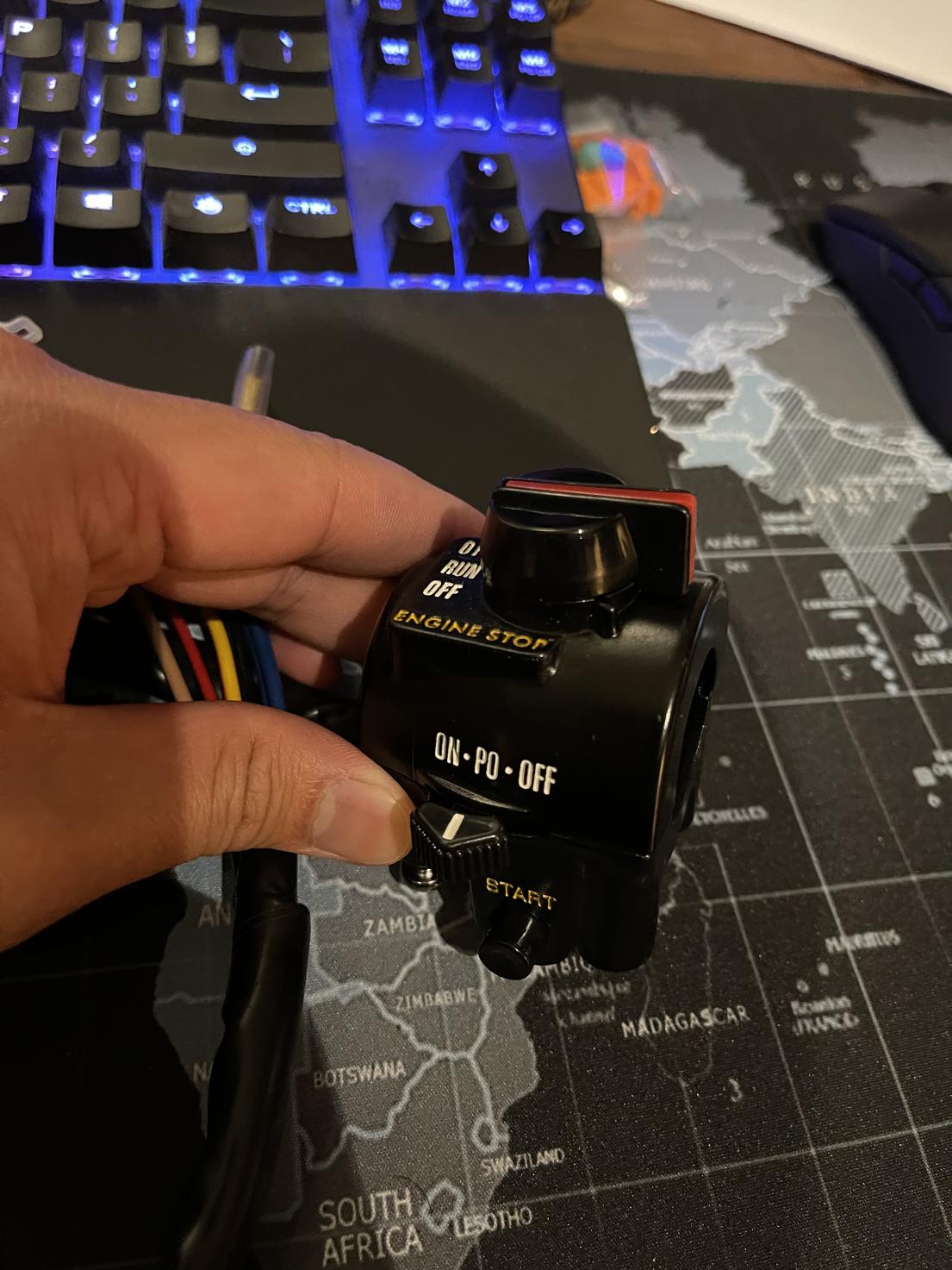

                    bikerphil Hi Phil wondering if you can help me out with this one.
                    replacing the R switch stop/start/kill
                    my bike has a 4-pin connector from switch to harness. All the wiring diagrams I see online has 5-pin connector from R switch to harness.
                    the new switch control has a 4 pin connector + 1 male + female in total 6 wires. Im planning on changing the connector style to a deutch waterproof pin connector but im not sure where all the wires should go.
                      • 8929
                      Is the new switch you are going to be using a Yamaha switch or something else? Post a few pics of the old and new switch if you could.
                      For the 4 wire switch:
                      Black is ground
                      Blu/wht goes to the starter solenoid
                      2 red/wht wires complete the loop for the kill switch

                        bikerphil the switch is aftermarket from cognitomoto.
                        oh god phil youre a legend. I couldn’t figure out why diagrams had 5 wires but my bike has 4.

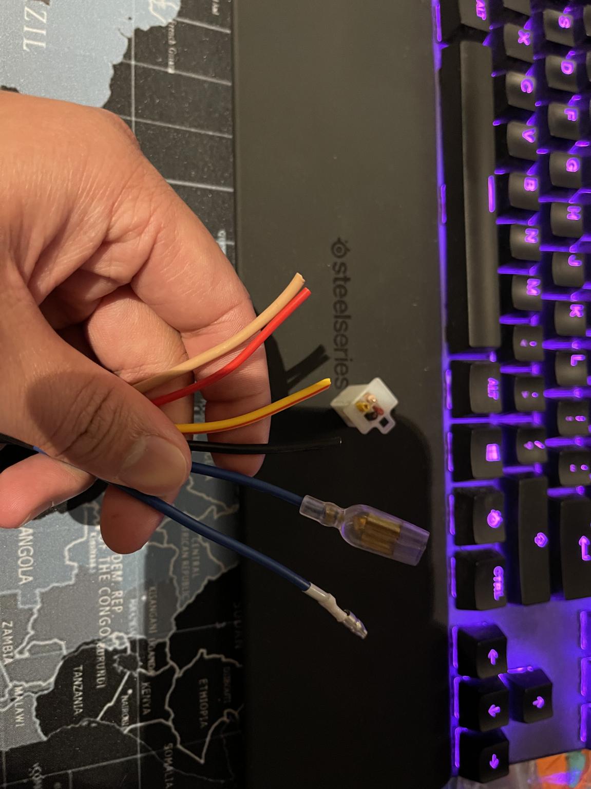

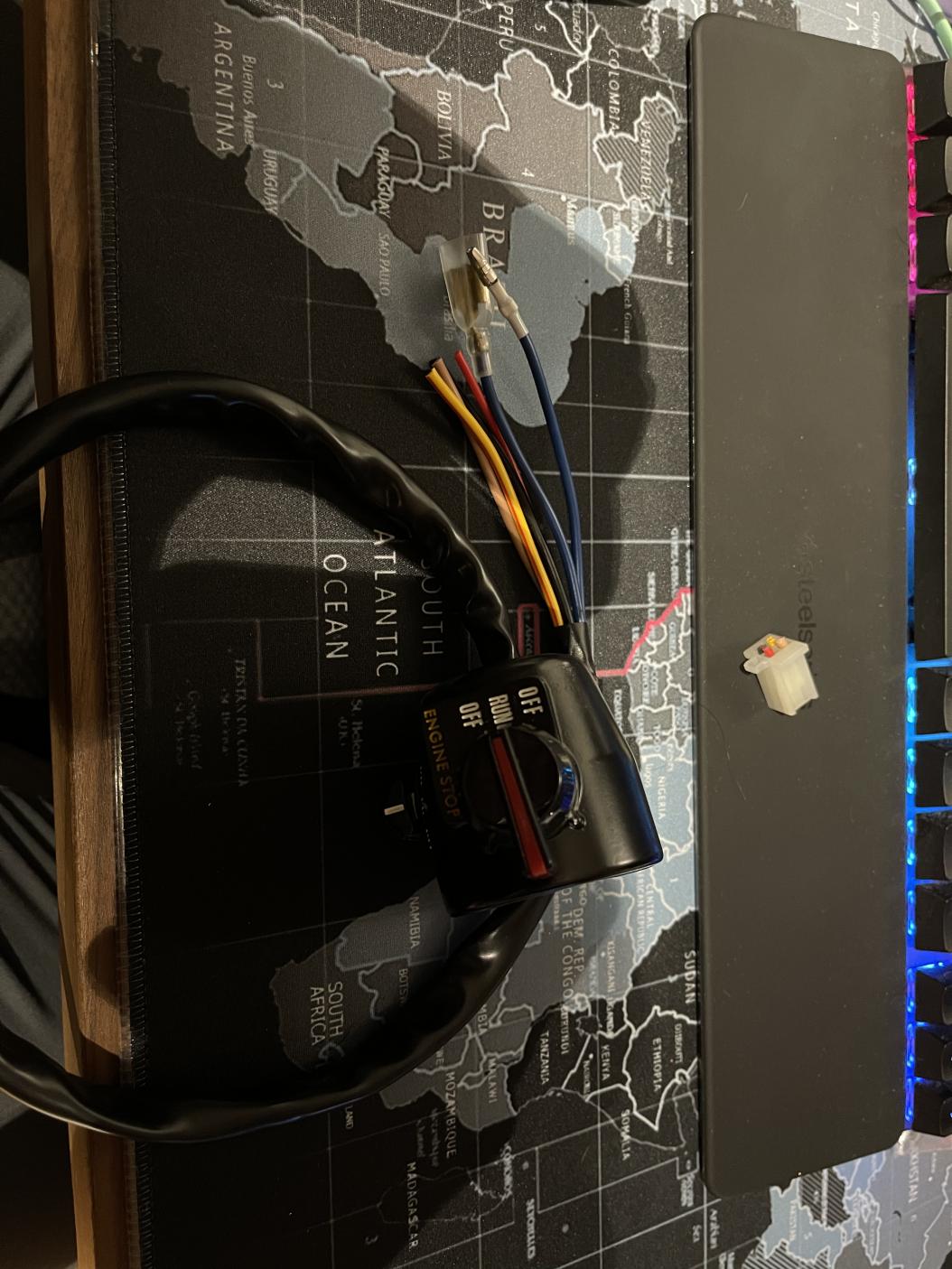

                          bikerphil From the website this is the only wiring diagram they provided for the aftermarket switch.
                          • Wiring Color Chart
                            • Blue to battery or key ignition
                            • Yellow / red connect to with blue bullet connector
                              • The blue wire is hot and by connecting it to the yellow/red wire you are providing power to the run, power on and start buttons. You can also just run the yellow to keyed ignition. The 2 blue wires are connected in the switch harness.
                            • Pink hot side feeding coils
                            • Red to reg/rec
                            • Black to starter solenoid
                            • 8929
                            Ok, first thing is the new switch won't require any power from the key or voltage regulator to operate the starter button and the on/off (kill) circuit. The way the starter button works is it grounds the blu/wht wire in the harness, leading to the solenoid to crank the engine. What you need to do is while pushing in the starter button, check for continuity between possibly the black wire and an unpainted area of the switch housing. If this works, great. If not, it may be a different color wire and the switch housing or maybe 2 separate wires. Anyway, when the starter button is pushed, it needs to complete ground to the blu/wht wire. The old switch uses the handlebar as ground going thru the switch housing and completes the circuit when the button is pressed. Let me know what you find.
                            As for the kill switch, put the switch in the run position and check for continuity between any 2 combination of the wires. When you find that, turn the switch to the off position and see if it breaks continuity. If it does, these 2 wires would go to the 2 red/wht wires (order doesn't matter) in the harness. These wires run to the TCI and when the loop is complete, the bike will have ignition, when the loop is broken, no ignition.

                              bikerphil i think i understand what youre saying. But not fully. All i can understand is
                              1. Check for which two wires have continuity when starter button is pressed.
                              —— i tried this last night but i did not try it with the housing on the bars. Which may be why the ground did not complete the loop. But to my knowledge i thought the black wire from the harness is ground? But nonetheless ill strap the housing on and try it.
                              2. As for the kill switch circuit up top. I opened the housing and there were only two colors. I matched those two colors up with the 2 red/white in the harness.
                              3. Im still confused where these blue wires go……
                                • 8929
                                There will be some unused wires that may be needed for different bikes, you won't need them. The black wire may be ground which would attach to the blu/wht providing it gets it's ground thru the handlebars. If you have painted handlebars you will need to remove some of the paint under the housing for it to mank contact.
                                Be aware that the colors of the wires on your new switch may not necessarily be the same as the ones in the bike's harness.
                                The blue wires are probably for that accessory switch in the center.
