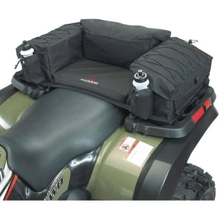

    Coleman Maddog saddle bags from Amazon just showed up at my door, UPS. I'm hanging them on Dark Horse and like them so far.
    I looked up your Coleman seat pad, 16x10x3" at Walmart and found an ATV pad that looks like it's made the same, 24x14", does not give height but bigger than the Coleman. Made by Northeast Harbor sold by KapscoMoto through Walmart $15. Went and ordered a somewhat matching fork bag while I was at it.
    I'm going to cut my sheepskin seat cover I had on my K100LT. It will go over the ATV pad that goes over the front strap of the bags. The bags front strap crosses over the seat right where the back of my butt perch is on the seat.
    Huh, $50 Coleman Maddog bags might be better than $100 Tourmaster bags.
    The Coleman ATV pad was the only one I found at Walmart, the one I bought and still have was discontinued. I don't really give a rat's patootie about the length of the pad but the width is important and I hope I didn't give Bonz a bum deer.
    If I need a longer pad for a passenger, I'd probably get one of the covers made for the rear of an ATV and sling it on there. Heck, I might try one for myself, forget the passenger! I'd like a seat cushion, backrest, dual cup holders and gadget bags too.
    Walmart | Coleman ATV Rear Padded Bottom Bag
