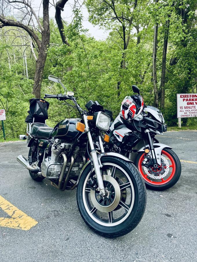

    Thanks for the tire recommendation everyone. She’s back on the road now after many years of sitting. Put around 150 miles yesterday. My buddy took his MT10 out and the Xs11 kept up with ease. He was shocked by how well it rode even with a 43 year tech gap.
      Yeah, the first HD that could turn a 1/4 mile faster than a stock 1978 XS1100 was the V-rod, and Porsche designed the motor for that bike! If you REALLY want to have some fun with your buddy, tell him you both put the bikes in high gear at 40mph, and then give it throttle. when he catches up with you you can smile!

        Theo The bike looks fantastic so glad you have it now please keep us posted on your progress
        82 XJ1100J
        81 Venturer
          • 8962
          That 110 really fills up that front fender well. Nice

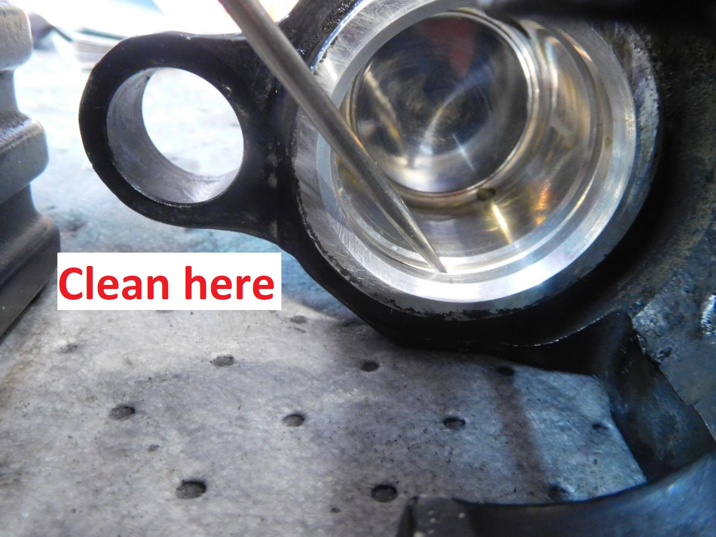

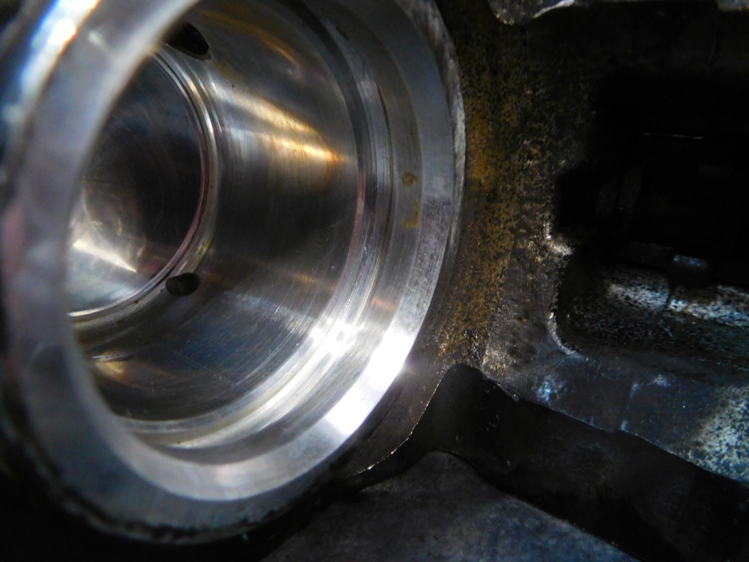

                      Since you guys have been so helpful, how much front wheel break drag is too much drag? My front wheel spins freely but there is a good amount of drag. I might pull the calipers out do a quick clean on the pistons.
                        • 8962
                        Well, if it's difficult to push the bike around in the garage, then it's too much drag. Yes the bike is heavy but should roll without too much effort.
                          An easy way to check is after you take it for a ride you should lightly touch each of the 3 brake rotors and they should be warm/hot depending on how you ride. If they are like stove top blazing hot, its time to clean out from under the brake seal. It's actually good maintenance to do so on such an old bike.
