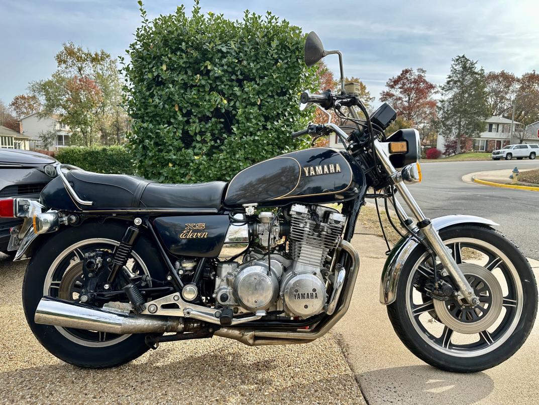

        Thanks bikerphil, Theo here, great to meet you. The current tires I have on there are Dunlop:
        Front - MM90H 19 (I might be wrong but I think it translate to 90/90-19)
        Rear - MT90B 17 (same goes here,100/90/17?)
        Regarding tube/tubeless - I’ll look for a stamp.
        • Tphil
          • Nov 2025
          • 10
          bikerphil - good news! They are tubeless.
          Let me know if my tire sizing is incorrect from my last comment. If they are, I’ll see if I can source the below:
          Shinko Tourmaster 230
          Front 110/90/19
          Rear 130/90/17
          Thanks again for your help!
