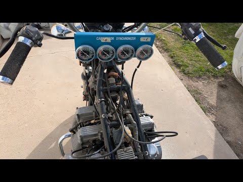

    Iffin' yur gonna go this far and Synchronize the carbs on yur XS1100? (O_o)
    Then fOaR sure you've made sure all gauges read the same by using Tees to tie them all together to the same source and verify'em. ( •_•)

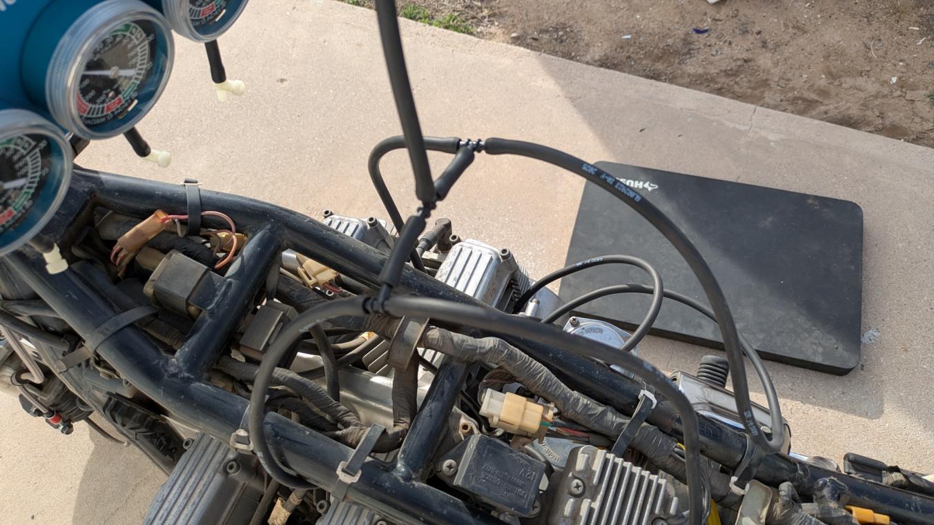

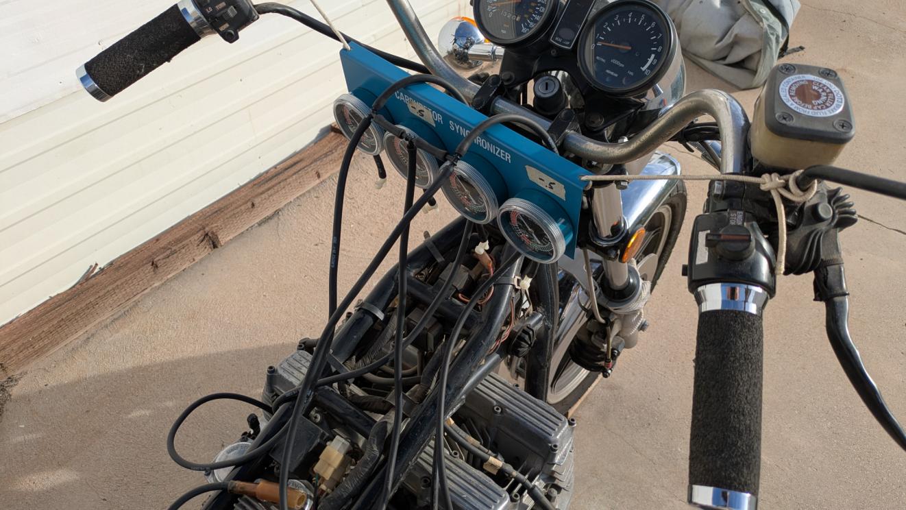

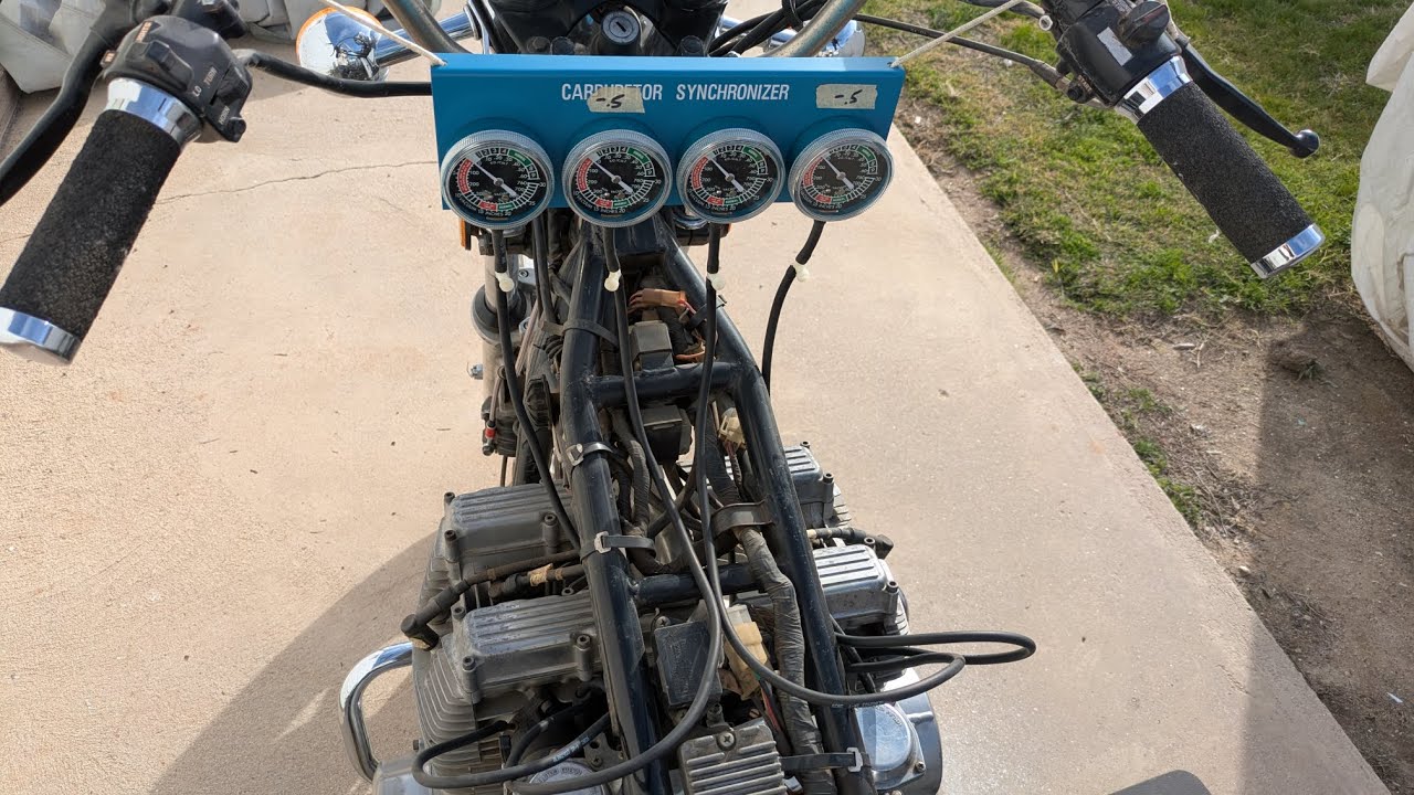

                    Here is what I use on my XS to sync the carbs. The plastic tank hangs from the IV pole, as do the gauges. Got it cheap through an auction site here in Idaho. If you notice in the second photo, I have a hand vacuum pump hooked to the gauges so I KNOW they all read the same.

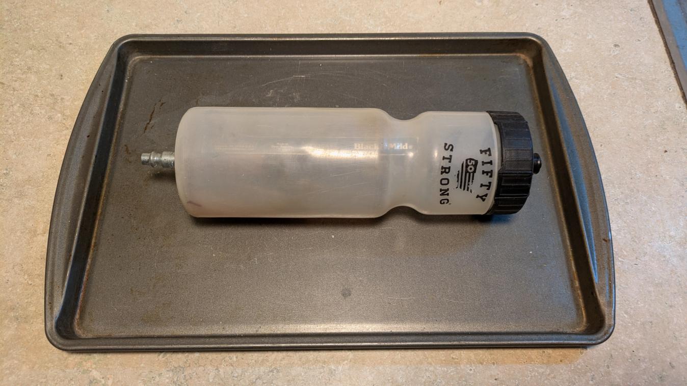

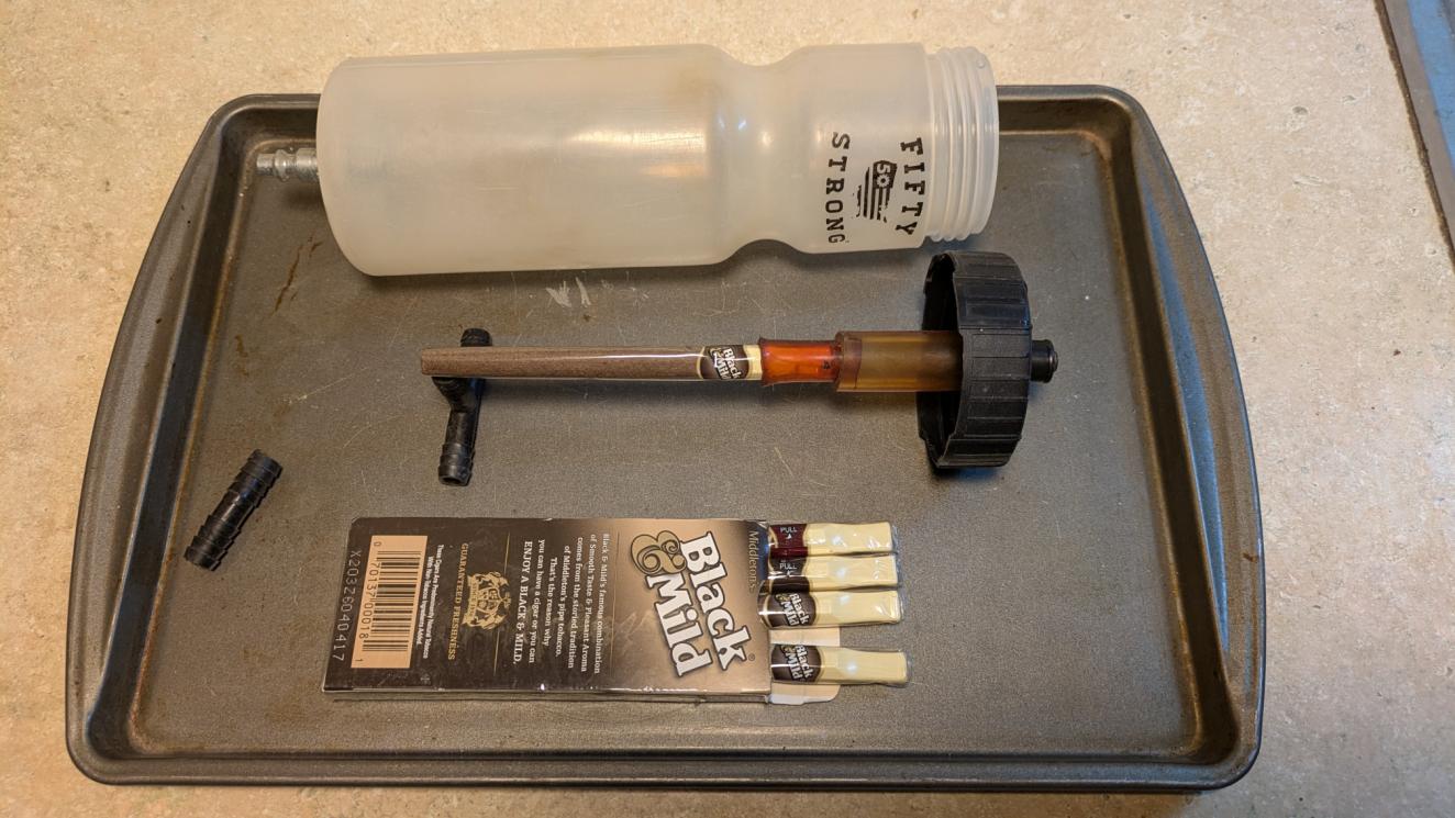

                      Here's wut I use to generate the smoke needed to check the entire air intakes system on my XS fOaR leaks. (^_^)

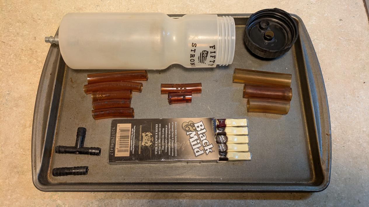

                      Actuakly all the "stuff" that I keep inside it shown below.....
                      Just a lot of old nylon hose sections and stuff I've found useful as adapters to hook "Der Raucher" (The Smoker....) to vehicles' vacuum/intake systems. (O_O)
                      Note- the hoses are yellow cuz they're like over 10 years old and that's wut happens to'em over time. NOT cuz they've been used to make smoke. (;☉_☉)
                      And....YES. The cigars fit inside too. A "bring-it-to-wheres-you-need-it-and-do-wut-it-do" setup. (^-^)

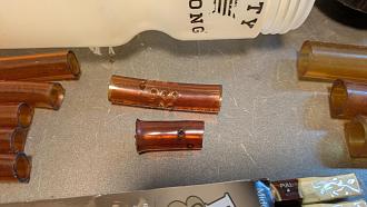

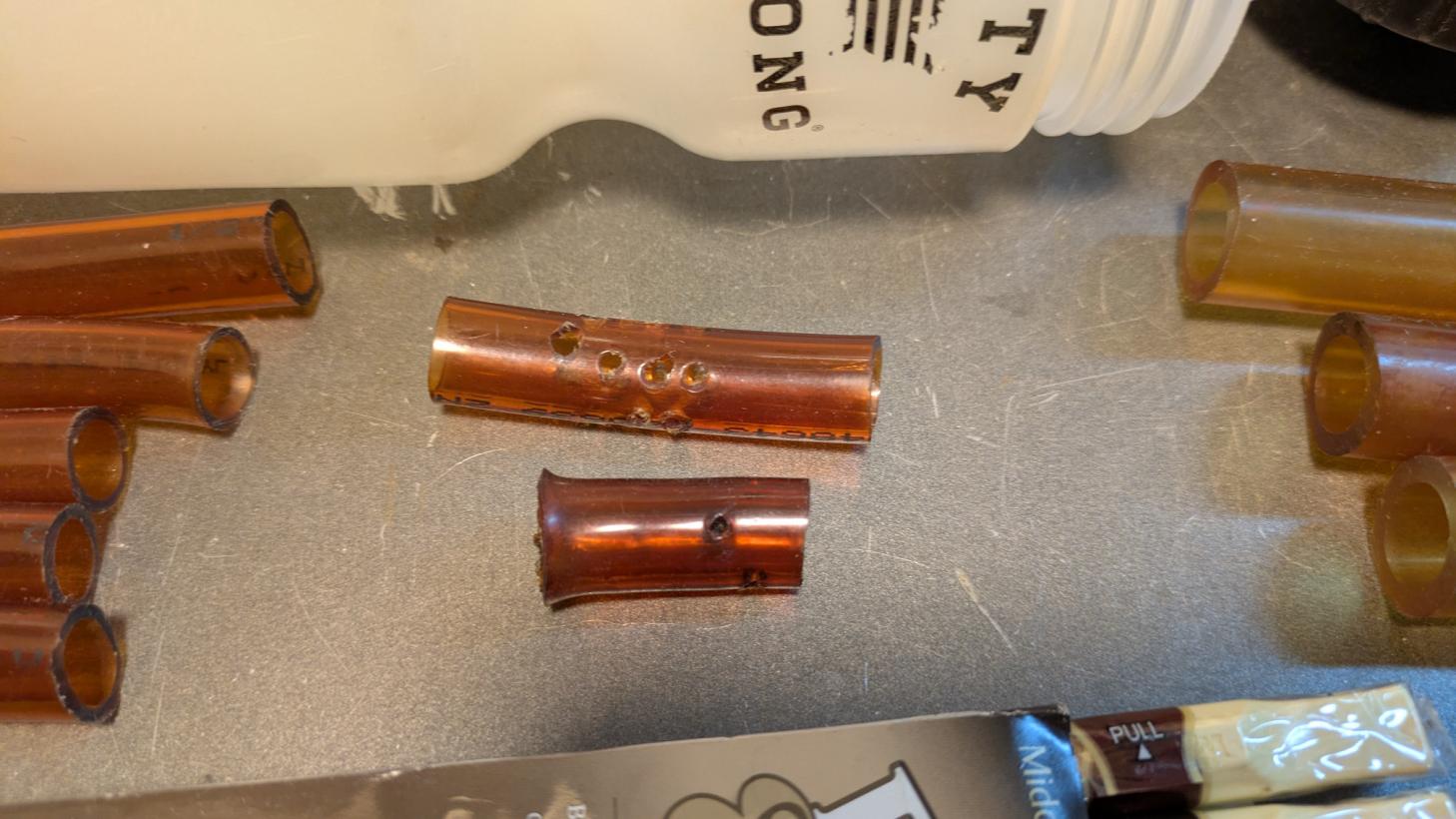

                        REALLY impor'unt are these two sections of hose wit' extra holes in'em.... (*′☉.̫☉)
                        Top one is fOaR when I use Incense and bottom one is fOaR when I use the cigarz.... ໒(⊙ᴗ⊙)७✎▤

                        The plastic cigar "holder" is held inside the section wit' holes and then that hose section is inserted into the larger hose wut gets connected to the water bottle "Lid". (∩`-´)⊃━☆゚.*・。゚
                        The extra holes mean extra air flows in along with the air that's from the soon-to-be-burning cigar. (・‿・)
                        This alows the "user" to adjust the smoke density by inserting the "holder" farther in or out of the next hose section (covering or uncovering holes...) ٩(^◡^)۶

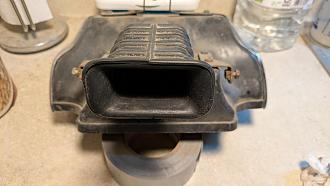

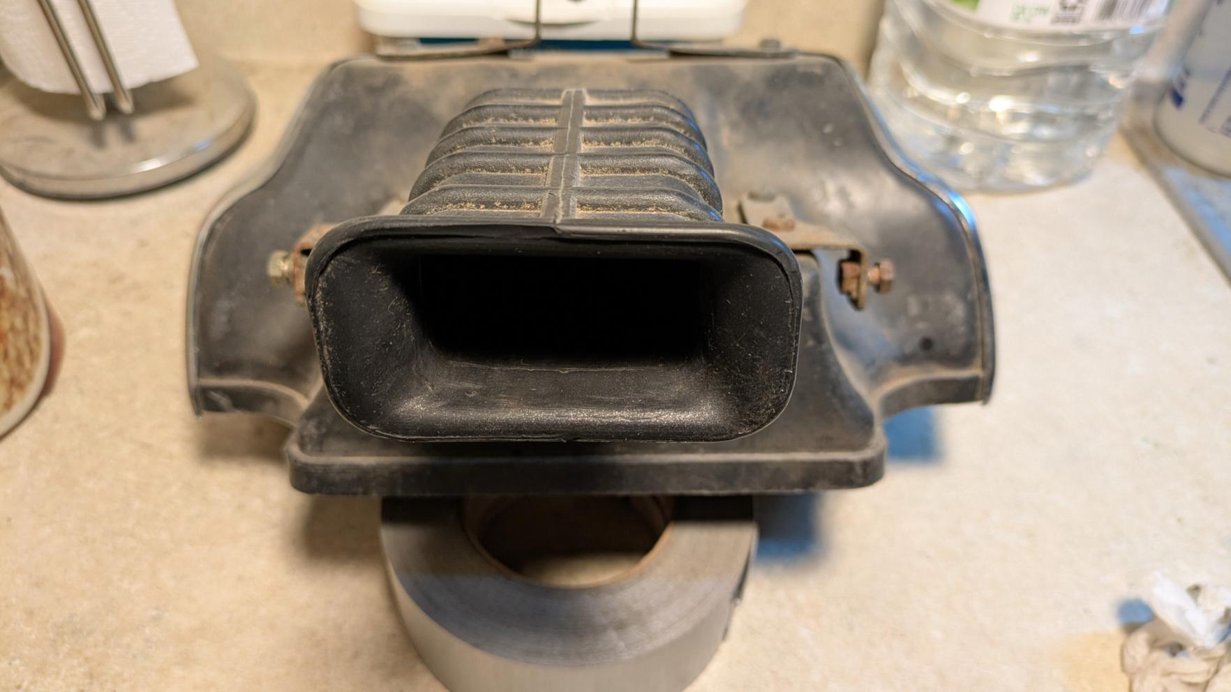

                          Prob'ly not noticed in the video and not even mentioned? (O_o)

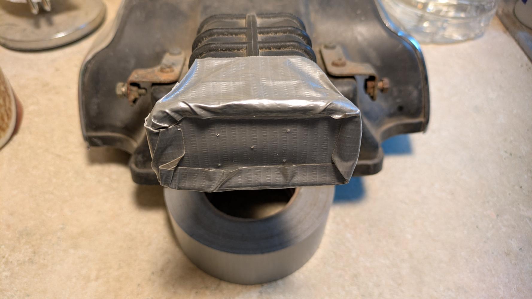

                          When yur actuakly doin' the testing you shouldn't leave the intake horn/snout/wut ever open like shown above. (ノ_<、)
                          The smoke test needs a bit of back pressure/restriction so's the smoke seeks out and finds any unwanted leaks. (¬‿¬)
                          When I did testing I had the snout blocked off like THIS-
                          Just duct tape wit 5 pinhole poked innit. Seems to wurky fine fOaR me. (*^‿^*)
                          Note- even if I leave the snout open (no tape...) no smoke ever comes out cuz I gotta oiled uni-foam air filter.... amazing, right? (* _ *)
                          You can decide fOaR yourself whether or not to put tape over the vent hole in the bottom of the air box. (O_O)
                          You know... the hole where the gas from overflowing carbs is s'posed to leak out instead'a goin' in yur motor? (O_o)

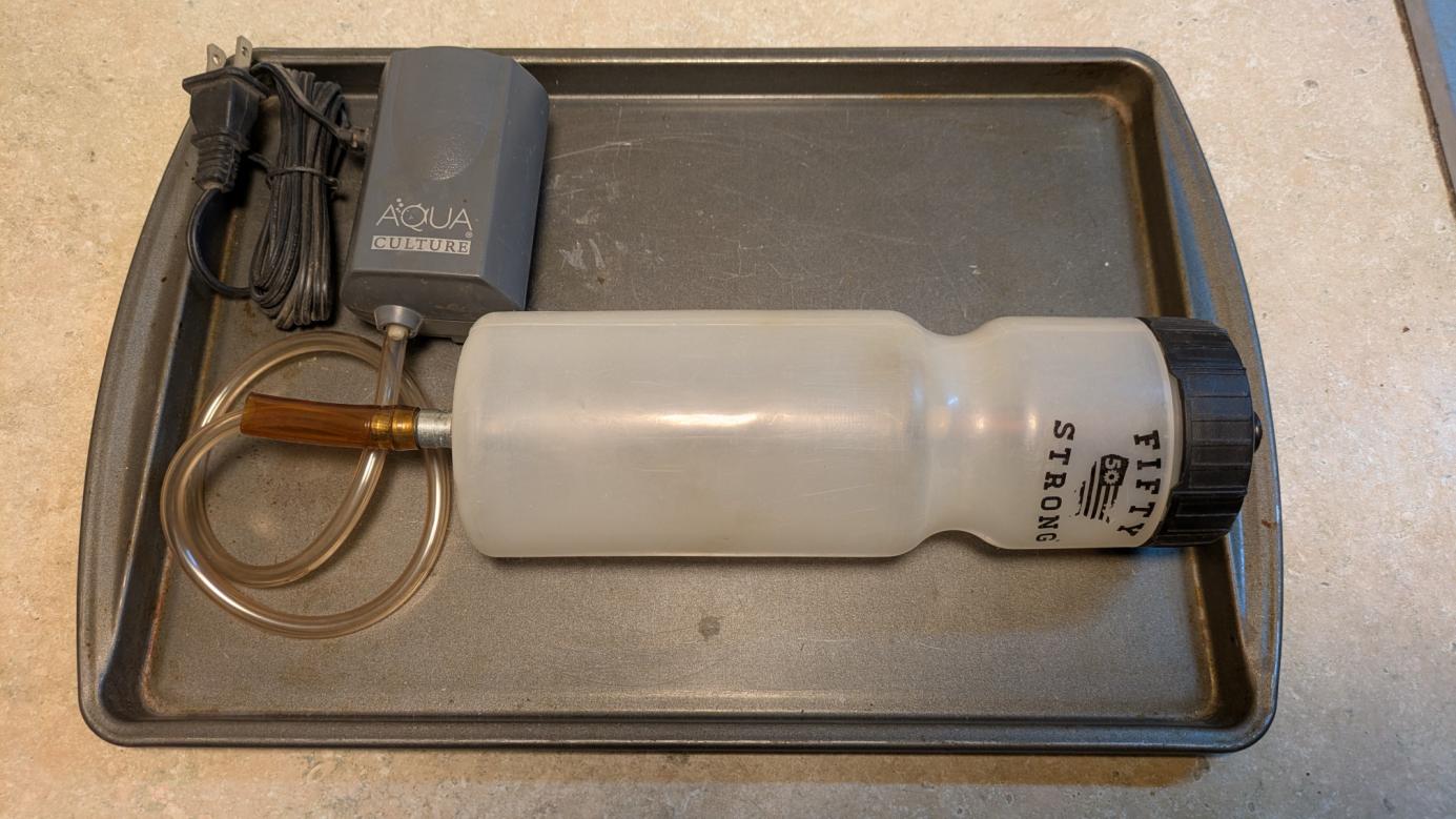

                            And iffin' you want/need a continuous supply of smoke instead'a measured pulses? (O_o)
                            That's a small aquarium air pump. Same one I use(d) to reverse fill my front brake system (^_^)
                            O'course you gotta have 120 Vac to use it which means yur likely inna garage or shop or sumpthin'. (⚆ᗝ⚆)
                            Ventilate well or yur gonna get folks riled up. (;° ロ°)
