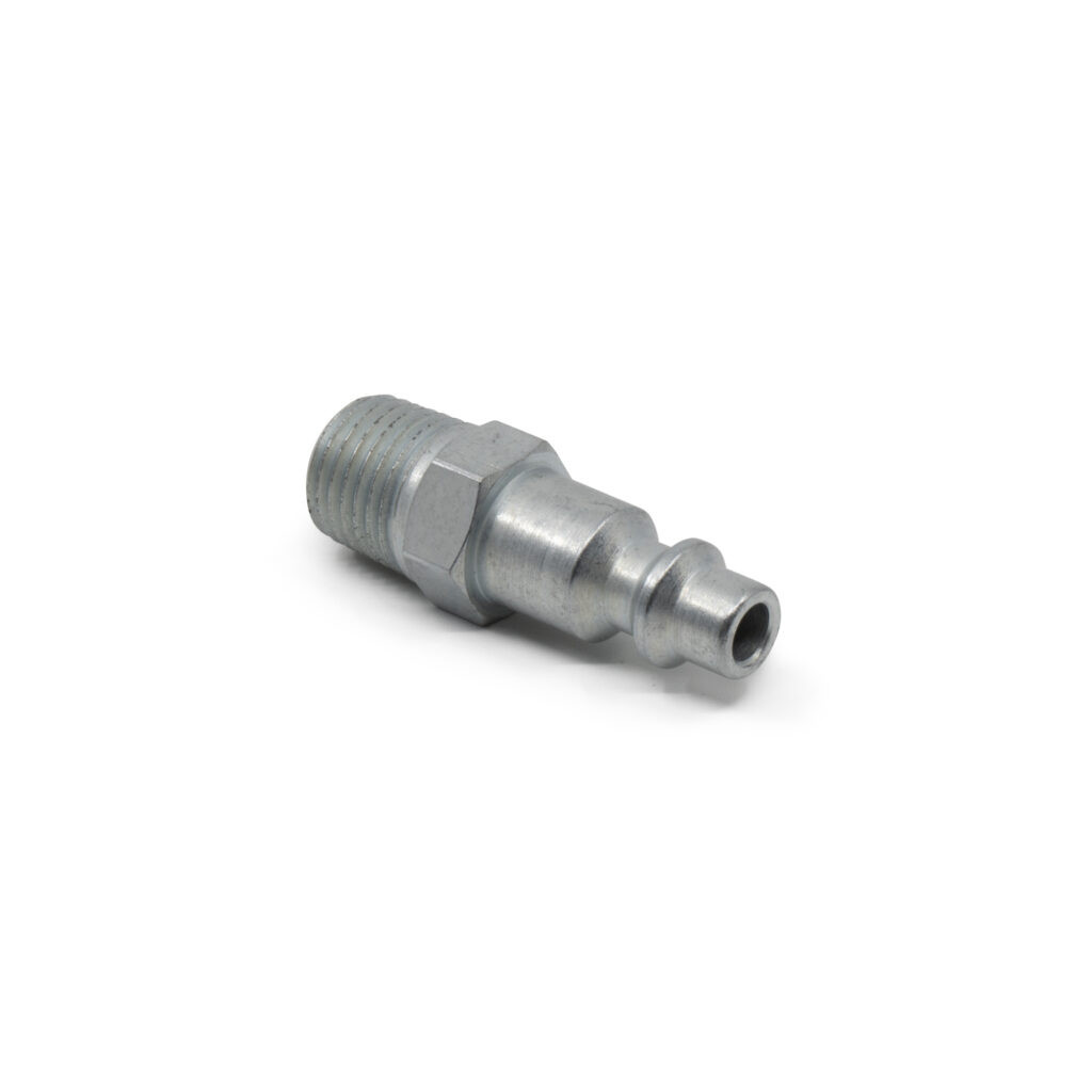

      Huh! This I have to try…Where does the one way valve on the bottom of the bottle come from?
      Umm....Not truly a one-way valve unless you count putting your finger on it when you squeeze and taking it off as you release. (☉_ ☉)
      Looky like this-
      Just a quick connect air fitting I had rolling round the bottom of my toolbox. (‘-’*)
      I'd never recommend hooking this thingy up to an actual air compressor line at ANY pressure. (つ﹏⊂)
      BUT wit' that air fitting I can and have connected/used a bicycle pump to slowly move larger volumes of air/smoke. ヽ(~~~ )ノ
