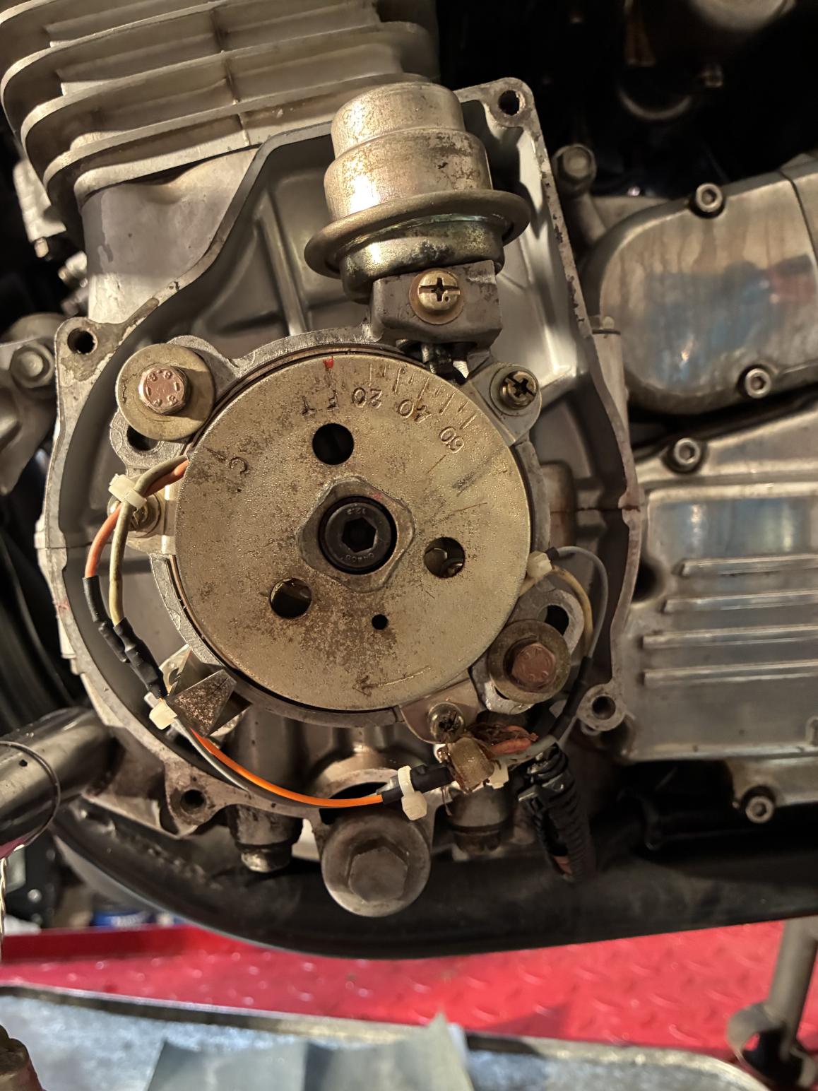

      I got mine fixed. It looks OK? My motivation was replacement of the oil seal behind it.
      I think it looks great, nice and neat like it would in an aircraft
      I've never had any problems with plastic zip ties deteriorating with heat except for when exposed to sunlight.

        White zip ties are NOT good for outdoor use. They are not UV resistant like the black zip ties.

          Arizonia...where I'm at? (O_o)
          I used them nylon zip ties on my truck (under the hood...) and even to secure the wires to my security camera(s). (O_O)
          The security camera wires wuz under the eaves and outta the sun but 6 Months later those farking zip ties just dried out and BROKE under the weight of the wiring. (>_<)
          Imma thimkin' twas not the sun but HEAT (caps intended...) wut dried'em out and broke'em AND the ones under the hood of my truck. ( ⊡ _ ⊡ )7
          Anybody ever used one of those laser temp gauge thingies on an XS engine after a "spirited" ride? (O_o)
          Probl'y a lot hotter under the left side engine cover where's Marty put them ties. (◔_◔)
          Unless Imma missing some sorta Yamaha engineered ventilation underneath that cover. ( *∵* )
          IMO, them zip ties is gonna BAKE-n-Break and one day let them P/U wires start flopping around.... ( ´・仝・`)
          Or at least that's wut Imma thimkin' would happen to me in Arizonia... ໒( •́ ∧ •̀ )७

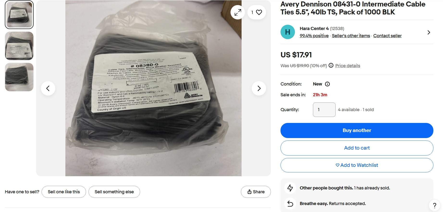

              Before retirement, I worked in security electronics for 20 years. These wire ties are used outside to tie fence alarm sensor wire to fences in New England weather. I first used these in 2003 and they are still holding that wire to the fence. I use these on all my motorcycle projects and have never lost one yet. They are UV proof and double lock.

                  Those metal ties don't worry you that they may cut into the wire sheathing. Seems like the back and forth motion would pose a risk. Cinching the wires tightly as Ray mentioned shouldn't be done as that is what causes the wires to break.

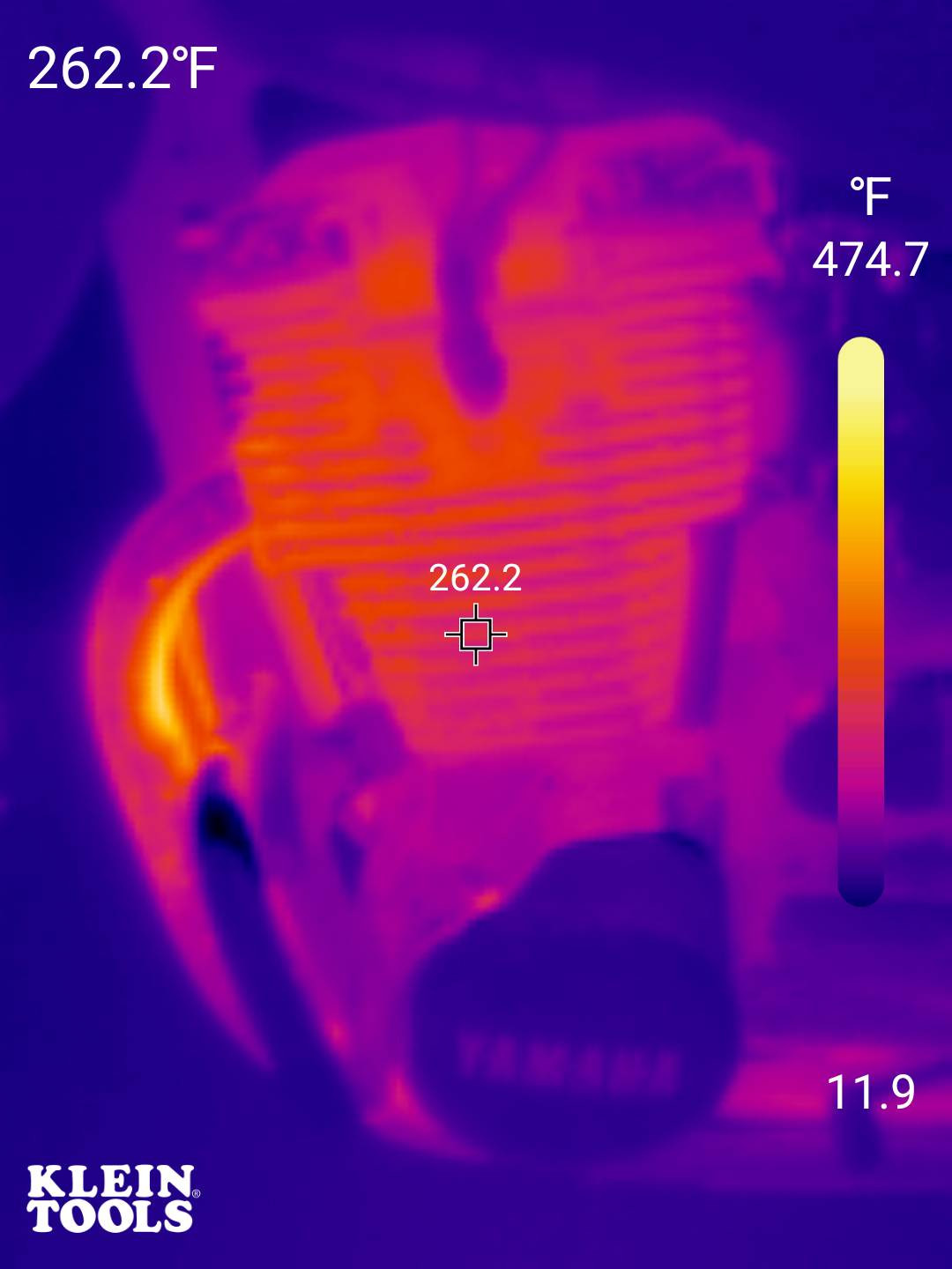

                    It might, just M i g h t.... be ok/safe to use them pesky nylon Tie wraps (high quality kind...) under the left side cover. ( •_•)
                    Lookey here-
                    Thermal pic taken less than a minute after a 25 mile "soft-serve" loop, shutdown, and puttin' it up on the center stand. ( ๑‾̀◡‾́)σ
                    Left side cover (and prob'ly everything inside...) WAY cooler than the 262,2 Degrees Farenheight of the cylinderz.... (; ꒪ö꒪)
                    Dunno how them Yammy engineers did it but...whoop! There it is!!! (;° ロ°)

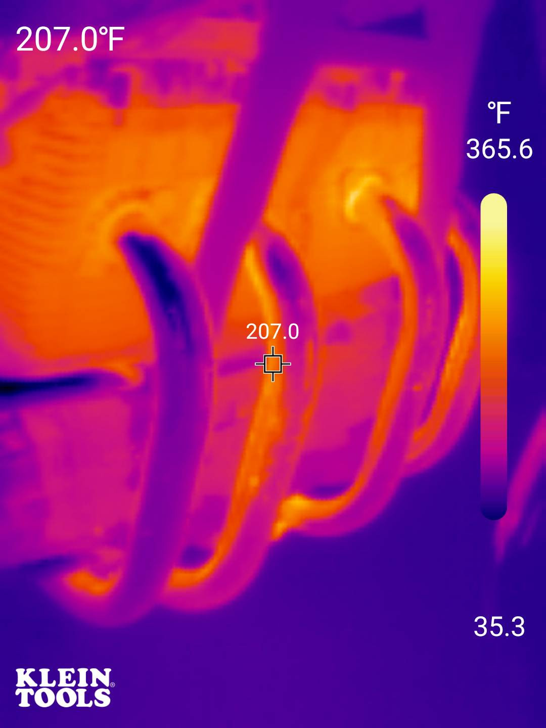

                    On anuther note... my XS started runnin' like a 750 A-G-A-I-N 'bout a mile from home. (⊙_☉)
                    Lookey like #4 cylinder ain't right fOaR some reason....(o_O)

                      I used nylon tie wraps. I think they fell into my lunchbox once upon a time.
