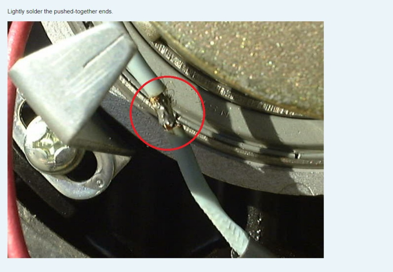

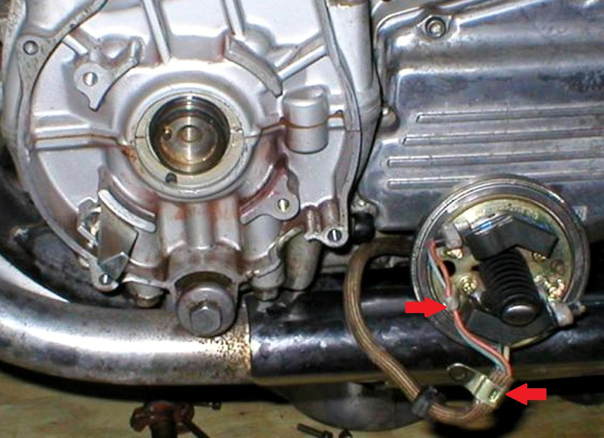

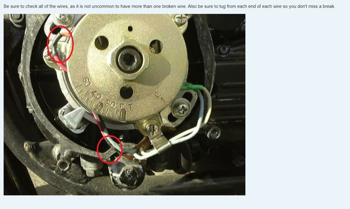

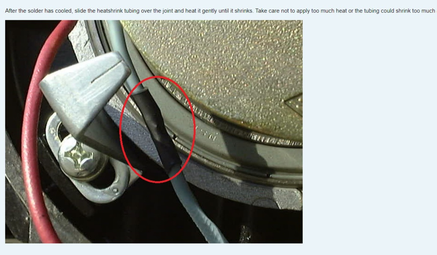

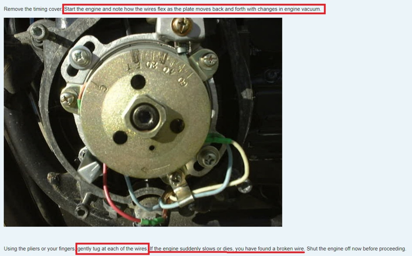

        I had pick-up problems with my bike. Ran ok sometimes when it was cold. When the engine got hot it would sometimes misfire. Turned out to be a common broken wire issue. Usually under one of the clamps. When the advance starts to rotate as the rpms build is when it can separate the broken pieces. Mine was an "just off idle" stumble. Here are some photos of diagnostics and repair.
Name:	Broken wire spots.jpg
ID:	886860 Click image for larger version
ID:	886861 Click image for larger version
ID:	886862 Click image for larger version
ID:	886863 Click image for larger version

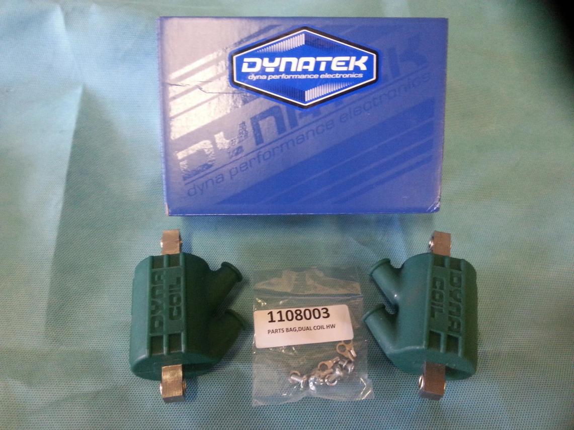

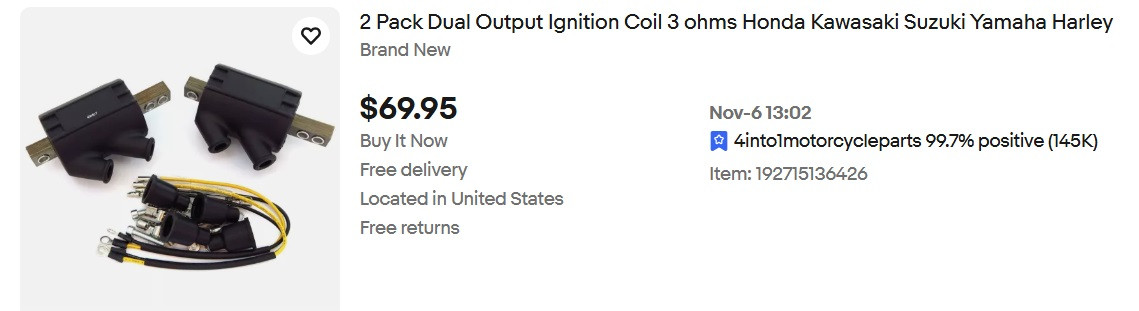

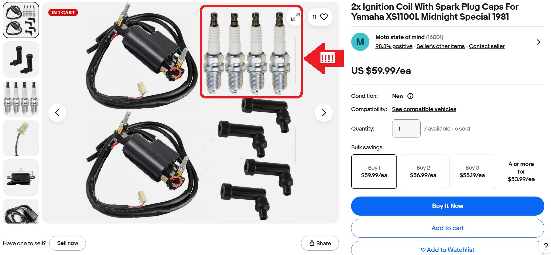

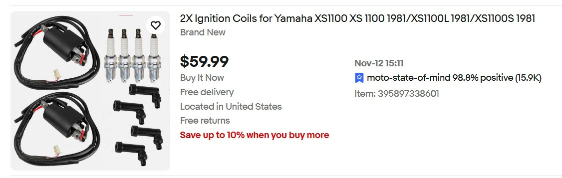

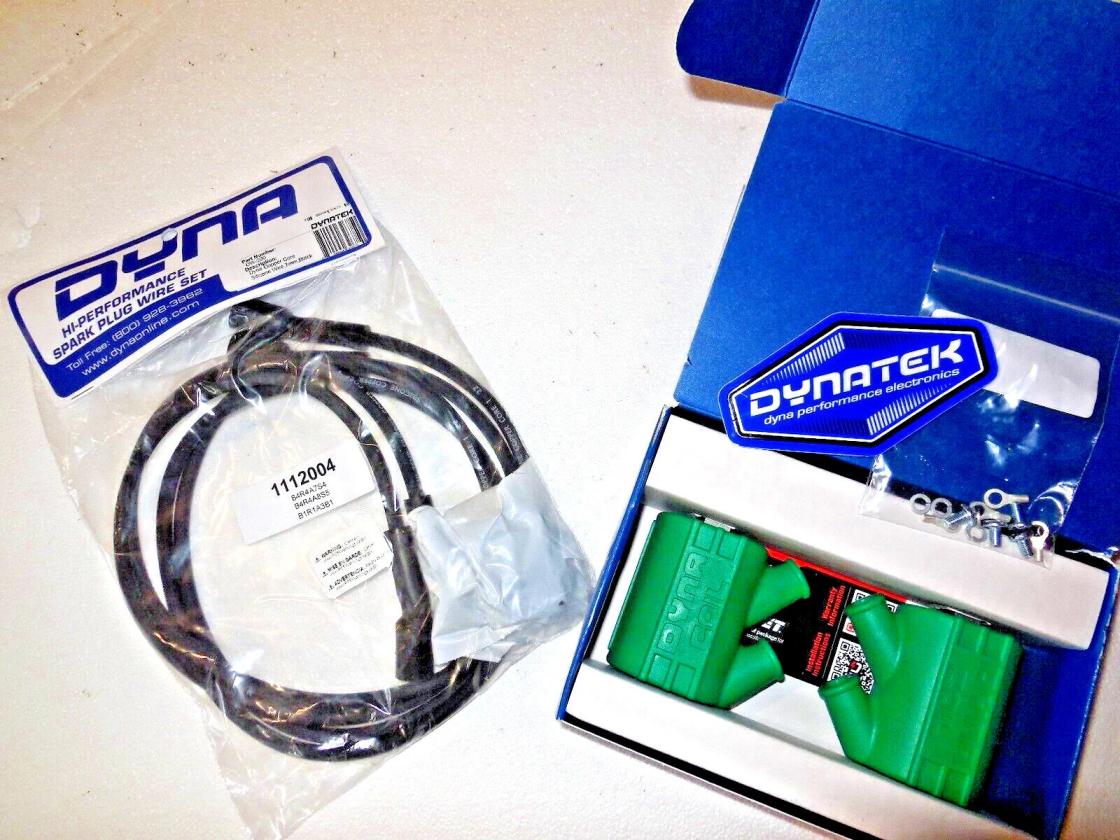

          It should also be mentioned the possibility of counterfeit Dyna coil Chinese junk parts as there are a flood of them in the repair market. They are sold by many "reputable" vendors. Here is an example of genuine parts:
          Click image for larger version  Name:	GENUINE DYNA COILS 3 OHM.jpg Views:	0 Size:	264.9 KB ID:	886866 Click image for larger version  Name:	GENUINE DYNA COIL BOX.jpg Views:	0 Size:	177.5 KB ID:	886867 Click image for larger version  Name:	ezgif-245e6c3899be0151.jpg Views:	0 Size:	135.7 KB ID:	886868 Click image for larger version  Name:	ezgif-25f4ea303782f1a3.jpg Views:	0 Size:	147.0 KB ID:	886869
            And here is how to spot Chinese F*ckery.
            Click image for larger version  Name:	FAKE.jpg Views:	0 Size:	139.5 KB ID:	886871 Click image for larger version  Name:	FAKE CHINESE DYNA COILS.jpg Views:	0 Size:	65.8 KB ID:	886872 Click image for larger version  Name:	FAKE DYNA COILS 1.jpg Views:	0 Size:	88.2 KB ID:	886873 Click image for larger version  Name:	FAKE DYNA COILS 4 INTO 1.jpg Views:	0 Size:	62.8 KB ID:	886874 Click image for larger version  Name:	ezgif-260610304ed4bc6a.jpg Views:	0 Size:	139.9 KB ID:	886875
              Another example of fake stock style Chinese junk. This kind of crap is being installed every day across the entire world from cars to motorcycles to refrigerators to washer/dryers to lawn equipment and everything in between literally ruining normally infinite sustainable machinery. It's a way to destroy the old and force you to buy the new crap (in this particular case motorcycles) that they are forcing down our throats.

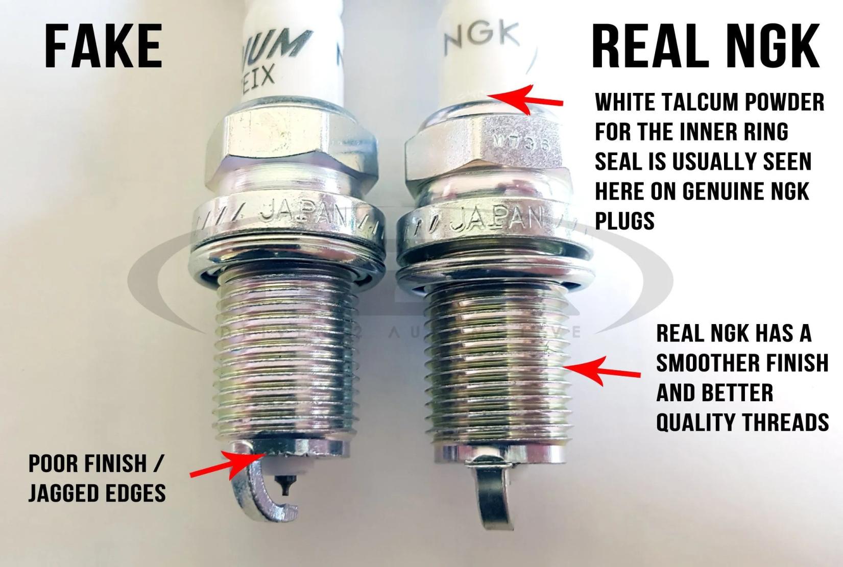

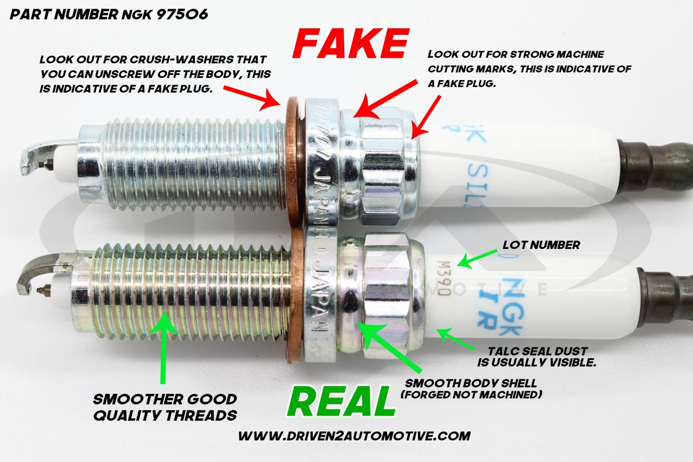

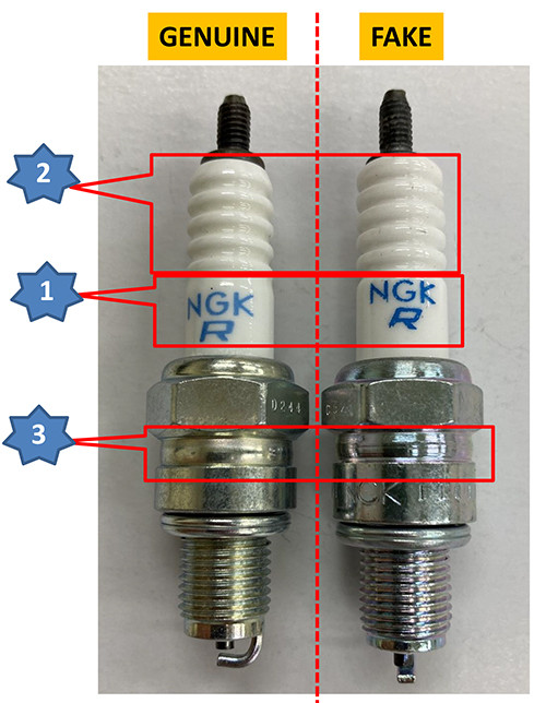

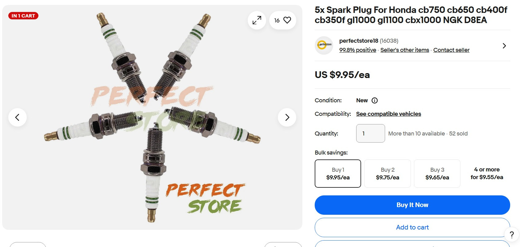

                Fake Chinese NGK (as well as others) spark plugs are being sold all over the internet. They not only sometimes just stop working but have been known to separate and the metal drops down into your engine and grenades it. There are horror stories all over the internet on many forums about this situation. We who wrench are f*cked.
Name:	FAKE CHINESE SPARK PLUGS A.jpg

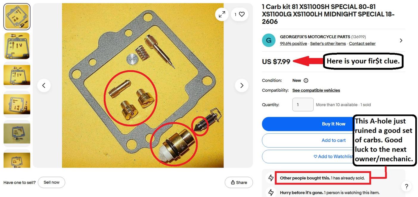

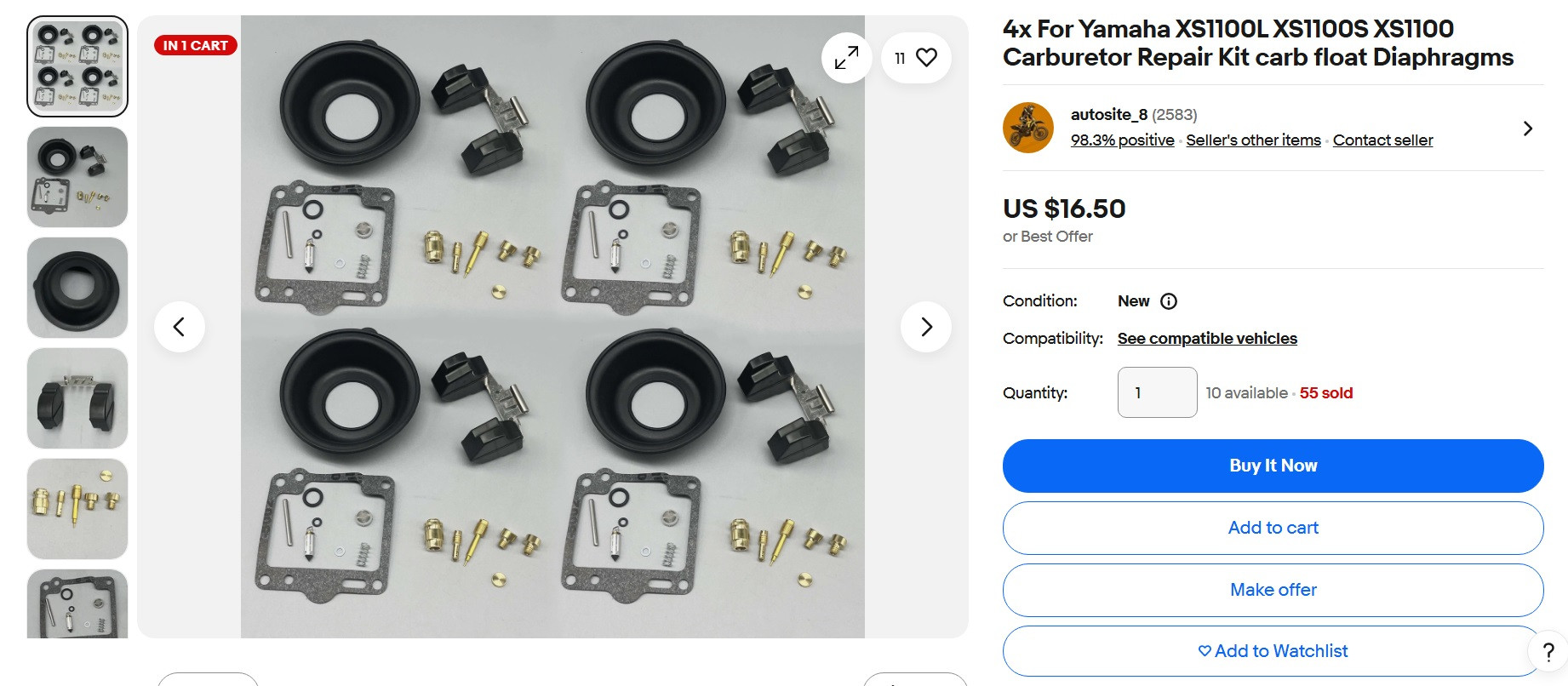

                    Don't even get me started on Chinese junk carb parts.
Name:	Junk carb kit.jpg
ID:	886887 Click image for larger version
Name:	Chinese junk carb parts a.jpg
ID:	886888 Click image for larger version
Name:	Chinese junk carb parts.jpg

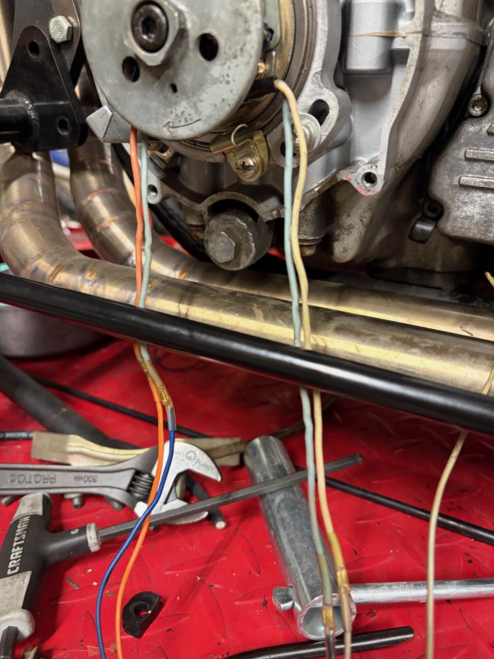

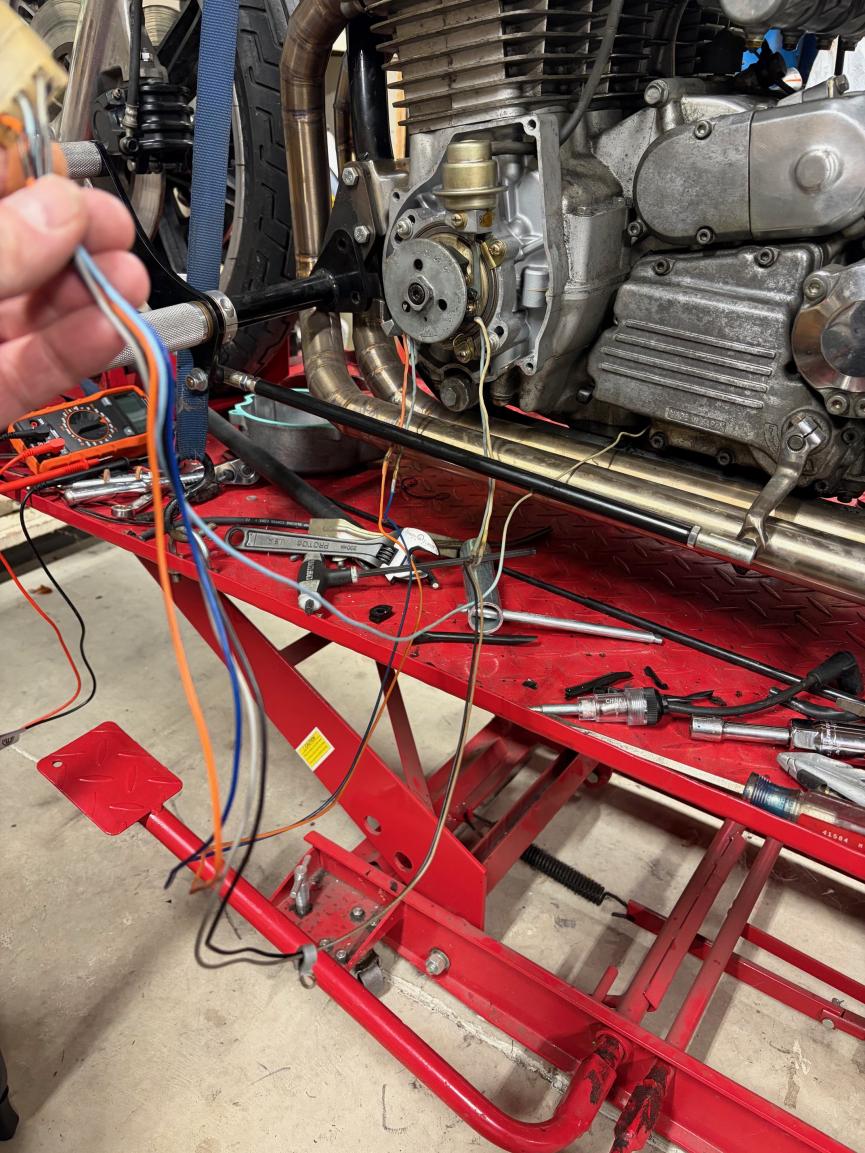

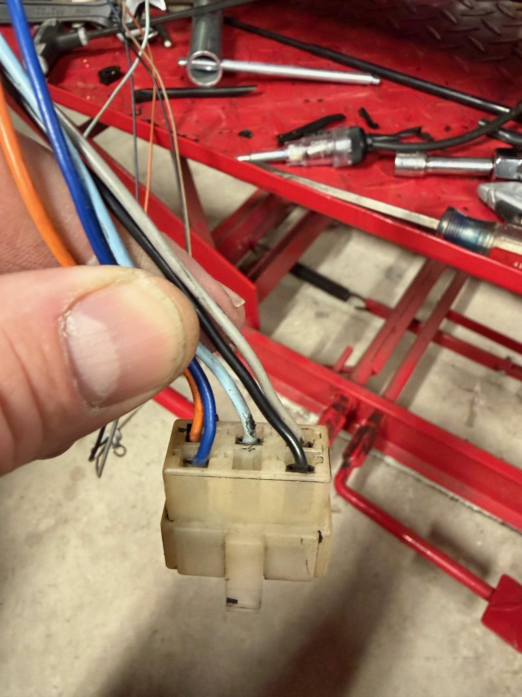

                          I checked the wires, pulled the sheathing all off and pulled on the wires pretty good. There was no "springy" sections in the wires indicating a broken wire. I researched that problem on here and on Youtube because it seemed like a common problem. Here are my wires: Click image for larger version
ID:	886895 Click image for larger version
ID:	886897 Click image for larger version
                          Yesterday I had my bike in the shop with the heat on and I checked for resistance (ohms) with multimeter across all the wires and got nothing. I checked for for continuity in the wires from the plug all the way up to the start of the pick up coils and got continuity in all the wires telling me the wires are not broken. just for giggles I checked for resistance at the plug today in my cold shop and I got 723ohms on one and 732 out of the other. Seems like they are changing due to heat. Does that sound right?
                          Let me know what you guys think. I sure appreciate the help. I sooo want to have this issue behind me. Thank you for the help.

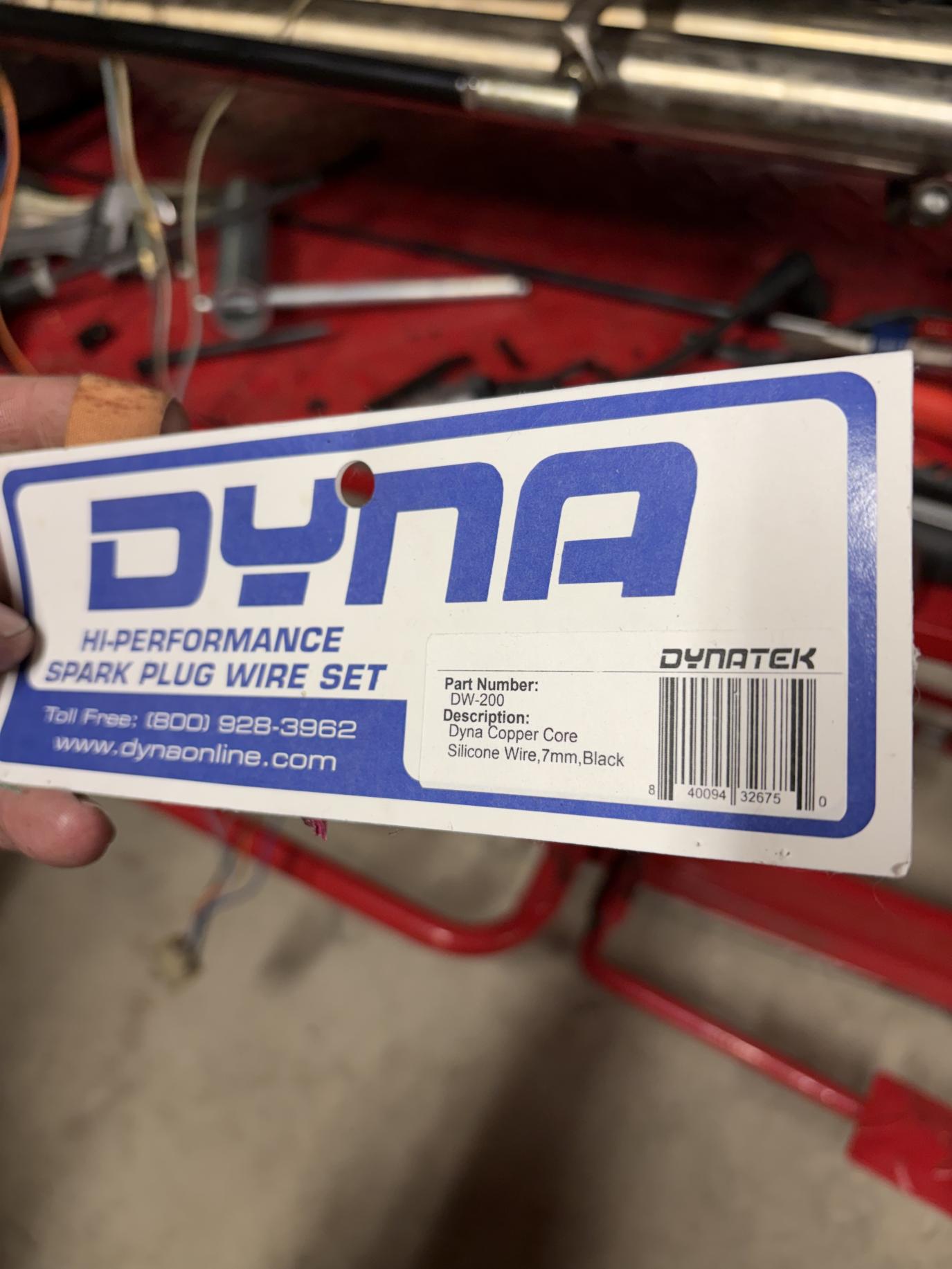

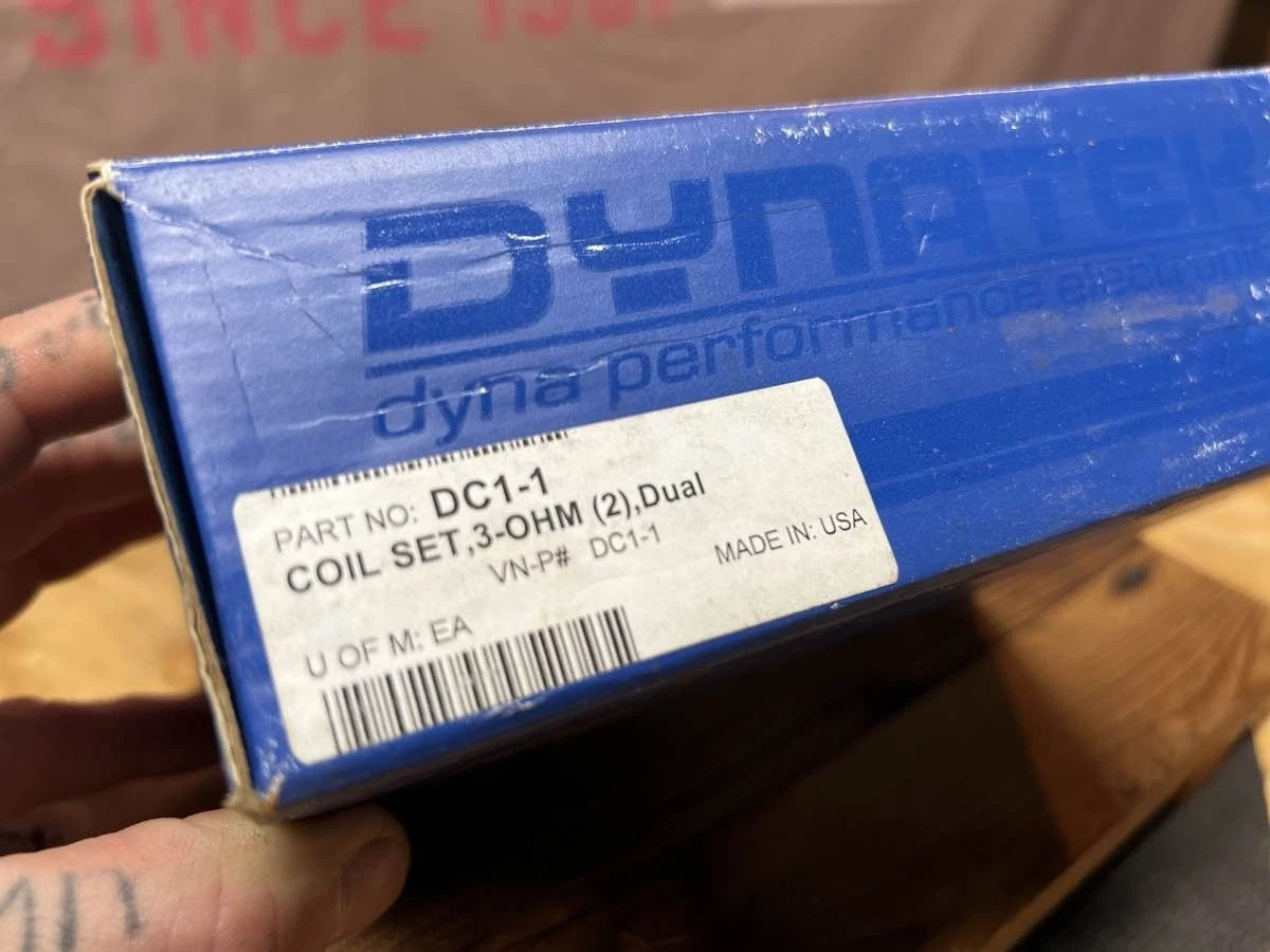

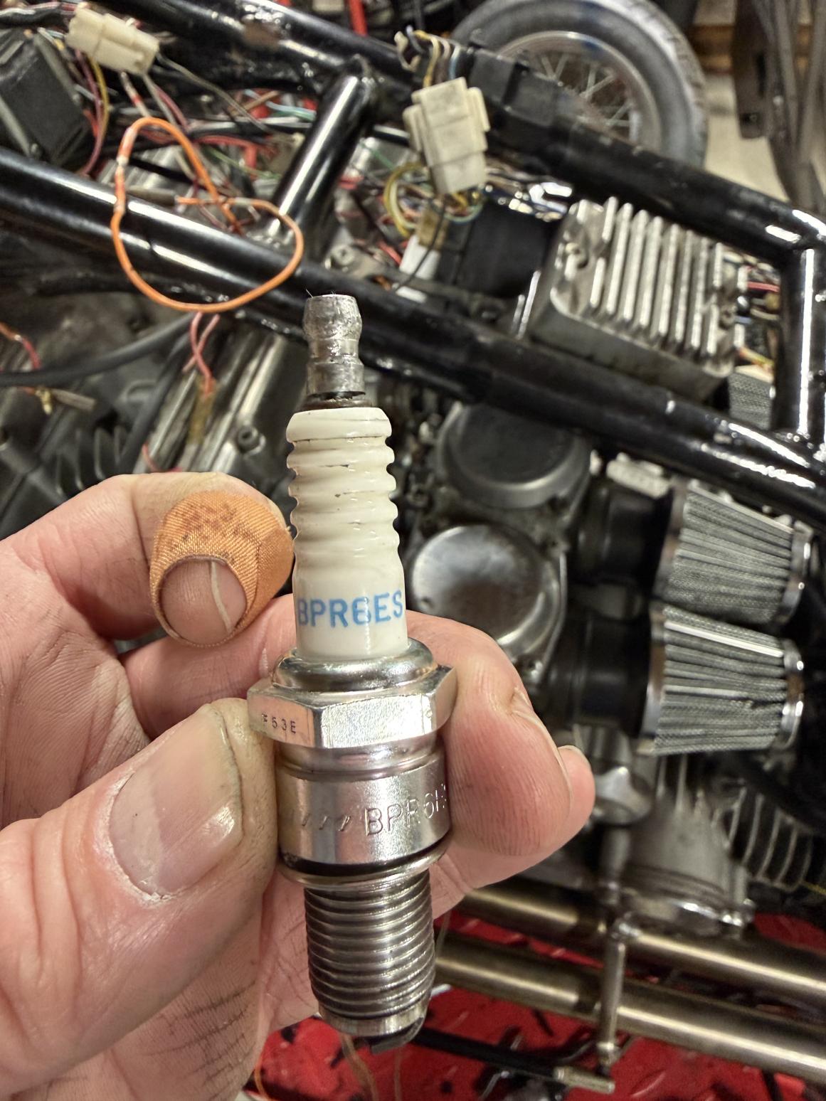

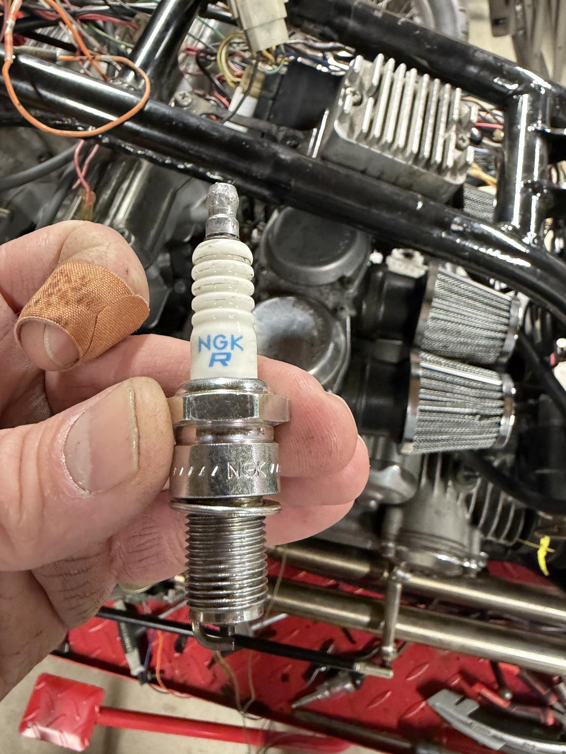

                            Here are my parts, they all seem to be the good ones right?
ID:	886900 Click image for larger version
ID:	886901 Click image for larger version
ID:	886902 Click image for larger version
                              Your equipment looks legitimate but I'm not sure with the spark plugs. However, testing wires on a cold, non-vibrating bike might give you erroneous results. I suggest putting it all back together and warming up the bike with the cover off. At idle, start pulling at the wires one at a time and see if you get a reaction.
                              Another question: When did you start to have this issue? What was done just prior to this problem occurring?
