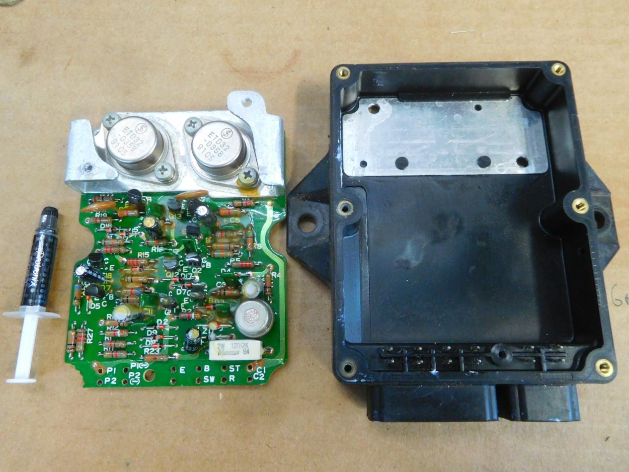

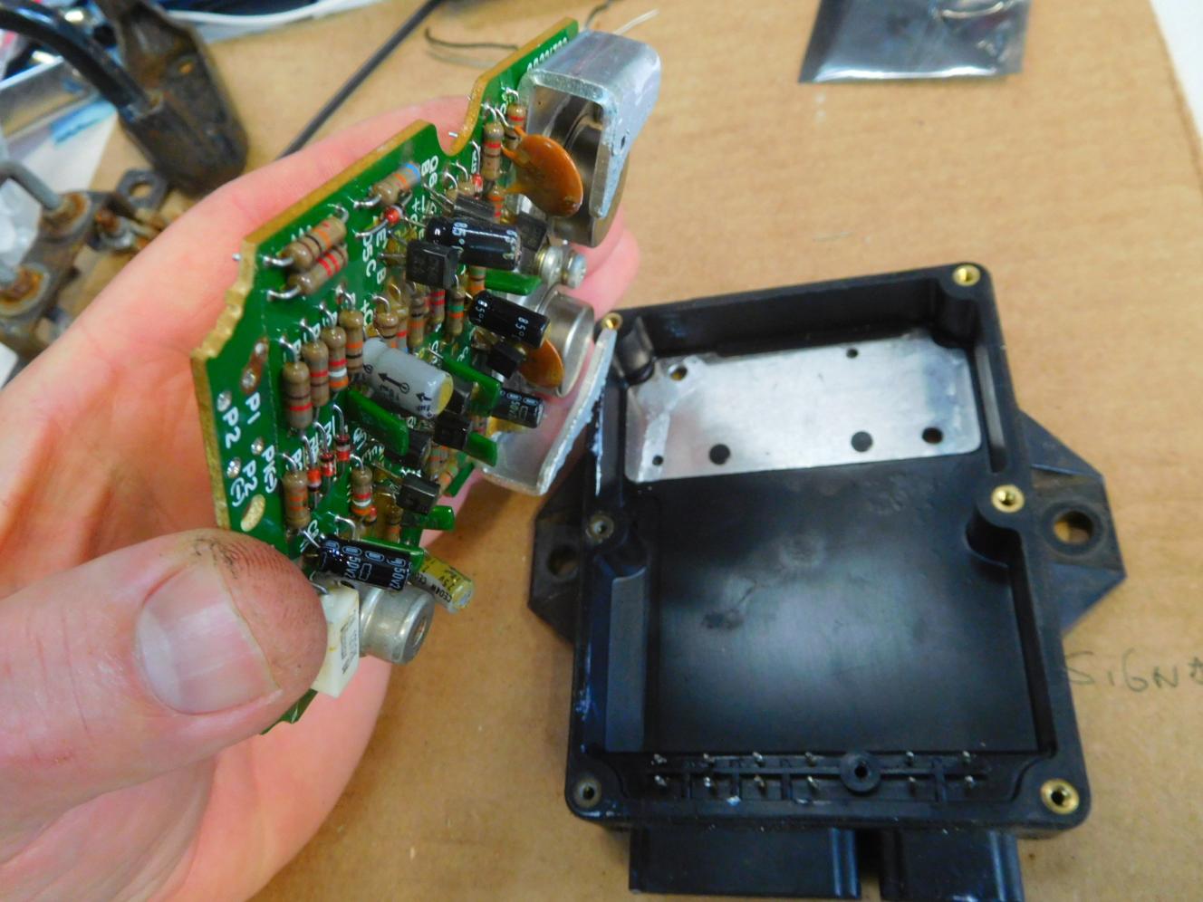

            The box can have problems as it used two large transistors to fire the coils. Send your old box back to me , and I'll look at it and see if I can repair it.

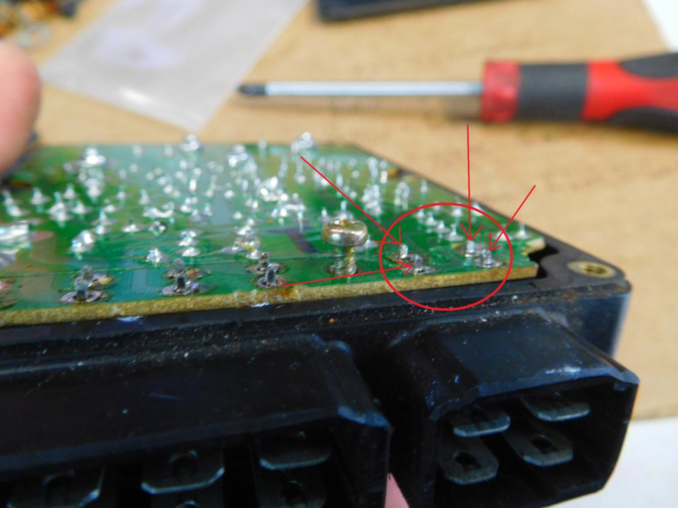

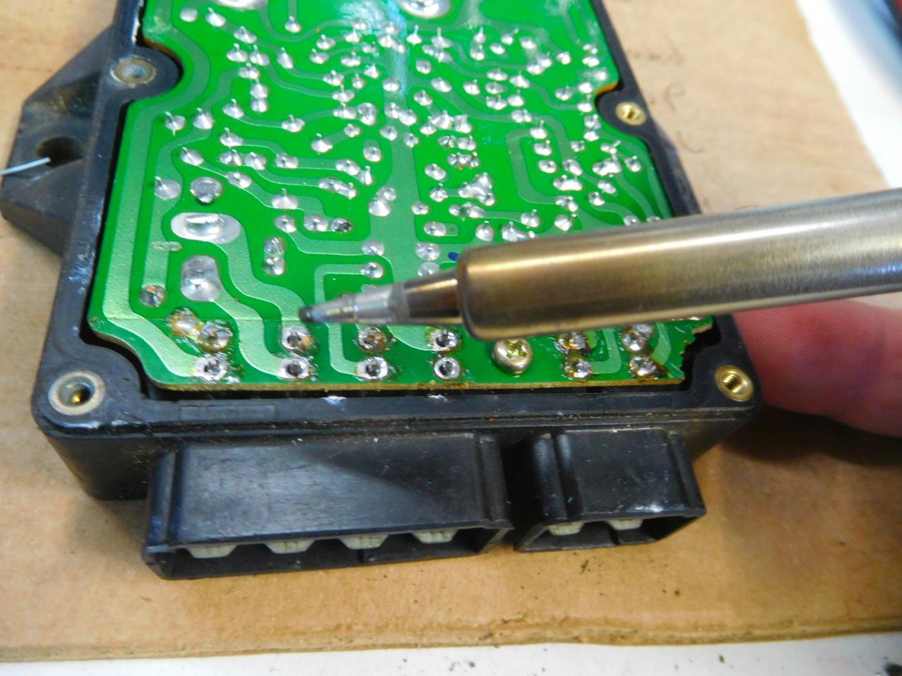

              #51
              Sometimes it's a cracked solder joint.

                #52
                Yep! I've fixed two boxes with that problem. Be careful about the solder you use! ALL the new solder is "tin" and it will cause problems. I still have old lead/tin solder that I use. It is available, but hard to find. Used for telecommunications and ANY space bound boards. Strait tin solder will "grow whiskers" in space and short out the boards. Yeah, I used to work in that kind of company...

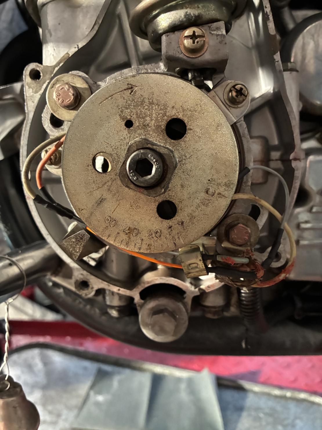

                  What do y'all think about this? These wires are known to break. The factory bends are tight. Maybe take the clamps out of the middle?

                    #54
                    Leave the clamp LOOSE so the wires can move just a bit. Yes, it could wear through the insulation after a while, but it would probably last a lot longer than the wires breaking again. That is how I fixed my '78 back in '78!, soldered the broken wire and loosened up the clamps. When I sold the bike years later it was still running great.
                      #55
                      Yes, the clamps are too tight at the factory. I loosened mine as well and used flexible RC car wire, solder, and small heat shrink tubing with internal adhesive.
                        #56
                        I got mine fixed. It looks OK? My motivation was replacement of the oil seal behind it.
