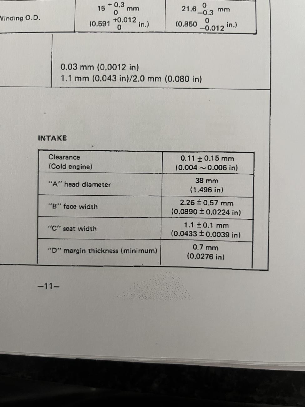

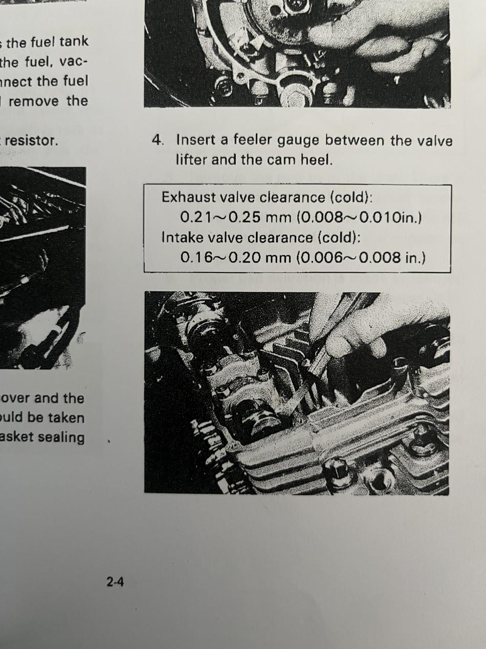

          GNEPIG I’m scratching my head now. I have a 1981 SH.
          Service manual says 0.006-0.008in
          but looking at the supplement section for H/SH says 0.004-0006in.
          Exhaust valve clearances are the same.

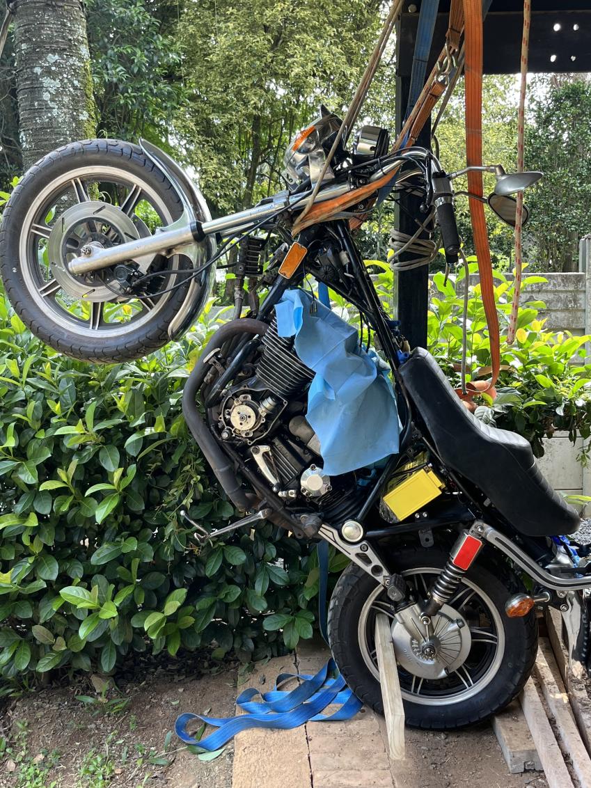

            Well I’ll be….. thanks LarryM 😁. CCT off and getting repaired.
            Noice! (◕‿◕)
            Just'a reminder....
            The CCT adjustment procedure set forth in the repair books/manuals gots the crankshaft/valves in an INTERNAL ROTATION position wut puts the maximum amount of chain slack at the front of the engine so's the CCT can whomp up against it (spring pressure...) during the adjustment. (O_O)
            Won't and wouldn't matter what EXTERNAL rotation or position the whole engine or bike was in so long as the CCT was installed. ( •_•)
            Cam chain wouldn't fall off any of the three sprockets or jump any teeth. (・‿・)
            But remove the CCT with the engine in an INTERNAL ROTATION position that puts that maximum amount of slack at the front of the motor whilst the motor itself is EXTERNALLY canted/angled FWD like it is when both tires are on level ground? (O_o)
            Slack chain falls down and mebbe enuf to jump a tooth or two at the crank? ( º﹃º )
            Cain't make gravity and chain physics NOT do wut they'd do in that situation. (-‸ ლ)
            Congrats on making them wurky WITH you instead of against you. (─‿─)

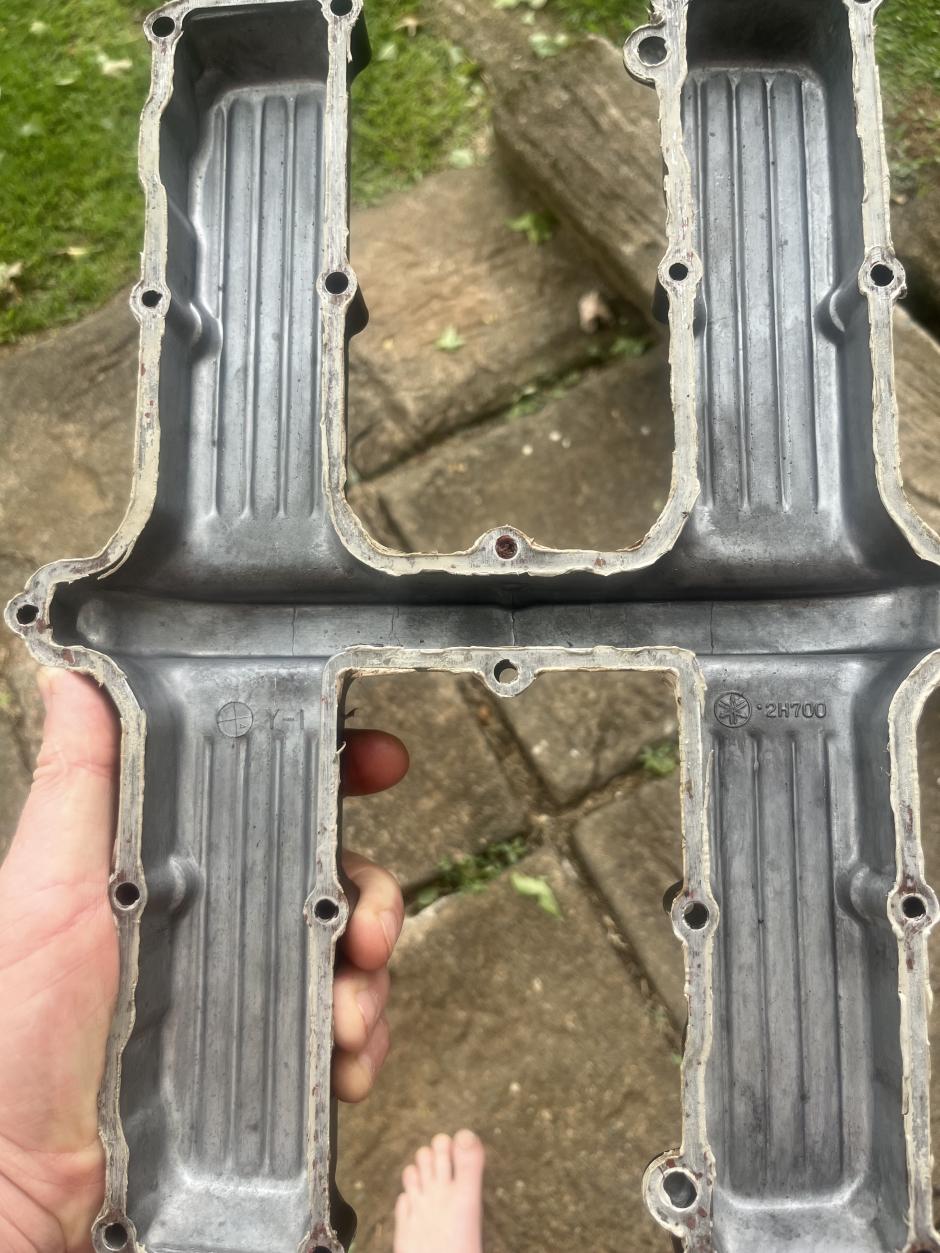

              Does your valve cover say YIKES on the top of it? Those must run hotter because of the emissions bull dookie= that's why the bigger valve clearance values. I remember the newer 1100s had lower cam profile and bigger vales also.
              • Appie
                • Nov 2024
                • 48
                • South Africa
                #37
                Unless I’m missing it, no YIKES, GNEPIG. Nothing on top and here’s the underside.
                It’s a 1981 European SH.

                  Intake clearance is 0.004 to 0.006" cold. Exhaust is 0.008 to 0.0098" cold.
                    • 8930
                    #39
                    The nice thing about using thou inch measurements is each shim size varies by .002", making calculating sooo much easier, JMHO.
