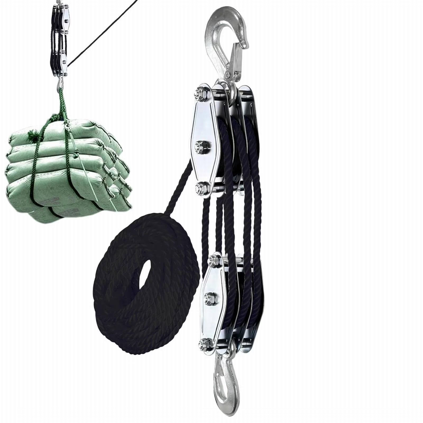

                            "so hesitant to put the bike in wheelie position by myself as LarryM suggests…."
                            Tow straps at the Triple Tree/Handlebars.
                            Sturdy overhead beam in the garage.
                            It's a one-man job if you gots/get wut is needed. (O_o)
                            Walmart Clearance 2024!1 Pack - Universal Wheel,Rope Hoist Block And Tackle 2200 Lbs Breaking Strength Pulley Block 1100lb Loading Capacity For Animal Husbandry Constructions by Niaviben" is only $25.69 when ordered online.
                            I paid way MoAR for what I gots.... ( ⚆ _ ⚆ )
