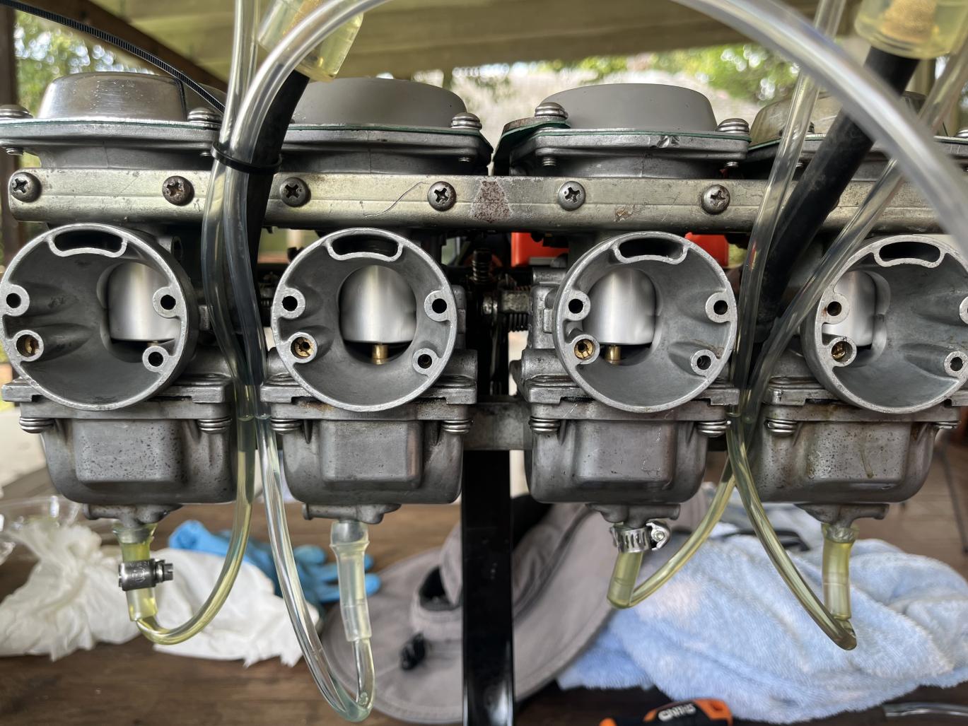

ID:	886390 Good day gents
    I’m busy with an ‘81 Special (89000km) which I am slowly working on.
    Ive finally got to starting it and having problems with idling
    1. Starts immediately on full choke but after 30-60 sec, idle goes waaay up.
    2. Half choke idling comes down but then also increases as the bike warms up
    3. Off choke it bogs down and dies unless I fiddle with the choke again.
    4. I managed a short ride, it manages a slow throttle increase but doesn’t idle without a little throttle.
    5. Towards the end of the ride (2km), was increasing revs in between gearshifts.

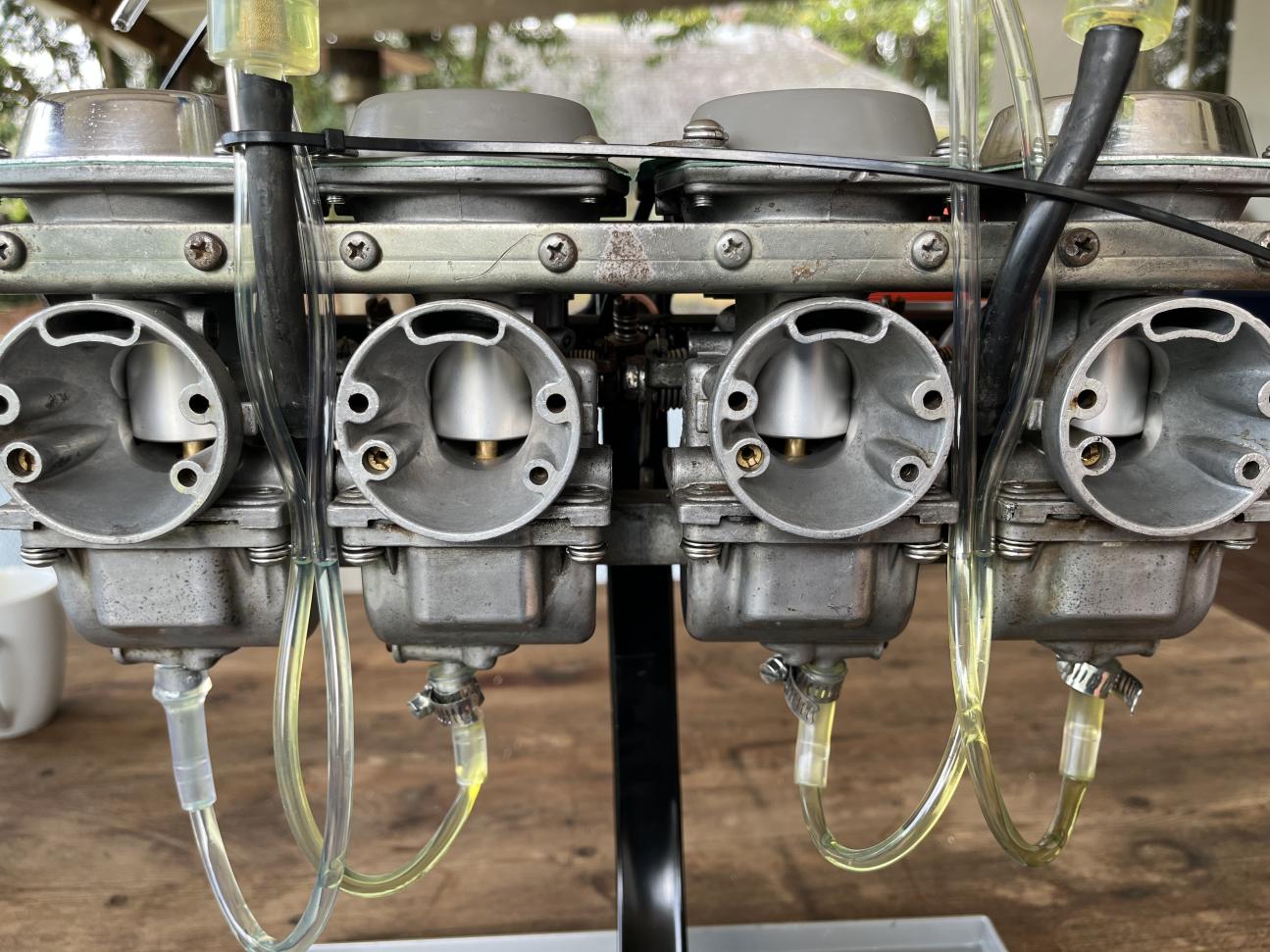

    I have had the carbs off to clean and fix a stuck needle float and have set the chamber fuel level as shown in the picture. I did have to set the floats lower than they were to get the fuel height correct….

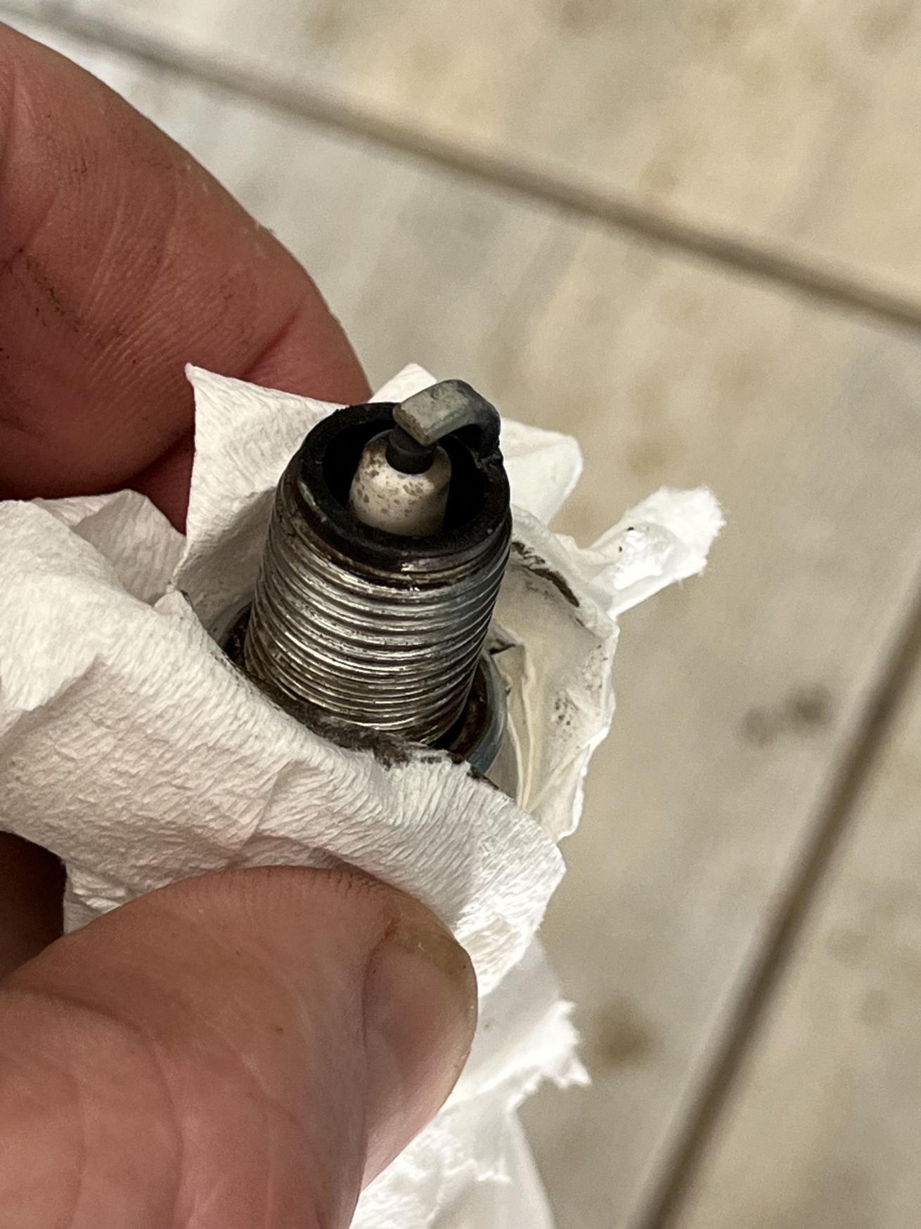

    New plugs and I’ve attached a picture one after this short ride.
    Im Wondering if I’ve set the floats too low and it’s running lean? But I can’t explain the runaway choke.
    Ill take the carbs off again but wondered if you legends could weigh in before I do so.
    I have checked the fuel lines and filters and have good fuel supply to the carbs. At least there’s no float leak so I can scratch one thing off the list 😂

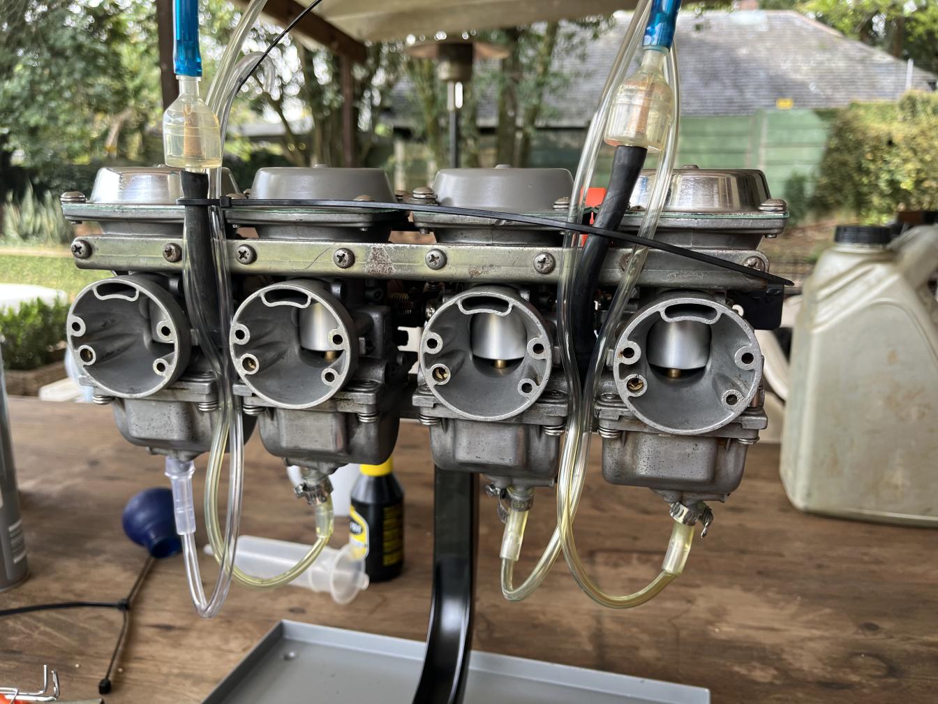

    Sorry for the duplicated post. I’ve attached another carb pic showing the float level properly Click image for larger version

            Ok an update…
            Deebs I did bench sync the carbs (thanks Crazy Steve, LarryM), all four carbs have the butterfly splitting the front hole in the upper carb throat.
            I pulled the carbs and rechecked and all butterflys are equal and seem correctly positioned.
            I did notice that in the upside down position my floats were all higher than the 25mm service manual measurement. I adjusted them all closer to spec and checked the float levels with the bowls back on….which are all about equal but higher now than before.
            Put the carbs back on and she started right up on full then half choke. Off choke she rides beautifully, still a bit sluggish if I open the throttle too quickly but much better, way better than before. No rev jumps during gear changes, no having to mother the throttle the whole time. She still dies in neutral when I leave the throttle but I haven’t adjusted the idle screw at all yet. It’s fully screwed out.
            So, I’ve never ridden this bike before today and I felt a little of the magic you all describe! I didn’t ride for long, just wanted to check it was running before I tackle valve clearances/camchain tension/ vacuum sync.
            I’m left with the discrepancy between float height ( now correct) and fuel level which is less than the 3mm below the mixing chamber body edge.

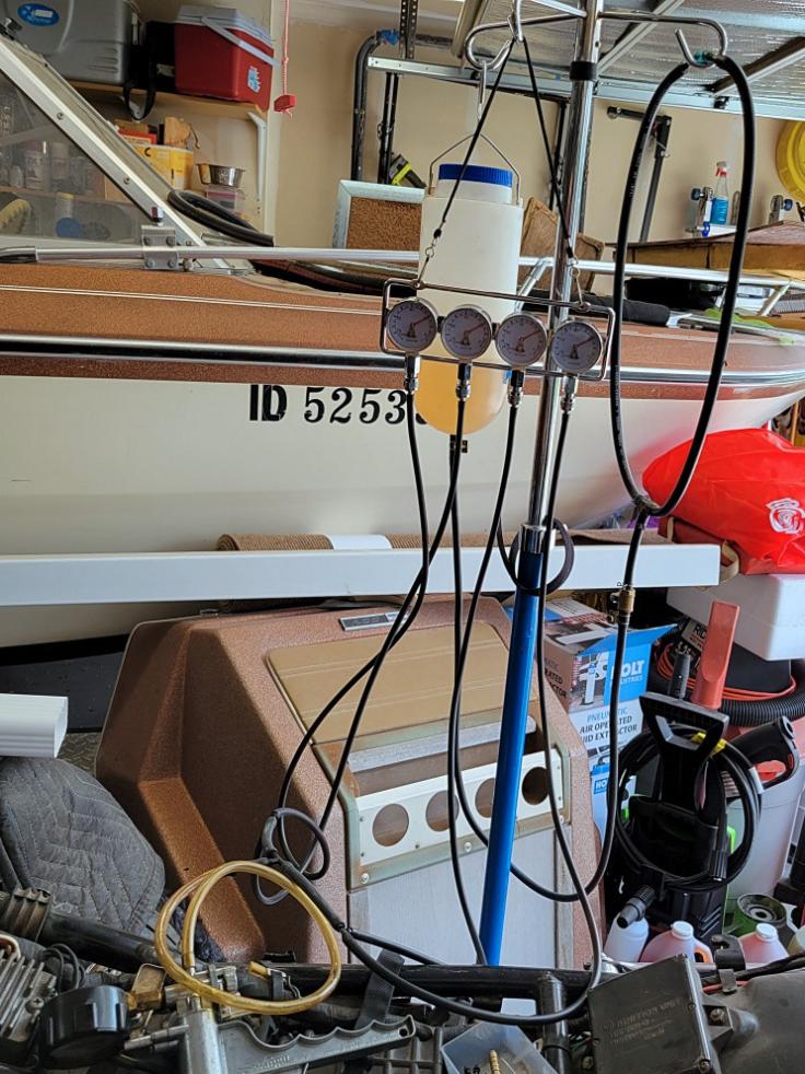

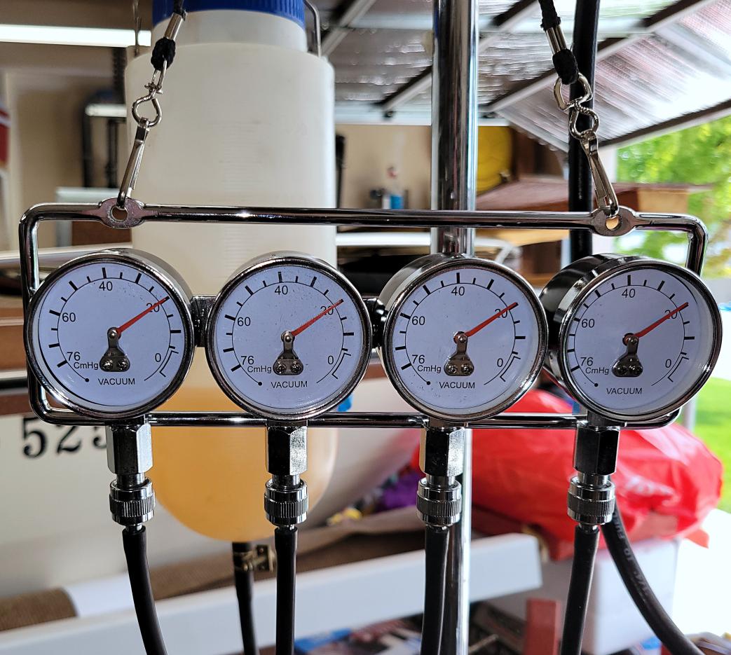

              Yes, SYNC THE CARBS! You MUST re-sync carbs every time you remove them. I use a set of four gauges to sync my '79 Special. I also set the four gauges to the same reading using a hand pump to draw vacuum. Three "T" fittings connect the 4 together.
              The only other cause may be a vacuum leak someplace. Starting with carbs synced, AFTER checking the valve lash, is what I do on any "unknown" engine.

                  Be advised Appie, a bench sync is not a vacuum sync. You are guaranteed out of calibration. You can't proceed until you perform this correctly.

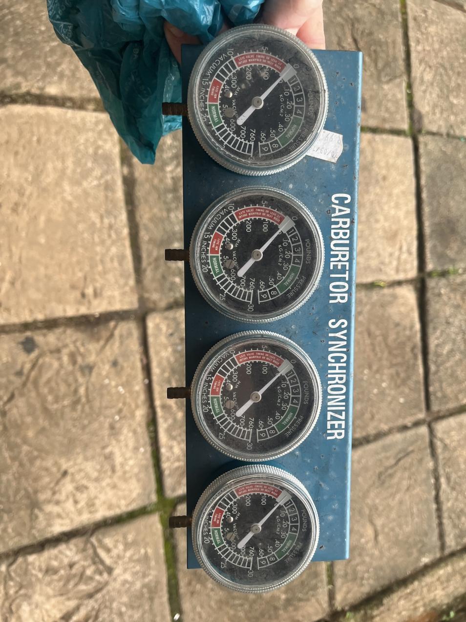

                    Deebs, I got my hands on these gauges. To confirm, do I check valve clearance THEN vacuum sync? Thanks for all the help - very tempting to open the cam cover and see what lies beneath. The cam cover bolts are not all original so somebody has been in there before but I doubt the valves have been checked in a long time.
                      Yes, as Ray stated, first valve lash, then sync. Should run much better after calibration.
                        And don't forget to put all four gauges on one vacuum line to verify hey read the same! There should be an adjustment screw that you may need to turn one way or another, but in VERY SMALL increments to do this.

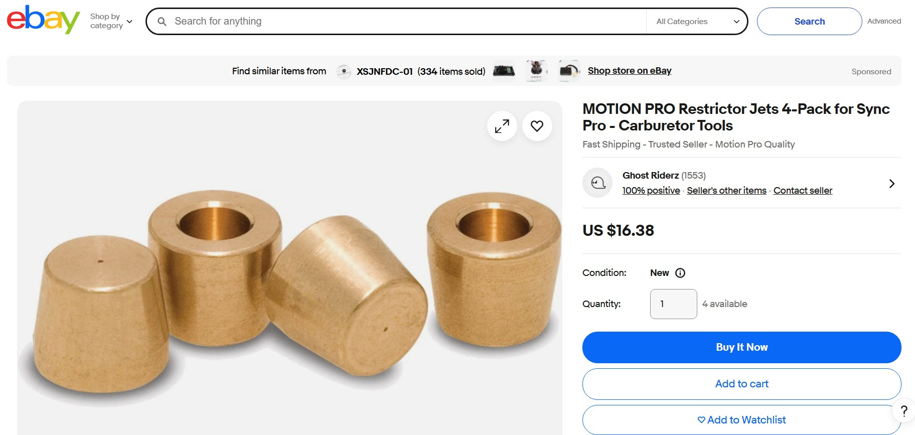

                          You will probably have to use restrictors with those to control fluctuation.
                            • Appie
                              • Nov 2024
                              • 48
                              • South Africa
                              Thanks guys for the advice and help. Where in the circuit do the restrictors sit? Sorry, feel it’s a silly question.
