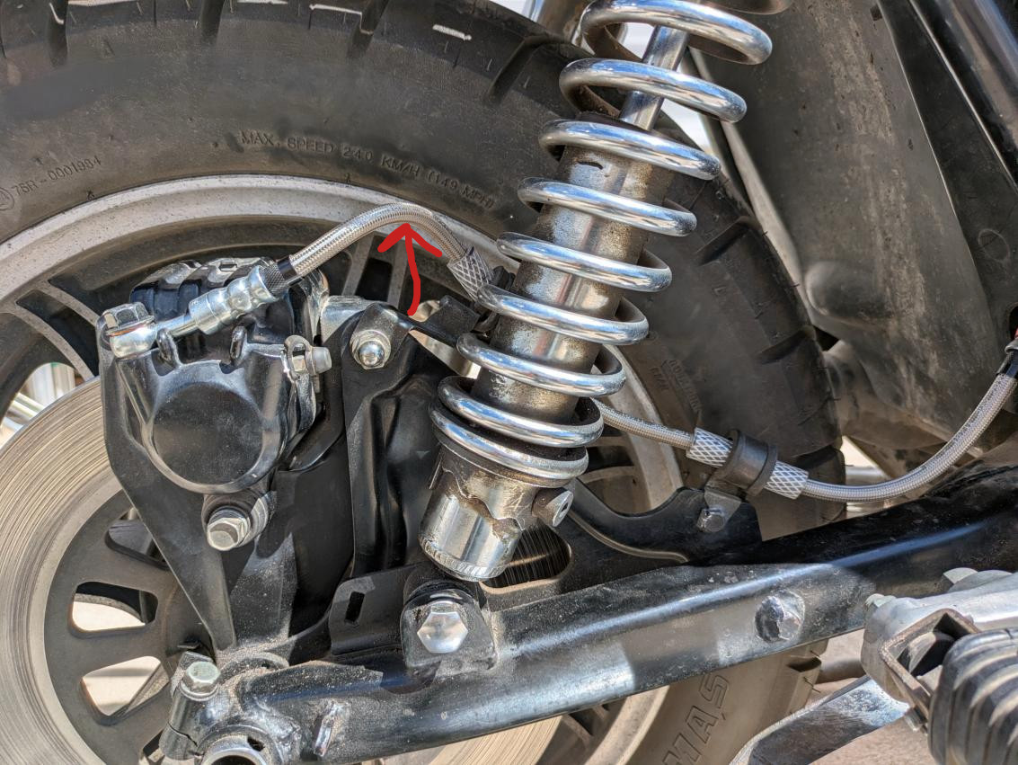

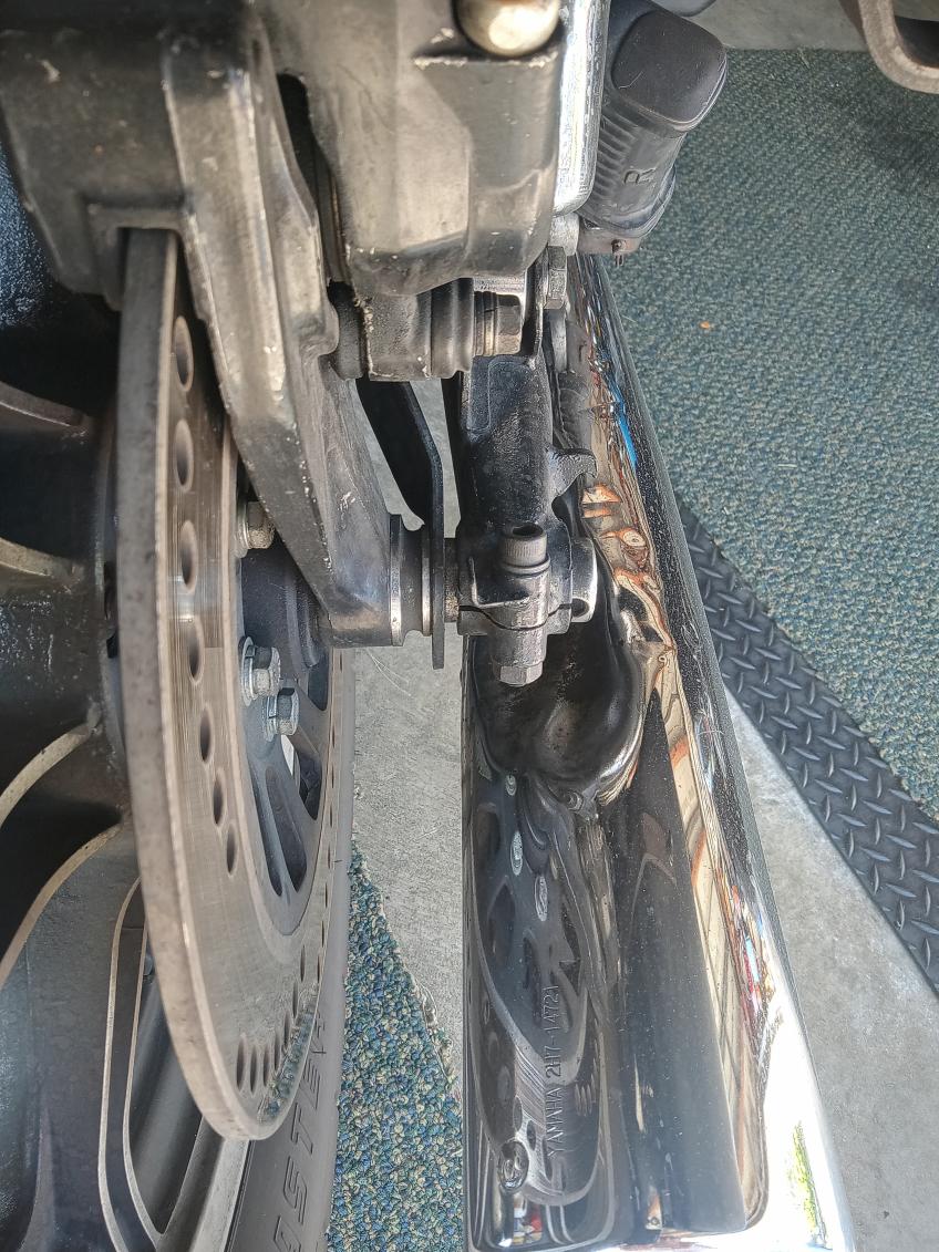

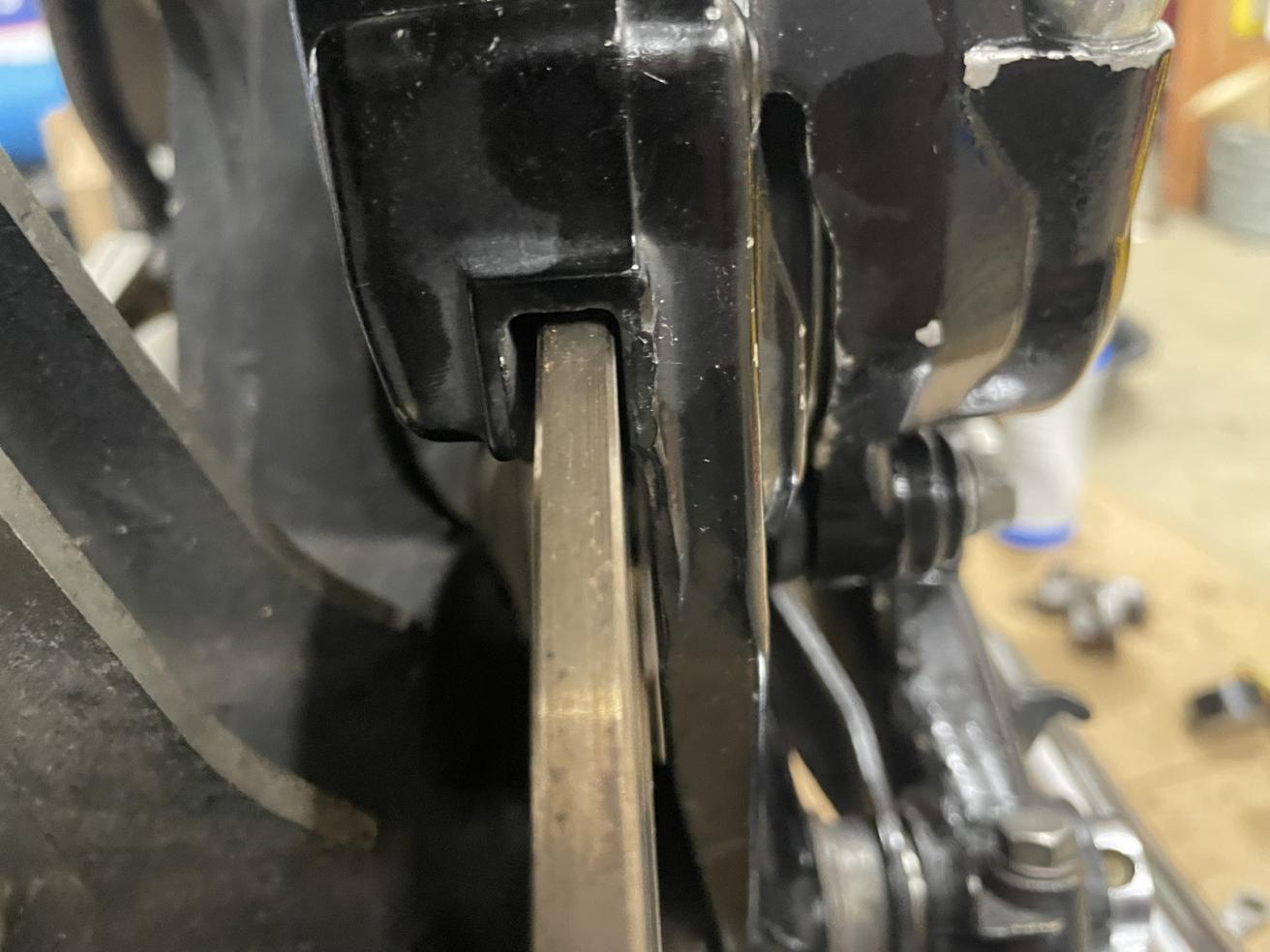

    Hi all,
    I'm looking for a gut check as my rear brake woes seem to continue. Does the spacing and setup of my rear caliper bracket relative to the rotor, as well as the setup of all the rear axle components in terms of spacers look to be correct? It seems like the rotor gets notably closer to the right edge of the caliper bracket when I tighten the rear axle nut, even following all the directions as far as tightening it first and only then tightening the 12mm pinch bolt on the RH side. It feels to me like there is brake drag that shows up when I tighten the axle nut. With it loose and the axle "floating" the wheel definitely spins freer.
    As far as the rear brake itself goes, I've got a fresh K&L master cylinder piston kit in my original M/C currently, brand new braided lines, a freshly rebuilt rear caliper with brand new SS piston and seals from brakecrafters. Bleeding the thing properly is still proving to be an absolute bear. I've got brake pressure but with long pedal travel. My suspicion is that I can't adjust the pedal travel rod very much at all, possibly due to the fact that I may(?) have this caliper alignment issue.
    Any thoughts/suggestions/photos of what a "correct" setup looks like are welcome!

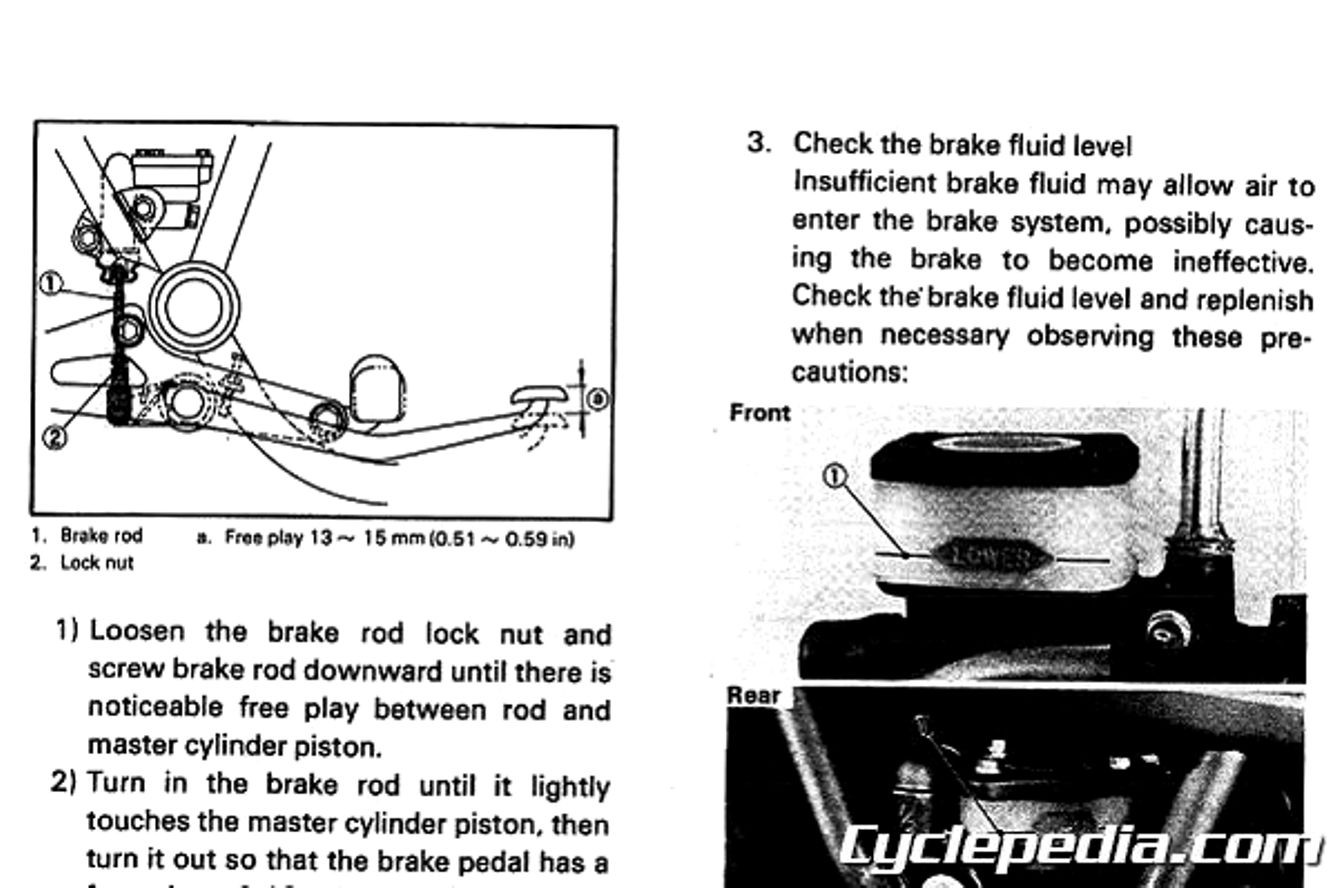

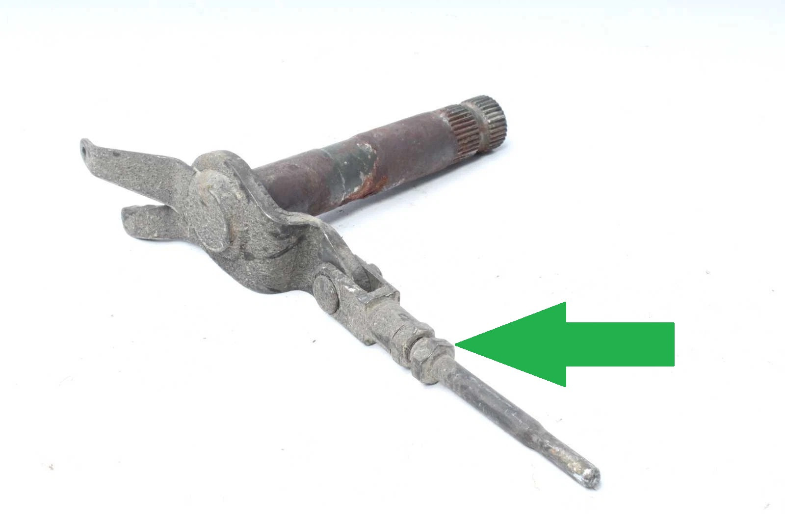

    Looks like the XS11 Standard collars. They look ok. The slide needs to be lubricated and free to move to be able to self center the caliper. The pedal should also be looked at for adjustment.

        Yep the slide pin is well lubed, and I've been fiddling with the travel adjuster to make sure I'm not applying pressure to the M/C causing drag when the pedal isn't depressed. I swear I've never ever had this much trouble with a brake before in my life!

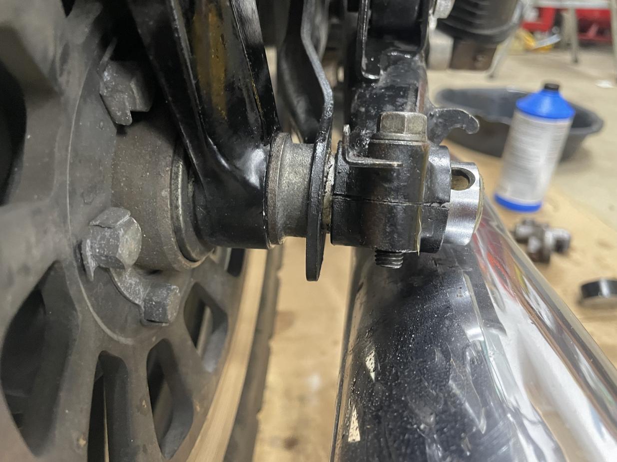

          Yep, looks like you have the spacers correct for the Standard model with the 17" wheel....
            There's actually very LITTLE room/space between the rotor and the brake pads whens the caliper releases after pressure is removed. ( •_•)
            On my own bike spinning the rear wheel freely while on the center stand BEFORE a ride doesn't spin PERFECTLY "free" and sometimes makes that noise indicating the pads/rotor are slightly and l i g h t l y making contact. (;☉_☉)
            After the ride? (O_o)
            Silence and smooth.... as during the ride everything wurky'ed back-n-forth and centered properly. (づ ◕‿◕ )
            Just sayin'... there's a true difference between genuine brake drag (BAD) and what's coonsidered as nurmal operation. ヽ(~~~ )ノ

              What about the spacer on the outside of the left side wheel bearing, is it in place? I know once I forgot to put it in, and the wheel would start to bind when tightening the axle nut.

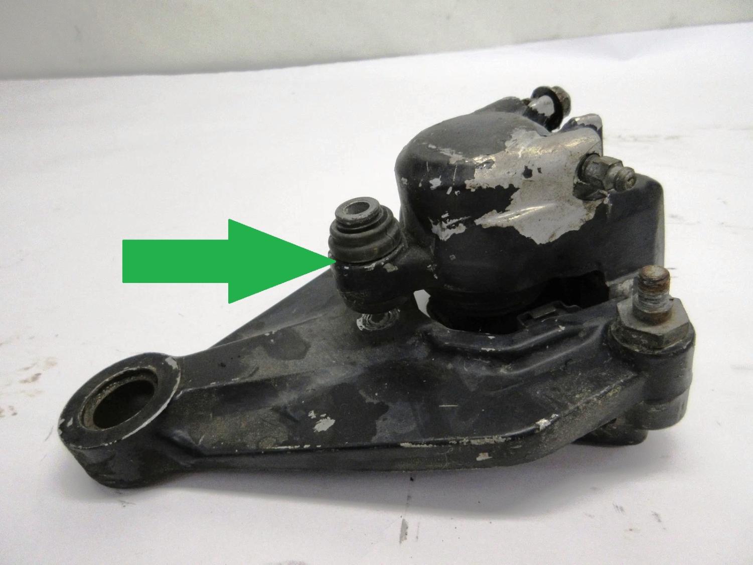

              Another thing to check is that the tip of the small screw on the inboard side of the caliper fits cleanly into the hole on the inboard brake pad. Sometimes that screw has been replaced and doesn't have a tapered tip like it should, or the hole on the pad is too small and requires drilling out. Otherwise, the pad can be forced at an angle and cause a binding issue.
                I'll double check the LH wheel bearing spacer, and that's a good point on that brake pad screw, I'll recheck that as well. Thanks for all the helpful suggestions!
