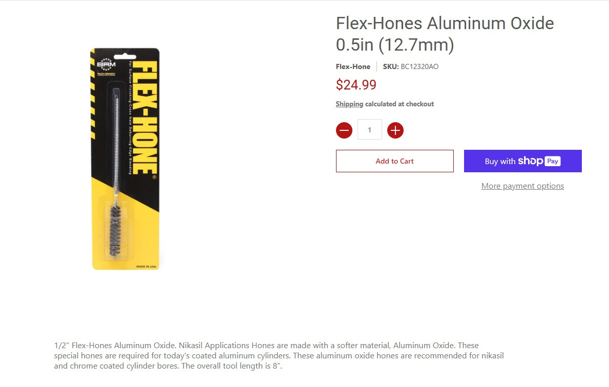

    You may be able to fine a hone tool at the auto parts store. A lot of the "imports" use the smaller bore and someone may have the hone for it.
      It can't be silica. It has to be aluminum oxide or you will ruin the bore.
      https://www.ebay.com/itm/234292184532

            I ended up buying the 1/2" Al-oxide ball hone as suggested, I think it worked great. Reassembled and bled everything. Have not seen any leakage from the master cylinder. Have been riding the bike to work. I'll say there's still a *bit* more drag than I'd say is ideal, the rear rotor still gets hotter than the fronts, but as I've been riding it it's been getting better it seems. The wheel spins fairly well (almost a full rotation when I give it a good spin by hand). I think the remaining culprits are a) the new piston seal is just a hair thicker than an OE, my local vintage bike friend (from messing with GS Suzukis) said he had this issue with new aftermarket seals before. His solution was to take some emery cloth to the ID of the new seal. Additionally, I think my rear rotor *is* a hair warped from when the rotor got really hot when this whole issue initially started with the sticking caliper. I think I'm just going to let it ride, and the seal will hopefully continue to wear itself in.

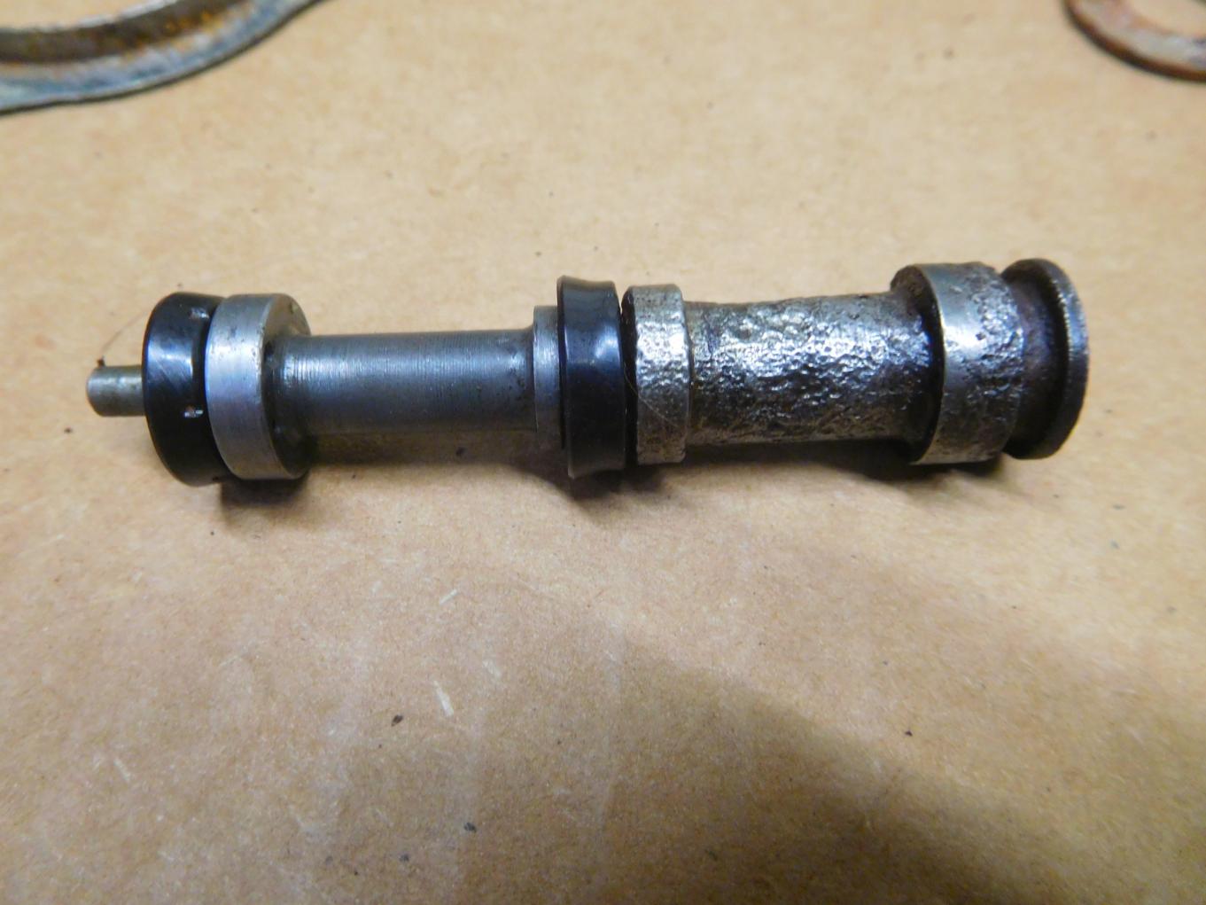

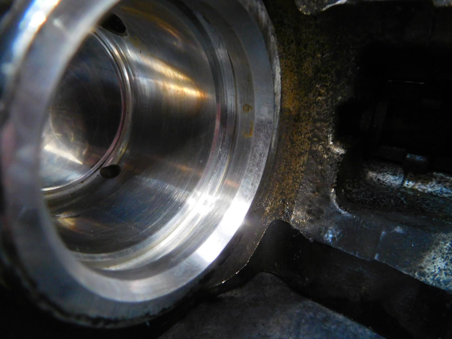

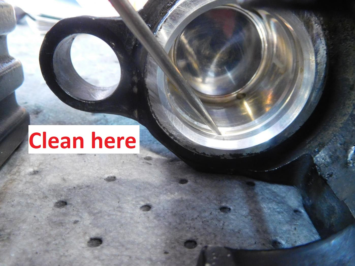

              Ya gtem, the fact that your buddy suggested abrading a rubber seal shows that it's time for him to stop wrenching. He is now an official hack. Aside from that, if you were to remove a slight amount of material, it would be from the aluminum seat where the seal rests. That is the area that builds up aluminum oxide and makes the seal grab and squeeze the piston. Just like I pictured here:

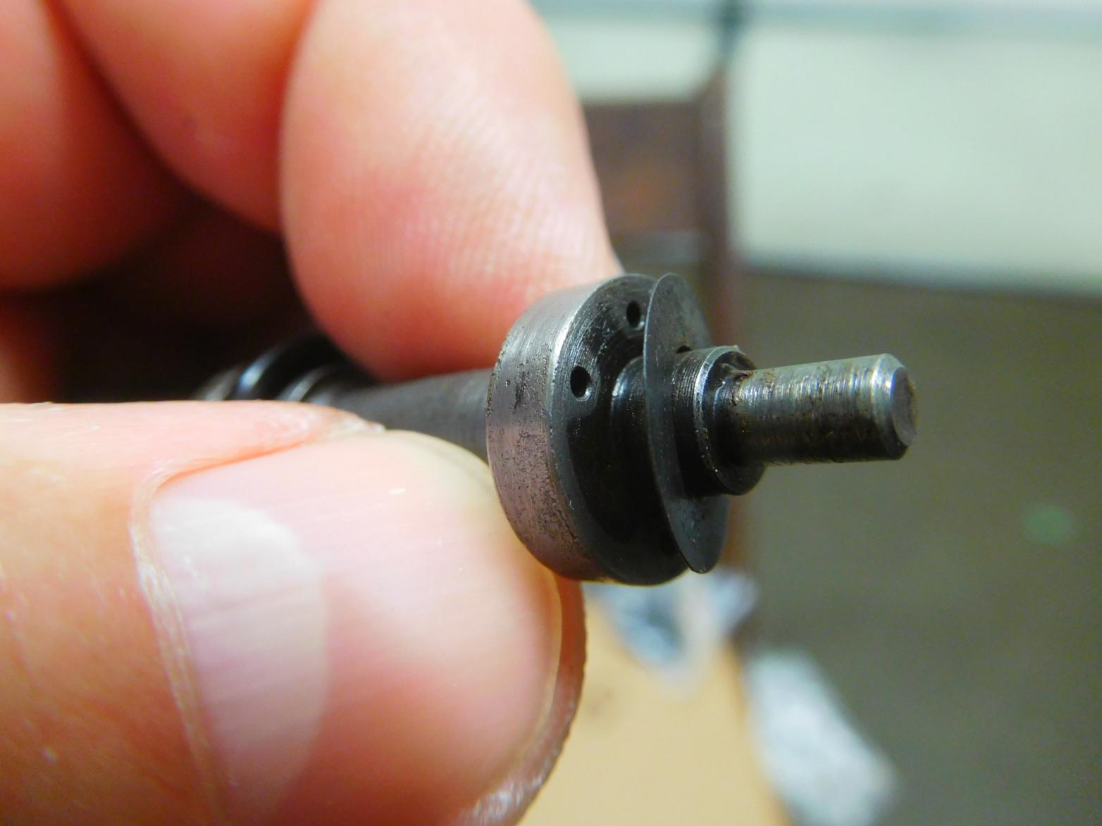

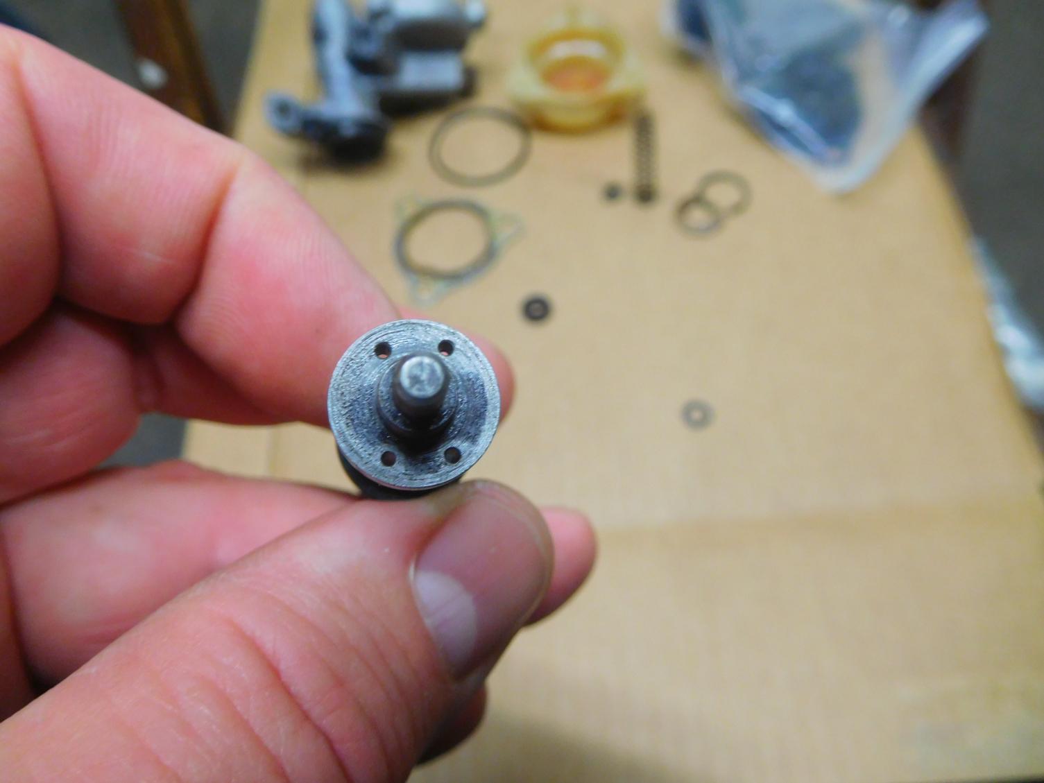

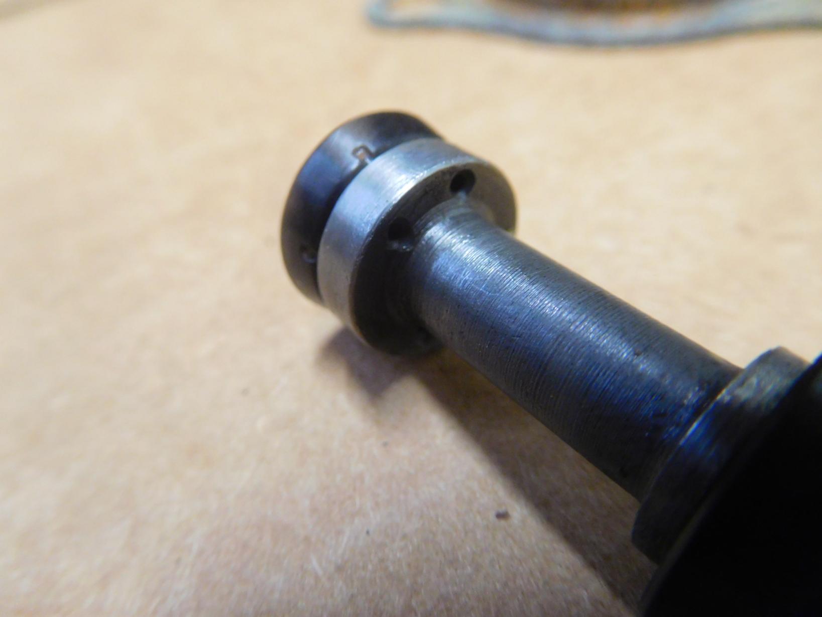

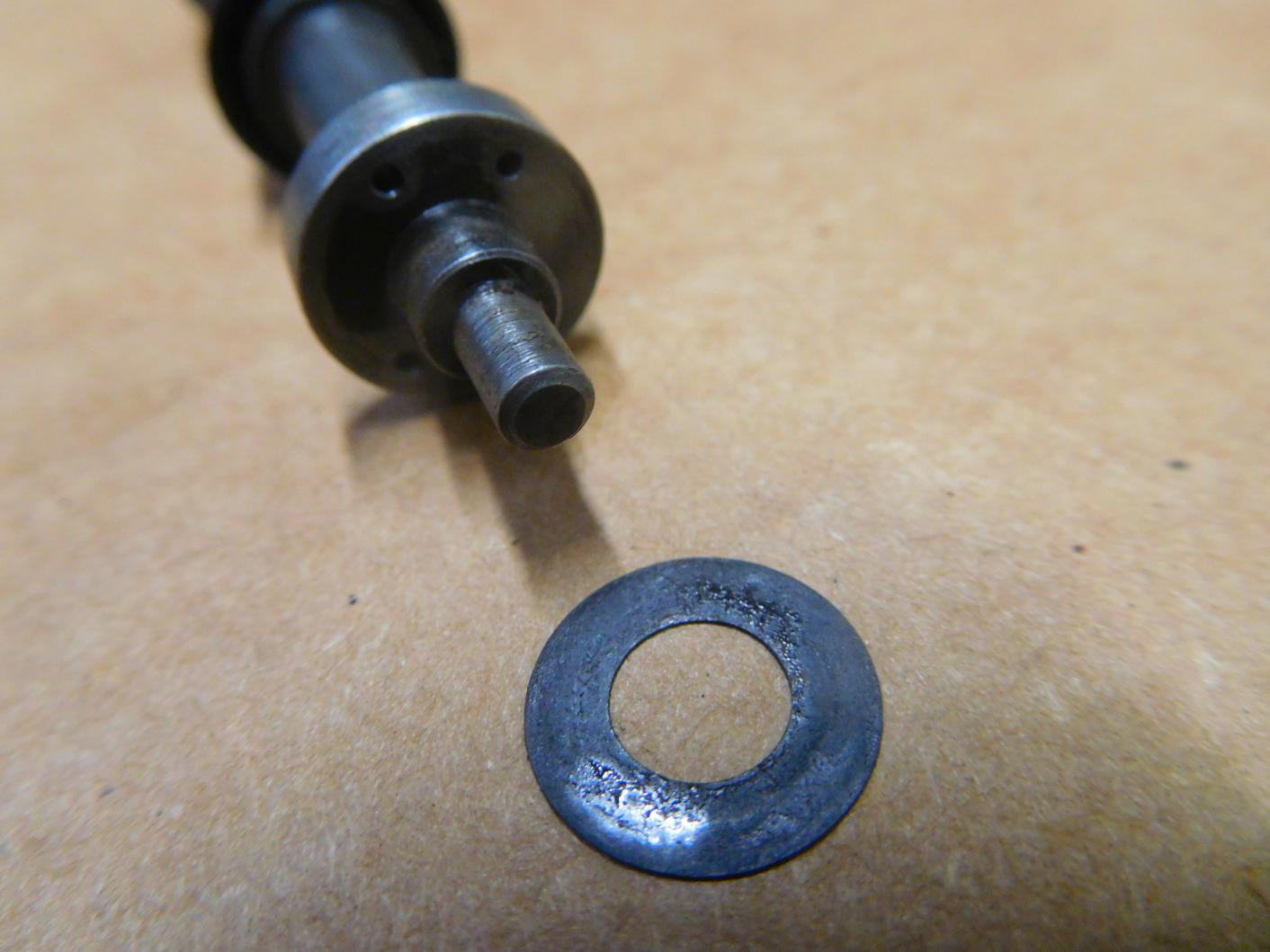

                        This is the check valve found in every master cylinder. It insures the fluid only flows in one direction. Out to the caliper. Fluid can be forced past it and I have done it in the past but it can cause problems. Afterwards you must bleed towards the caliper to remove any pressure that has built up behind the caliper piston.
                        As you can see, the holes are very tiny and the check valve washer is very thin. If you are cleaning, this is always gunked up. It is often overlooked.

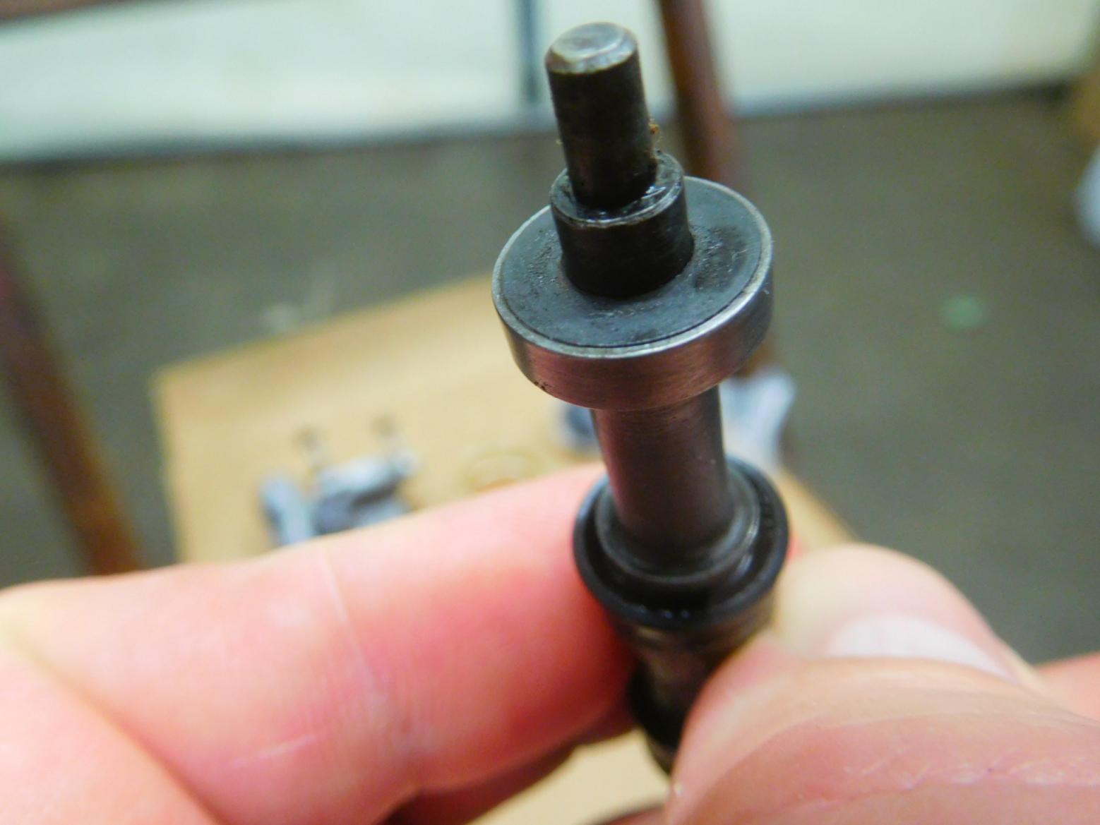

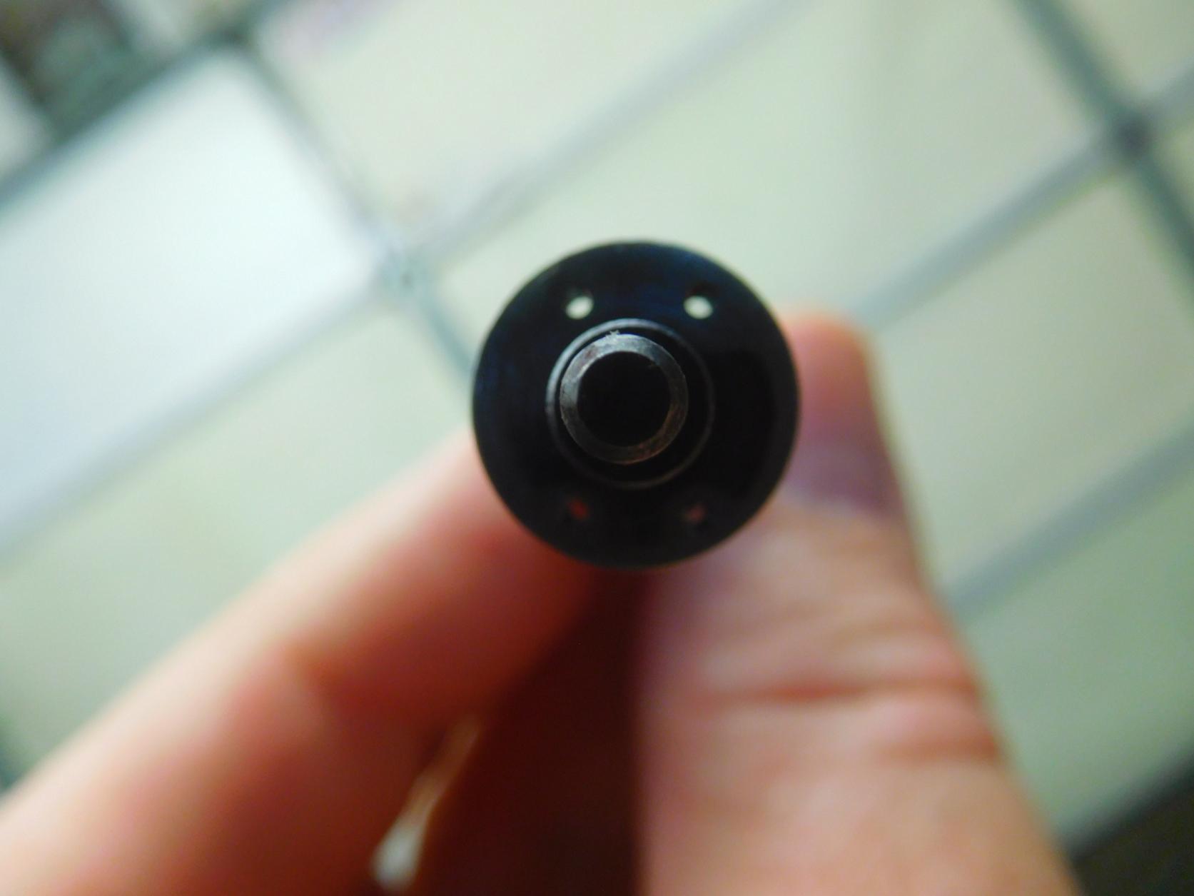

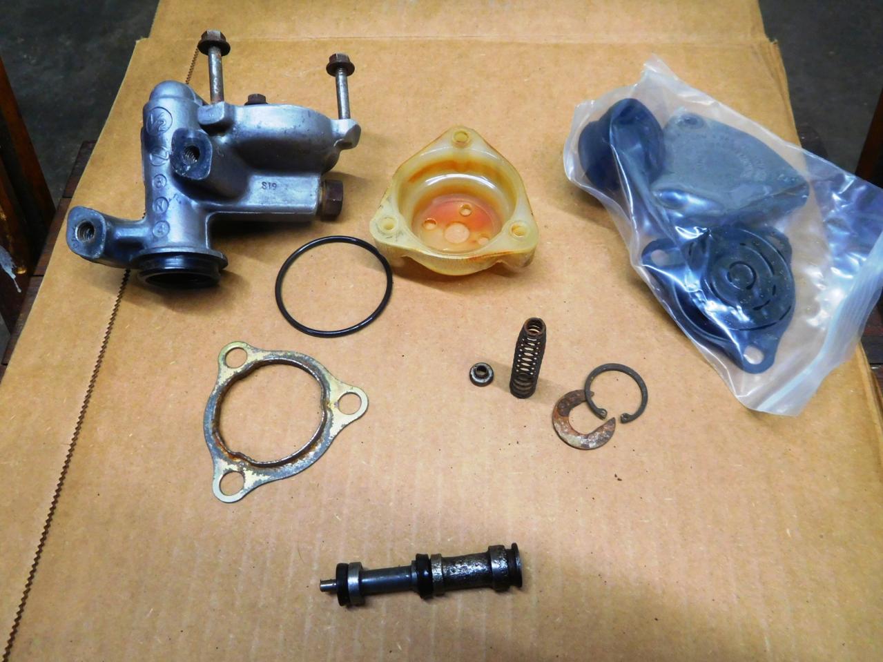

                          One-way check valve.
