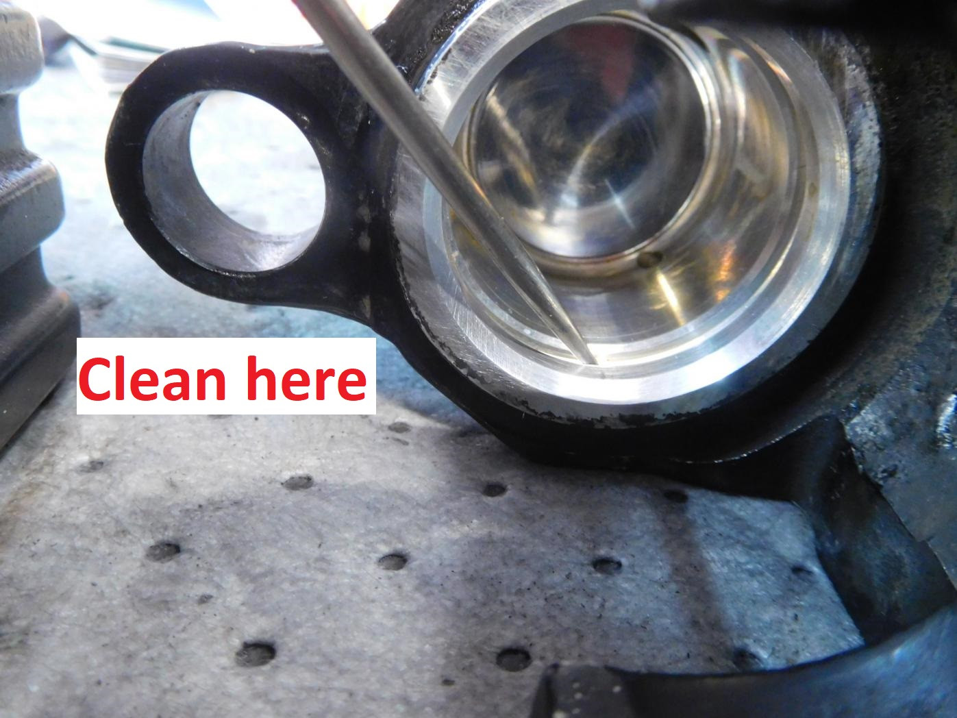

              The grooves in the piston where the rubber ring rides could be fouled, or did I miss the part where you cleaned that?
                It's a brand new stainless steel piston, new seal.

                  The groves are in the caliper. If you did NOT scrape and clean the grove, that is probably your problem. I took a cheap, small, flat blade screw driver and bent it in a vice. I then filed the blade for a perfect fit of the grove, just to clean out the groves.
                    Sorry that's what I meant to say, the caliper groove that holds that main piston seal, has been cleaned out.

                                I'm going to try swapping one of the front rotors with the rear to see if the problem follows the rotor (hopefully my front rotors aren't also warped?) And I will take another look in that caliper groove just to make double sure.
