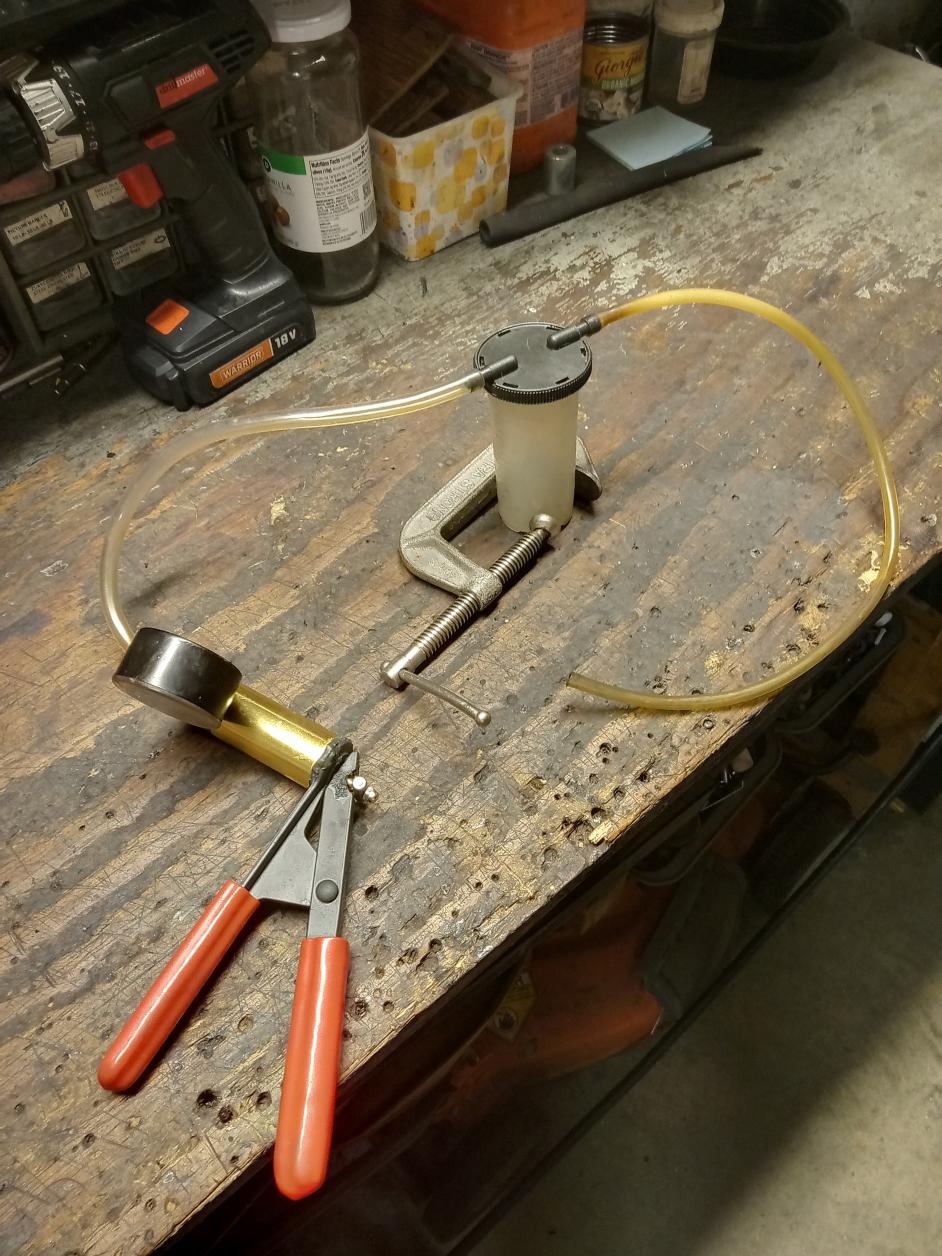

                Hack of the Day...
                To avoid sucking fluid into the vac gun, put the container in a C-clamp (tighten lightly) and it won't tip over.
                Click image for larger version  Name:	IMG_20250319_215409.jpg Views:	0 Size:	184.0 KB ID:	883887

                    Hack of the Day...

                        Hack of the Day...
                        Really a good idea Phil!

                          #57
                          Thanks, Sid. No more having to take the pump apart and clean it in the middle of a brake bleeding job.
