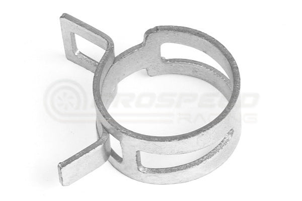

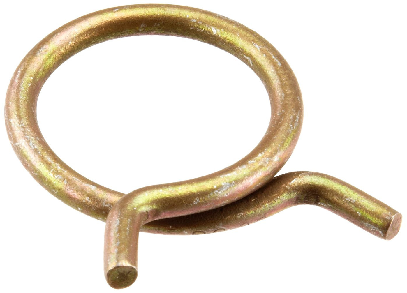

      There's plenty of alternatives to your worm gear type hose clamps, I've generally found these types at places that cater to small engine repair.

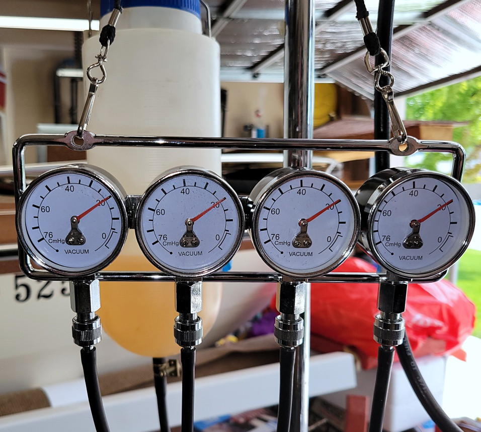

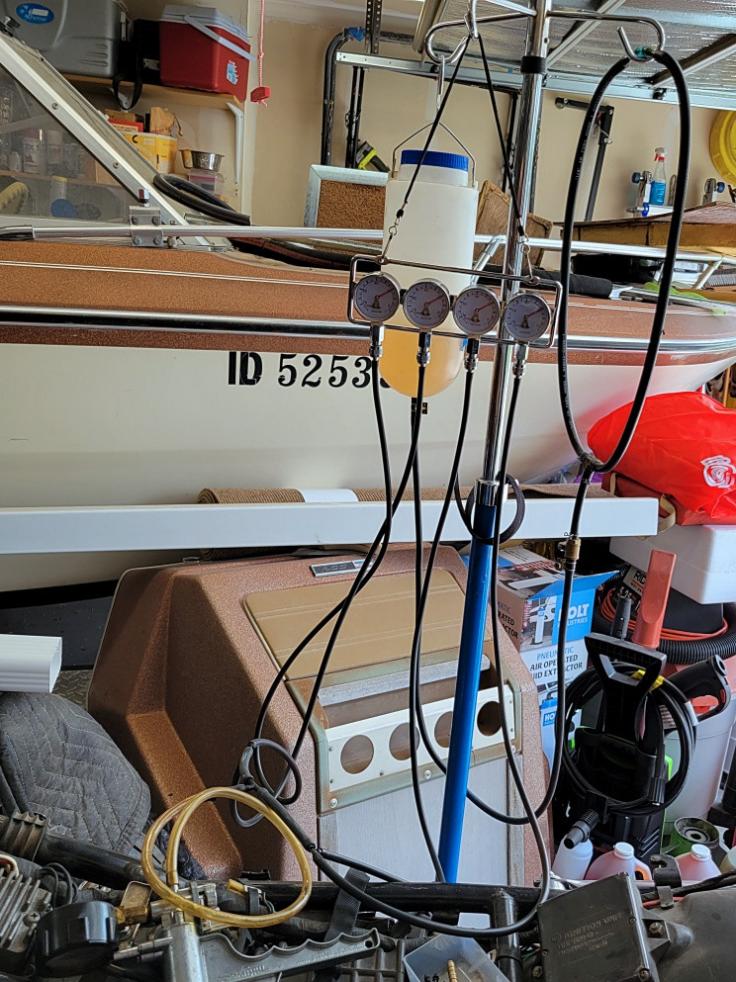

                    A set of 4 gauges is the way to go. BUT! you MUST make sure all 4 are reading the same before the sync. I have a vacuum hand pump I use with three 1/4" plastic "t"s made for irrigation. Hook all 4 meters together with the "t" and then pump to 20 on the gauge. There should be adjustments on each gauge so you can get all 4 exact. I do this every time I synd, just to make sure.
                    Photos show the 4 gauges connected to the hand pump, and how close they are. second photo shows my setup, and yes, that is an IV pole! Picked it up at a local auction for about $10.
