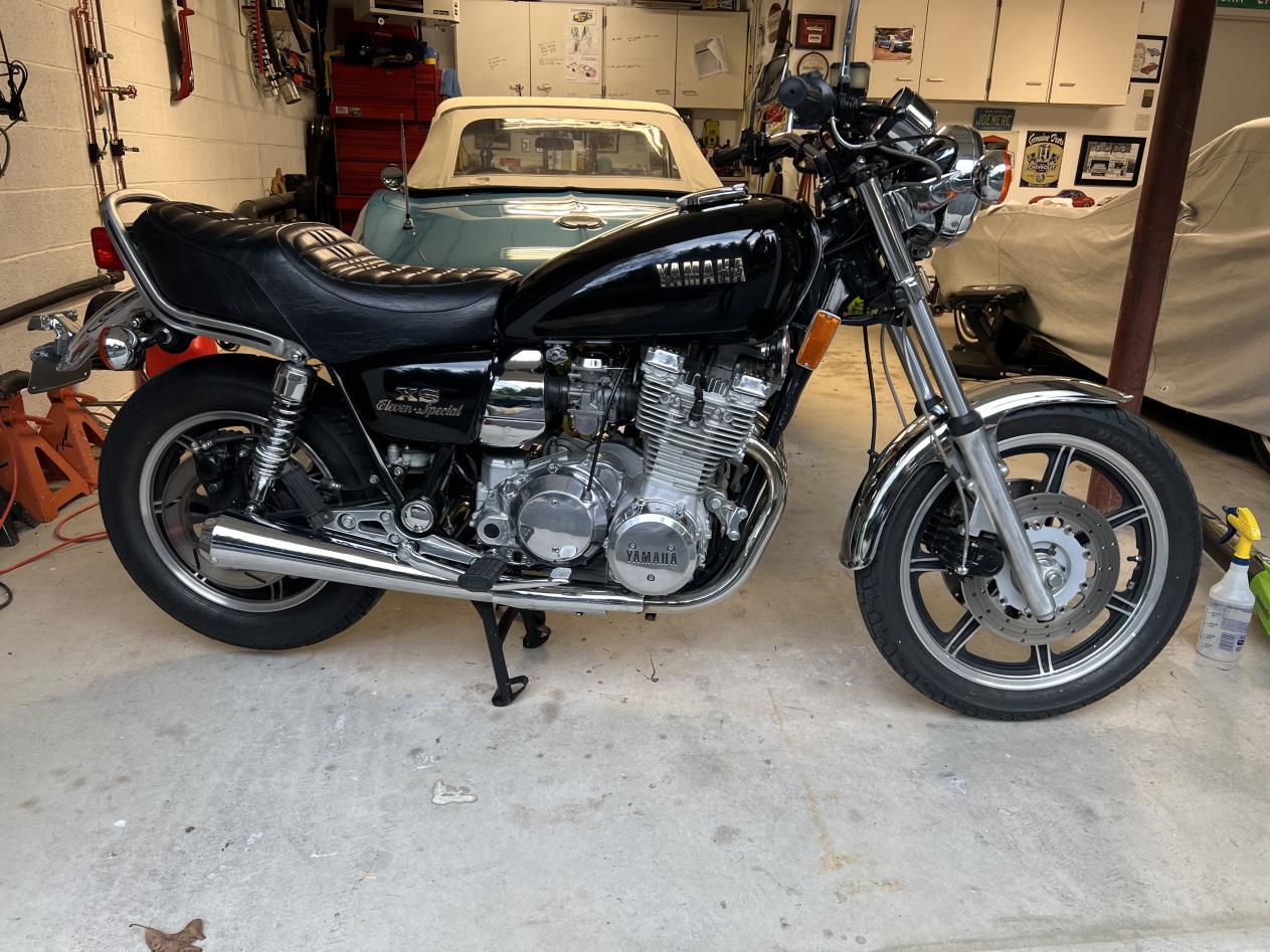

                          Strangely, I took the bike out for another test ride starting on prime, then after a short while, switched to run, I did get a little sputtering so I switched to prime and that cleared it up so back to run after a very short while and no further problem for the 10 or 12 miles I rode. Bike idles and runs great. Not sure why that would happen that way. I think I'll put a gauge on that port to see what vacuum reading I get.
                          Cases all polished up and ready to go. Last thing to do is pull the rear wheel & grease the shaft spline. Bike has less that 7k miles so don't expect any surprises.

                            So I have been using this bike only for short 20 miles or so trips with no problems. This past week I trailered the bike down to MD to do some riding with some friends. In 2 days we did around 300 miles. 2 problems surfaced. When I put the bike in the back of my pickup, I neglected to turn off the petcock when I shut it off. I realized this around an hour into the trip. Shut it off and continued. When I got to the point to transfer it into a trailer with the others, it started flooding white smoke coming out of the left pipe (unburnt fuel). **** it down immediately and fuel was coming from airbox. Pulled it and cleared it and it appeared to be the left outboard carb intake that was all wet. Oil was not overfilled and didn't smell. fired it up again, took for a spin, all is well. When we did our rides all was well for at least 90-100 miles. Stopped for lunch. afterwards, leaving to continue, I forgot to turn the petcocks back on and noticed it starving so quickly turned them on. pretty soon, sputtering and white smoke for the left pipe and gas leaking from airbox. quick shutdown, let the box drain. rapped on the carbs a few times with a tool to get the needle to seat and all was well for the rest of the 200 miles. Bike ran like a charm. I don't forget to shut off the petcock anymore but wondering if I can get the bowl off that carb to inspect without pulling them all? My suspicion is with the bike in motion, it doesn't allow the float to get stuck being jostled all the time.
                            ANyway, problem 2 was the forks seals leak a bit. I changed the oil over the winter and used the amount the manual recommend. Is it possible I overfilled?
                            Thanks for any help!

                              (1) I think you understand the finicky float problem in #1 carb. I don't think you can inspect it without removing the carbs.
                              (2) Maybe most of the fork oil had leaked out before you owned the bike. Then maybe you refilled it and now it leaks out? Regarding overfill, I see you measured how much oil to put back in. When you drained it, did you cycle the forks a few times to get our the trapped oil?
