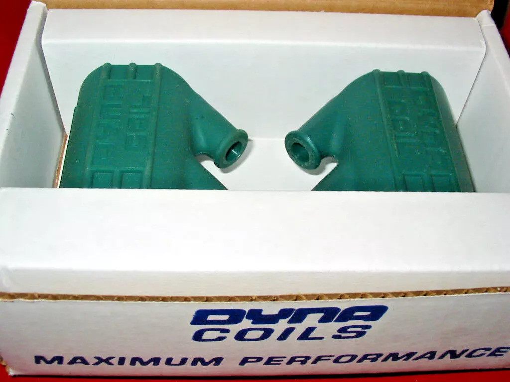

            If you are looking for high performance new, you can't beat Dyna coils. 3 ohm green for eliminating the ballast resistor. Beware of Chinese imitation coils that do not say DYNA on the side.
            https://www.ebay.com/itm/38069367064...Bk9SR7qBx4WxZA
                Went with a set of used late 80's Honda 750 coils on mine also 3ohm and eliminated the ballast resistor, my warm/hot starts are MUCH easier now! Kinda difficult to measure a ballast resistor while "hot" but my guess is the value changed as heat increased.
