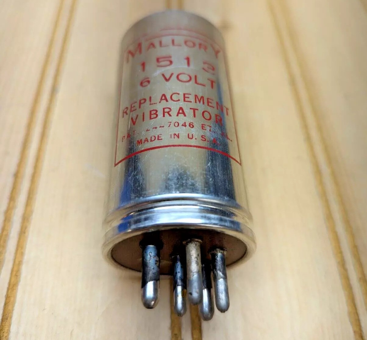

                        Here is one of the best kept electronic secrets in my arsenal. This is an old fashioned two-way radio oscillator or multi vibrator. 2 pins are positive and negative. 2 pins are in and out contacts. They work just like points. You could also use this to make quite the cattle prod also.
                        Positive to your coil and negative through the oscillator and to the negative of the coil. Don't electrocute yourself with this. It's quite easy.
