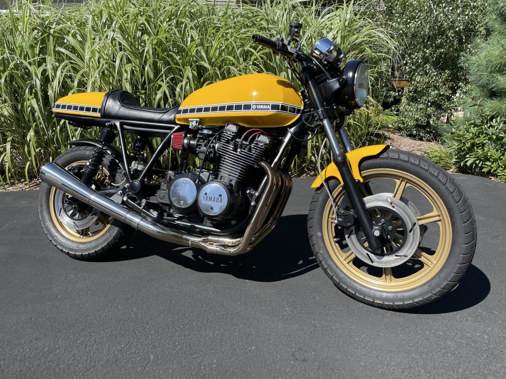

    Click image for larger version  Name:	IMG_6431.jpeg Views:	0 Size:	207.5 KB ID:	881308 After some great help from those of you on this forum, I was able to take the bike out on a maiden voyage last weekend. I thought I would post a pic also. Now you purists on here should know that this bike was a near basket case to start and would have unlikely ever have seen the road again.
    now that she’s running it’s time to tune. Now reading a lot of other posts on this forum I have learned that there are different versions of these carbs as well as jetting. Since I have painted the carbs black, I don’t know which particular version I have, but they are not the version with the connected main and pilot circuit. I have been meticulous in cleaning every port, nook, and cranny. Removed all the removable bits, jets, idle screw, etc. someone at some point have been inside these carbs before. The pilot jets are marked 42.5, main jets are stamped with a “120” and no markings on the needles, leading me to be mistrustfull of these pieces. Also of curiosity is the pilot air jets are marked “190”. So as I begin this journey of the tuning phase beginning with carb syncing and idle mixture adjustments, do I bite the bullet and replace all suspect components (needles are hard to find) or address tuning issues as I work thru idle to WOT?

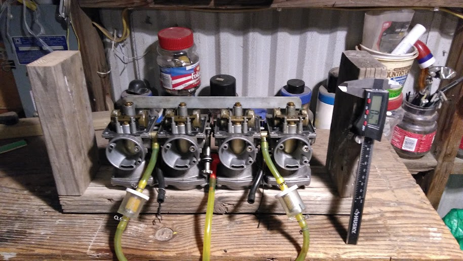

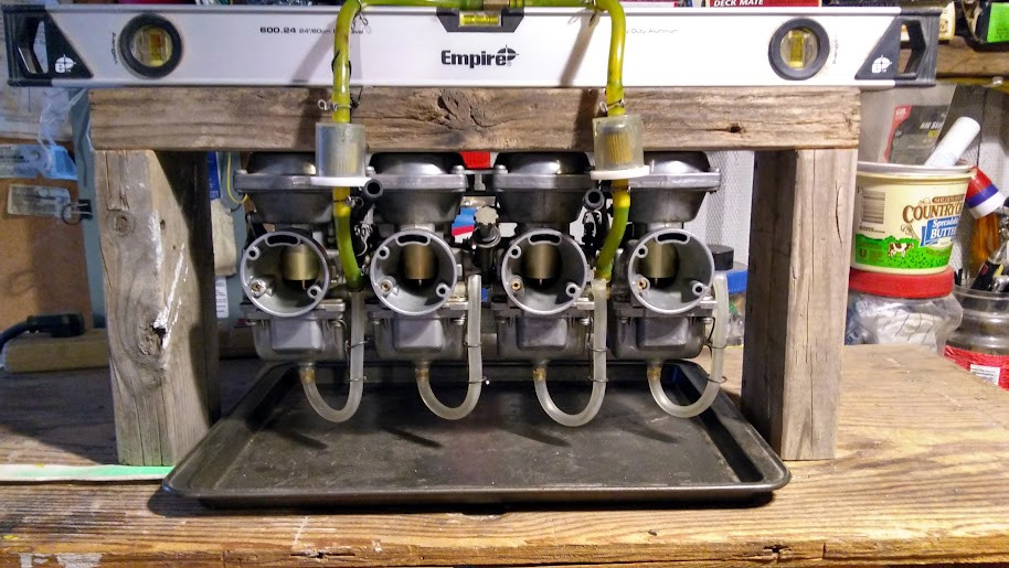

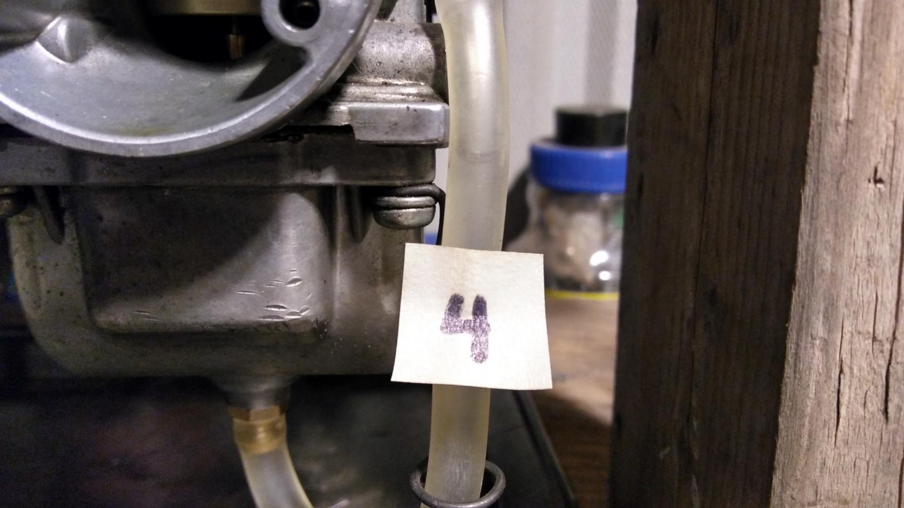

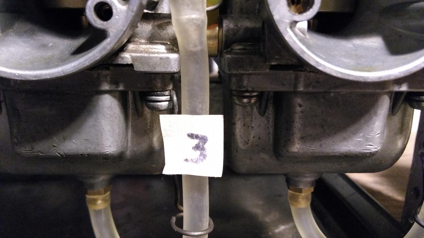

            I am sure Larry will chime in, but for clarification, in the first picture that he posted, when the fuel is applied to the the carbs the fuel levels will show in the tubes. The proper level should be at the bottom of the float bowl screws across all four carbs. If the level is incorrect you will need to adjust the float levels one by one by bending the float tangs until all four are set correctly and at the same heights. Once you have them set up correctly you remove those tubes and close off the float bowl drain plugs. On the carbs with drain plug screws you just put them back in the bowls and on the newer carbs you just turn the drain plug screws in until they are closed. The 81 and later carbs all had the latter screws and the earlier carbs actually have drain screw plugs and washers. In order to incorporate this process you have to have a set of four special drain plug replacements that allow you to hook the clear tubes up to them. Some have had success with buying the right size diameter hose so they can basically just shove or screw the hoses into the bottom of the bowls. Hopefully these last two lines are wrote don't confuse rather then help, but hopefully you can envision what I am describing.

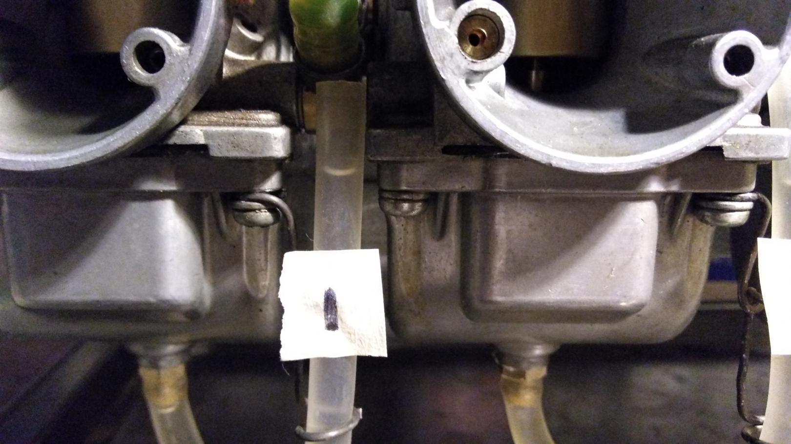

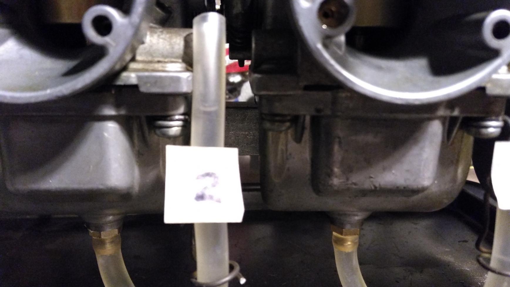

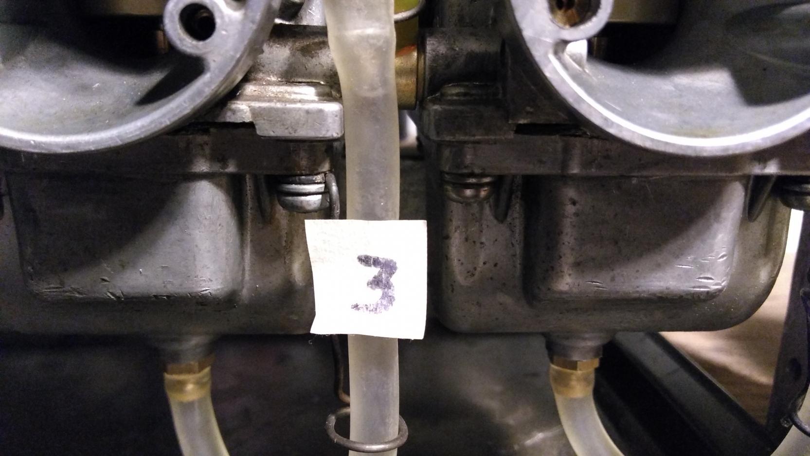

                I went with wut Cajun31 said-
                Here's wut they were even after setting the float height/distance per the repair manual. (_Oo)
ID:	881327 Click image for larger version
ID:	881329 Click image for larger version
                After I adjusted/checked/adjusted? ¯\_(°,_」°)_/¯
                They were all at/or near the squiggly red line shown here-
                The pic shows the screw, the washer, and the bailing wire wrapped round the screw. Red line represents where the screw/washer would be when bailing wire is removed as I do NOT ride around wit these set up. ʅ(°_◞°)ʃ
                Note- fuel level in #3 was not only up/over the bowl surface. It wuz pouring out of the main needle jet. Very bad.... ʅ(°_°)ʃ
                  Originally posted by Steverk
                  Looks like that's the purpose of the straight edge and calipers. Larry are the float bowls drains just for the purpose of verifying fuel levels in the float bowls, or do you keep those lines on all the time? Clever rig that I will adopt.
                  Thanks for the advice fellas. Let the games begin!
                  Straight edge/level is to show that the "Carb Pagoda" itself is level from side-to-side fOaR accurate readings. (^_^)
                  I mean...in theory when I cut the 2X4 I did my best to ensure the legs were the same length so iffin' I put the Pagoda on any level surface it'd wurky. Just that my work bench was a little off and I wanted to double-check. 乁(ツ)∫
                  The digital calipers come in handy when you wanna change the float level in .5mm (1/2 millimeter) increments until the fuel level gets to the sweet spot. \(゚ー゚\)
