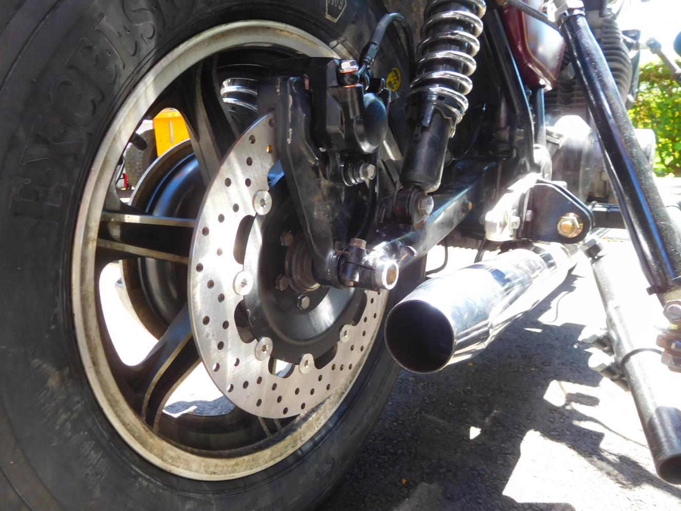

    It should be mentioned that my Standard has been converted to a Special rear wheel to fit a car tire. I had to change the torsion plate and spacer. I was not aware that the grommet was different for a Special but it fit together correctly even though it had a Standard unit on it.

      Originally posted by OldGreyBeast
      That part is totally gone on my bike, but I took some measurements. I'll get it into CAD and print a beta test soon
      Here are the two parts Standard vs Special with pictures of each. SPACER, TORQUE STOPPER for XS1100 1978 USA - order at CMSNL , SPACER, TORQUE STOPPER for XS1100L MIDNIGHT SPECIAL 1980 (A) USA - order at CMSNL

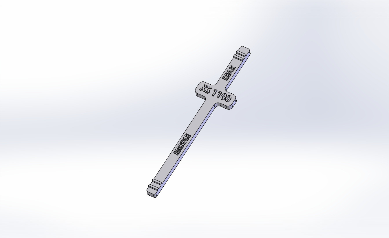

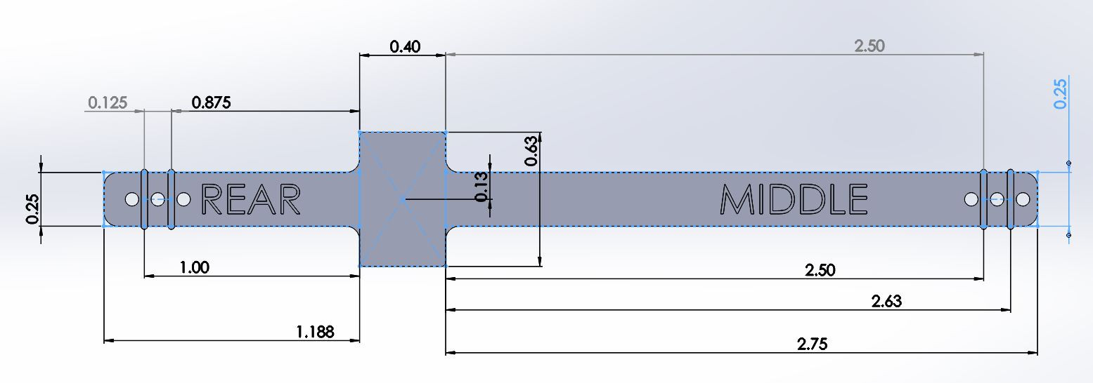

                My take on a 3d printed final drive dipstick. Happy to print off a few, especially if someone with an original is willing to compare and make sure my marks are in the right spot!

                  One thing the parts book does NOT show is the place at the "T" that allows both sides to bend. To check the middle drive, you have to pull the lower air cleaner off if the dipstick will not bend.
                    Ah, excellent feedback! I can definitely try to add in a joint in the middle (at a cost of losing that neat "XS1100"
