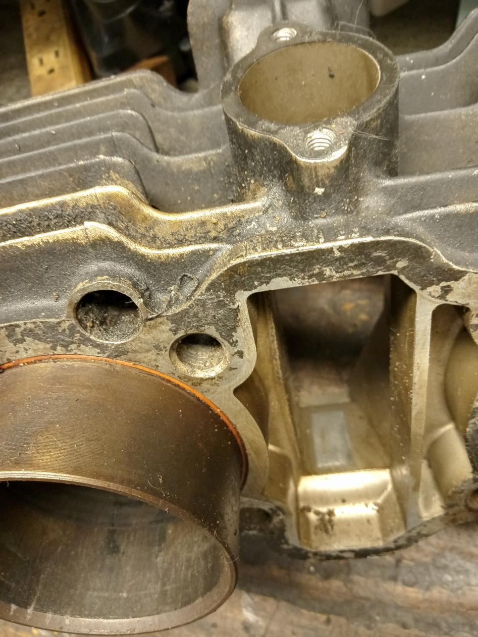

          This is the area that is prone to leaking, the smaller is the stud/bolt hole. See how close it is to the faulty O-ring.
          And to add, there is an awful lot of oil being slung around in that cam chain tunnel right nearby. I think some kind of sealer would be a good idea around this area when reassembling, maybe an anerobic type so there is no rush fitting the pistons/rings back in.
