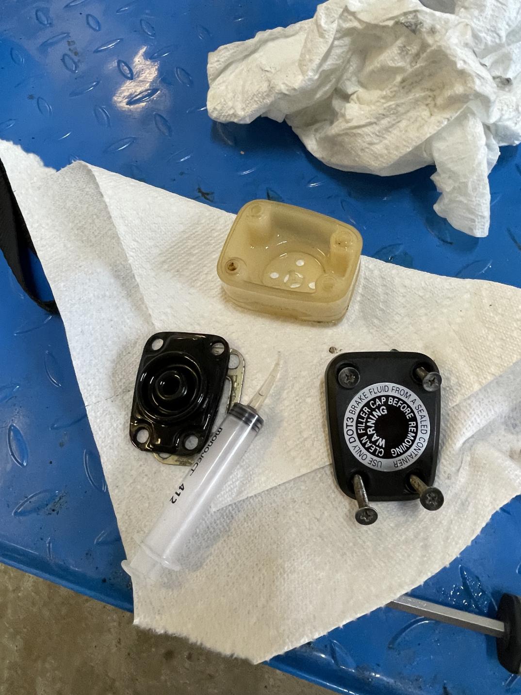

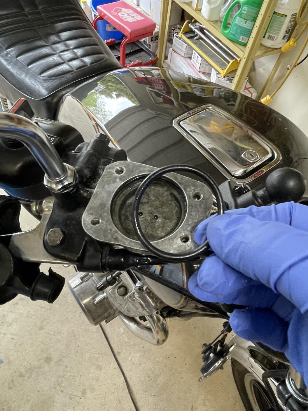

    Alright folks, I was all excited to get my o rings... pulled the reservoir off... man what a mess. However the 39.7mm x 3.5mm O ring I bought is not a fit. It is smaller, and a thicker O ring than what is there ( I am sure the stock one). Bummer. So what O ring do I need? I tried to clean the old one, which was still very pliable and seemed fine, but after trying again it was still weeping terribly. Thats odd to me, not sure why after cleaning it up it does not work. You can see the original O ring in the slot, and the new EPDM one I ordered (specified in this thread) that does not fit in my hand.

      That sucks. Perhaps you could measure it with a vernier.

        I will take it to a store to find one. Just found it odd, why would it be different. And why would cleaning it up not work...it is still so pliable. Anyways, frustrating! And now off the road.

          Local auto store had the one, although it is Nitrile. Have to hope that is fine, he sure seemed to think it was.
            Hopefully the one you found is a bit tighter fit. Who knows if the one that was in there was the correct size to begin with.

              Well, that's not the success story I'm sure we all hoped to hear... (⊙_ʖ⊙)
              SOooo, went back into my own personal XS1100 inventory to pull out not one, but BOTH of my "Standard" MC's and resevoirs.
              Why do I have standard's parts when I own a Special? Answer- I don't say NO to XS1100 parts boxes... ʅ(́◡◝)ʃ
              Popped off the resevoir and removed the OEM O-ring. Definitely not as "girthy" as the 3.5 mm O-ring I bought/used to replace the OEM in my Special. ໒( ⊡ _ ⊡ )७
              By my digital caliper the Standard O-ring wasn't 3.5 mm but close to 2.5 mm.
              Me being me? I put in one of the extra O-rings ( 5-in-a-pack) in the Standard groove after lubing it with Dot3.
              Then tried pushing the OEM Standard Resevoir back where it came from.
              It didn't WANNA go in with normal hand pressure and twisting/turning. (︶︹︺)
              But placing the resevoir on a flat bench upside down and twisting/pushing down MANLY-LIKE on the inverted Standard MC? (O_o)7
              ....POP! And in it went. (^_^)
              A tight fit with a lot mOaR pressure seal on the surfaces.
              Looks like the same O-ring I used for my Special resevoir can PoSsIbLy be used for a Standard.
              But it IS quite clear that the OEM Standard Resevoir O-ring isn't as "Girthy" as the OEM O-rings for the Specials. (  ゚ ,_ゝ゚)
