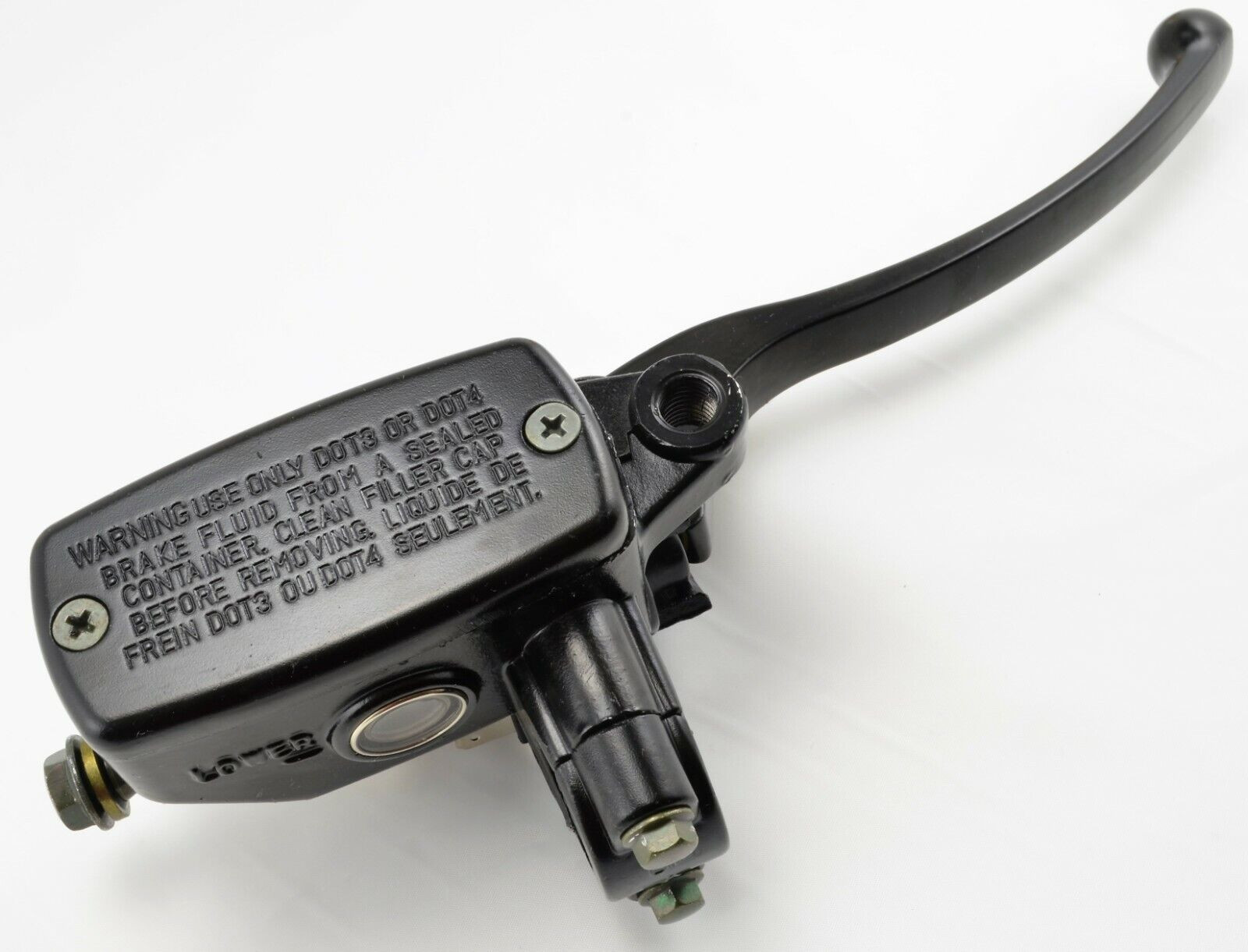

    Mikesxs has replacement MC's. Just make sure you buy the one for two front disks. On the final drive, is the bolt head stripped, or the threads in the case? Partzilla can probably get you a replacement, but again, that I'm not sure of as it's been about 15 years since I've last stripped on.
      This is another good source. You need a 16mm piston for dual calipers. Not 12 or 14mm. I use these on several bikes. They work great. Some in service for over ten years.
      https://www.ebay.com/itm/203479587747

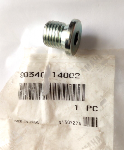

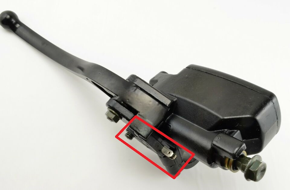

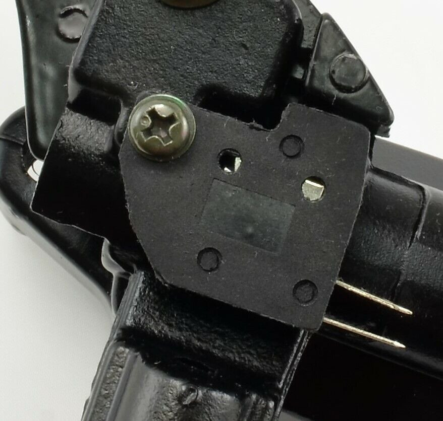

        Does the brake light switch integrate into that lever? As for final drive, it is the head... the PO must have used an impact driver on that sucker... took all I had including a heat gun to get it out. Looks like you can just get a new one from Yamaha.
          Brake light switch.

            Plug.
            https://www.ebay.com/itm/16638799776...Bk9SR6bs3bPcYw

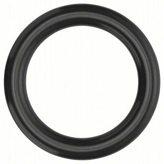

                  Marty knows. 39.7mm x 3.5mm.
                  https://www.xs650.com/threads/brake-...-o-ring.60701/
                  https://www.allworldmachinery.com/it...?itemCode=P-40

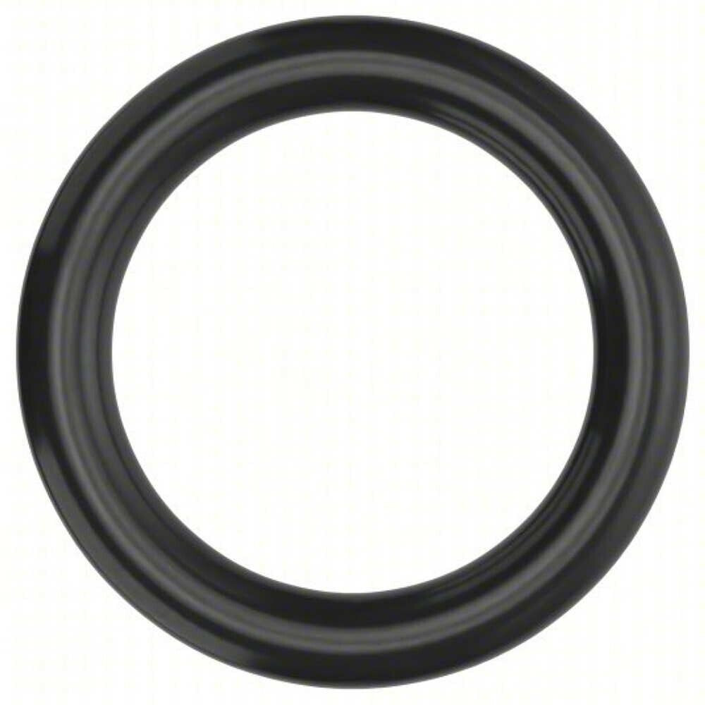

                    https://www.ebay.com/itm/36478165784...Bk9SR8zHud7cYw

                      Somebody correct me if I'm wrong here, it's my understanding that ordinary hardware store o-rings are made to seal water and won't hold up to gasoline or other auto type fluids. Generally speaking I get mine from auto parts stores, they tend to keep them in an assortment behind the counter.
                        LAB3, Brake fluid is silicon based (should not corrode a Nitrile O-ring) and since the master cylinder is so far away from the hot calipers, there is not much heat to deal with. However, if you can get Viton, that would be the better material. I think Buna/Nitrile would work fine. I use Nitrile in my KZ1000/750 rear master cylinder cups and they have lasted for many years. I have that part reference if anyone needs it.

                            I replaced the MC Reservoir O-ring on my 79 Special this year cuz of the same "weeping".
                            But in my Inter-Web searches I got conflicting info about whether (or NOT) nitrile rubber was safe with good-ole-DOT3 brake fluid. (⊙﹏⊙)
                            Imma chickened out 'bout Nitrile and went with EPDM instead. (◠﹏◠)
                            Purchased from-
                            Goin' on over six months and no problems.......yet. Feeling like a guinea pig/test subject but we'll see. ¯\_(⊙︿⊙)_/¯
