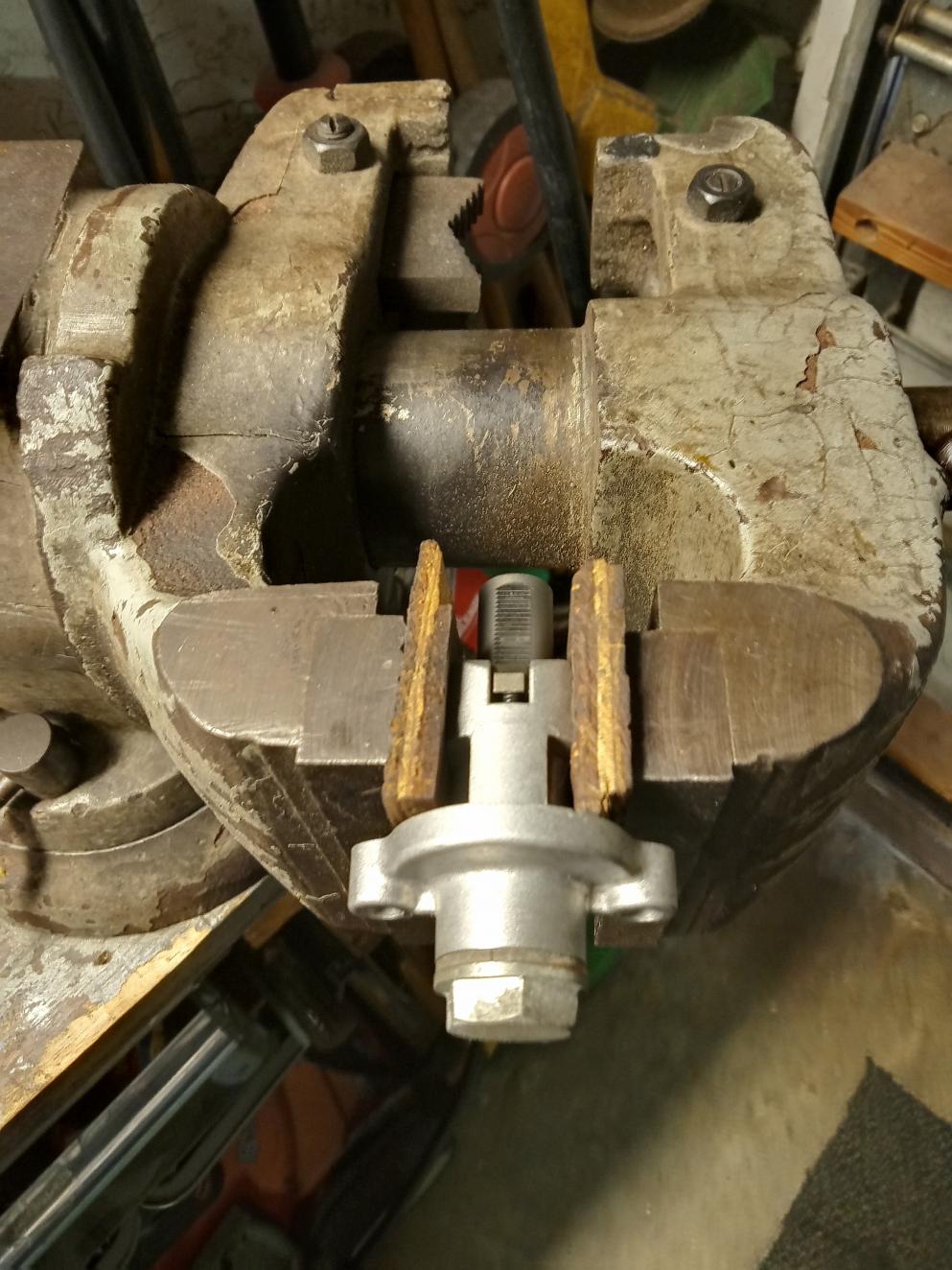

                Need to take the acct apart to reset spring or length of tension somehow before installing?
                80 G
                  Yes, you'll need to remove the large 19mm bolt first before installing the tensioner. You can hold the tensioner on it's 2 flat sides between 2 wood blocks in a vise to do so. An impact gun would be best but a wrench should also work.
