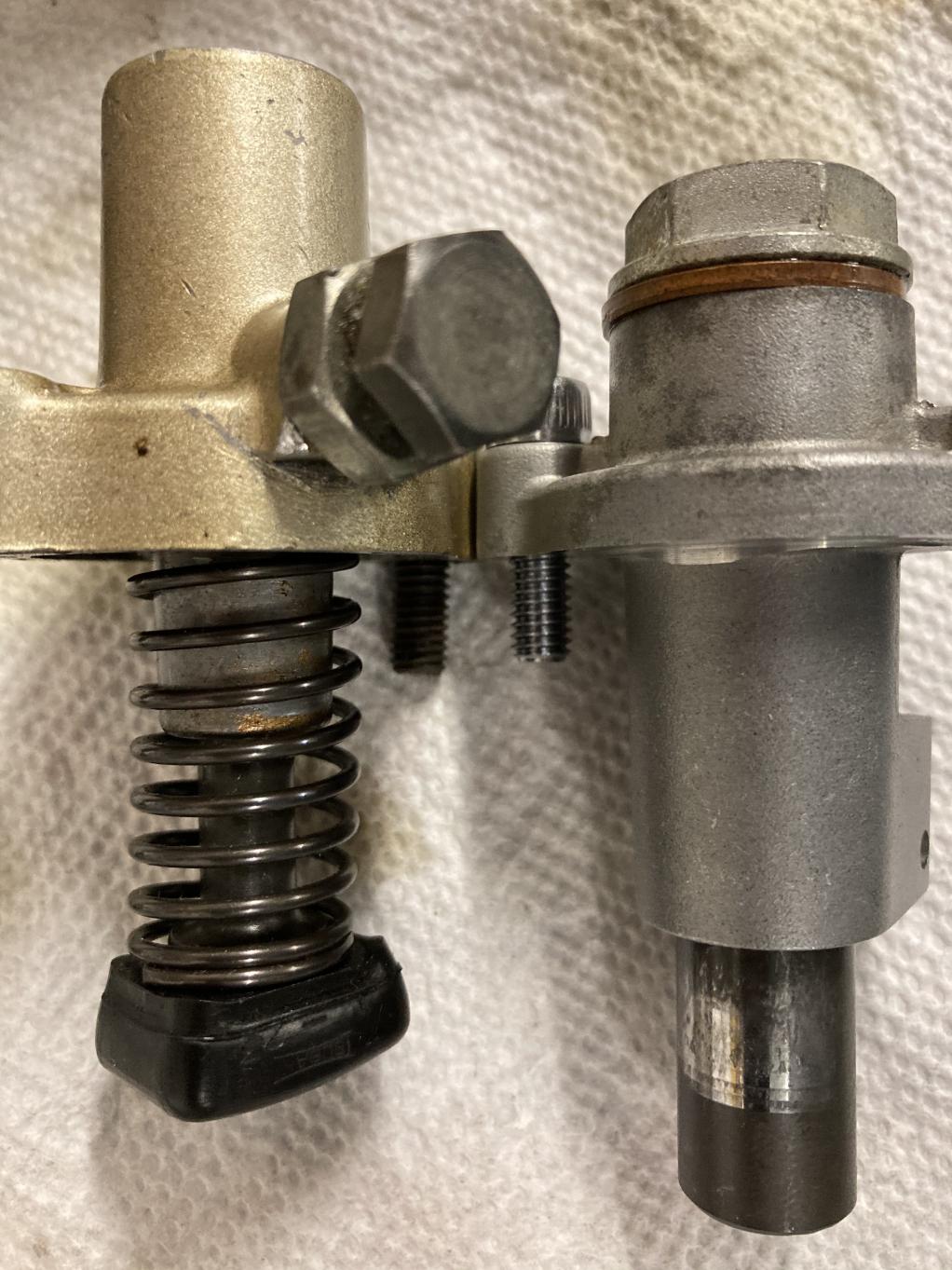

    Will a 1993 Yamaha VMX V -Max cam chain tensioner work on my 80 1100 SG? Have a chance to get one.
    Automatic Cam Chain Tensioners - XS11.club Forums
    Short answer is yes it will.

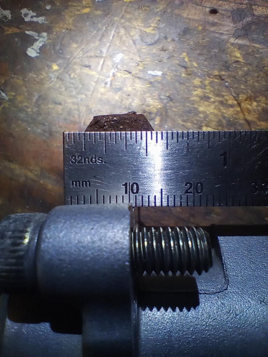

        You need to use the Vmax bolts (or equivalent) when you install the Vmax tensioner on the XS11 because the shoulder on the Vmax tensioner is not a thick:. Therefore you need the shorter Vmax bolts:
        Click image for larger version  Name:	Vmax Bolt.JPG Views:	0 Size:	179.9 KB ID:	873995
          Yep, 20mm length bolts for the vmax unit, the OEM bolts are 25mm I believe.

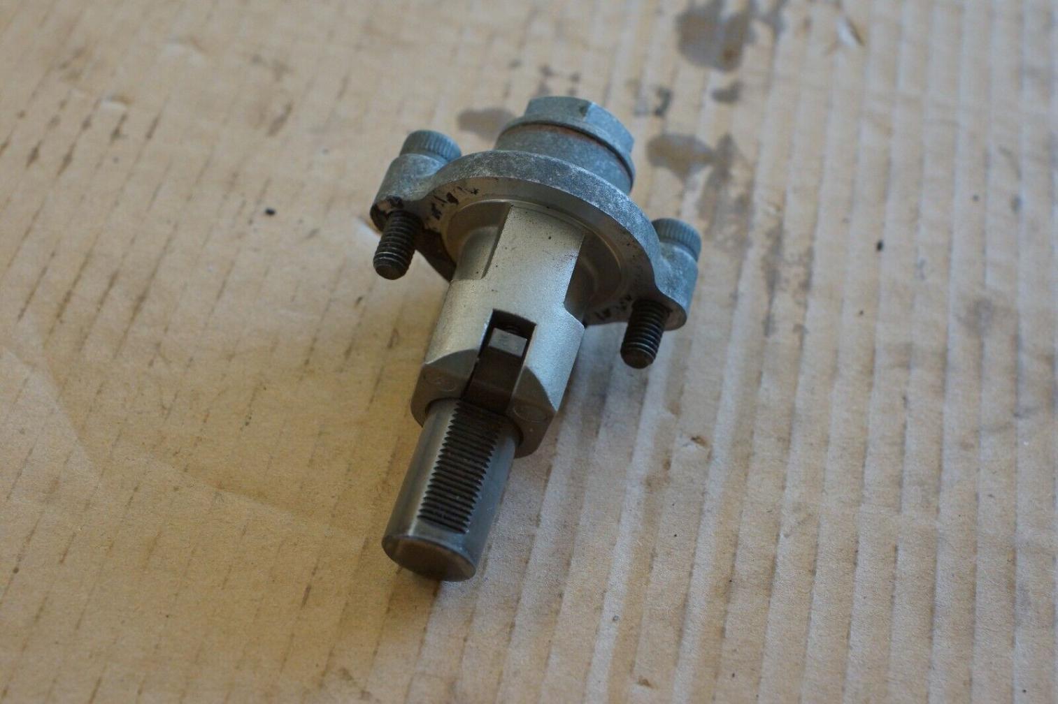

                    Got my V Max tensioner today in the mail-already removed the spring and pushed the part back ready to install. Do I really have to remove the cam cover like it is stated to make sure nothing is off?
                      Put the bike on the centerstand, rotate the crankshaft clockwise with a wrench and set the timing to the 'C' mark, remove the old tensioner and install the new one. No need to remove the valve cover, just make sure not to rotate the crankshaft any when the tensioner is out. After the new one is in, rotate the engine with the wrench slowly a few rotations clockwise to assure everything is smooth.
                      Very important that the bike is on the centerstand for this procedure, otherwise the chain may slip off the crankshaft teeth.

                        • 2117
                        I dont have the centerstand but will get it level. Will the Yamaha gasket from the stock tensioner fit on the V Max tensioner? If not I have form a gasket sealant.
                          I think it will, not 100% sure.
                            They are both Yamahas!
                            Yes, you can use either gasket. I used the XS11 gasket on my Vmax ACCT.
