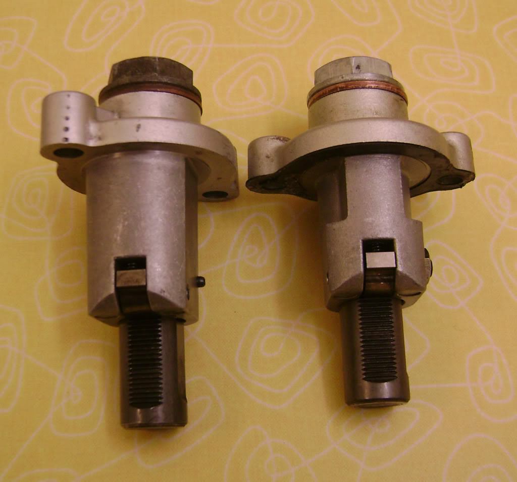

    Below is the various types; there's three units that we know work, and they are the V-Max/Venture units, a very similar unit that was sourced off a Vision, and a unit off a Raptor. The Vision unit needs a slight mod, the V-Max and Raptor units might, and I'll note those.

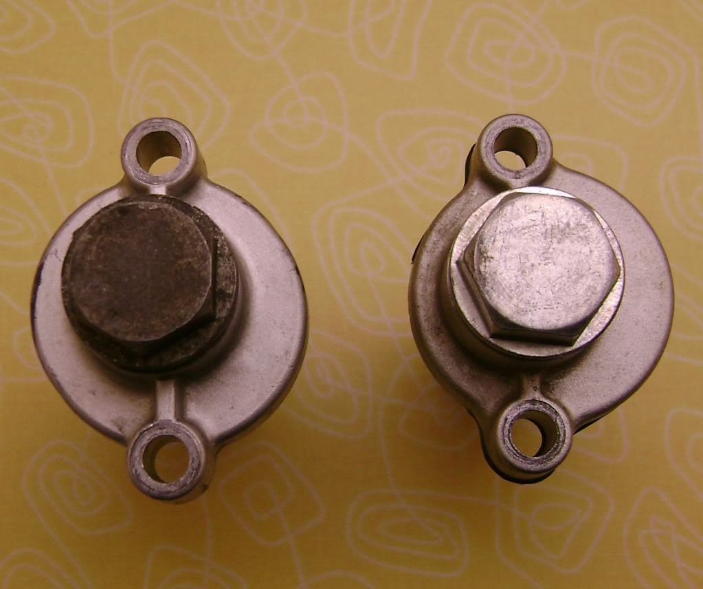

    Here's a A/B comparison between the V-Max/Venture and XV550 Vision tensioners. All pics have the Vision unit (found by Natemoen) on the left.
    Click image for larger version  Name:	camchain1.jpg Views:	0 Size:	124.1 KB ID:	861635
    You can see the slightly different 'offset' here, but it's too small to make any difference I can see. The big difference here is the bolt center-to-center; the V-max can be a direct bolt-in, the Vision has the holes .070" further apart. So the Vision unit needs a small alteration. You might have to slightly file the V-Max mounting holes (I did) if the bolts don't screw in easily. For the Vision unit, do the alteration in the upper hole, and file the hole down and to the left slightly for the best fit. The Vision unit will only fit one way, so test-fit to see which hole is 'top'.
    Click image for larger version  Name:	camchain2.jpg Views:	0 Size:	127.5 KB ID:	861636
    The Vision unit is .130" longer than the V-max internally. I doubt that this would be a problem, maybe with a new cam chain. I know in comparing this in length to OEM units I have that are 'set', this will fit. The Vision unit has a much softer spring too; you can easily fully compress that one, the V-max takes some effort. Both seem to use the same plunger.

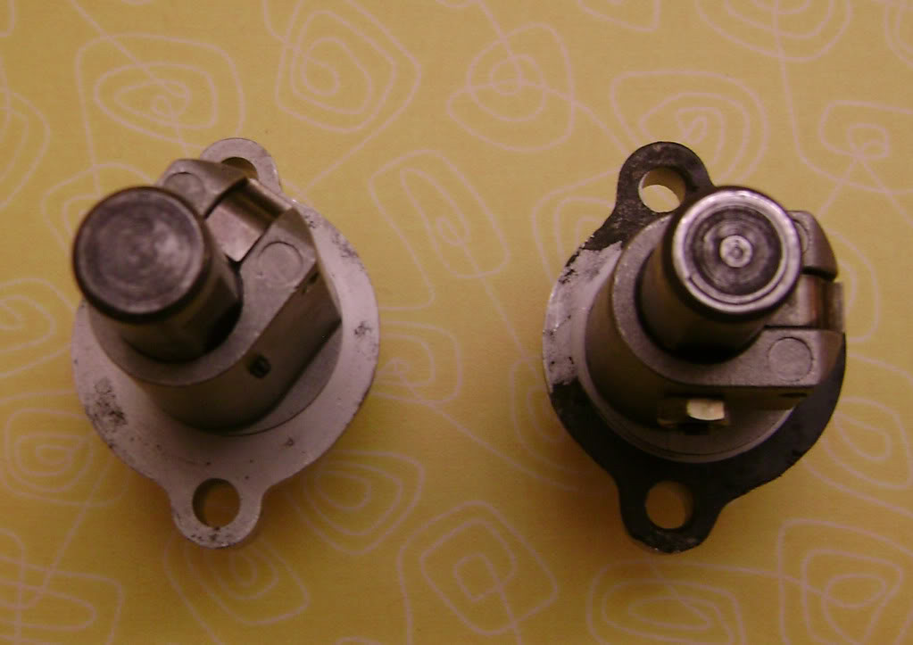

    Click image for larger version  Name:	camchain3.jpg Views:	0 Size:	86.8 KB ID:	861637
    The other big difference. The Vision unit has the plunger/ratchet rotated about 45 degrees.
