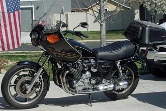

ID:	870975 Before new cover. Click image for larger version
ID:	870976 After new cover and padding.
        It's easy to do, but you will need to make up something for the pointy tabs that hold the seat cover on. I used my TIG to weld on a few I cut from sheet stock, or you could use a punch to create new points.
