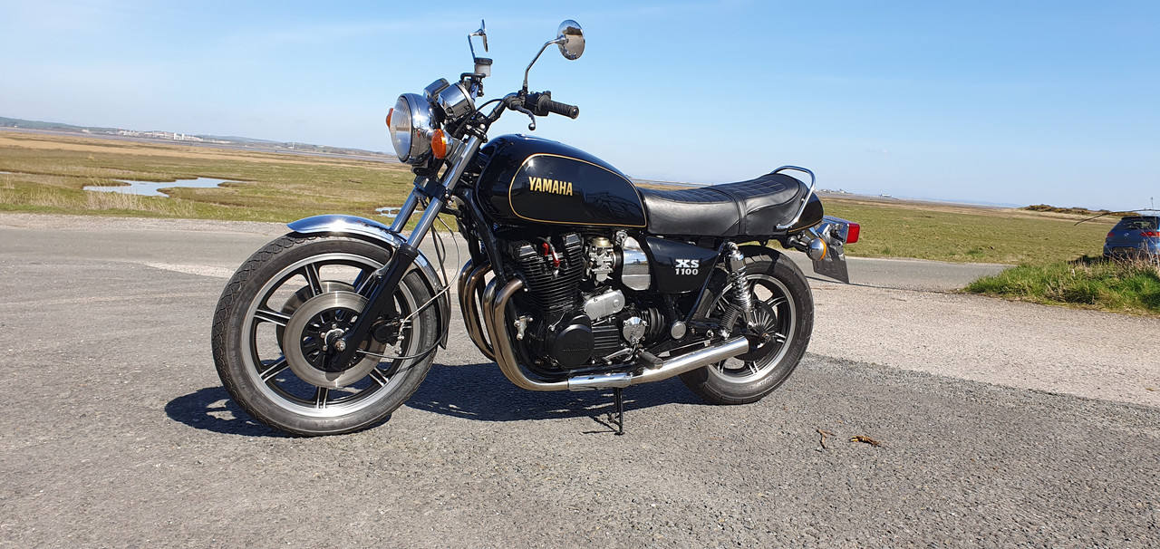

            bikes running really good now, not %100 but almost. STILL need to paint the standard side panels using the Special ones for now. I think i'll go down the square headlight route at some point as I think its suits it better than the round one, or lower the round one as it sits up to high I think !!!!! happy though

                cheers ranger, this is my 4th XS11 and riding it brings back good memories from my first 78 standard, had so much fun on that bike. I love my GSX1100 but the XS pulls that little bit more, not bad for a 44 year old.

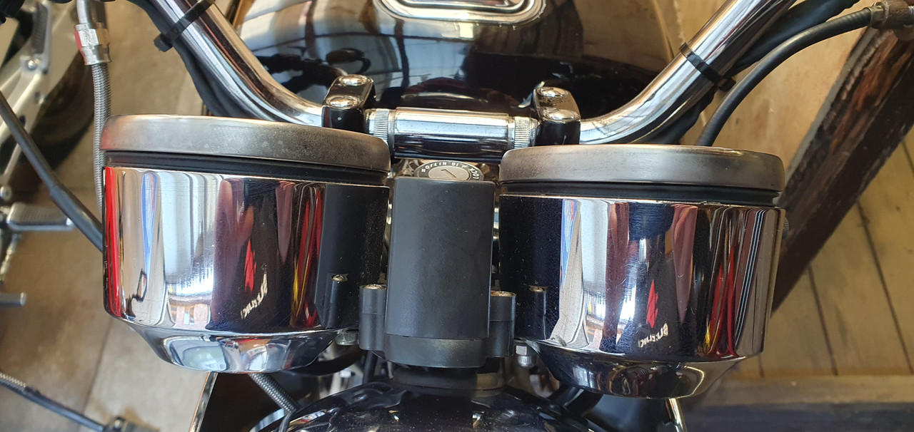

                              the clock surround rubbers where perished and looks crap and no longer available, so someone came up with the idea of using draught excluder (can't remember who) so i bought some.
                              as you can see they are way past their use by date !!!!!!!

                                they now look good and don't wobble about
