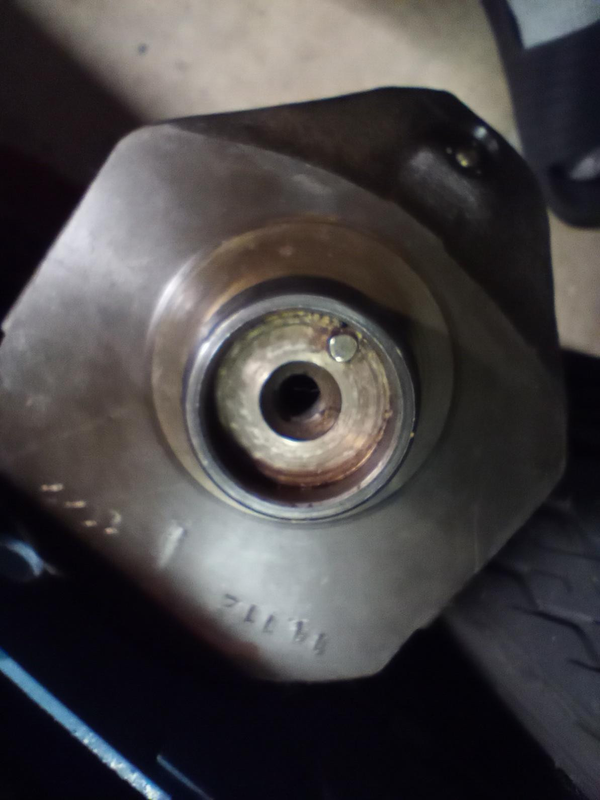

    replied
    Speed, solder, oil and heat & vibration do not mix. That being said, let's take one step back. How was your crankshaft end measured accurately with the seal installed? Did the mechanic use a vernier caliper or a micrometer? The seal would have had to been removed in order to measure the crank end with any accuracy. It needs to be measured right where the seal lip (inner) resides on the end of the crankshaft.
ID:	877752 Click image for larger version

  • speedlimit85
    replied
    Well, Phil, you were close to right. Instead of a wobble, I have an egg.
    I rode into the country to a bike shop today. They let me take it apart and show them the seal. The seal looked good. Then Bullfrog measured the end of the crank and it's an egg shape.

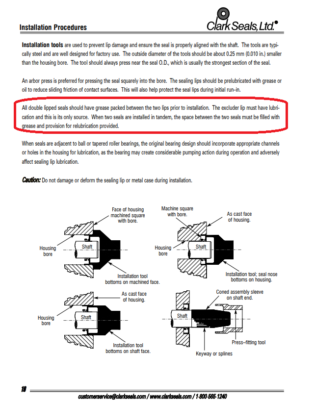

    replied
    And a page on installation of seals.
Name:	Opera Snapshot_2024-01-31_124001_www.clarkseals.com.png

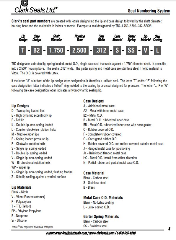

    replied
    Here is how the part numbers from one company are laid out. For a 32mm x 48mm x 7.8mm (stock) I figured the part number would be R-B2-1.889-1.259-0.307-(blank space)-SS-V-L for the exact seal. Measuring 48MM = 1.889" and so on....
    Click image for larger version  Name:	Opera Snapshot_2024-01-31_123326_www.clarkseals.com.png Views:	0 Size:	180.4 KB ID:	877744

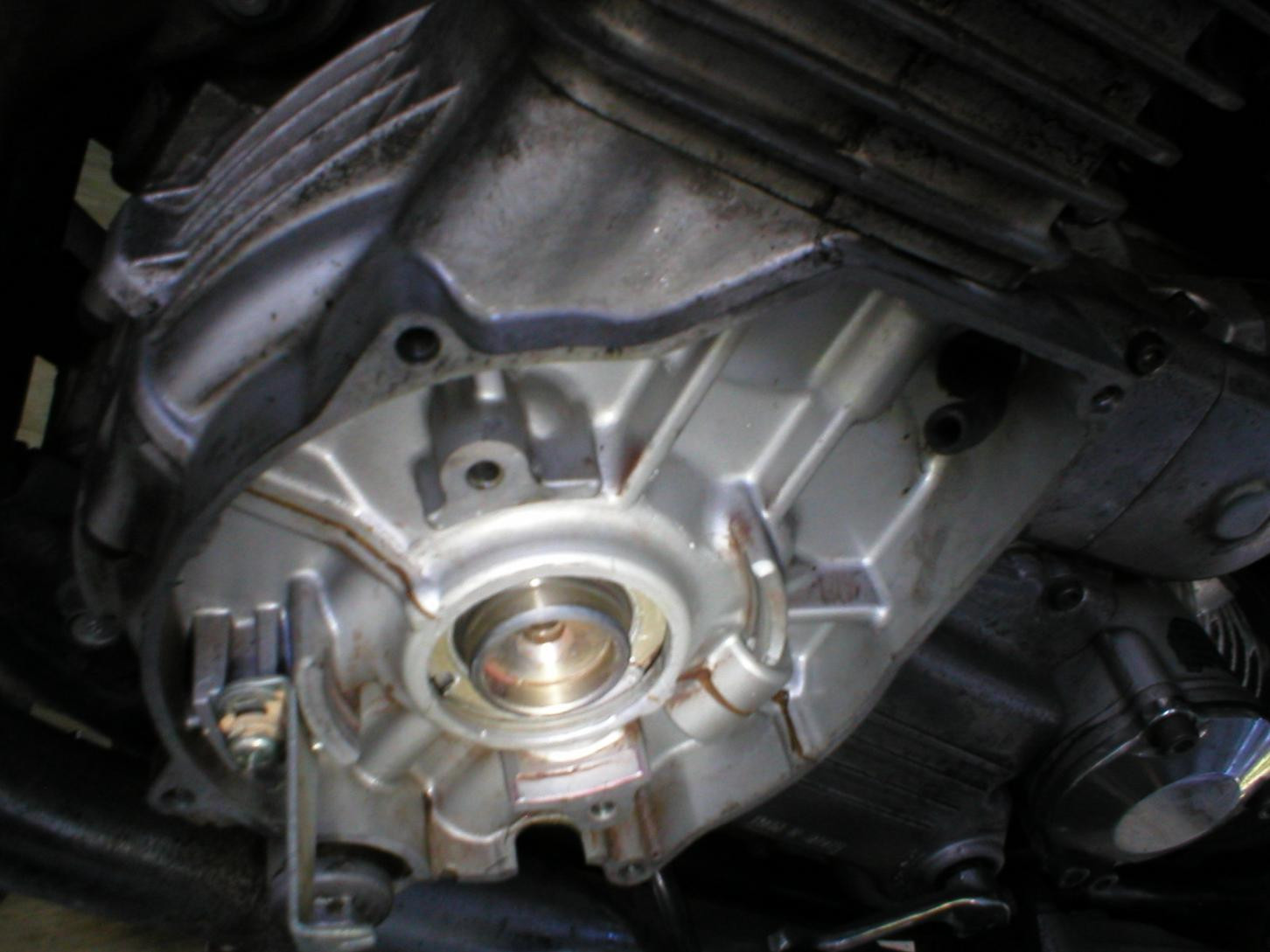

    replied
