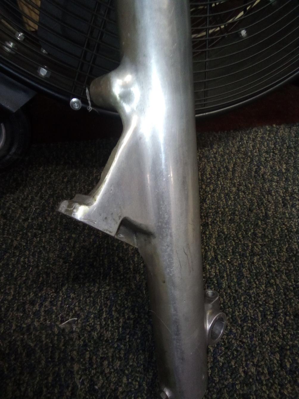

            I could be wrong, but I do not believe anyone makes a caliper adapter plate for the oddball Special forks. Member Topcatgr58 made his own but not very easily.
            Click image for larger version  Name:	Special Fork.jpg Views:	0 Size:	152.0 KB ID:	865635
            Link to the bracket fabrication...
            https://xs11.club/forum/idle-talk-fo...rk-upgrade-mod
