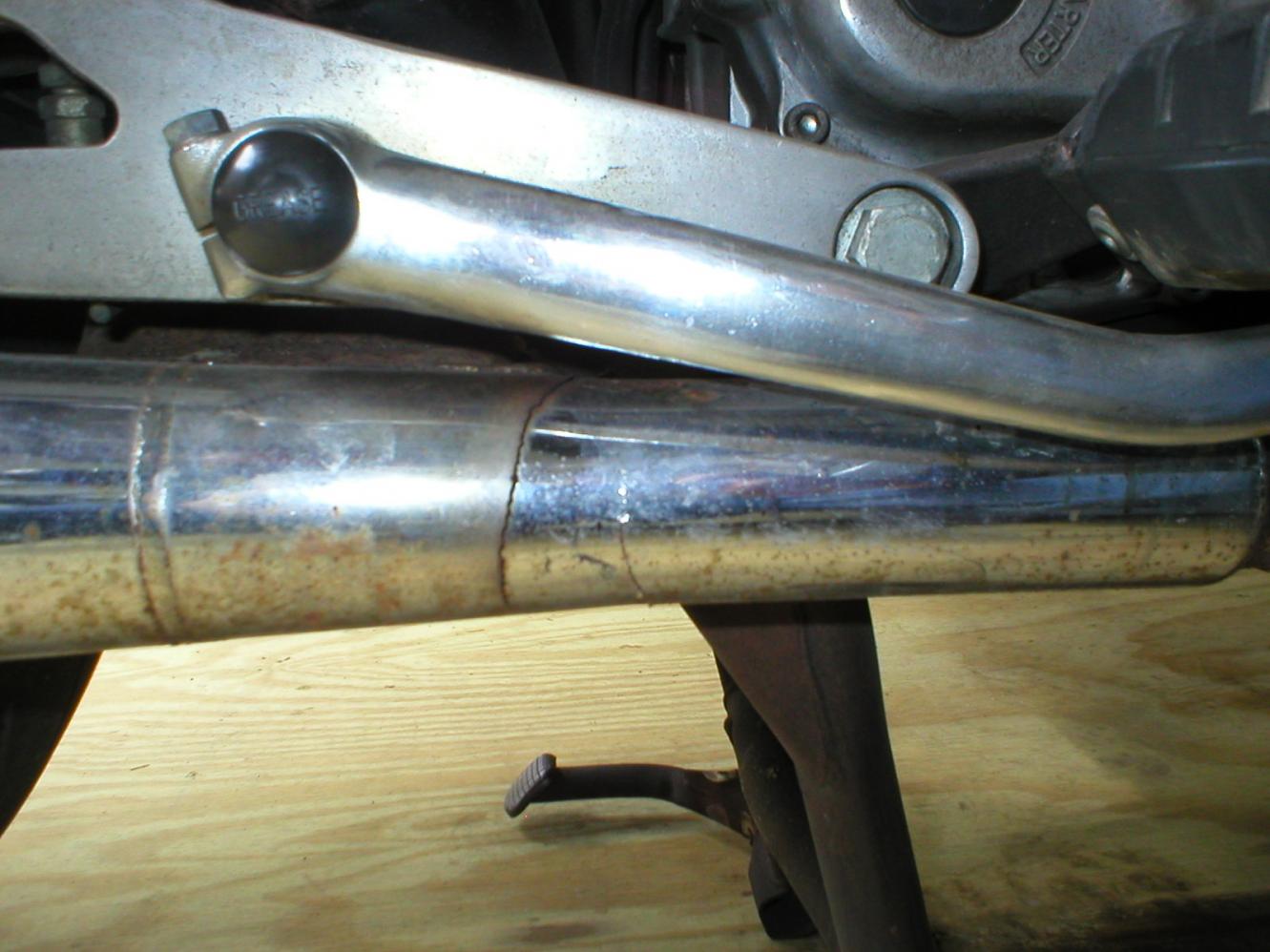

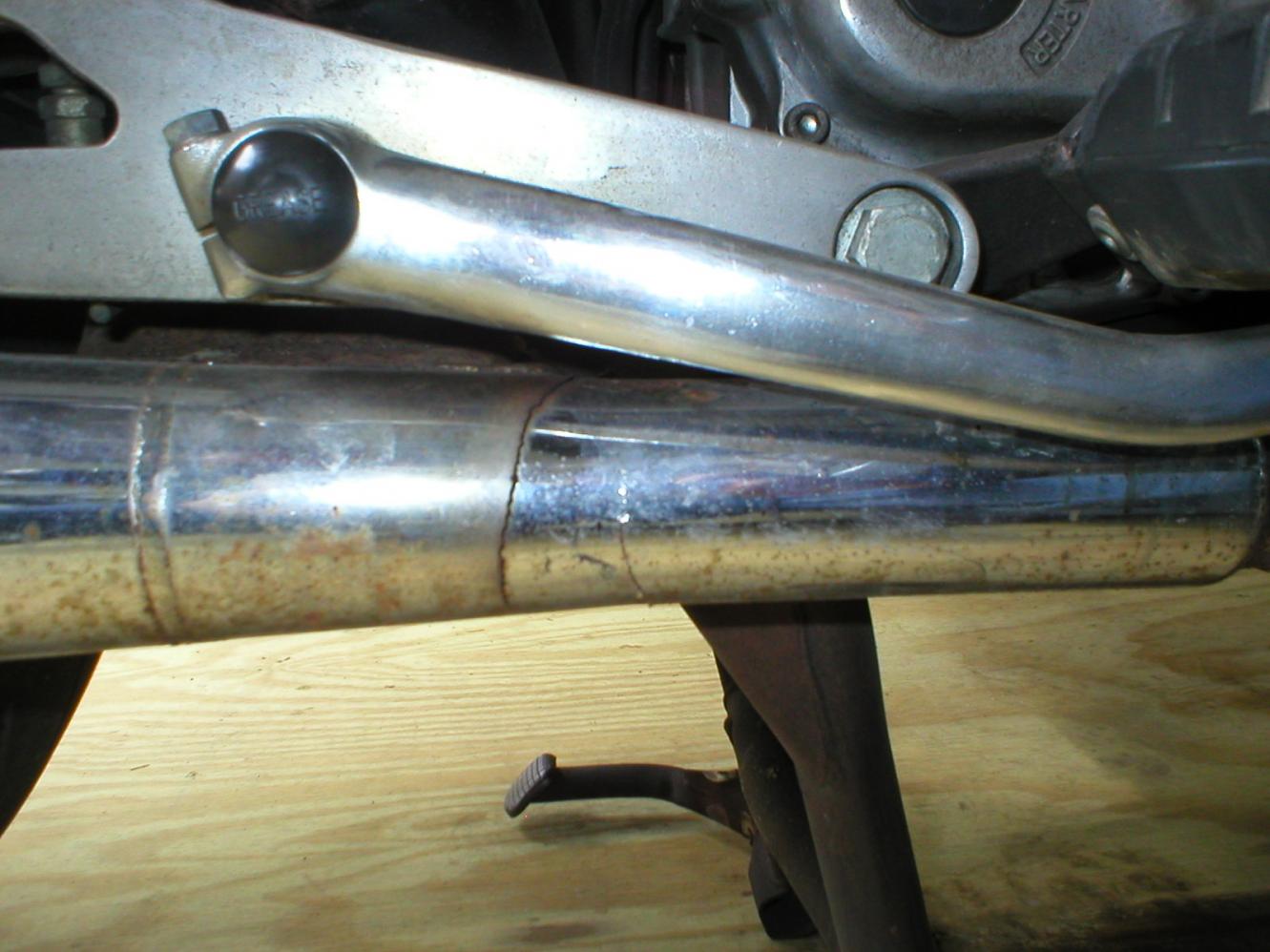

    Maybe I take too many bumpy back roads. It's not too rusty, but today I heard rattling and there is a big crack through the right side just in front of the cross over.
    Can this be repaired, welded, JB? Could be hard to replace. I rode aroundy with it like that today, It's not dangerous yet right?

        They rust from the inside, so you are probably close to "end of life" on the factory system. The JB may give you another year or two, so it's a good first try. If you know how to weld, or have a GOOD local welder, that could give you about four more years.
          Speedlimit,, tack weld in four locations with a wire-feed welderl while exhaust is in place. Remove right side exhaust and finish welding break preferably using a torch and welding rod. Torch welding this spreads the heat across pipe while welding. Grind it smooth with an angle head grinder using a flap sanding disc. Paint the area using a can of Dupli-Colors High Temp Silver. That fix will last rest of bikes life. Just a tried and true procedure from a certified welder/fabricator.
            BTW, Dupli-Color brand spray paints are primarily located at your local NAPA dealers. It is also a high quality paint brand that stays looking good for many years!

              I agree. Go right to a good weld shop. Do not use any epoxy as it will contaminate any weld repair.

                I had this happen on my original to me MNS. I took the bike to a reputable welder so that he could spot weld it to hold it together. I then took the exhaust off the bike and brought it back to him to finish the job. It would be best if you can find someone that can do TIG.

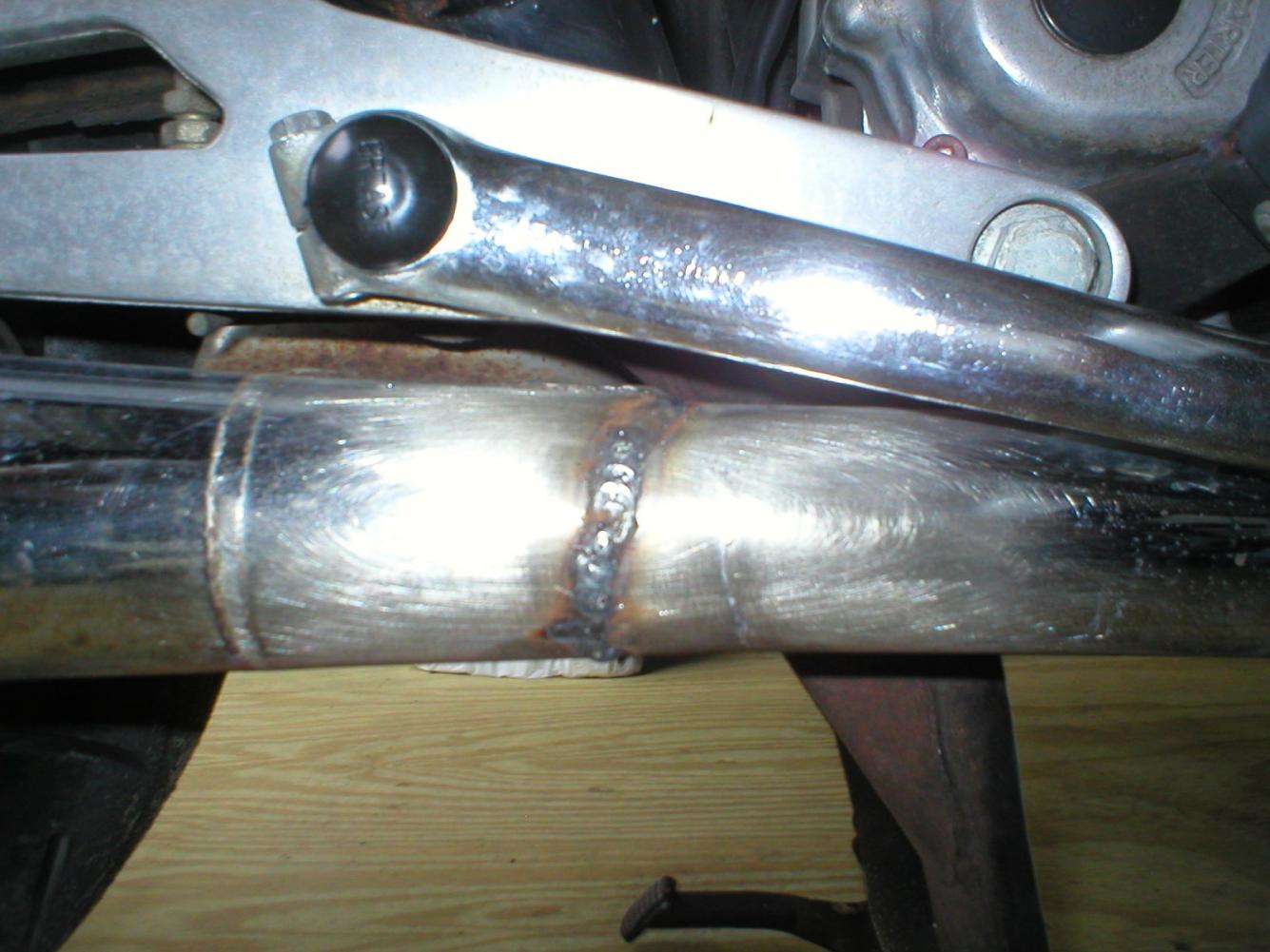

                  better Click image for larger version

                    Hit it with a brush to clean off the oxidation and put a bit of high temp paint on it to keep it from rusting out in the heat affected zones of the weld.

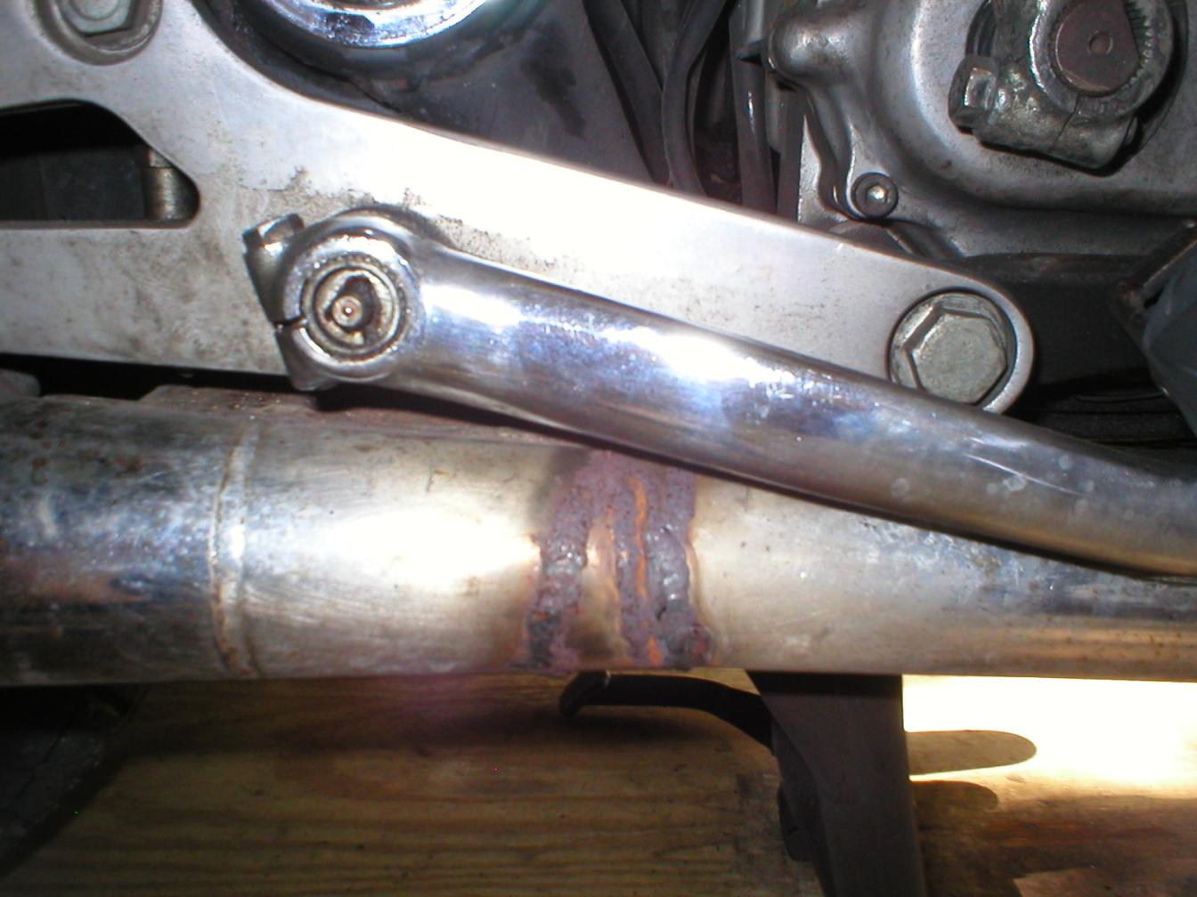

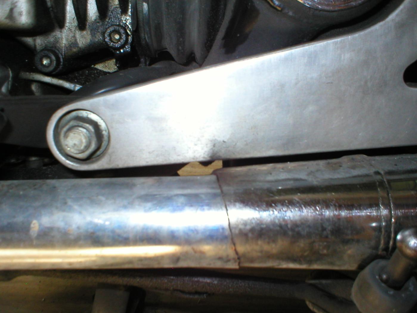

ID:	890906now the left side crack is all the way through...How hard is it to remove for weld to go all the way around? would I need new exhaust gaskets?

                        • 7828

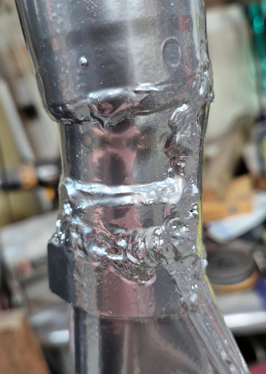

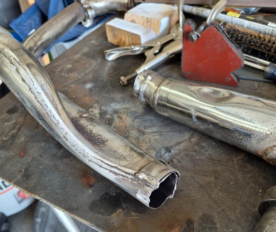

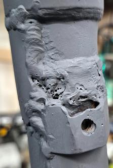

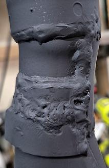

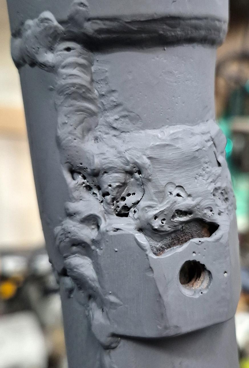

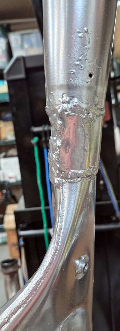

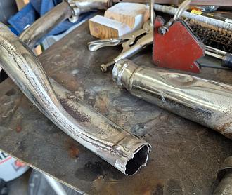

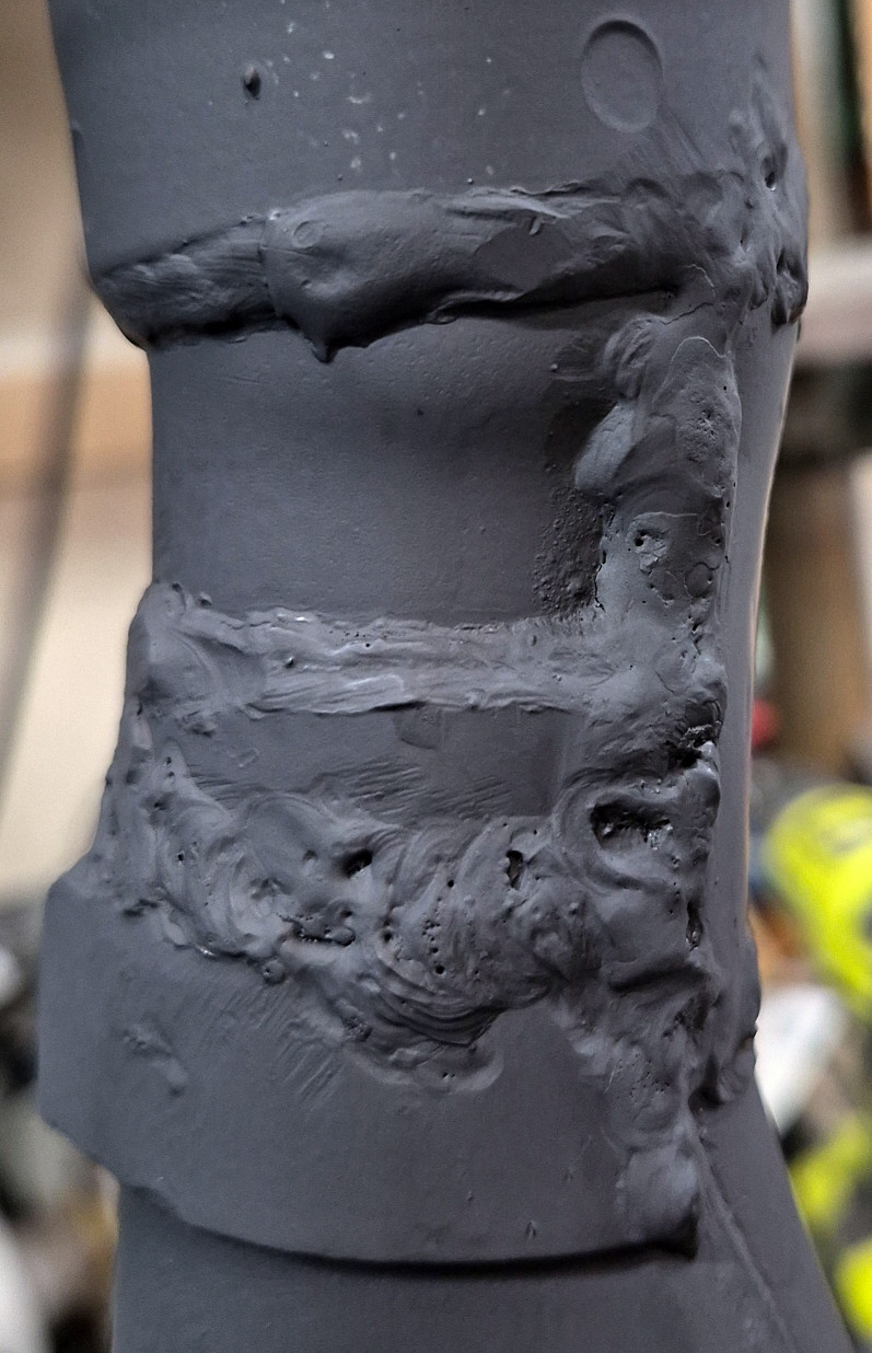

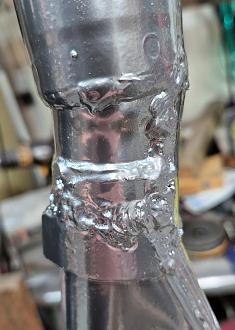

                        I had to do my special exhaust this past spring. Right side cracked all around. Lucky for me I have a TIG welder and was able to weld it up. I did add some extra steel to help support the pipe at the break. The hard part is trying to get a clean weld, between the carbon, nickel plating, and thin "good" steel to weld on. I know it's not pretty, but it should hold for another 30 years with any luck. My next task is going to build a complete exhaust system for the 1978 I'm working on. That is going to be a 4 into 1 made of stainless steel.

                          Many times the exhaust header gaskets can be re-used, but not always. Probably a good idea to change them while it's off. The new gaskets can be held into the head while assembling with a few dabs of grease.
                          Yes, the factory exhaust is a bit of a pain to remove/install, mostly because of the weight of it.

                            He's gonna weld it on the bike. I just stopped at the shop. He welded the other side with good results. I thanked him for changing tires and brakes in time to ride back from the everglades in 7 hours. His eyes popped out of his head "on that thing?"
