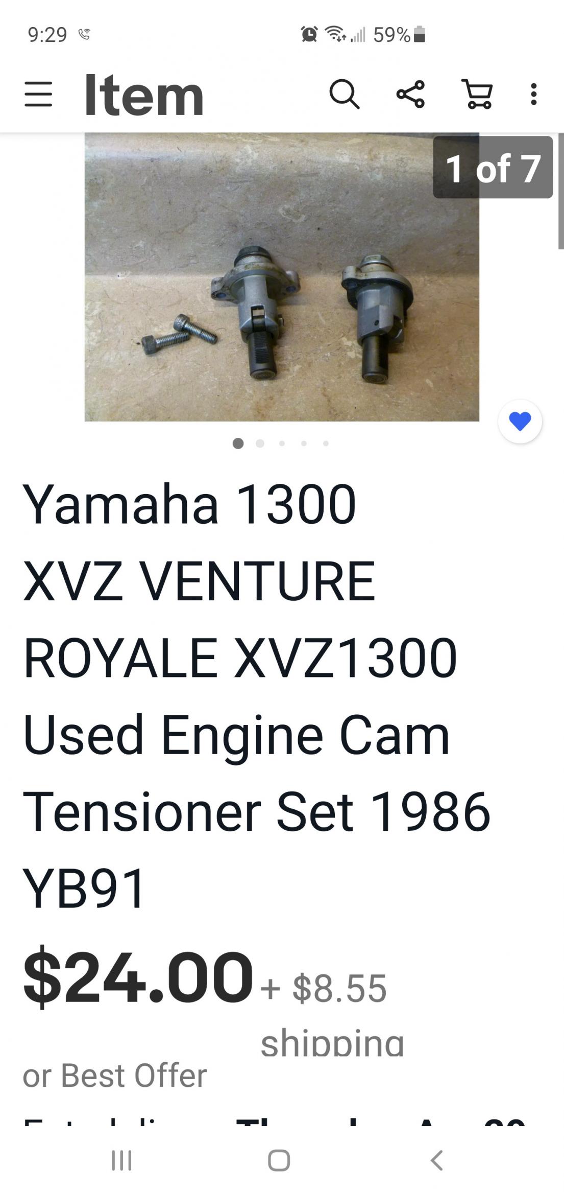

              Is this the style automatic cam chain tensioner adjuster I need???

                              Well got automatic cam chain tensioner coming.... And AUX fuel stand for syncing carbs (have 6 bikes and 3 of them have multiple carbs).... Only about $20 for the AUX fuel container that hangs....
