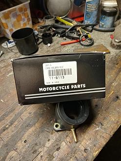

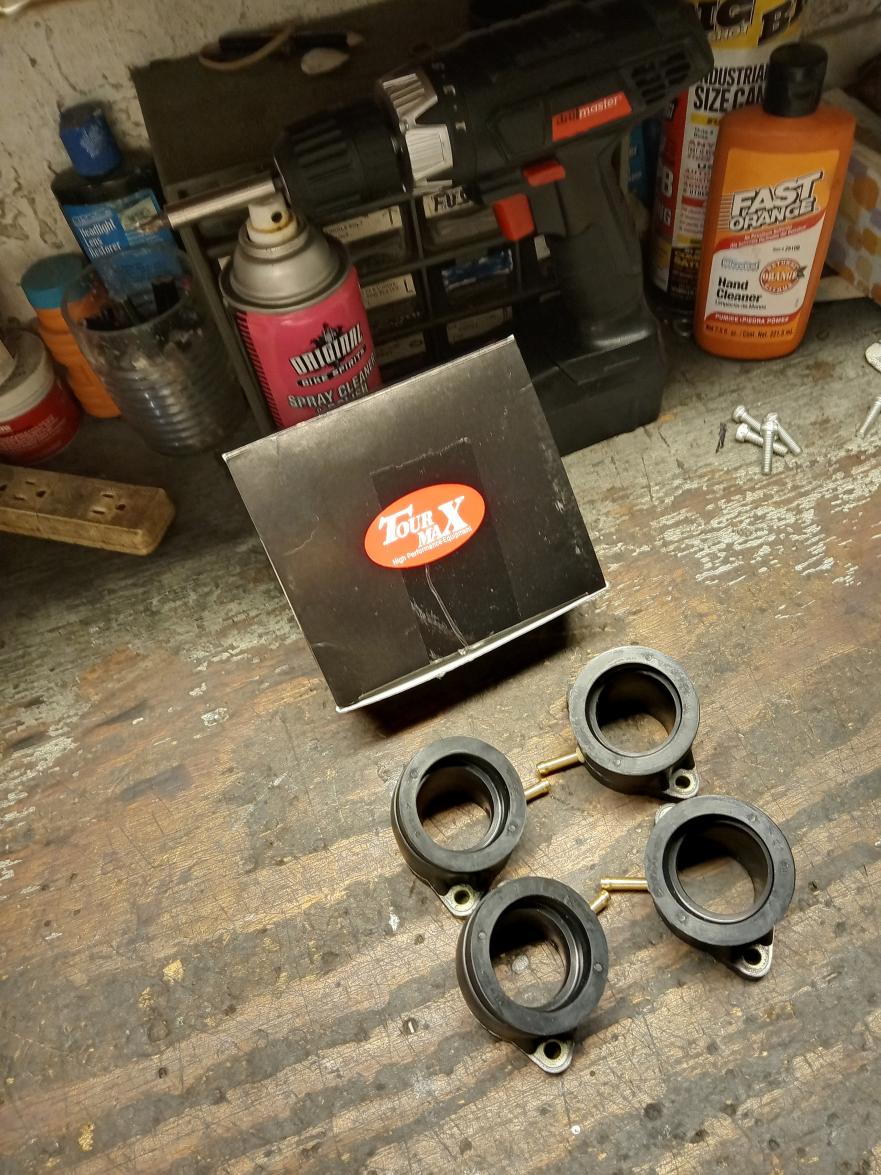

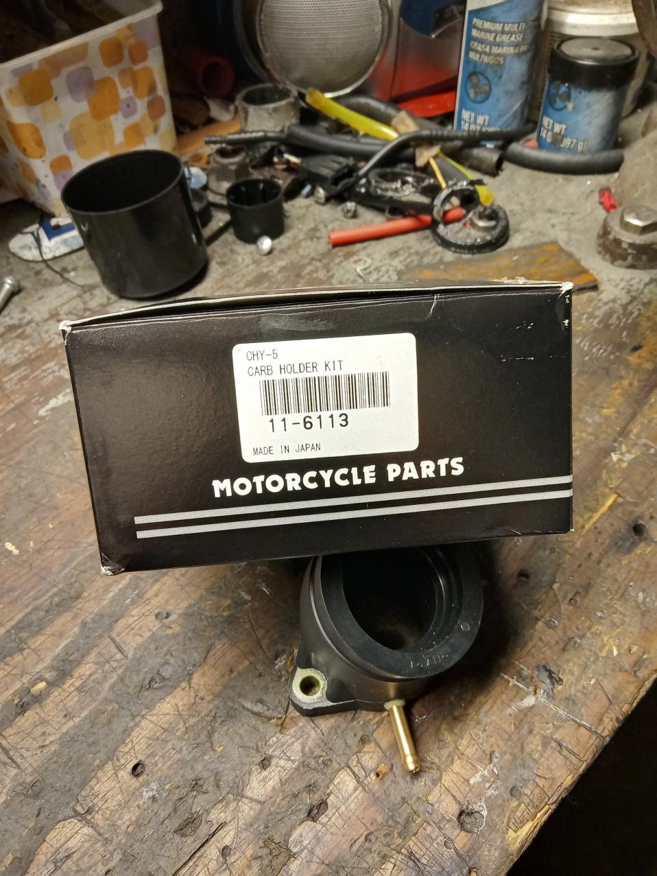

ID:	868526 I like the Tour Max brand, heavy duty, 100 bucks. On the Cheapo 25 dollar ones, the vacuum ports become loose after a few heat cycles. The rubber becomes Click image for larger version  Name:	IMG_20220425_220417.jpg Views:	0 Size:	174.5 KB ID:	868525 soft and flimsy when they get hot. I won't ever buy the cheap ones again.

                          I modified them before I put them on. I heated them up enough to get the rubber flexible and then pulled the vacuum tubes out. I then scored the brass to give the epoxy something to grip to as well as the holes left in the manifolds. The reason was because we had this discussion once before concerning the lower cost manifolds. Even though these are indeed from Japan, I went the extra step to ensure the tubes don't leak or come out. I have had some of the Chinese ones fail while tuning the bike. The Octy tube on number two was so tight on the vacuum brass that when I pulled on it with my needle nose the tube came right out of the manifold. Needless to say I wasn't a happy camper. i had to pull the carbs and the manifolds and repair them. The ones from Japan are reinforced internally like the originals.
                            Yeah. That's what I meant.
                              • 8891
                              Yep Marty, I had to Google Tourmaster, at first I thought it was golf equipment, but it's actually motorcycle riding apparel.
                              Jim, the way I kept the vaccum tubes from pulling out is by using a thread die on them and then pressing them back in with some silicone sealer.
                              I also developed a strange issue with the Cheapo boots. They would develop a vacuum leak when they reached a certain temperature. After 30 minutes of riding, the idle speed would increase about 300 RPM more than usual. It unbelievable how flimsy they become when super hot. They may work just fine up in Canada.
