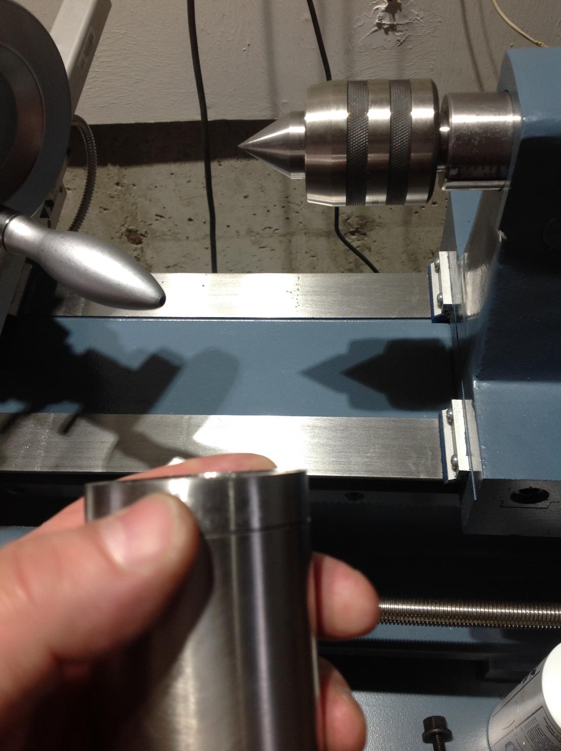

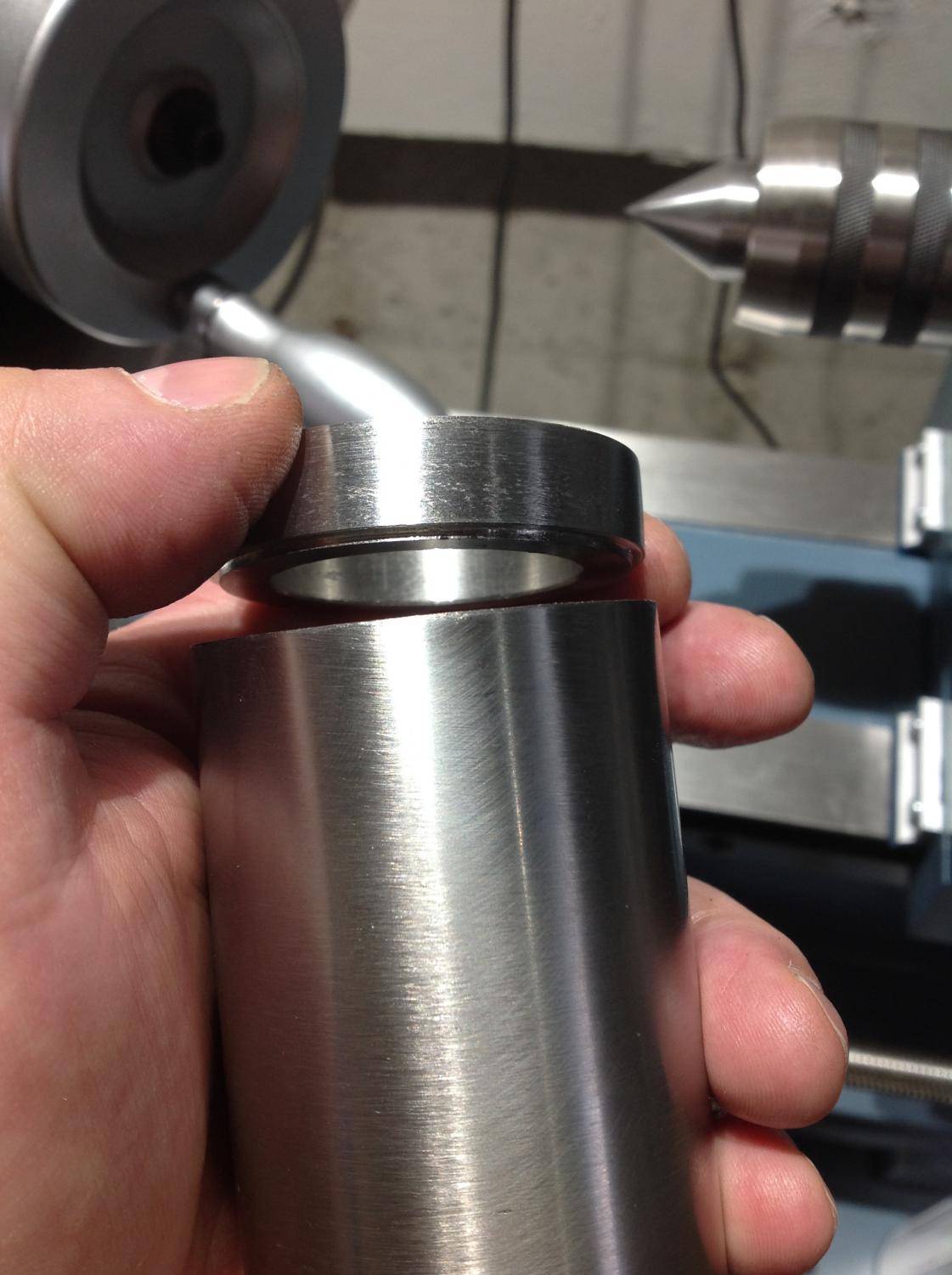

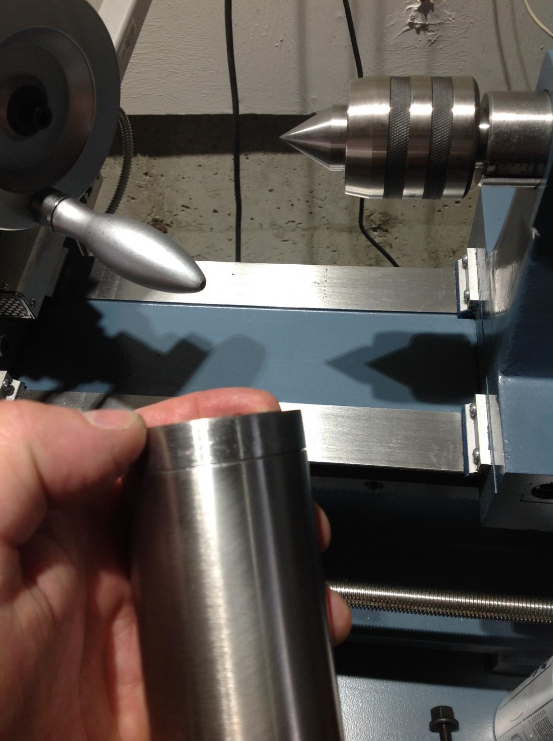

    A few more pics

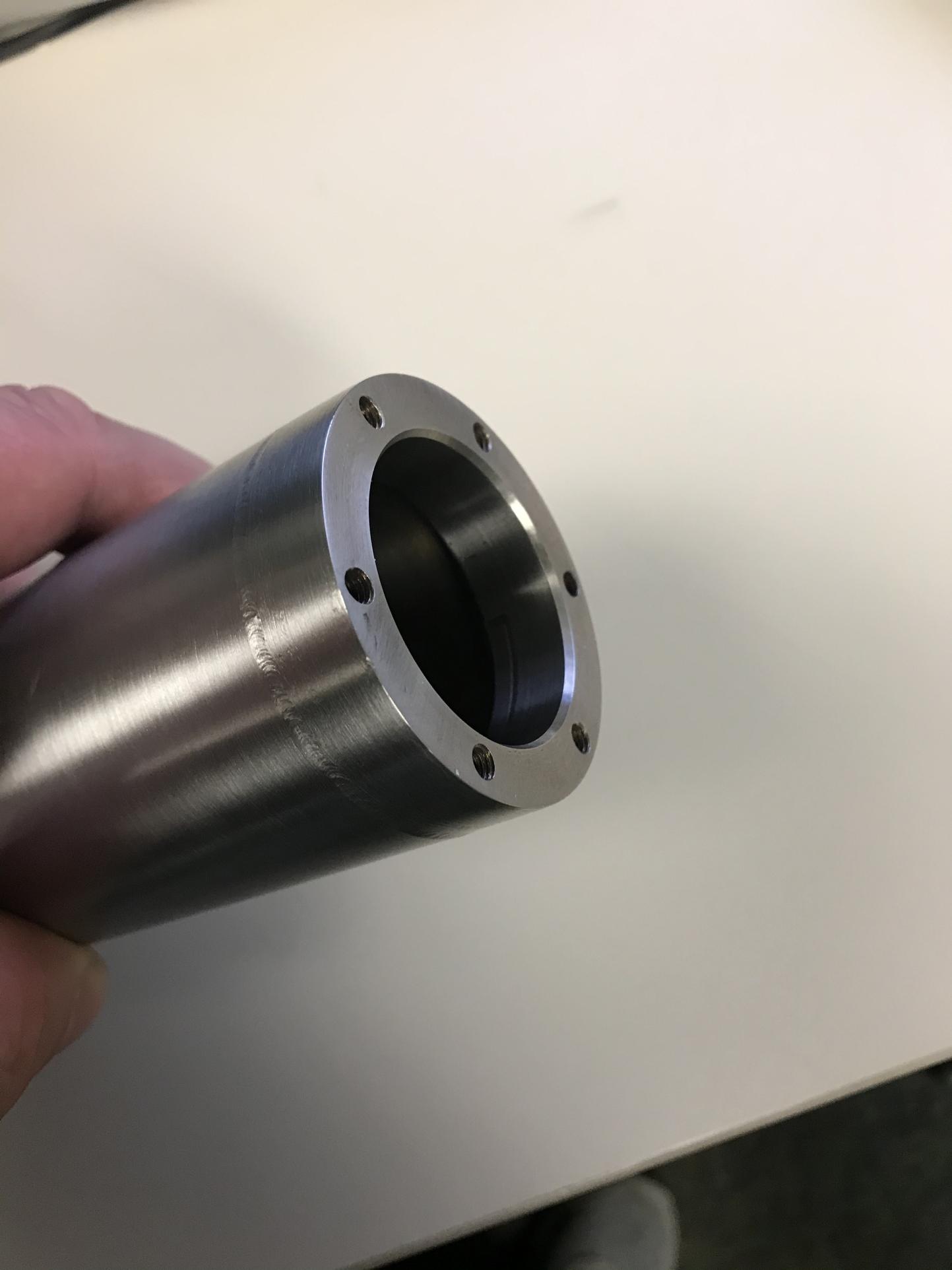

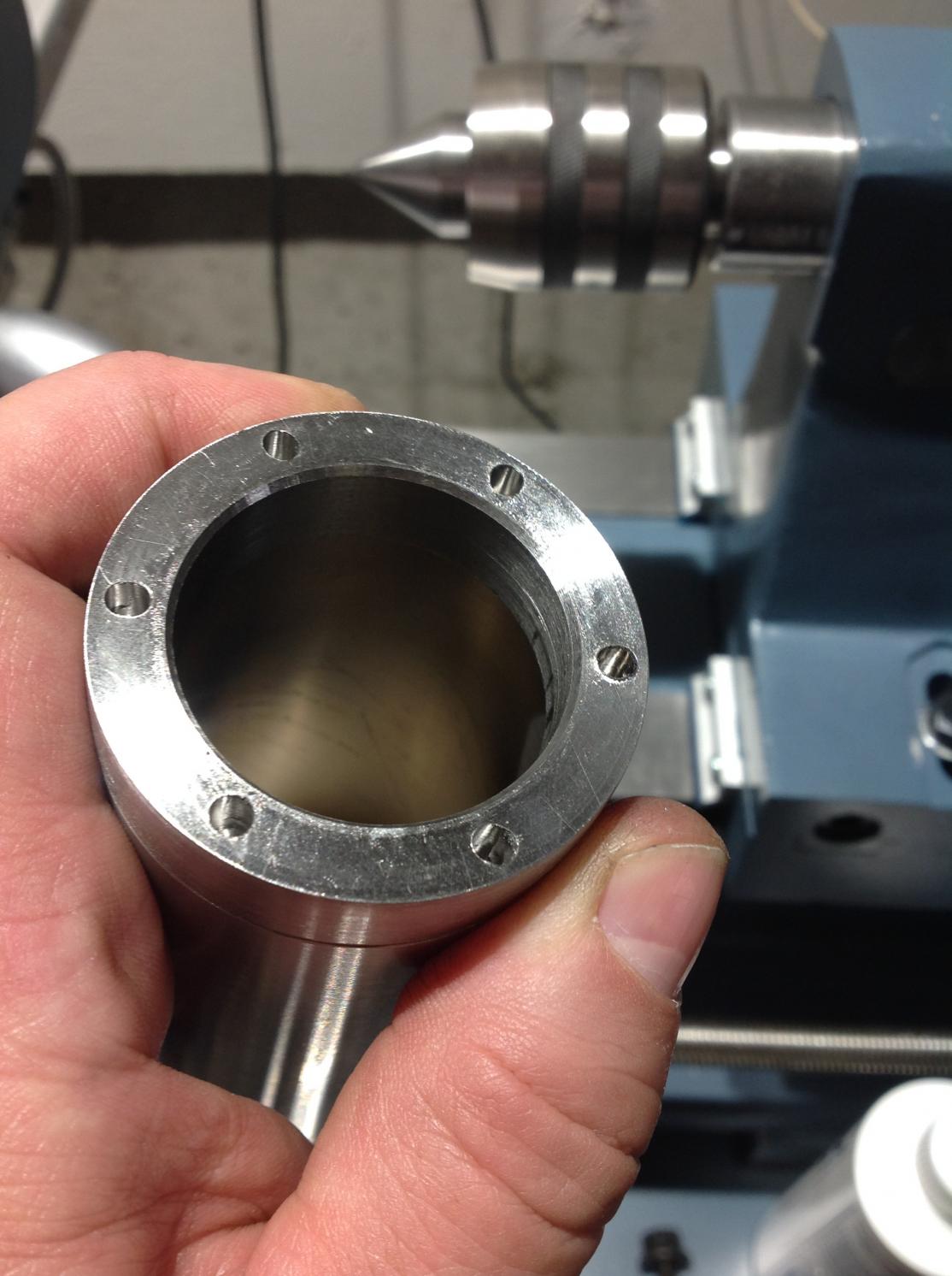

      Internal flange orbital welded.

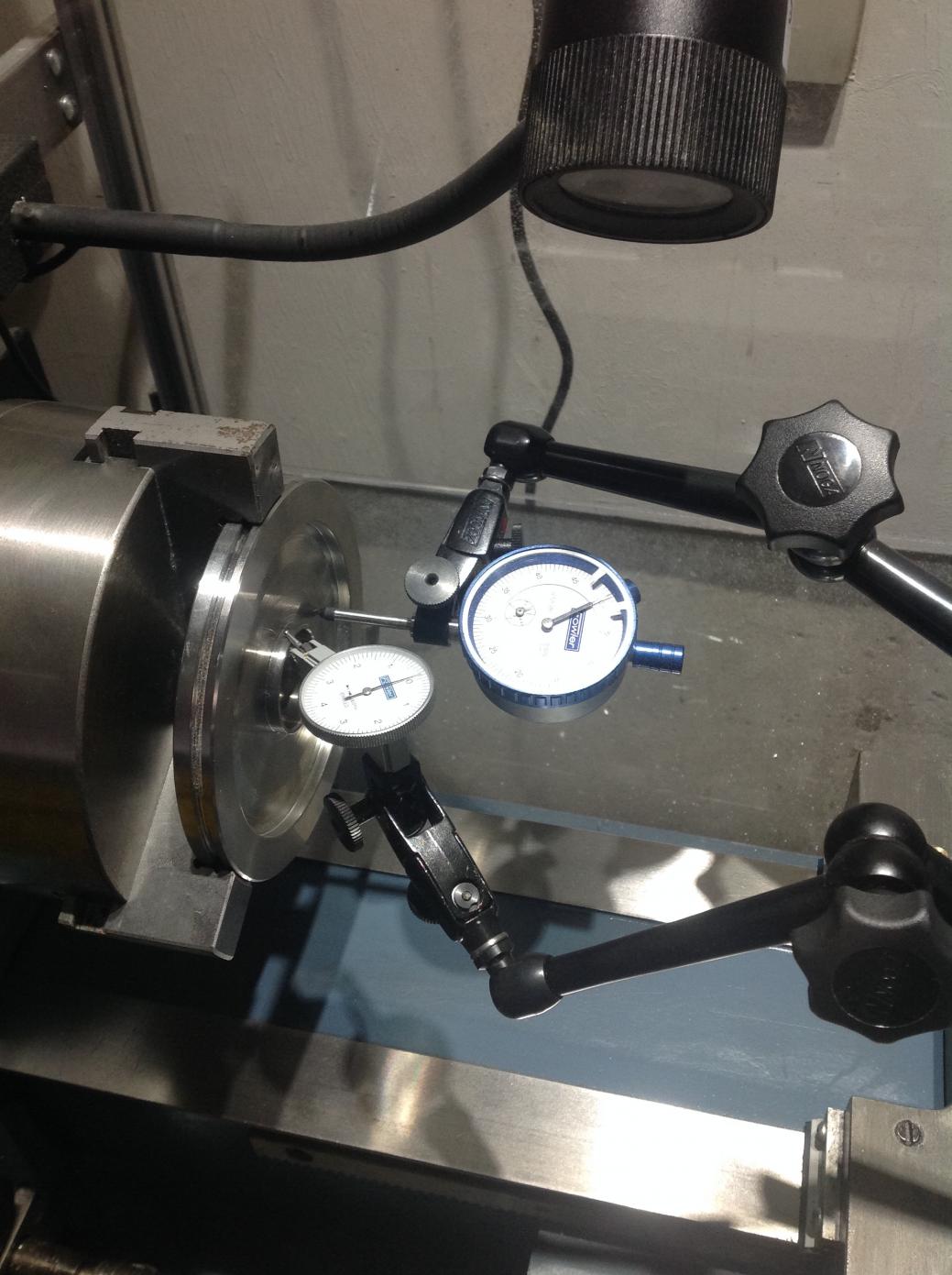

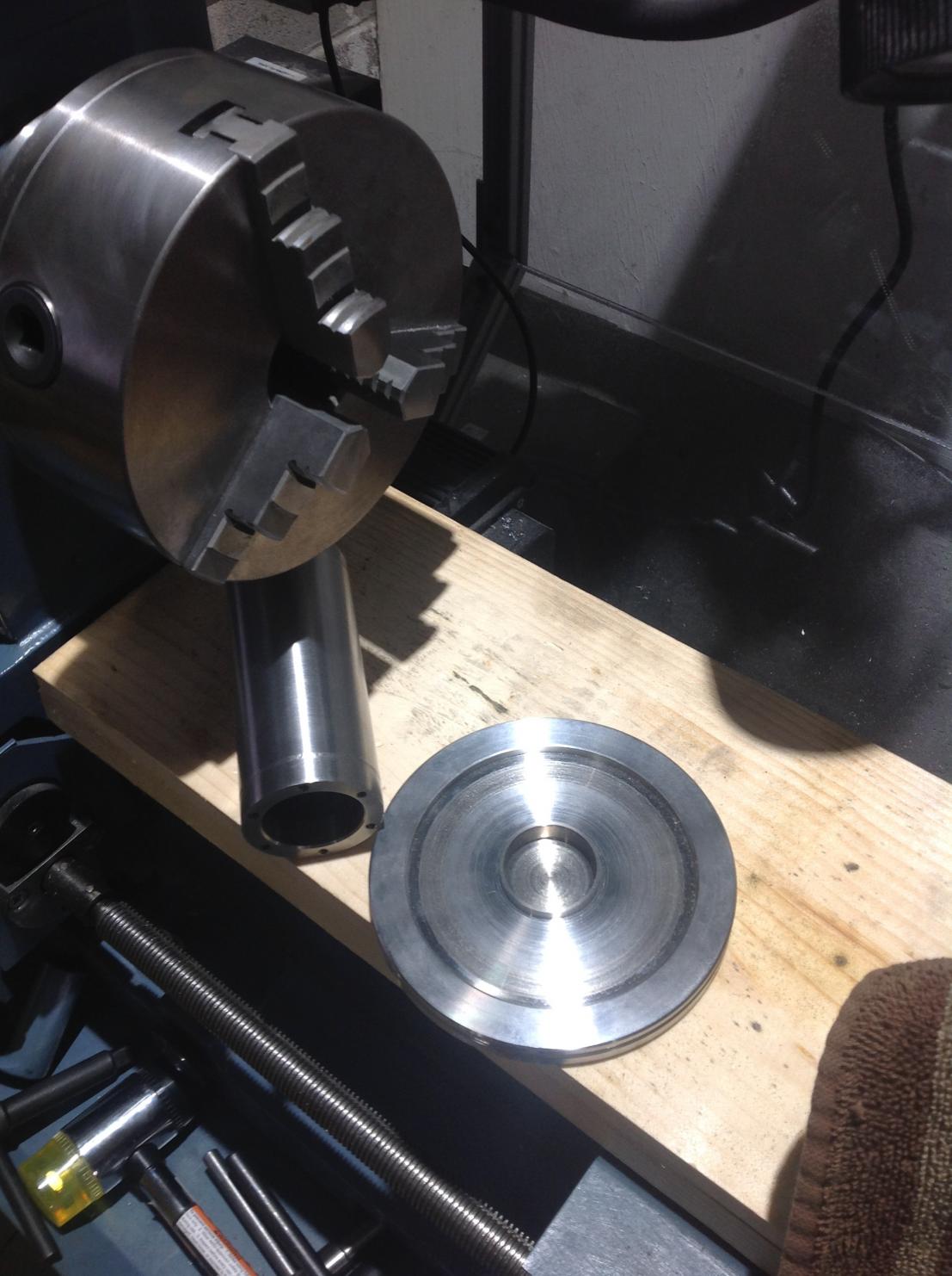

        Finally able to come up for air..... Been a very demanding Spring - Fall at work, semiconductor manufacturing in chip shortage times and issues with the M8 engine in the FXLR sorta shutdown the progress on the XS. Made some changes to the garage during the warmer weather.....it's more like the XS21 work shop now, heated with wood pellets......... The bike is on the lift center stage and the EFI build project rolling along again. I had to take the fuel pump tank cap I was making out of the scroll chuck for another turning job so that'll be getting dialed in the lathe tomorrow.

          The 4 jaw chuck is soooo much easier for resetting work pieces but I got both surfaces back within 0.0005" on the scroll chuck, lots of little taps. Good enough..... Fuel pump tank cover will appear soon.
