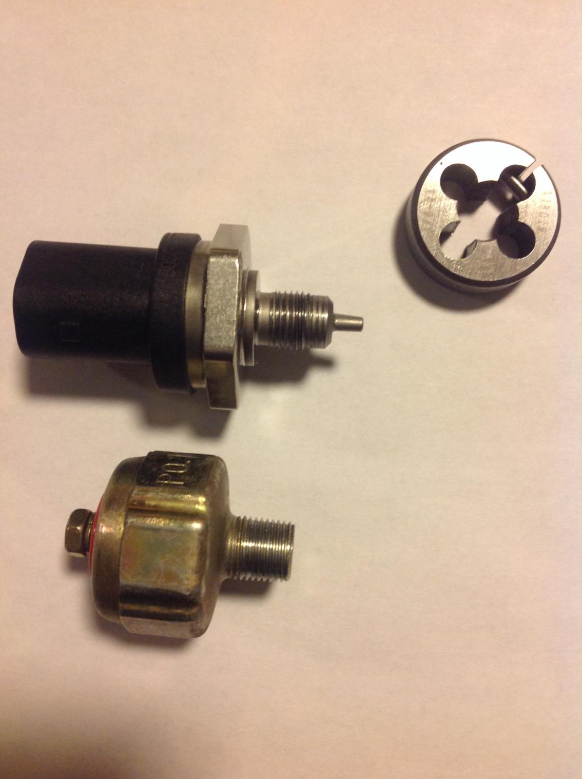

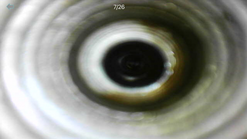

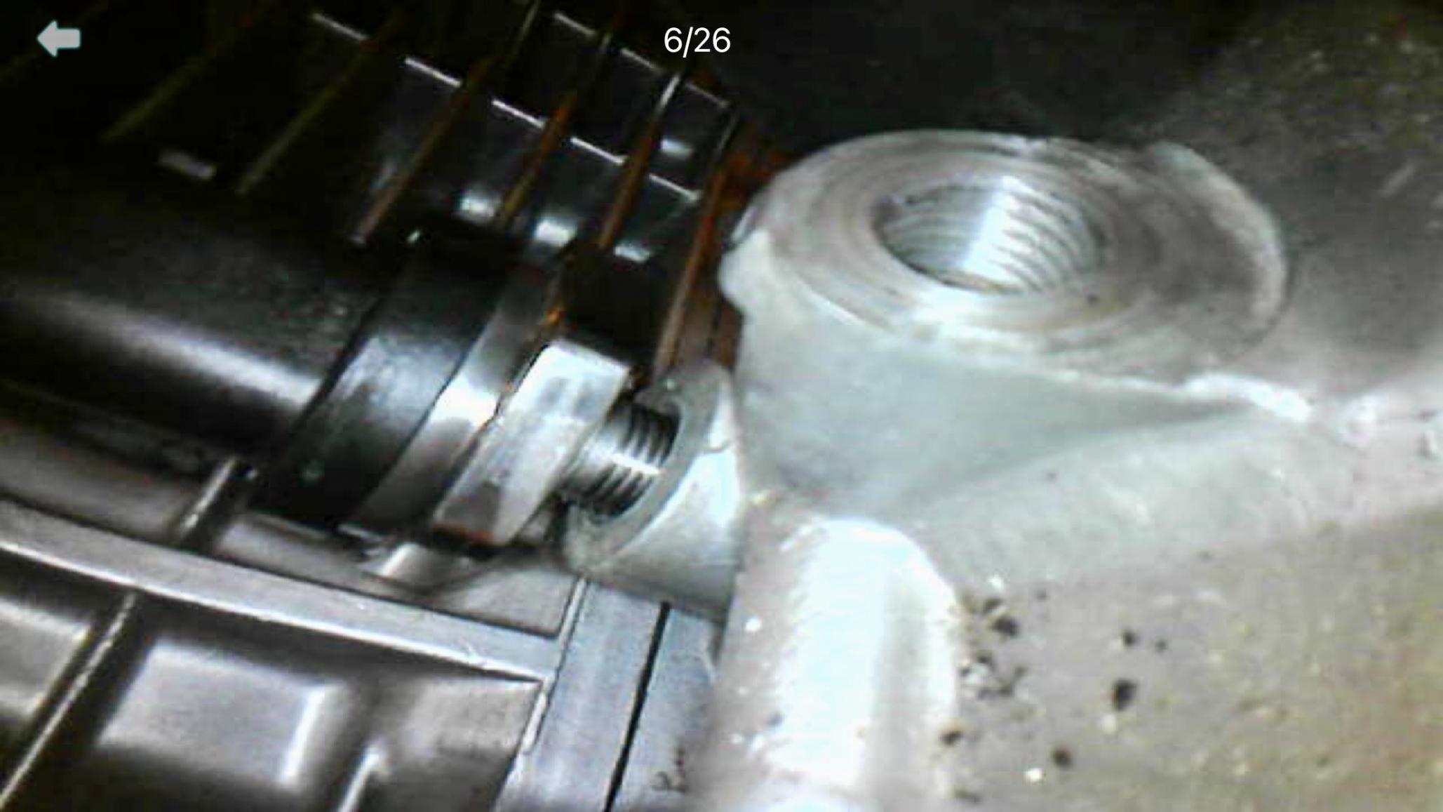

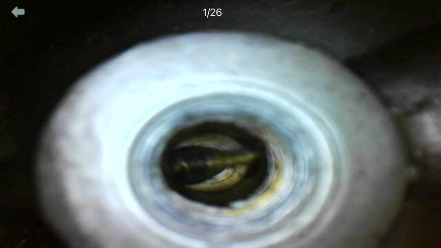

    Looks like the re-threading attempt on the combo fluid temp/pressure sensor was successful. The die was held squared up to the existing threads and a new minor diameter is cut along the sensor mating protrusion. I did a test fit on the bike, looks good, checked the oil passage with the borescope and the sensor tip does not protrude into the passage. Score one for the easy way.
    ---Bax

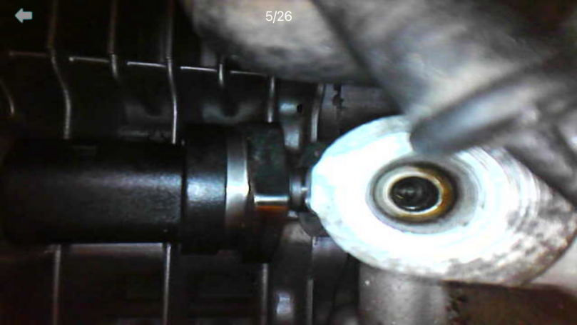

      And the view from the borescope.
      ---Bax

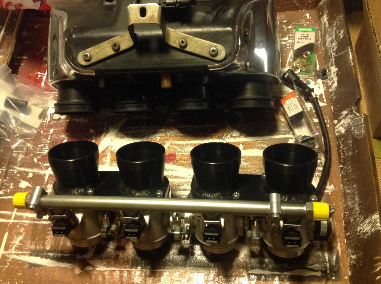

          Fitup on the TB array was spot on.
          ---Bax

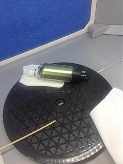

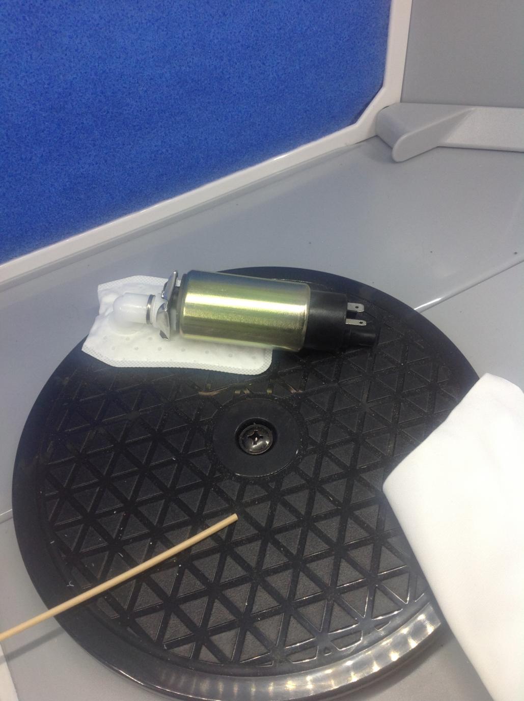

                  Did a bit of assembly with the fuel pump and suction strainer this evening.
                  ---Bax

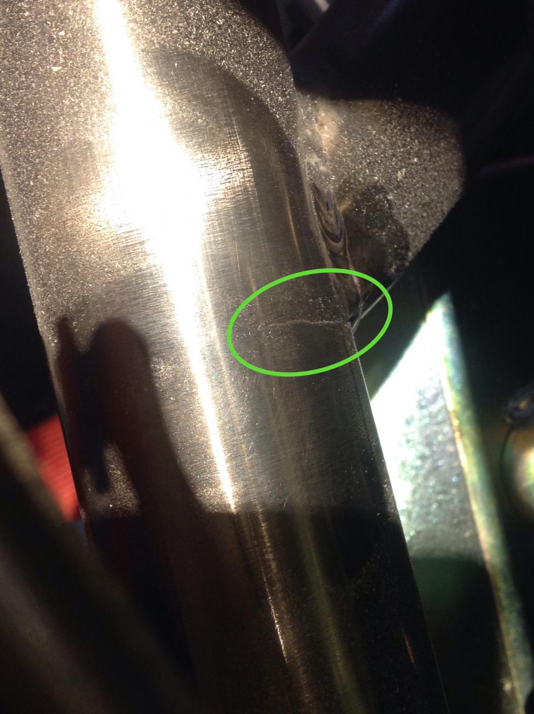

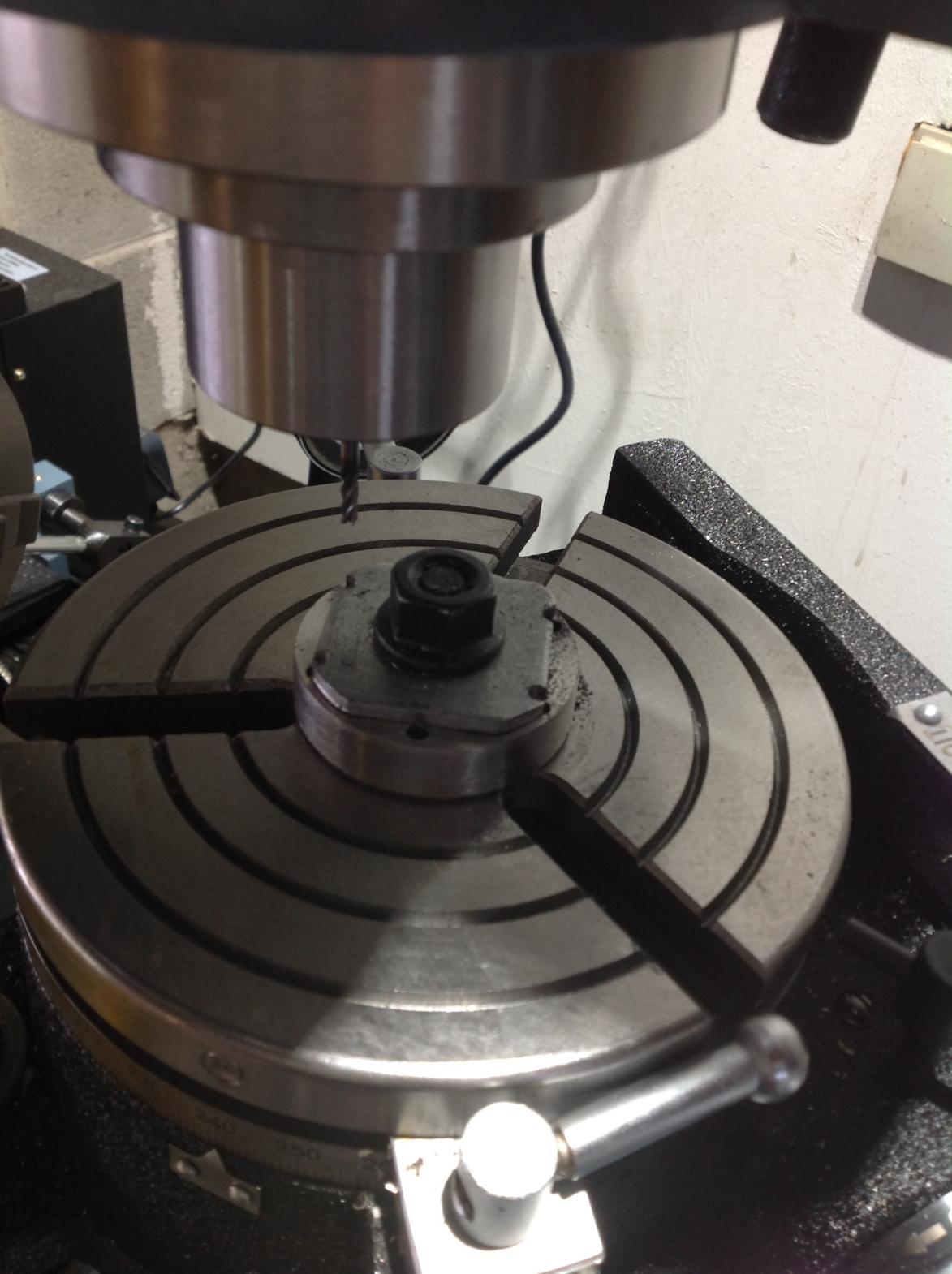

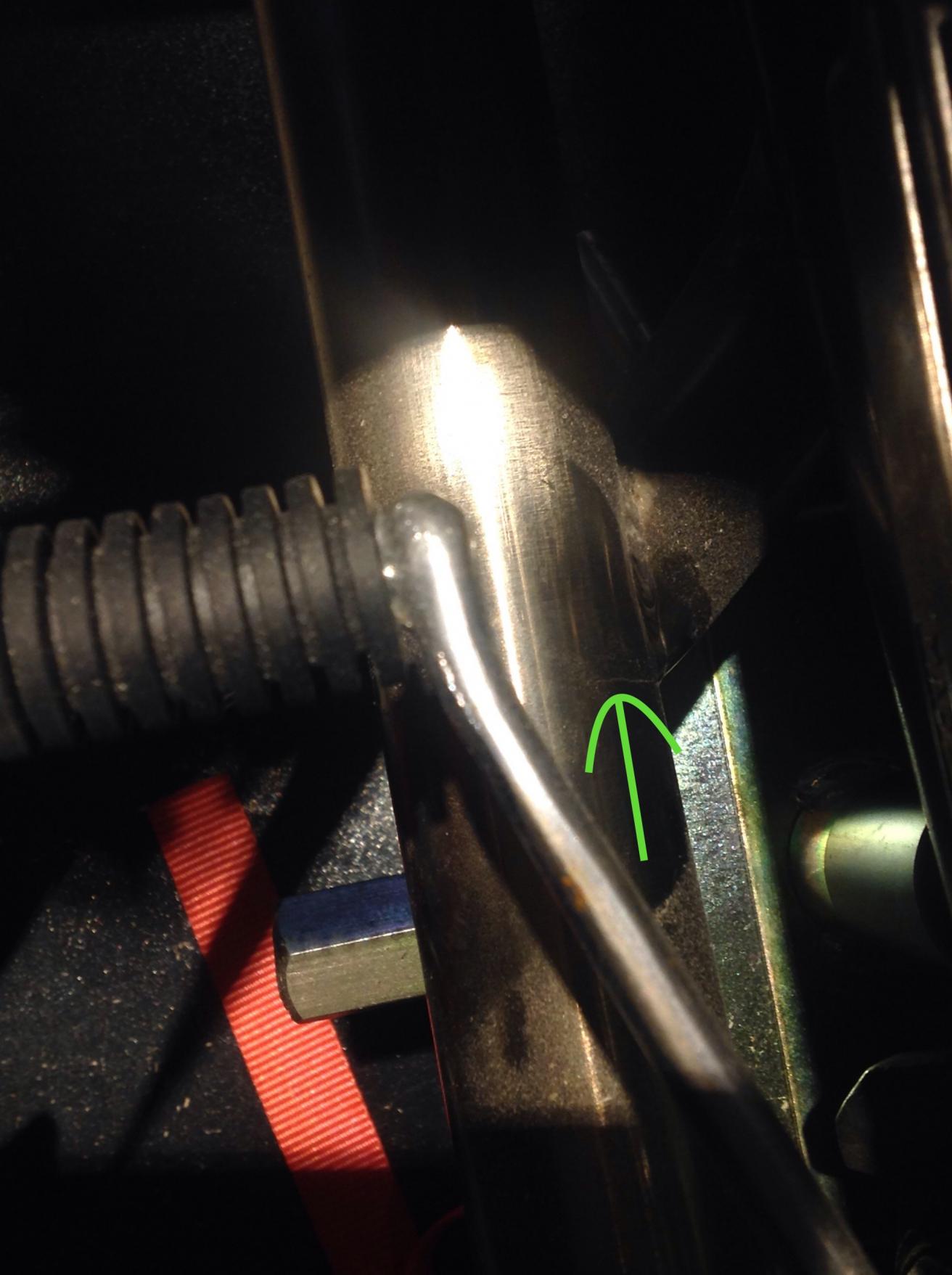

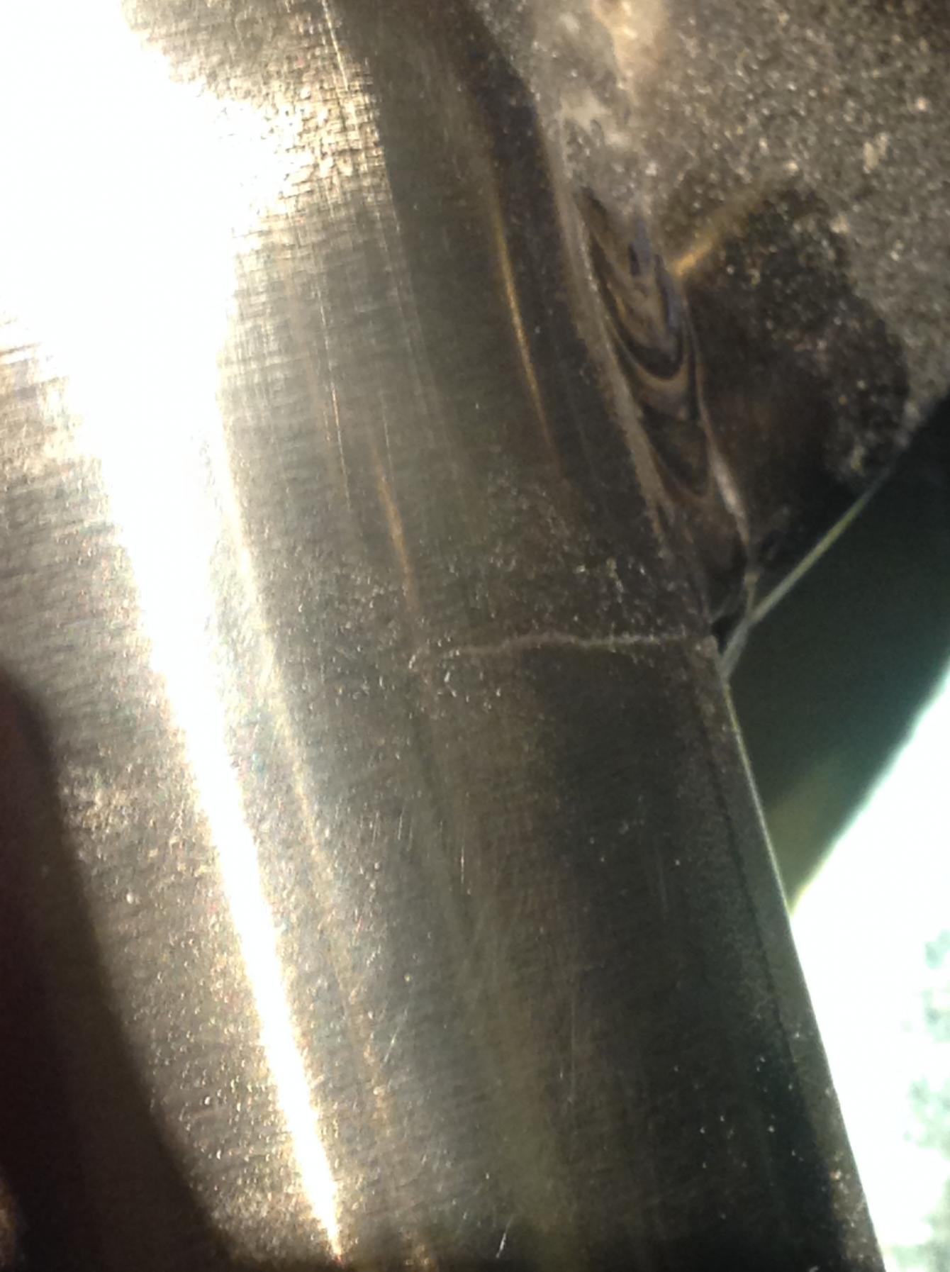

                      Never a dull moment...... Taking advantage of the past warm week melting a clear path between the shed and asphalt combined with a cold night to freeze the March mud the Harley is on the road. For me, NH bike season 2021 started today. Bit of a set back on the XS21 this afternoon, maybe more like something else to fix. There is a nice crack on the Heinz-Wyes SS exhaust where the pipes join below the shift lever....... Ughhhh, the TIG weld repair is easy, restoring the finish is the PIA.......
                      ---Bax
                        #56
                        stress crack from the pipe weld. If you have a bit of SS sheet, I'd make a small triangle from the cross tube to the pipe to reinforce it a bit..

                          #57
                          DiverRay Hi Ray, Yeah it looks like the pipe joining weld was a bit thin and had a stop/start where the crack formed. I'll beef up that weld while I'm fixing the crack. Hopefully it won't be a persistent issue once repaired.

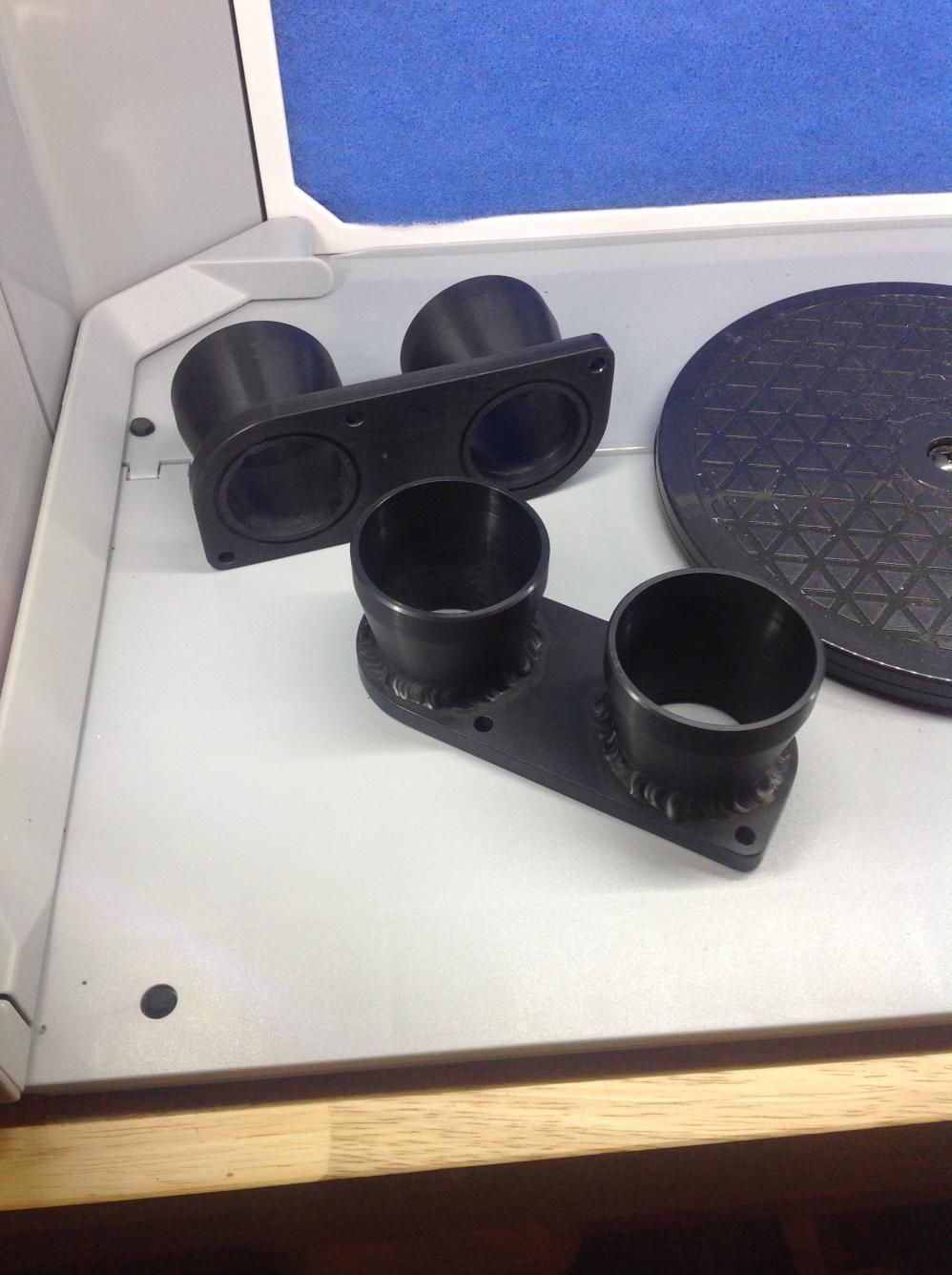

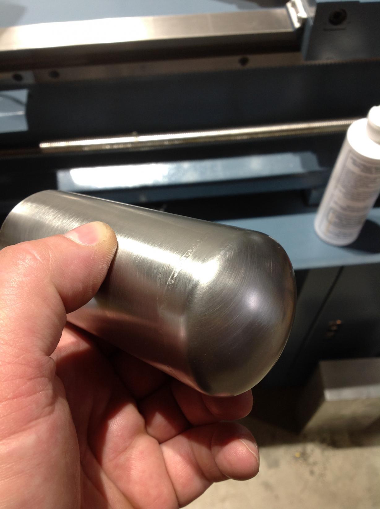

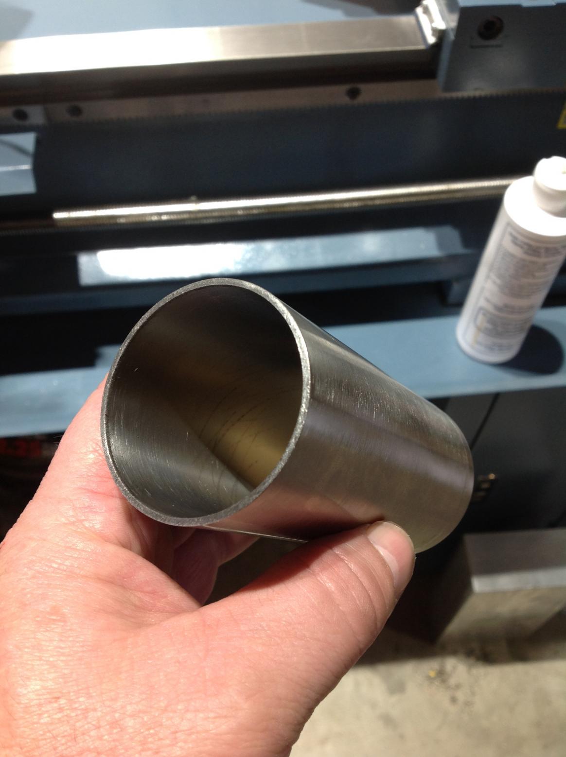

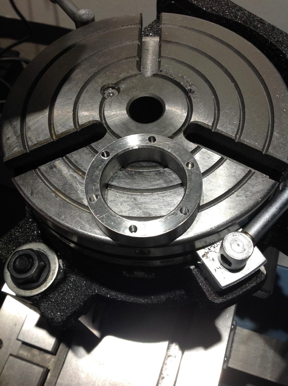

                                Winter project extended to Spring....... Work has been putting some excessive demands on my time and the last kid in the house (3 of 3) needs to get a drivers license and this round of the student driver thing is scary. Anyway, back to the XS project. Had some time this wknd to work on my fuel pump can, 304 stainless sucks to machine...... I'll orbital weld this flange to the fuel can tomorrow and then make the mate up flange with the pressure takeoff and the internal pump supports in the next few days.
                                ---Bax
