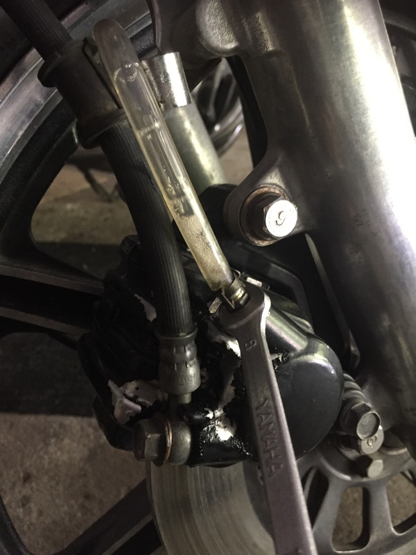

      reservoir keeps going down, i keep topping it up without any air getting in, fluid keeps coming out of the calipher, but no tightening of the brake lever.
      when i take a break, i tie up the handle so its pushed in.
      i guess ill just keep at it ��
      The Mity Vac you're using is the only thing needed to bleed successfully, however, it needs to be hooked up properly
      Looks to me the bleeding bottle is omitted in the pic. If the vac in the pic is indeed a Mity vac brand then on page 21 of the tools manual shows the correct setup with the bottle inline between the caliper and the vac pump, BUT there is an orientation of the hoses that needs to be adhered to which you may already know as I'm not lecturing, just sayin'
      With the MV there is no need to squeeze/ pump the brake lever, it sucks all the air out through the bleeder. BUT, the bleeder threads have to be sealed so I slather a coating of grease with a small paint brush around the bleeder screw at the caliper.
      With that said I've bled brakes successfully, for 40 plus years, on many vehicles pumping, holding, releasing, repeating til I got myself a cheap version of the Mity Vac from HF and wallah no more second person (my daughter thanxs me ) pumping, holding, releasing
      That cheap vac's seal went bad so I picked up a real Mity Vac and has worked perfectly on all the vehicles my family owns.
      P.S. page 22 in the MV manual has the MC bleeding info
      BTW, NICE Twin you have there !!!

            Yes Ill keep at it. I tried using the mitivac on the nipple directly, and then the way it’s intended to work, connected to a container and then to the nipple. I didnt know using method 2 that i dont need to pump handle. good to know!!!

                looks like champagne with all the bubbles in my tubes. i mean, bubbles are rushing out hard. Is this a good sign?

                    I read in the yamaha manual not to use a “speed bleeder” nipple. however my oem nipple is badly stripped so it makes opening and closing the nipple difficult. so i had a new speed bleeder lying around and that’s what Im using. just wondering what problem would it cause?
                      www.xs650direct.com/products-50.html
                      The speed bleeder or a stock bleeder, when using the MV, should be treated the same.
                      This is the way I bleed my calipers.
                      1) Top off the MC with brake fluid (leave cover off to monitor level)
                      2) Make sure bleeder nipple can be loosened and it has a good seal on the threads (grease for me)
                      3) Connect MV like you have in your pic
                      4) With nipple closed (either type) pump the MV to at least 15 and stop, make sure you have a good seal and if so, then open nipple, let it draw fluid through then close nipple when the vac gets down around 5 and repeat til no more bubbles come through the line. Remember to check level in MC between each sequence of bleeding.
                      Might take a couple of times but I haven't had to pump the lever at all using the MV and my front brakes, with SS braided lines from XJ4Ever.com, can and are applied with two fingers at every stop.

                        The mighty vac has always leaked air around the threads of the bleeder nipple. It will give the impression that there is air in the brake system even when there is none. If you do the mighty vac while pumping the handle, it will give the best results (2-person operation). Of course you might have to move to the other fork side to get out all of the air. I used speed bleeders on both sides and replacing the fluid was quite easy without a mityvac.
