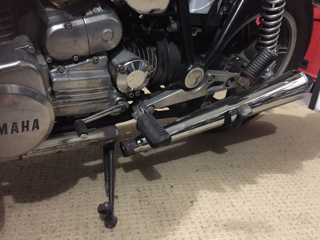

                The muffler can be repaired, but it will no longer look like new. I've had to weld up a muffler for the same reason on the MNS I had. Someone with a wirefeed welder should be able to repair that in less than 30 minutes.

                        So the muffler falling apart was my fault. In the spring I saw the mufflers were not symmetrical. So I tightened the bracket holding the muffler a little too much. After a few months I guess it snapped the weld.
                        Muffler has been rewelded and reinstalled on the bike. $100 mistake
