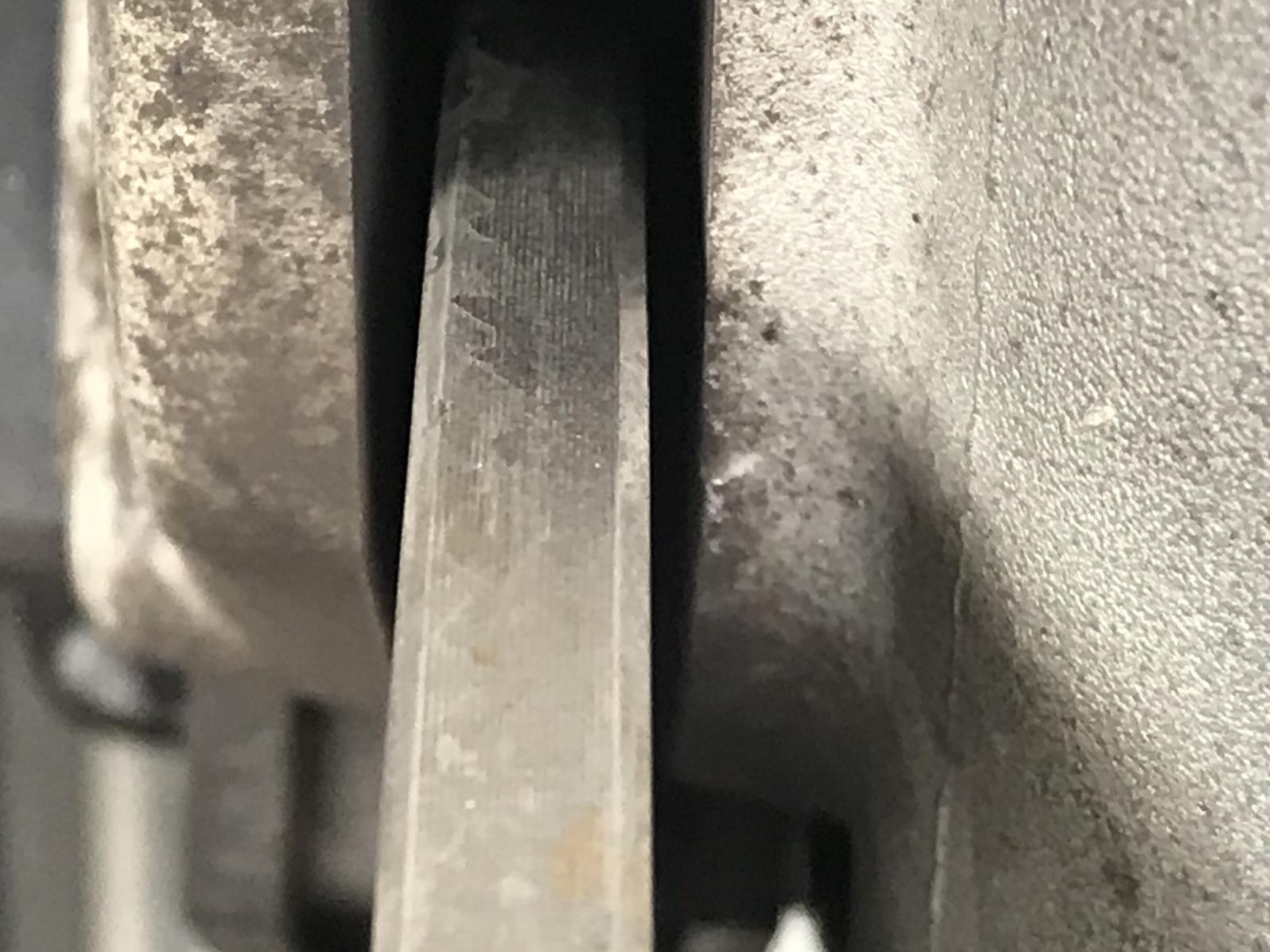

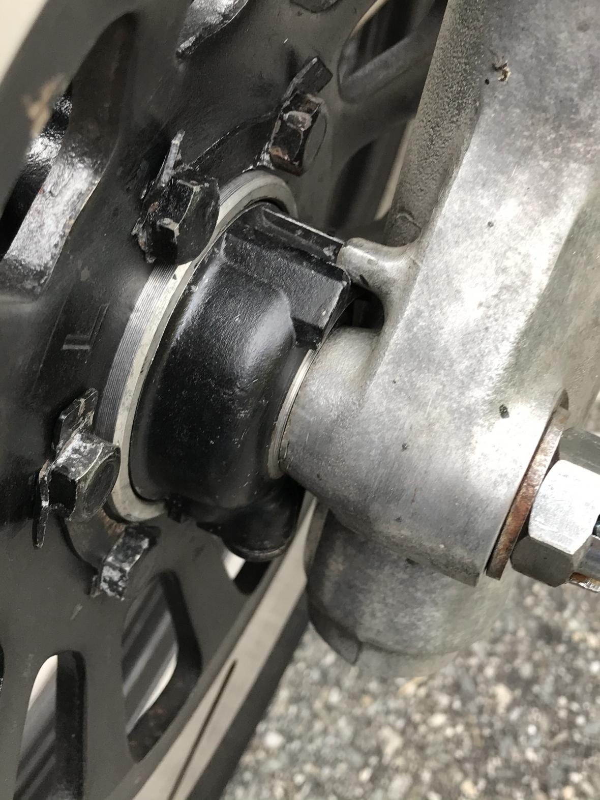

              Hi Cajun, Yeah, the centering took a bit of extra effort and parts to resolve. Not sure of the cause but this bike was off about 0.9mm from a centered rotor on the left fork (non adjustable side). I had to add shims to the stack up on the axle to return the forks to a parallel condition and rotor center. Along with several other small tweaks the brakes now work well with no pulsing or drag.
