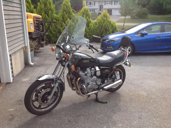

    Hi All,
    Starting this thread for my SG.
    Got a great bike that is almost all original and been well kept for the age. Two previous owners and only ~18K for mileage. It does have a small shake on the front forks when braking and a harmonic shimmy at speed, three shakes for about a sec and smooth for about a sec. When it warms up a bit here in NH and my teenager gets "his" Jeep out of my garage..... I'll be putting the bike on the lift and pulling the front forks to resolve the handling issue(s). Hopefully in a week or so I'll have a second SG for parts and speedy type rebuild project. I'm sure I'll be reaching out to this crew for advice.

                  New site, post update: So the bikes in the Bax Cave have changed a bit, gave the 06 Shadow to the kid, after USCG bootcamp grad, Karen gave up riding and sold the 05 Vulcan, 18 FXLR added on the same day the kid had HS grad.... Now the XS, 80SG was kept on the road and still my favorite bike. Had a SF for a bit as parts bike but then passed it along to friend who was looking for a project bike. The SG needed a bit of upkeep, past the handling/brake issue noted at the start of this thread...... So took 10 days off of work and got to work, new battery, AGM type, restored the battery brackets, installed the Heinz Wyes stainless exhaust I got a few years ago, rebuilt the BS34iii carbs, rebuilt all calipers and master cylinders, new rubber anything in fuel delivery system. I did do the VR update from Tony and have the fuse box from Len in shipping. New tires and SS brake lines along with a new set of bars.
                  Okay, Big takeaway with the Specials front brakes..... it all adds up. Small issues make incremental improvements when corrected. My hope was with caliper rebuilds the front brake shake/pulse would be resolved but no, just slight improvement......... I've been thinking the shims for some time may be contributing to the front braking mess as the backing tape was partial and folded in areas along with my several attempts to restore the shape so I dug up some NOS shims and installed. Now this helped with the minor drag but still not right. Back to checking the bolts for bends, nope still straight. Pressure align the calipers when tightening, put a clamp on the brake lever with a damn good squeeze and then tighten the calipers to the forks, BINGO!!!!! Major improvement in all functional aspects with this procedure. My pads and calipers now float slightly when no brake applied with a nice braking response through the range.

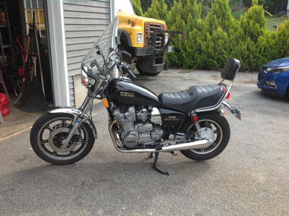

                    My SG passed NH inspection this morning, back on the road...... Enjoy the holiday wknd. I'll be adding a few more cruising miles on the XS during this long wknd.

                              Will be making the the trip to work tomorrow on it. Fingers crossed......
