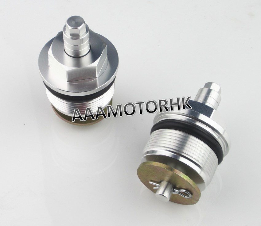

          Am I right in assuming that the air assist forks have mo mechanical preload adjuster? If I could find a pair of those then I would not have to butcher a set of normal ones. Also, It would probably give me the 18mm less preload (emulator + difference in spring length) I'm looking for, whereas cutting mine down would only give me about 10mm less preload.

            The threads are the same and there is no preload adjuster in the air caps. The problem lies with the depth of the thread. Look towards the bottom of this thread for more info...

              There may be an aftermarket cap like these:
