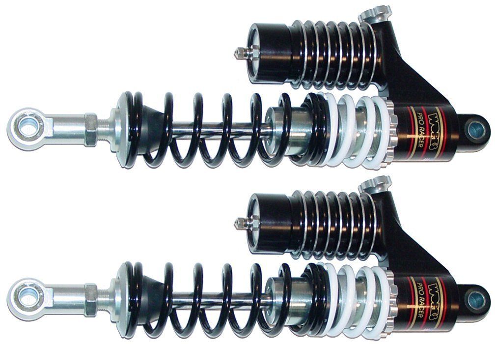

These are the shocks I'd like to go with, but at almost $1k I'll have to save up
They're Works Performance - here's the link: http://www.worksperformance.com/html/vintage.html1980 XS1100G "Dolly G" Full Dresser (with a coat of many colors

Finally got some time to swap out the rubber shock mounts from Honda to Yam. The shocks fit fine with no interference and they look good. I was worried they were a bit "fat" but the XS isn't a dainty bike so they look about right.
With me on it (160 lbs) and less than 1/4 tank of explody stuff the sag with rider is about 3/4" on the lowest pre-load setting. I think my stock ones had about an inch and a half of sag which is too much. On the road they feel quite a bit stiffer and sportier than my old stockies but not uncomfortably so. I always had my stock ones at minimum preload and they would almost bottom out on big bumps in corners. These give me way more ground clearance and confidence in the corners.
There's a corner I ride with a bump in it that would always grind my center stand. Takes it like a champ now.
At least now there is damping in both directions and there is no tail lift or drop with throttle variation. These would be perfect for heavier riders than me as well, although the 3/4" sag is a touch low for my weight the rebound damping does not let it top out. Maybe with a full tank it's a full 1"...
Verdict: Great sporty replacement for the stock under sprung shocks. Modern damping and can be had cheap from upgraders. Especially good for riders 160+
