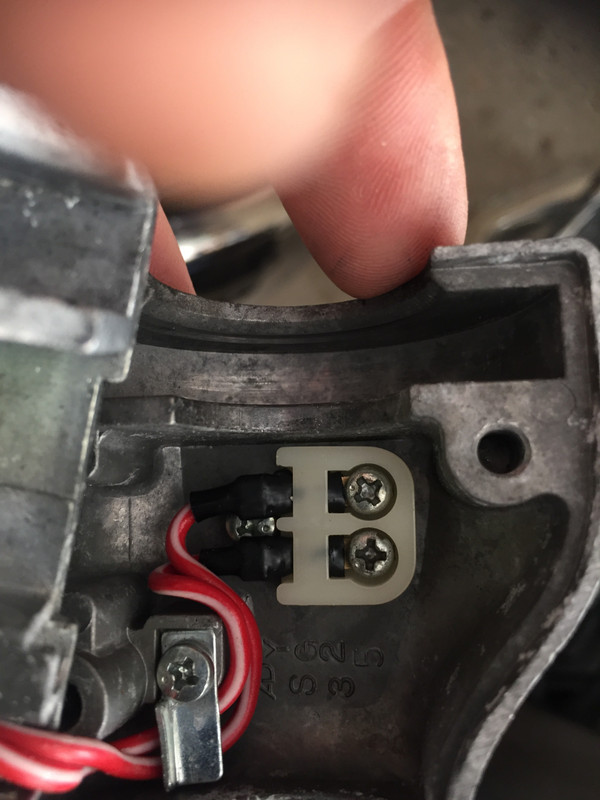

                  -i did open the right controller, looked like wires were fine
                  -i sprayed electrical cleaner in it, just because... no improvement

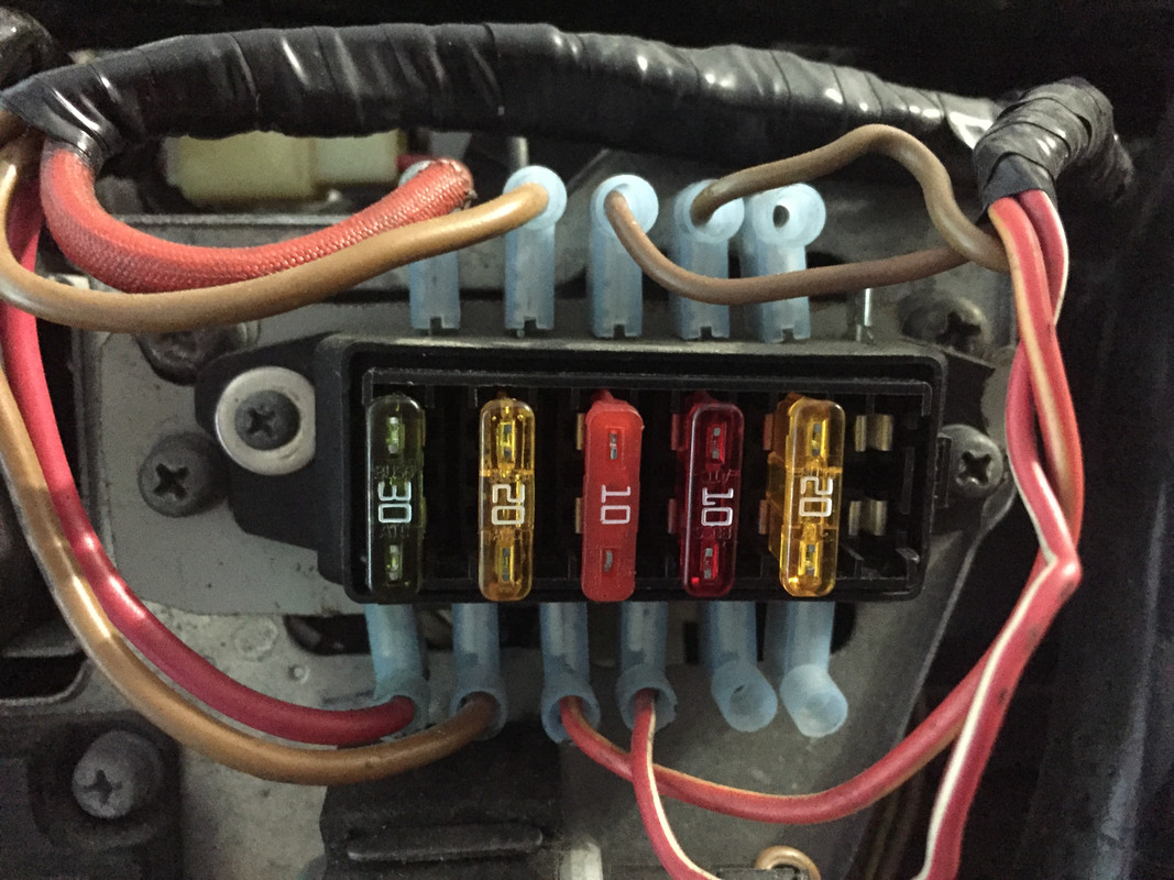

                    my fuse box blade configuration
                    which blade would be responsible for starter button?

                      Clymer says from left to right it should be 30 main, 10headlight, 20turn, 10ignition.

                        seems all is clean and firmly connected.
                        i think i need to follow that blue/white wire to find my problem

                          How did you make those crimps on the fusebox flag terminals? The flag terminals on the smaller gauge wires are too big. They should be red. If you can pull on any of those wires, and they come out, that's at least contributing to your problem.
                          Corrosion in the switchgear is no good.

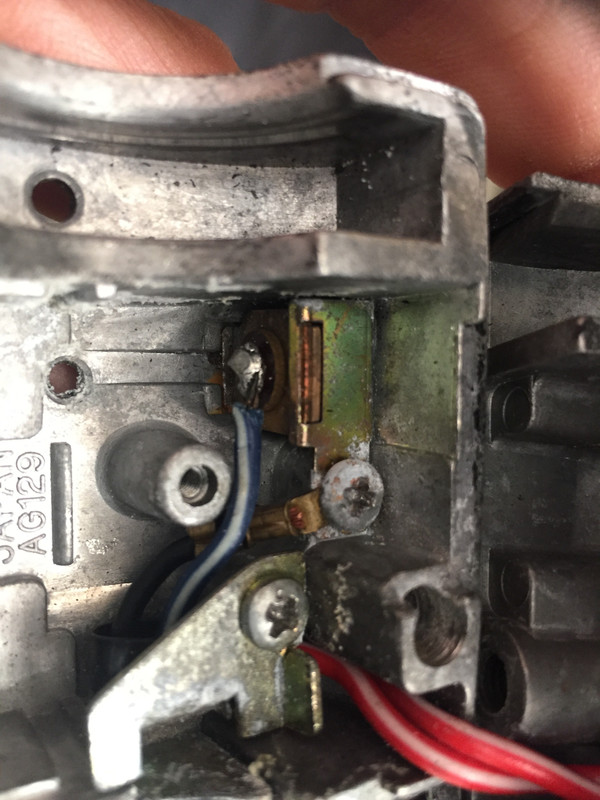

                            Try taking the button assembly apart. clean up all the contacts and re-assemble. Just work on the starter button for now, but you may need to do all the contacts as age IS a factor.(I can't be old yet!)
                            Also, looking at the photo the ground wire could use cleaning as well. it's the screw that holds the starter button assembly in.

                              i want to take the button thing apart but i dont know how it comes out. when i unscrew everything it doesn’t dislodge, do i pull it out? the ground wire (blue /white) goes into the button housing, the screw on top is soldered tight, should i rip it out???
                                it comes out from the inside of the case. when you take the screw out, there's some spring pressure that hold it in places. A little wiggle and you should be good.
