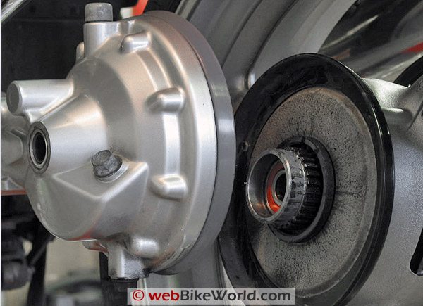

                                Instead of the R1 wheel you could opt for the FJR1300 rear wheel, although I do not know about availability in the States. The rear disc is bigger too. This wheel already has a separate cush drive for its shaft. Styling is almost the same as R1.
                                Pic shows FJR1300 cush drive:
