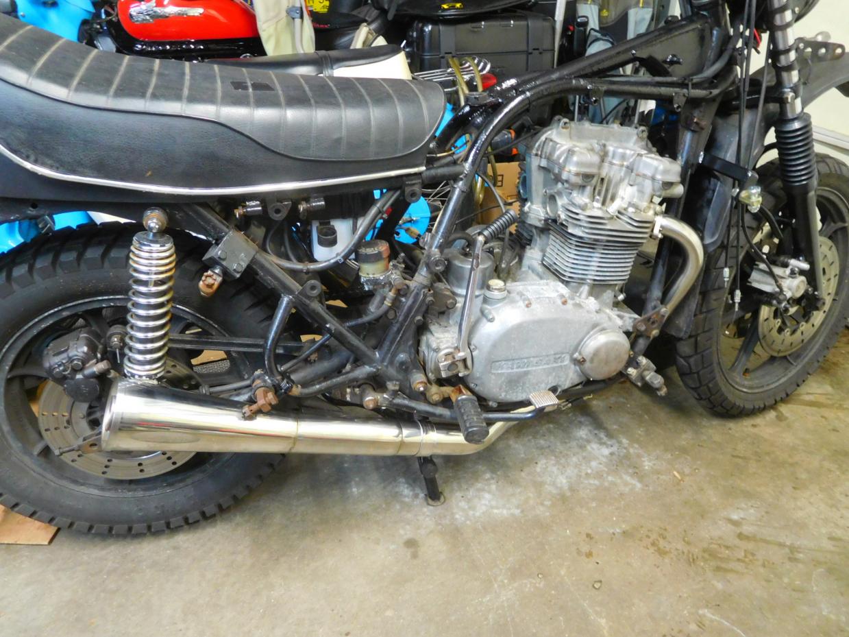

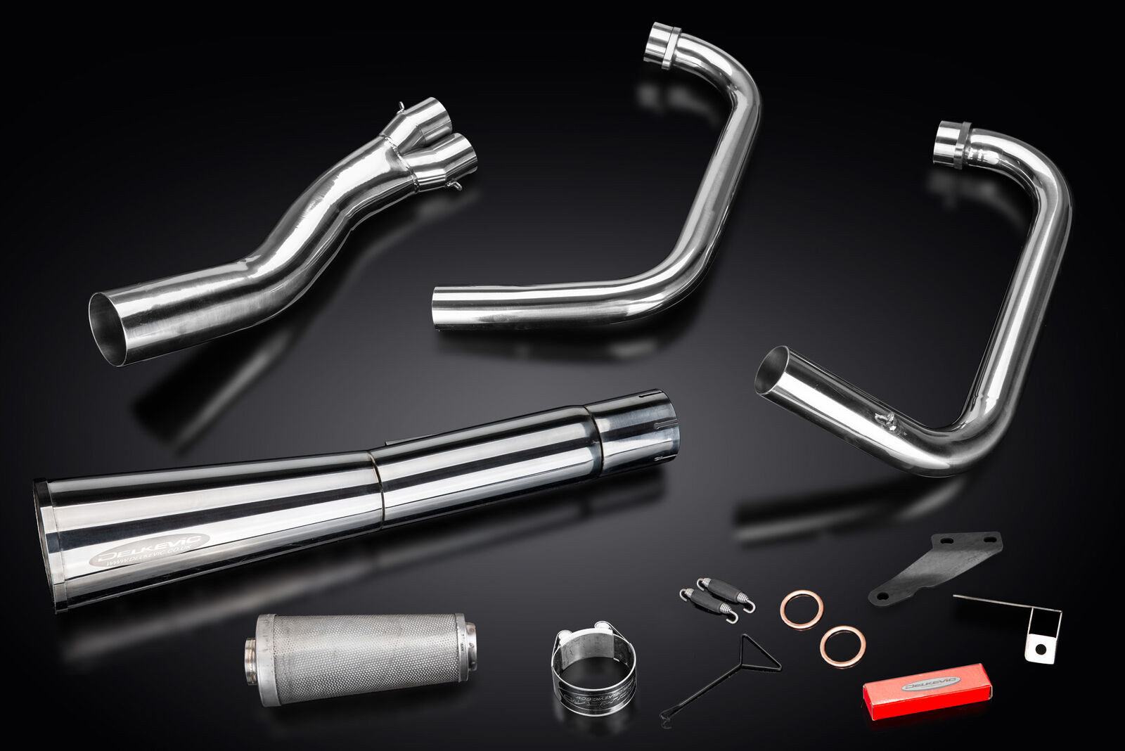

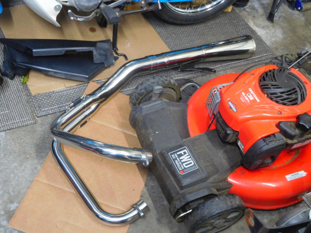

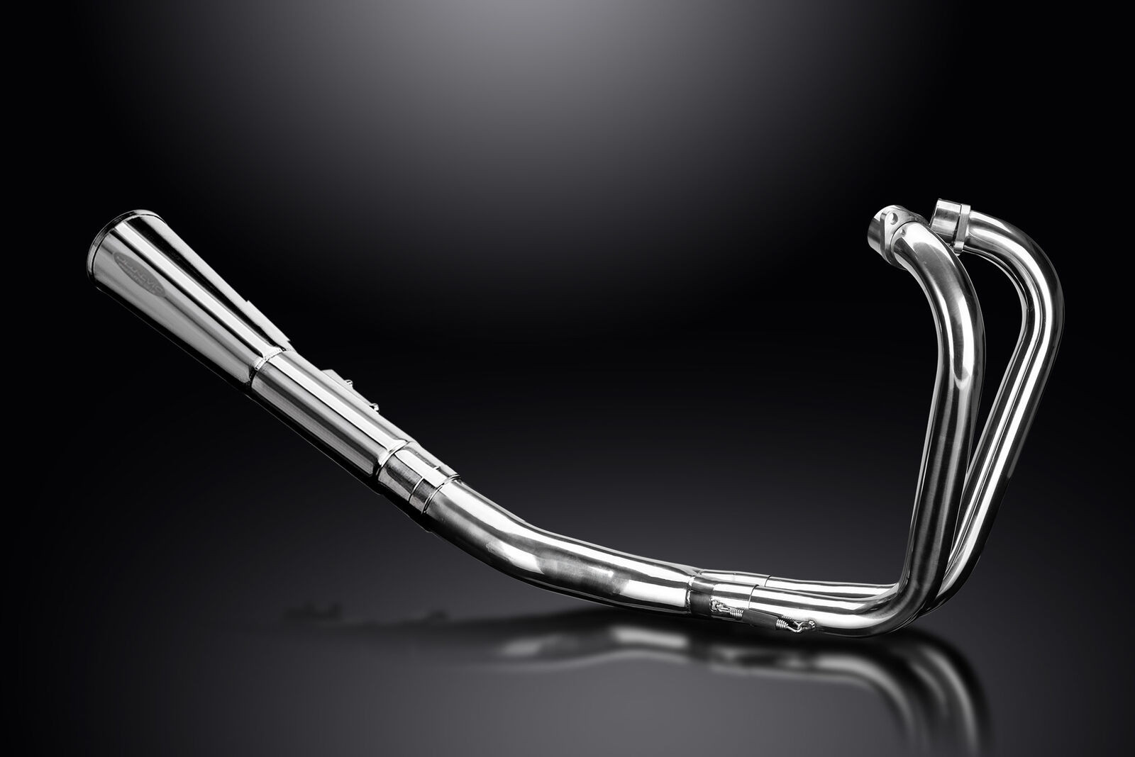

    New stainless Delkevic exhaust. I have been through countless plain steel exhaust systems that rot off. Hopefully the stainless holds up.

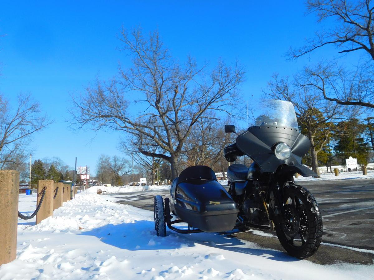

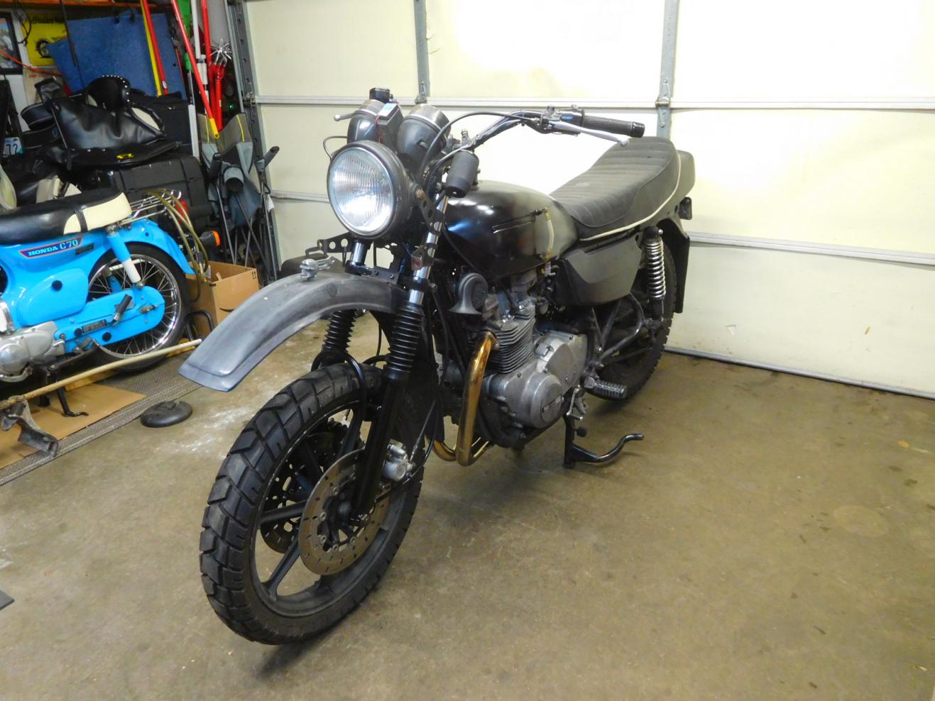

      It runs! My wife is mad at me because I'm wrenching after I got surgery to my foot. The yellow thingy is a pin in the bone.
      Click image for larger version  Name:	DSCN1953.JPG Views:	0 Size:	121.0 KB ID:	877285 Click image for larger version  Name:	DSCN1910.JPG Views:	0 Size:	92.7 KB ID:	877286

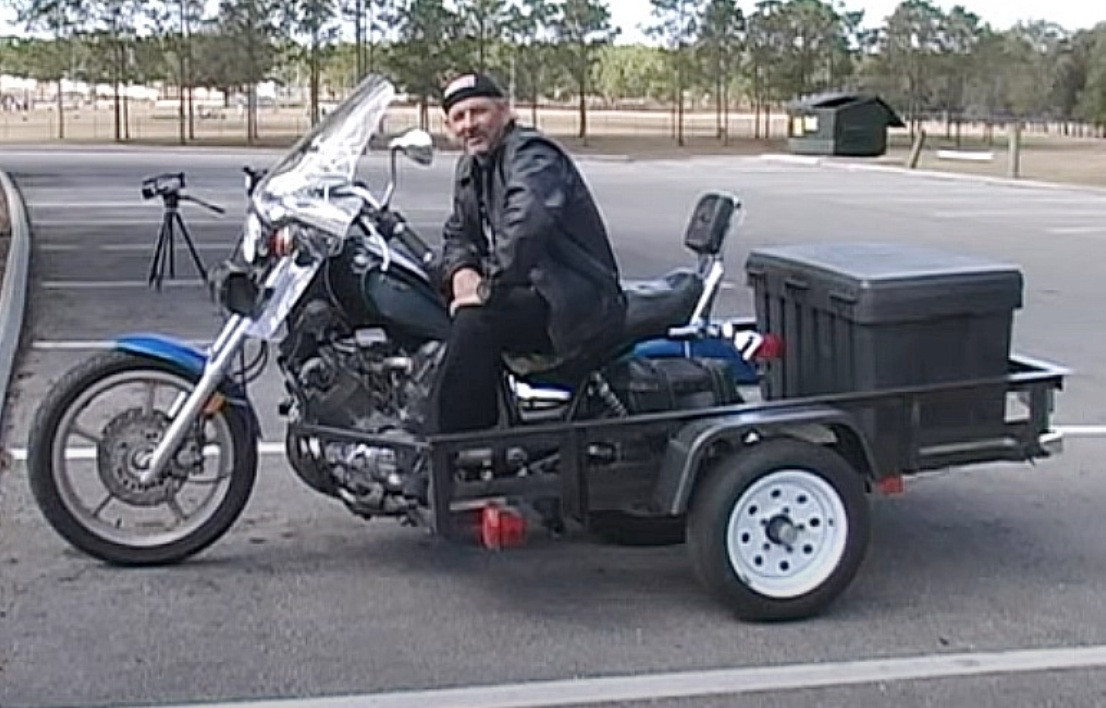

        That's the way I'd put together a winter time bike for sure, a twin or big thumper in order to keep it simple! Had a 920 Virago some time back that I rode whenever the streets where clear enough and the salt ate it up quick!
        Sidecars are an expensive proposition, I'd thought about some form of outrigger like you see on the ice racing bikes to help keep the costs reasonable.

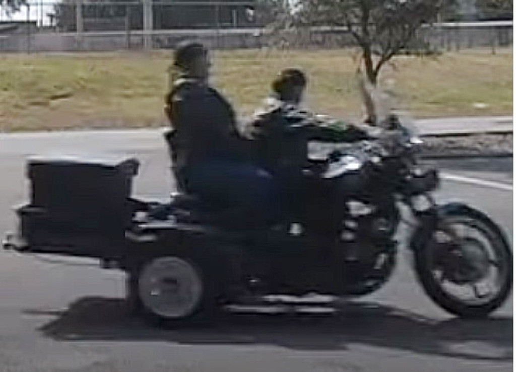

        There was a guy selling a video about 15-20 years ago of what he called the "Super trike" which I believe to be the the precursor to the bolt on trike kits you see today. It's basically a 4X6 trailer with the tongue removed and a "slot" about two feet wide cut into the bed from the front back to the axle. He fabbed up a way to mount it up to the rear pegs and also the front motor mount, this gave him 12" wide "Running boards" on the sides of the bike and a 3X4 trailer to pile stuff onto! One picture I saw of it had him hauling a washing machine on it.
        PS: found the video
          • 1785
          That was very interesting and inventive. I like the way it converted the bike into a pick-up type vehicle. Not sure how it would do in the snow. Really would need a car tire on the back as a conventional motorcycle tire would get eaten up quickly. He really whipped that rig around and it looked impressive. I looked for more info but could not find any. Looks like he used to sell on eBay.

            Like I said it was probably 15-20 years ago when I came across the video on eBay and I bought a copy, super low budget shoot of him cobbling up the mounts. Just seeing that little bit of video is all you really need to know other than the fact he made a really basic "independent rear suspension" on the trailer by cutting the axles and using through bolts and chassis bushings mounted to the trailer frame. Torsion stub axles would probably be the way to go for that.

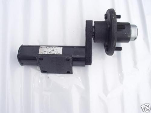

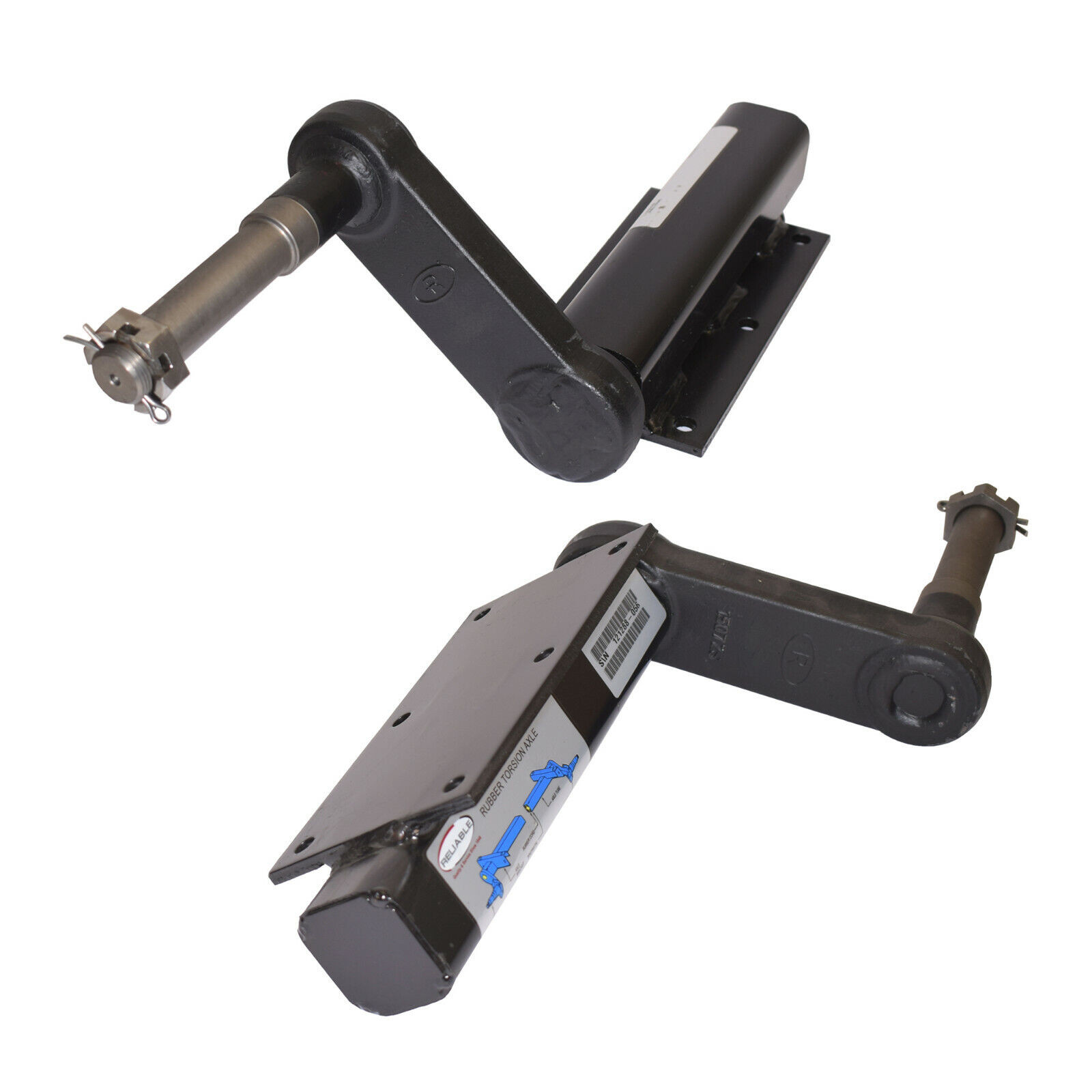

              These are nice. Would also make a good sidecar suspension. 500LBS. Not too stiff.

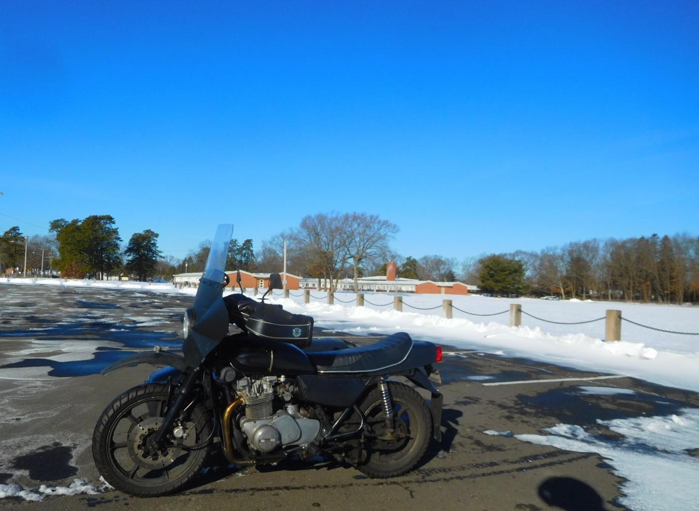

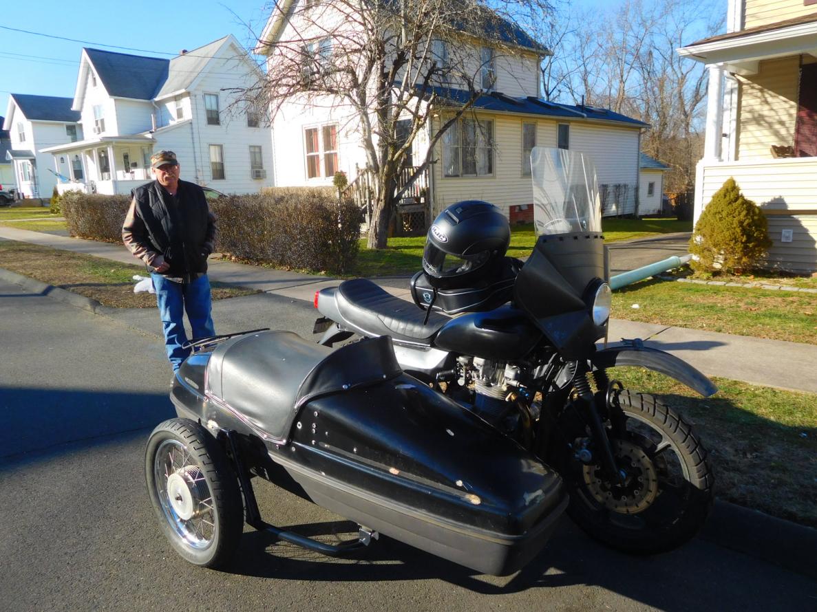

                        On the road today. Saw my pal Greg & a moose.

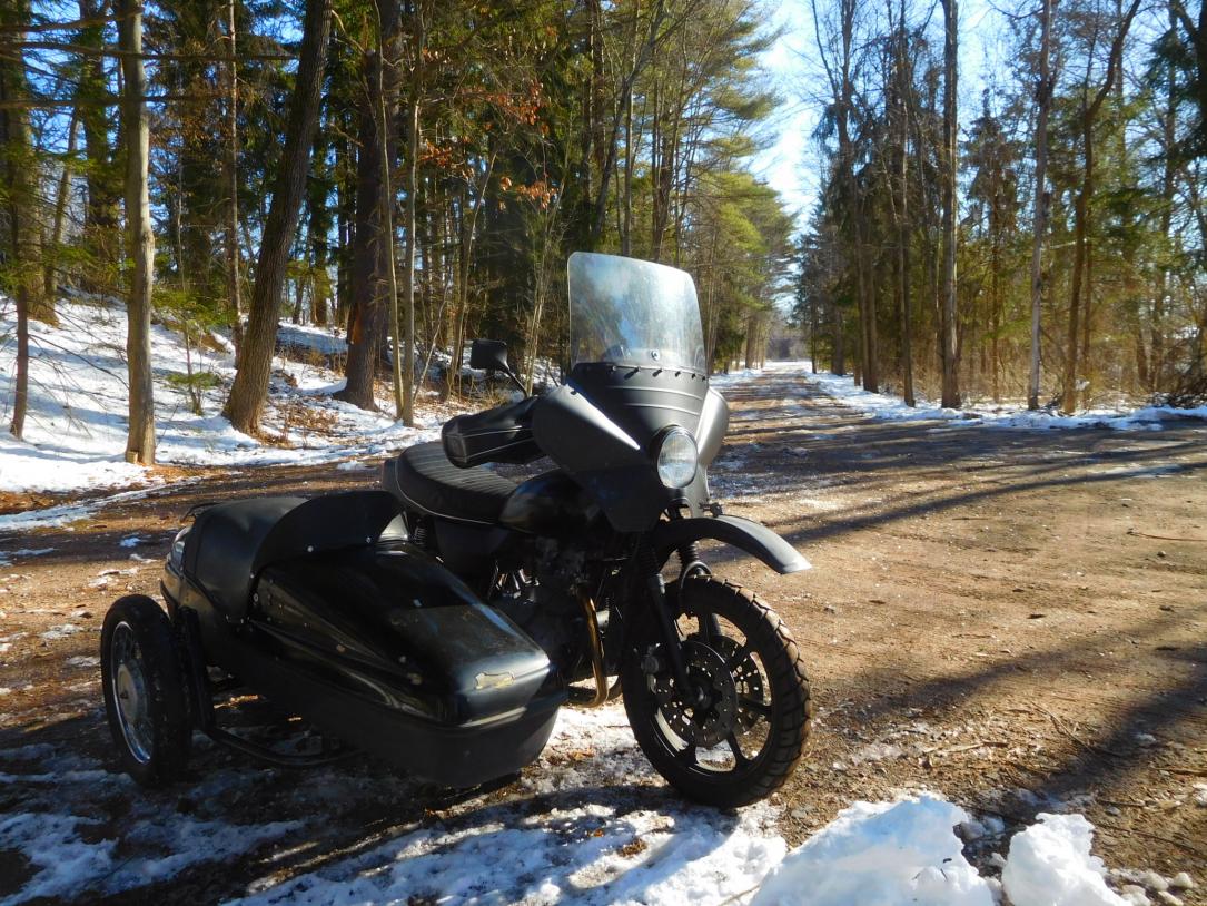

                                On the road today. 26°. Will warm up to 35° later.
