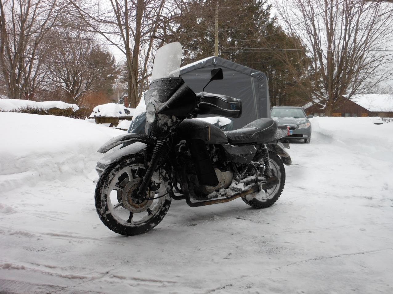

      I hear ya LAB3. It's not for everybody. I just could not stand the depression of not riding over the winter months so I corrected my situation. It's also pretty cool to be virtually the only bike on the road for almost 5 months a year for the last 11 seasons. I am living the dream.

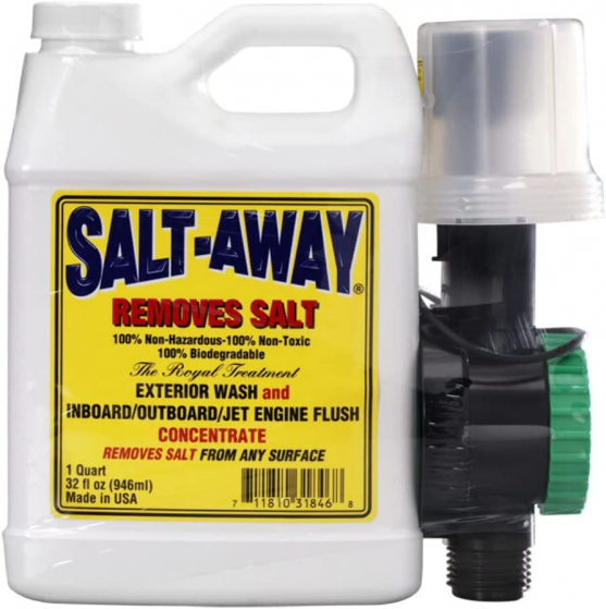

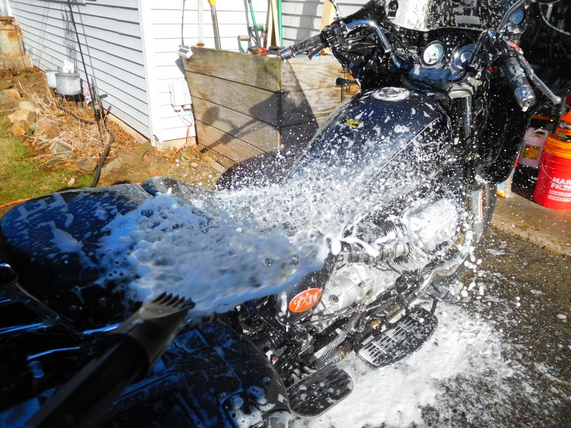

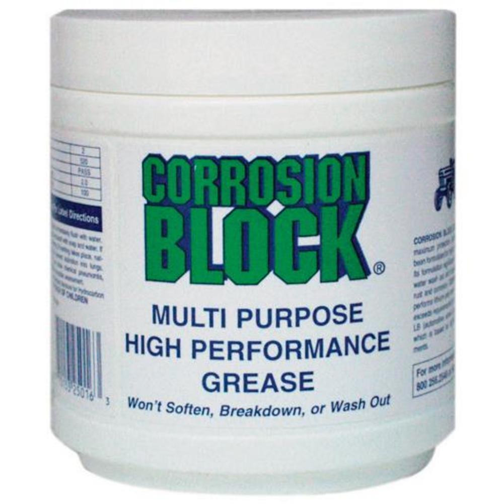

            I do own an old F150 2 wheel drive that I use for work only. Don't drive it much. Two wheels to many. My secret to keeping salt corrosion down to a minimum is lots of Corrosion Block grease on every nut & bolt and a product called Salt Away to wash the bike with a sprayer/mixer. It works great for winter riding.

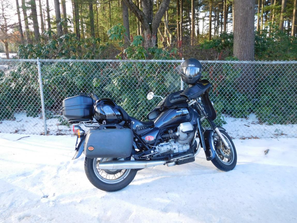

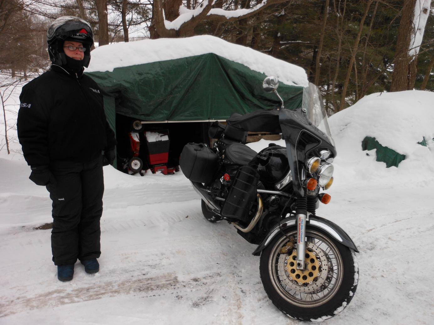

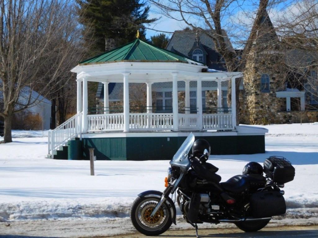

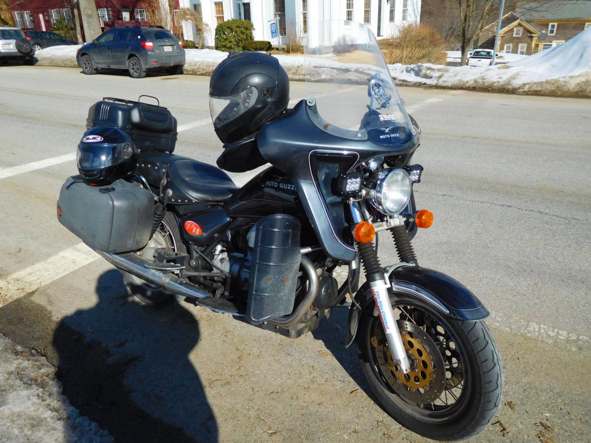

              You can see in the wash picture one of my other winter bikes a 98 Guzzi California 1100. Just turned 225,000 miles (no motor work ever, just oil changes every 3K miles). BTW, my wife rides with me all winter.

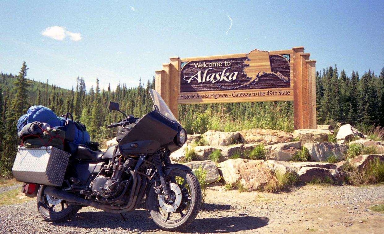

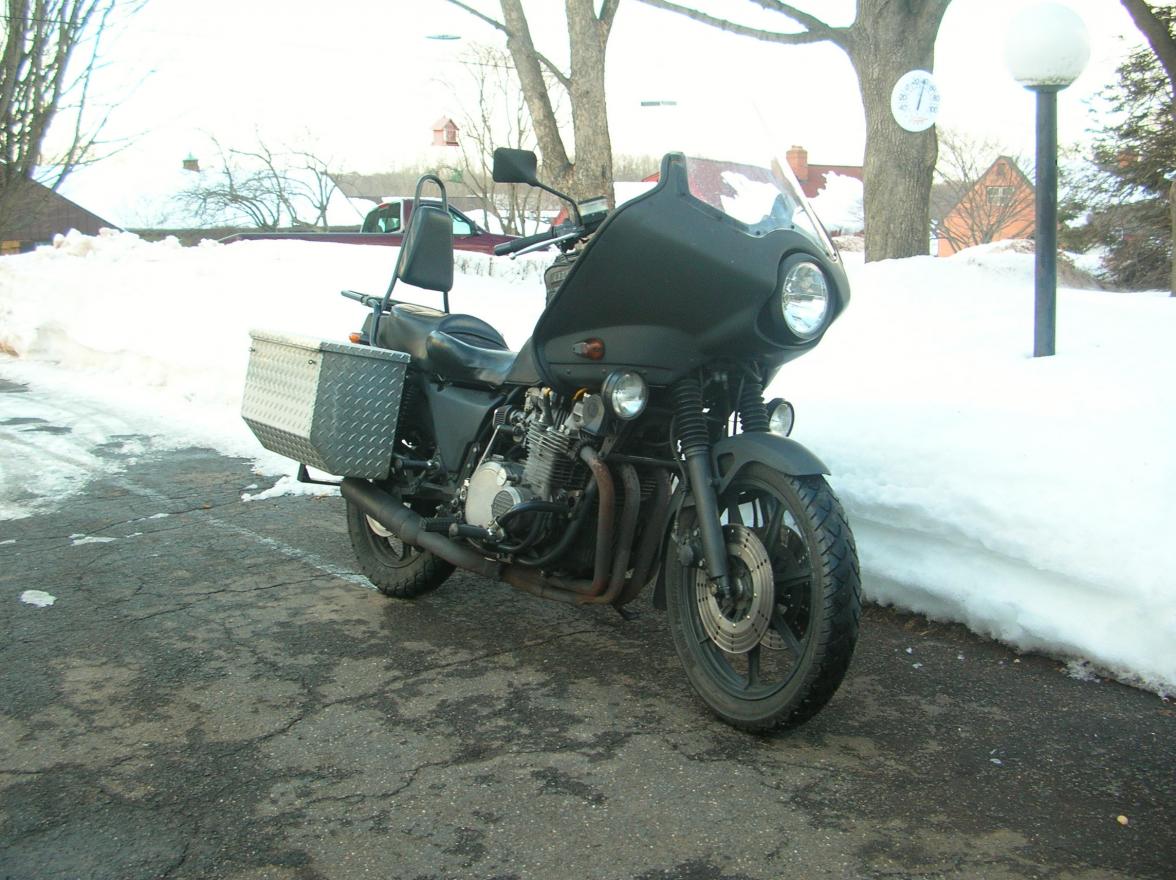

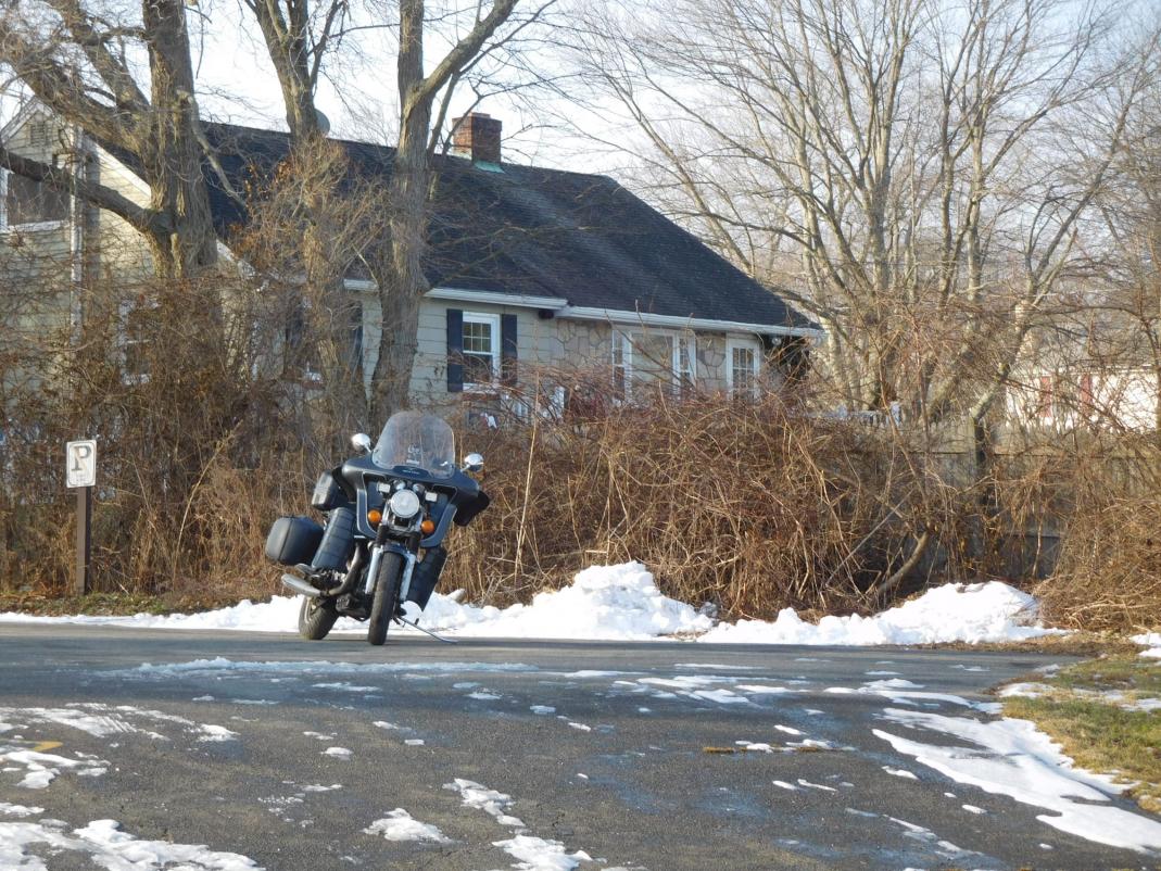

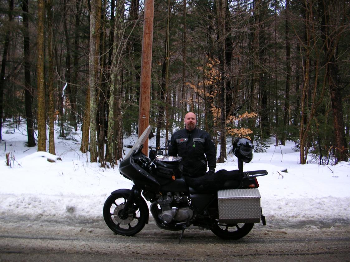

                My third winter bike is an 80 KZ1000 MKII which I don't think you will see many these days in the snow.

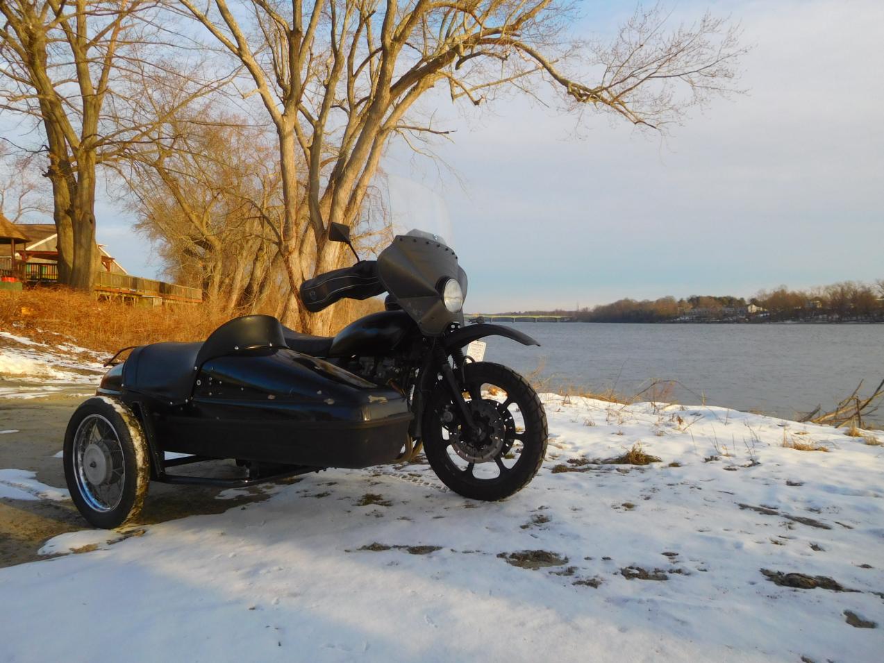

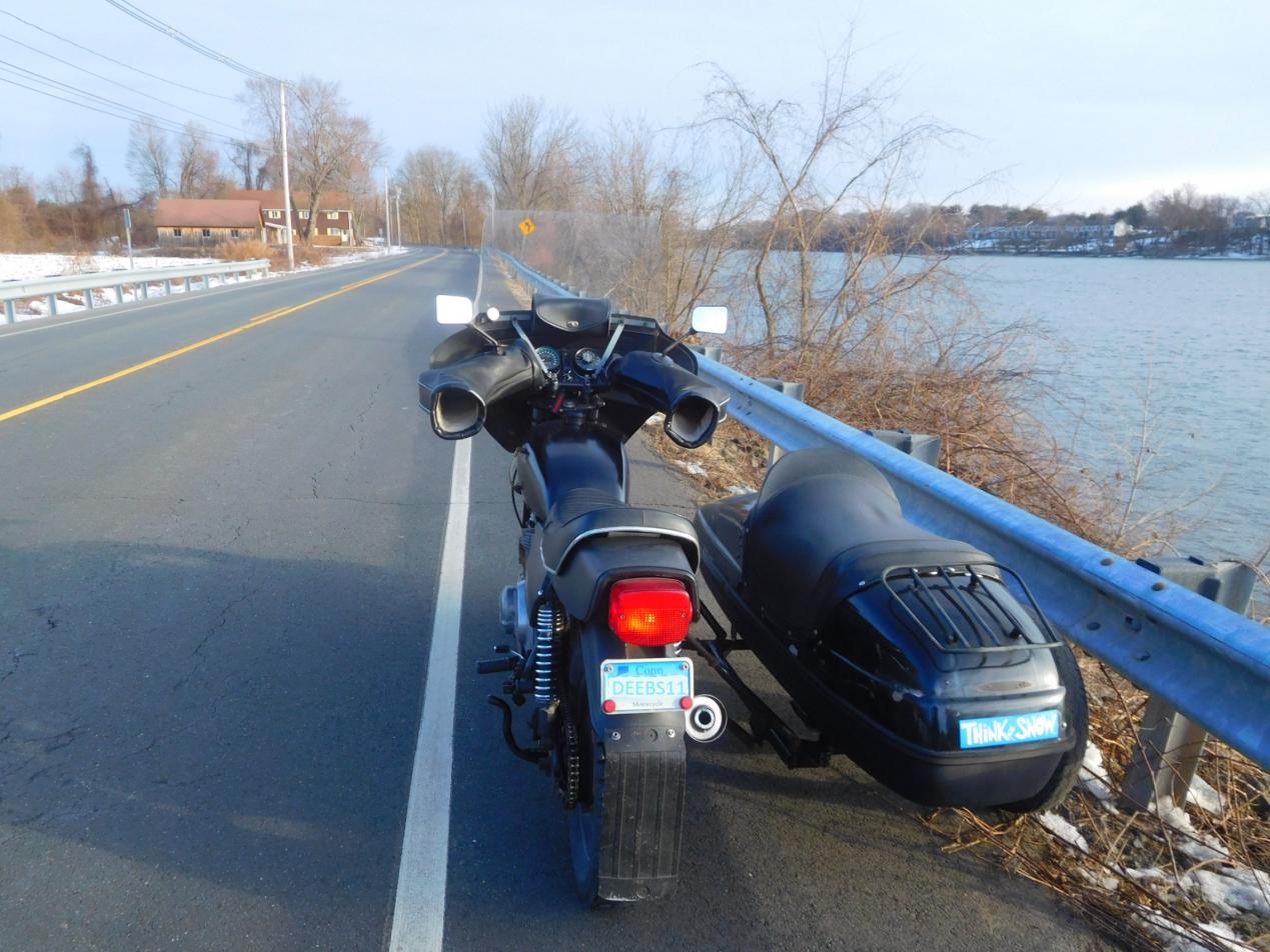

                  On the road yesterday 6:30AM riding through Windsor.

                    Absolutely inspirational. I always had a soft spot for those KZ750 twins and on several occasions have come close to buying one. One of these days! Cool that Delkevic has really stepped up offering good quality stainless steel replacement exhausts for a whole bunch of different UJMs. Thanks for posting this up.
                    '98 GSF1200S '81 GS850G
                      • 1906
                      #40
                      I like the twin. It's torquey. I geared it real high to pull the sidecar. Top speed is about 70 but it can climb hills with a payload. I have the carbs dialed in perfectly. The main jet on these bikes is actually a pilot jet for another type carb. The pilot jet is very specific and has to have the correct number of bleed holes or the bike will run like crap. The carbs are Mikuni and are very similar to the XS650 twin carb. The ignition is points and condensor but I eliminated the condensor and went with a IGBT (Insulated Gate Bipolar Transistor or Gate) type of electronic ignition. The points are now only used as a low current switch closure which means they will last forever (or whenever the pivot wears out. Perhaps 75K miles?). It also has a black Dyna 5 ohm coil (always use 5 ohm coils with points). The 3 ohm units don't last as long because they run hotter and develop cracks after about 20 years. The Delkavic exhaust is nice but a little too loud for me. I modified the baffle to quiet it down. The bike really rips for a 750.
                      And as I mentioned before. I eliminated the weak old 2 wire (single phase) stator charging system and converted it to a KZ1000J Police bike 3 phase system. Plenty of power for lights or heated grips. BTW, I don't run heated grips on this bike because the Hippo Hands from Craig Vetter are plenty warm.

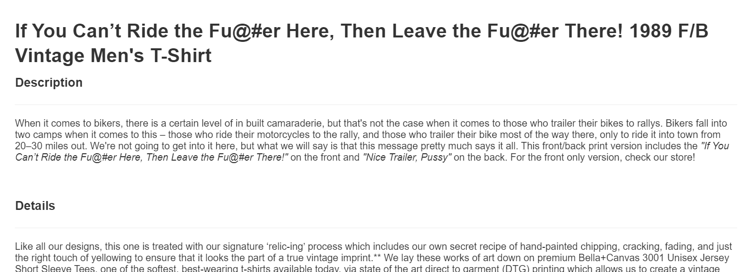

                                The real funny thing about that shirt is that it is "faked" to look old so you look like a real biker. The process is called "Credit-Carding".
