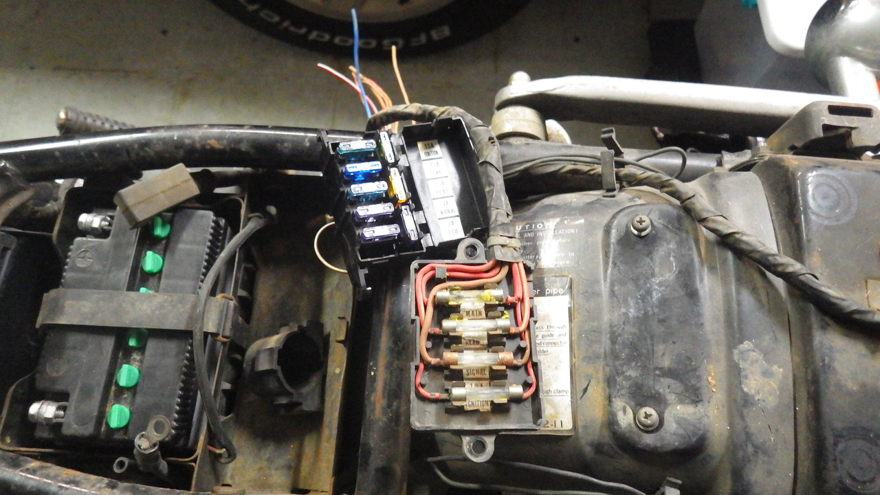

      • I have a spare fuse box kit for the XS11 that just won't work with the XS850 (photo 1)
        • Another guy used one of these but left the cover off the box.... not sure about that one.
      • I've pulled the fuse box from a spare FJ1200 harness and it will be a better choice (photo 2).
      • Unfortunately, the special seat pan will not allow either unit in the OEM location.
      • I've considered putting the fuse box inside the tool bin (eliminating the ability to carry any tools).
      • The other choice appears to be up under the tank (not exactly "ease of use")
      • I'm tinkering around to see if I can get the panel in just below the rear seat stops.... still tinkering.
      XS1100 Upgrade Box
      FJ1200 OEM Box

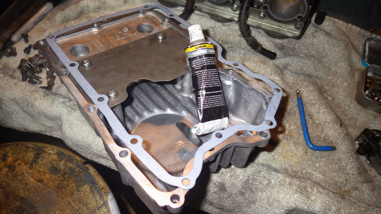

                  The oil pan was a mess on the outside and similarly disgusting on the inside.... It got a bath in my ultrasonic washer and was treated to a new gasket and Yamabond 4..... It's back on now nice and pretty & clean (inside & out).

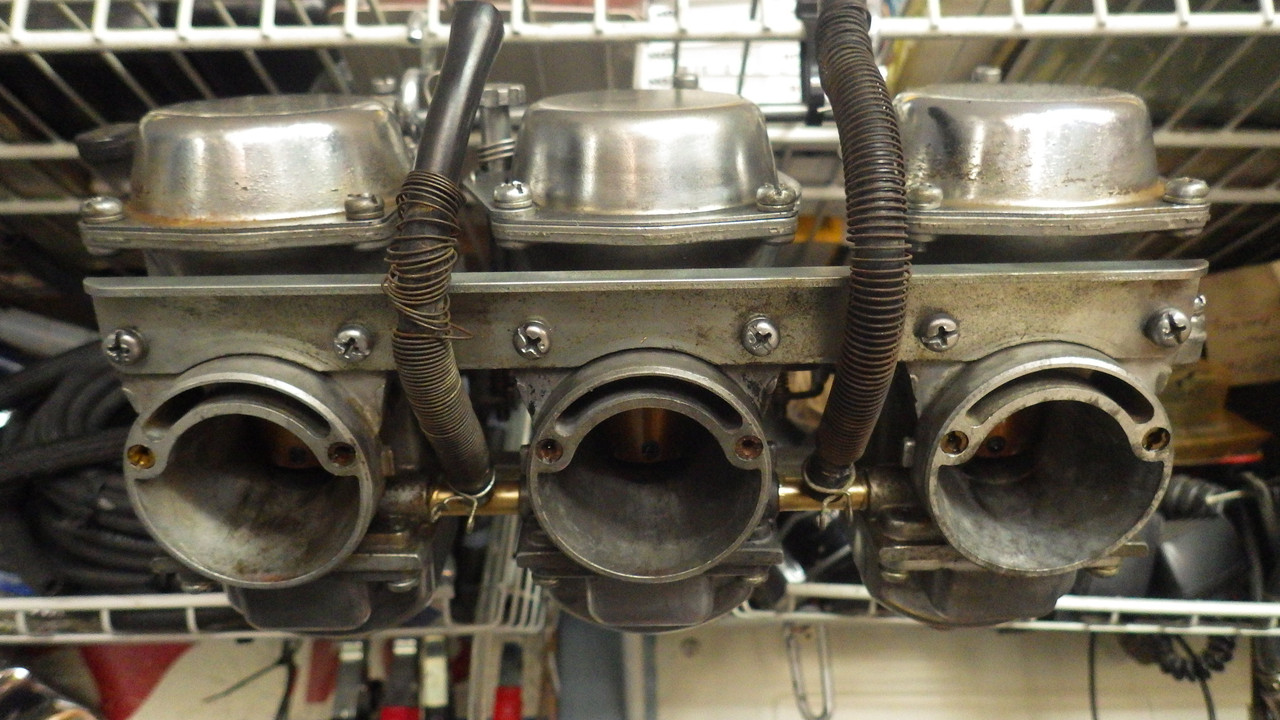

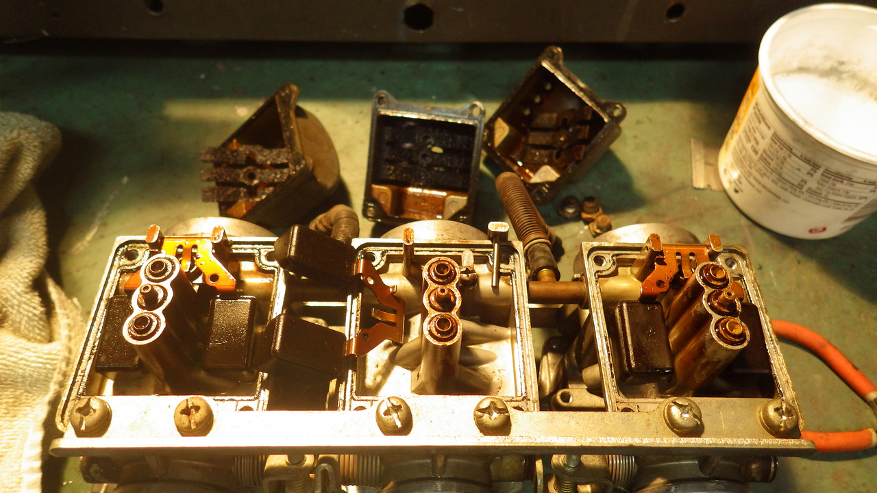

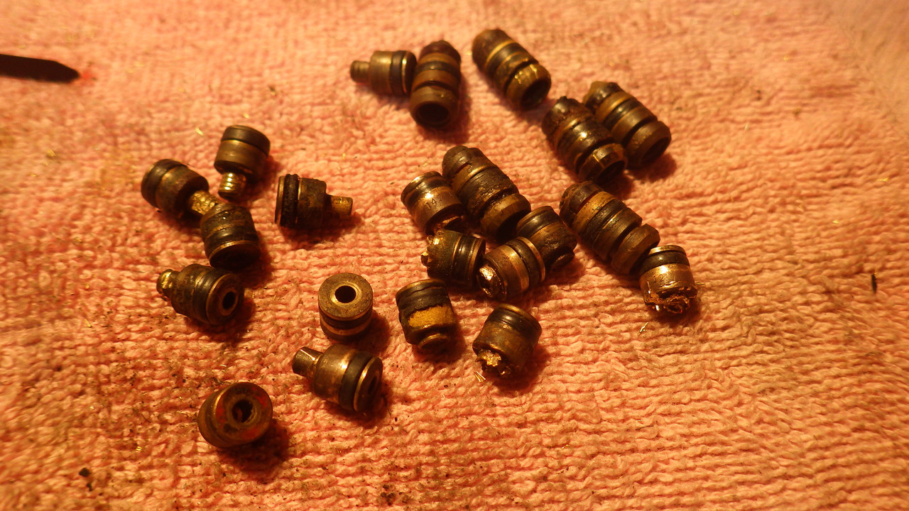

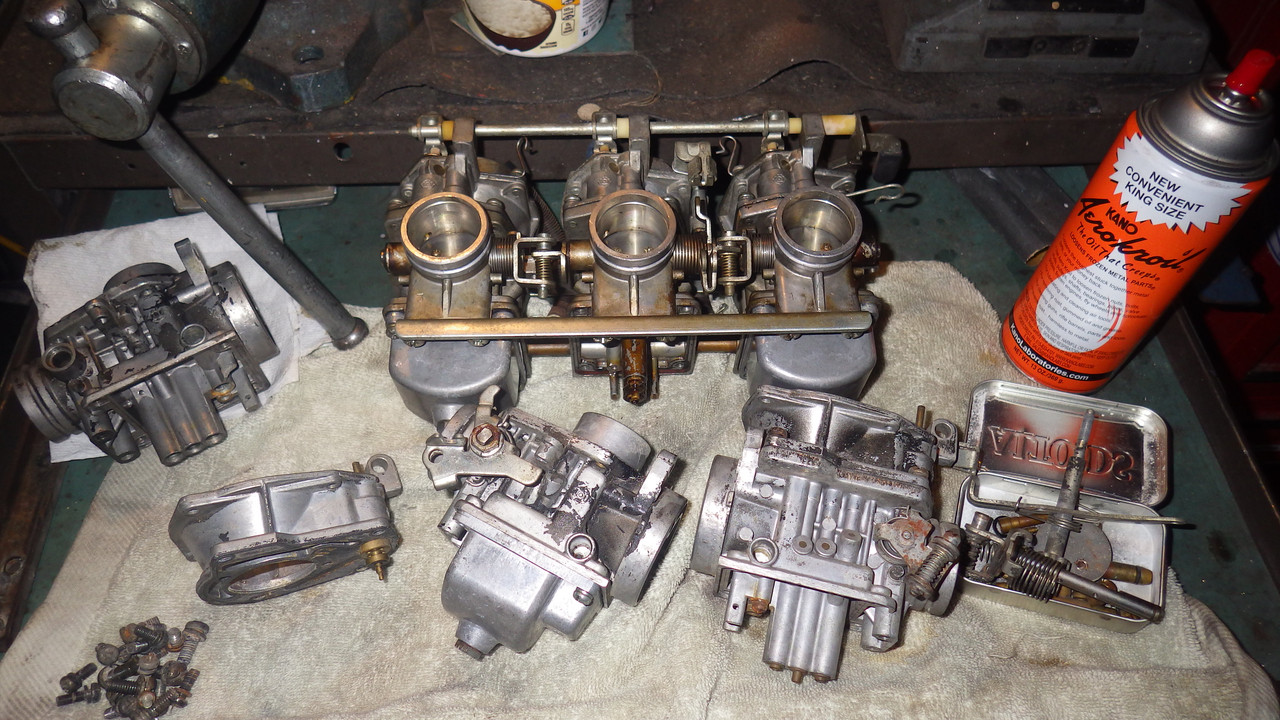

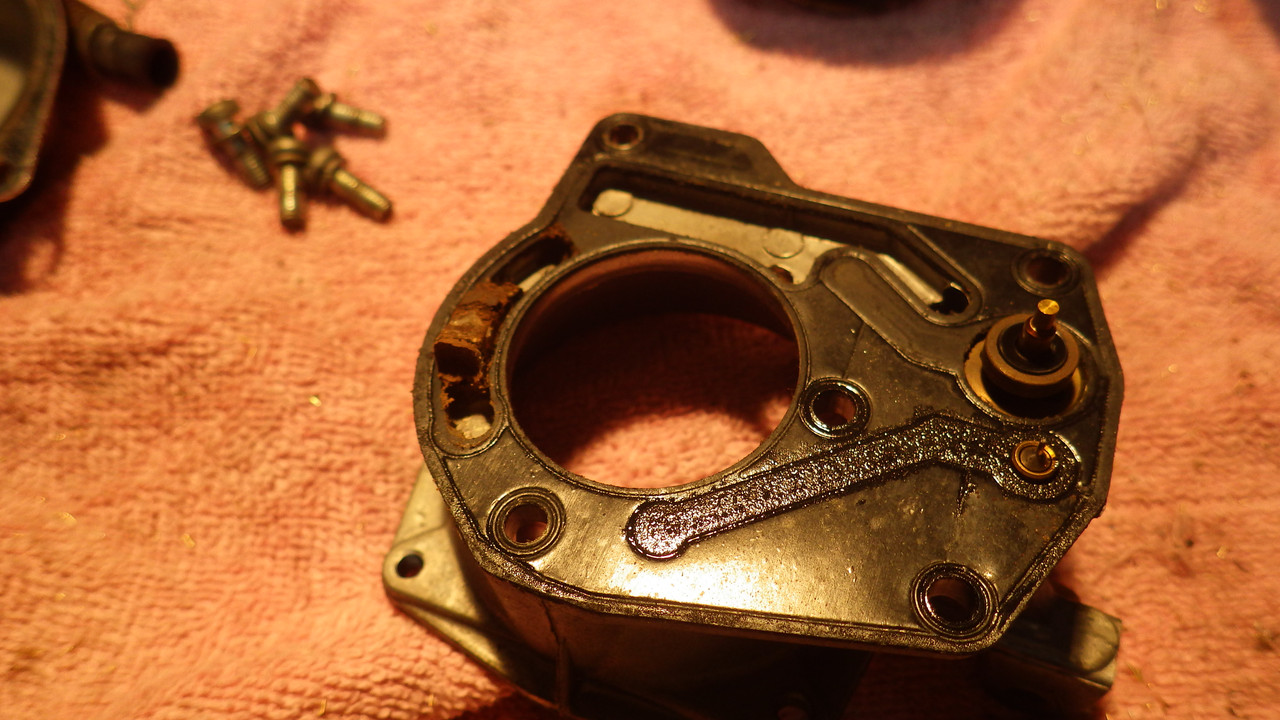

                  I had started on the carbs and set them aside.... Picked those up again today and got them done... WHAT A MESS!
                  Those from the south know what a Mud Dabber is.... Seems they LOVE Carbs.... They had made a home in ALL THREE of the carb tops..... That's what ya get with no air filter system installed (thanks to Mike I have one now)!
                  Thankfully, I received the three full Hitachi rebuild kits with all new jets. There is absolutely NO WAY to get these out without destroying them, they are held in place by a metal bridge and each jet has an o-ring to seal it (not screwed in like a Mikuni) On a Mikuni, if your safe & slow you can clean the comparable parts and reuse, NOT on a Hitachi. There is absolutely NO WAY to grab these and pull them out, there is NOTHING to grab!. I had to drill them out a little, install a drywall screw and YANK them out. Obviously, that process destroys the jet. Similarly, under each jet(3) is an "Emulsion tube" also impossible to remove, especially when all gummed up. Fortunately, the "Drywall Screw Method" also removed these but without damage.

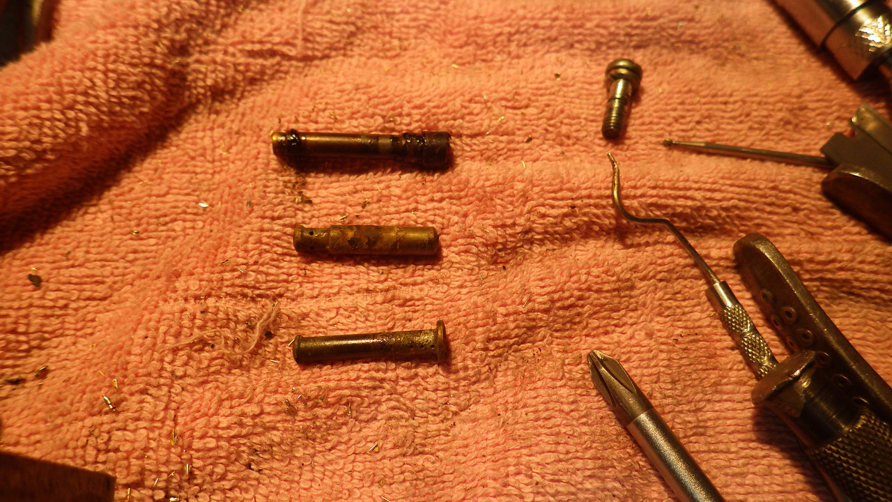

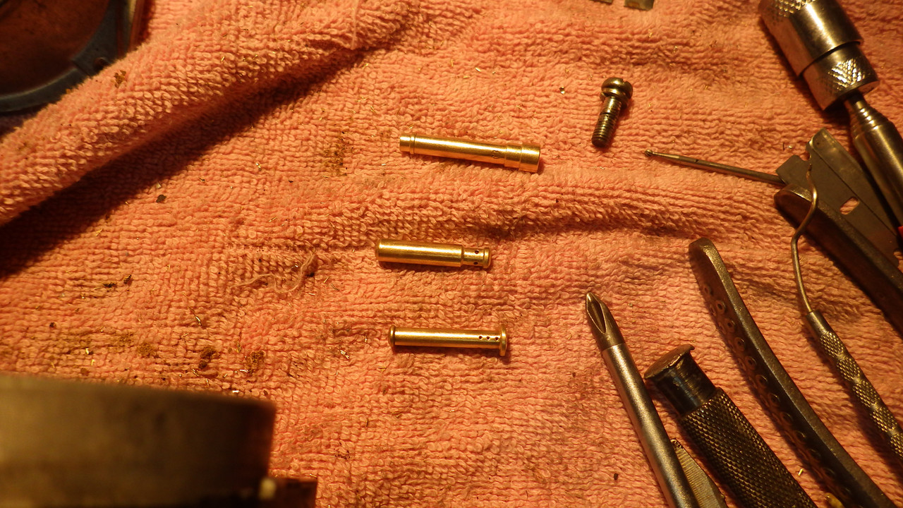

                  How the HECK is one supposed to pull these out (3 each in the centers) with absolutely nothing to grab? Even clean and new, there is no way to remove without destruction!
                  Dirty Emulsion tubes
                  Clean emulsion tubes (love that BRASS wire wheel).
                  A pile of destroyed jets and needle seats.
                  Carbs are done (ready to start). Yes. I will replace the hoses. The "T"s got new VITON o-rings thanks to McMaster-Carr Supply Co. (100 pieces @ <$5) advertised on Evil-bay for >$7 plus shipping for TWO(2) .

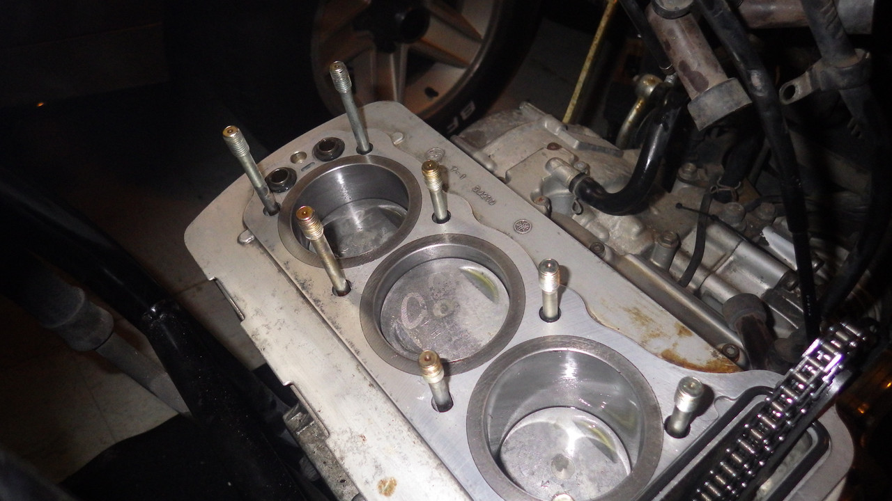

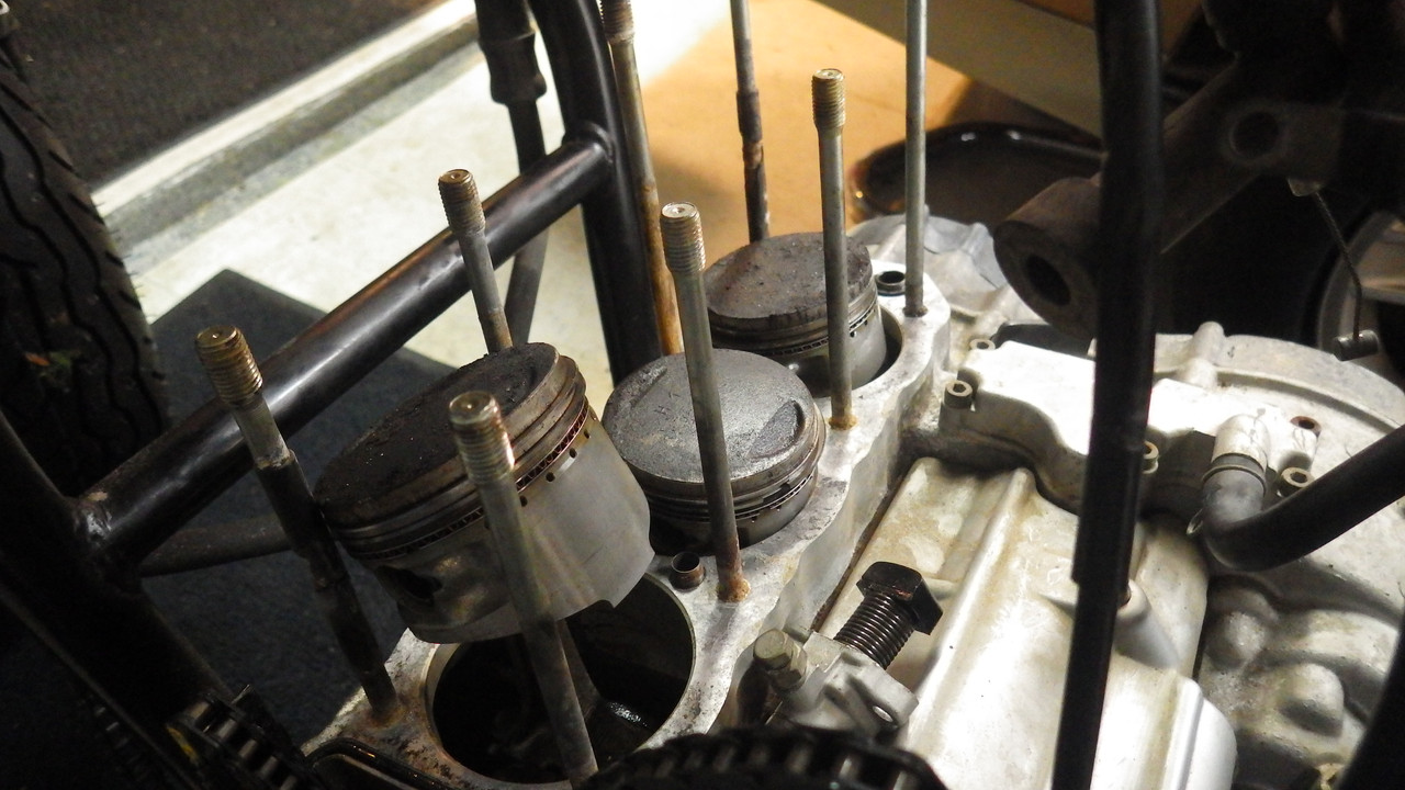

                  Since I have the "Extra Time" and I was planning on doing it anyway.... Pulled the cylinders. Actually looks a LOT better than the last XS11 did... But this bike has only 17k miles so they shouldn't be as bad as the XS11 with 69k on the ticker.

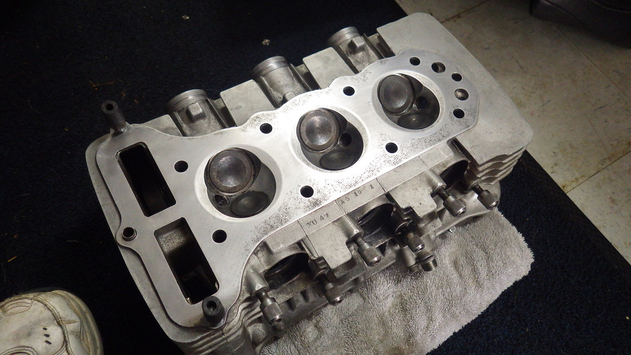

                  I also finished preparing the cylinder head.....
                  Before Photo
                  After Photo
                  All new Valve Seals, Valves cleaned and polished (a little), gasket surfaces prepared for installation. Again, not too bad on the carbon build-up as one would expect from only 17k miles.

                      With the help of Nancy, I got the thoroughly cleaned pistons and new rings installed and the jugs back on. A REAL pita to get these in. Cylinders have been honed and the ring end gaps were nearly perfect at the lower end of the acceptable range .023

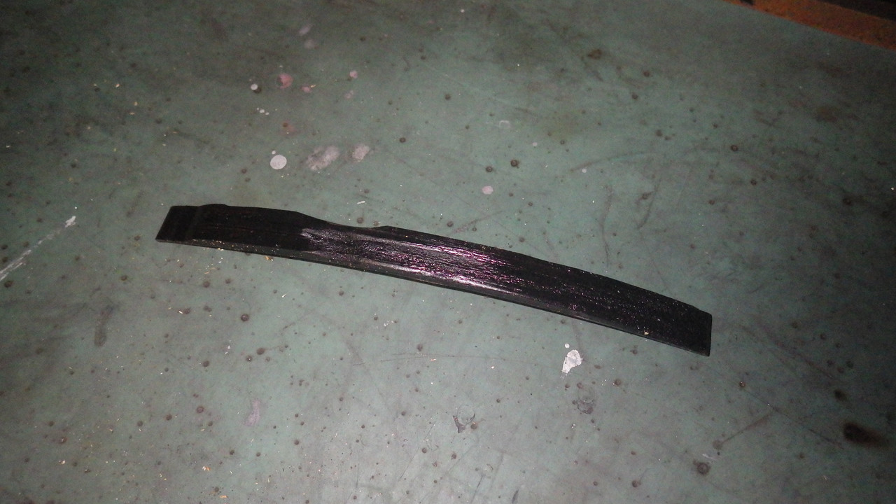

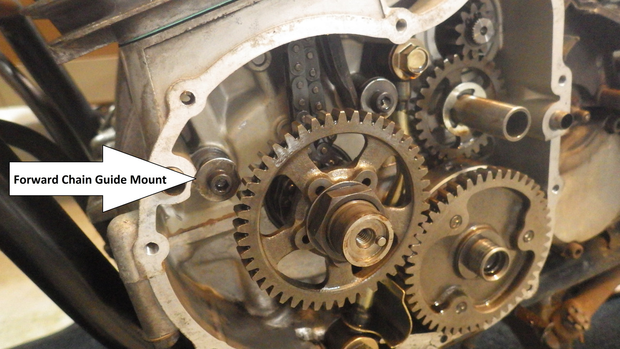

                      Unfortunately, it appears there was some existing damage to the chain guide (forward one) and it snapped off at the base.
                      You will note it looks like it has been beat to heck and back already. I'm actually thinking this dumbass PO tried to start the machine with the cam partially disassembled. Can't figure out how otherwise this was damaged and there were chunks of aluminum in the cam area otherwise. Anyway, this part is available new from Partshack. But, I found a used one for cheap which should be here in a day or two.

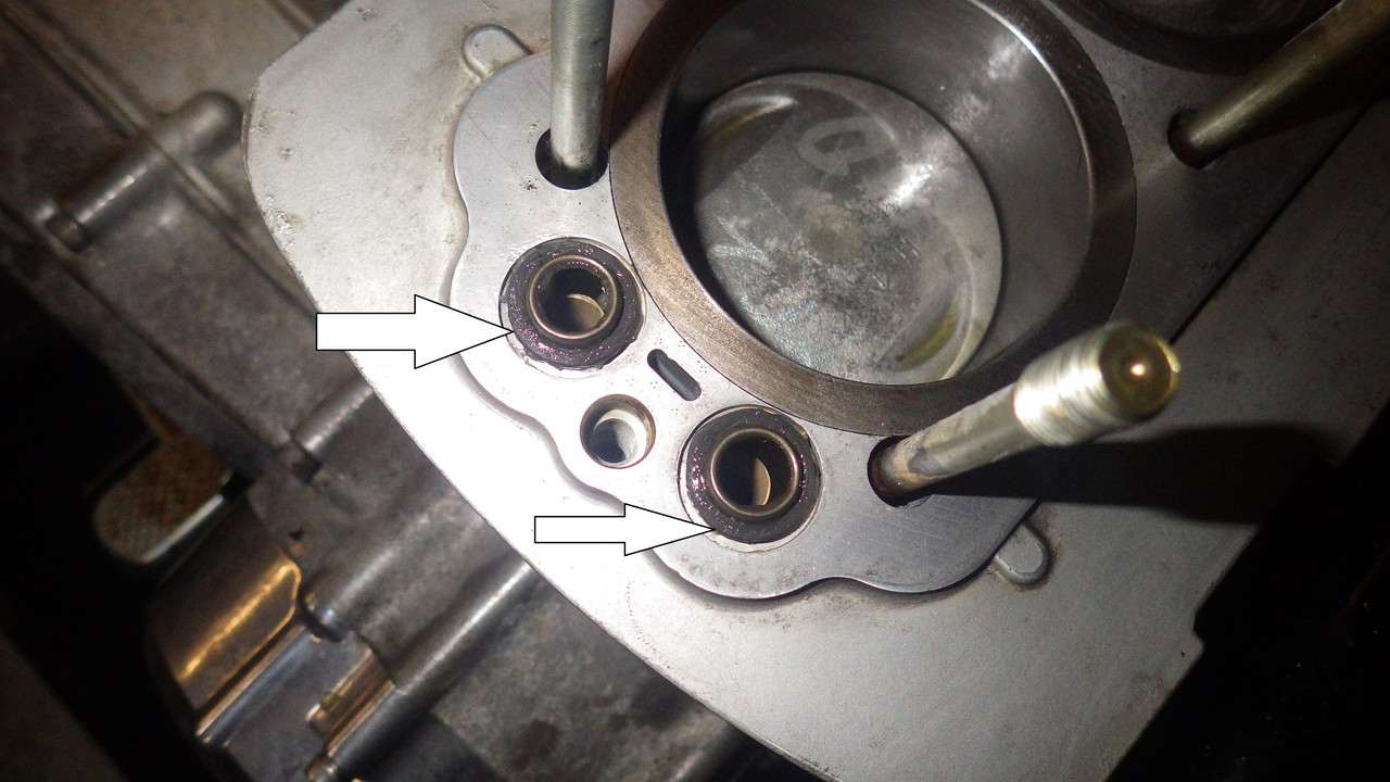

                      I also found that my "Complete" gasket kit did not include the oil passage seals (2 at bottom of cylinders and 2 at top of cylinder). These are NOT available form either PartShack or Partzilla. They look like o-rings, but are very different. Fortunately, I saved the old ones and they look fine. I coated them with my DOW o-ring grease/sealant and they should be just fine.

                        ...I also found that my "Complete" gasket kit did not include the oil passage seals (2 at bottom of cylinders and 2 at top of cylinder). These are NOT available form either PartShack or Partzilla. They look like o-rings, but are very different. Fortunately, I saved the old ones and they look fine...
                        ... I need to pull the left engine side cover to see If I can get the replacement guide in there with the head on. I'll also check the instructions in Clymer.
                        (1) I like siting around the house (napping), and doing home improvement.
                        (2) You probably know those O rings have a D-shaped cross-section and the they have to be put back in with the flat side up, or there will be an oil leak (p 82 Clymer). My Athena kit had round O-rings to replace the originals, but I chose to use the original ones instead and I had no leaks.
                        (3) You can't get to the cam chain guide from the LH cover. You just see the side of the crankcase when you remove it. I suspect you have to go in through the oil pan.

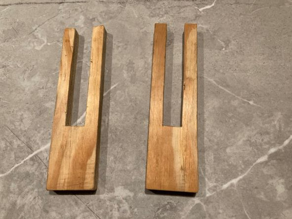

                        (4) I made these "forks" to hold the pistons from flopping while you drop on the jugs- I saw the idea and dimensions in the the FSM or Clymer:
                        Click image for larger version  Name:	IMG_3408 -1.JPG Views:	0 Size:	73.1 KB ID:	868076
                            Mike,
                            Thanks for the note. I have a pair of those wooden supports identical to yours. I also found the dimensions in the Clymer. Unfortunately they were up in the attic as I put them away after the XS11 jug job and was too lazy to go get them.
                            I found that you actually can get to the chain guides, the starter clutch and a couple other little items from the left side cover. Of course, that was after fighting like heck with the "EPA Screws" that are designed for us NOT to be able to adjust the timing. After a considerable amount of time with left drill bits, and easy outs I got those nasty little no-head screws out and the side cover revealed the inner workings of the cam chain area.
                            I shouldn't have any difficulty slipping the new guide down the cam chain tunnel with the head installed. I can just bolt it in and then finish the cam shaft installs and mend the chain. Might just go and put the head on now.....It will certainly be done this wekend.
