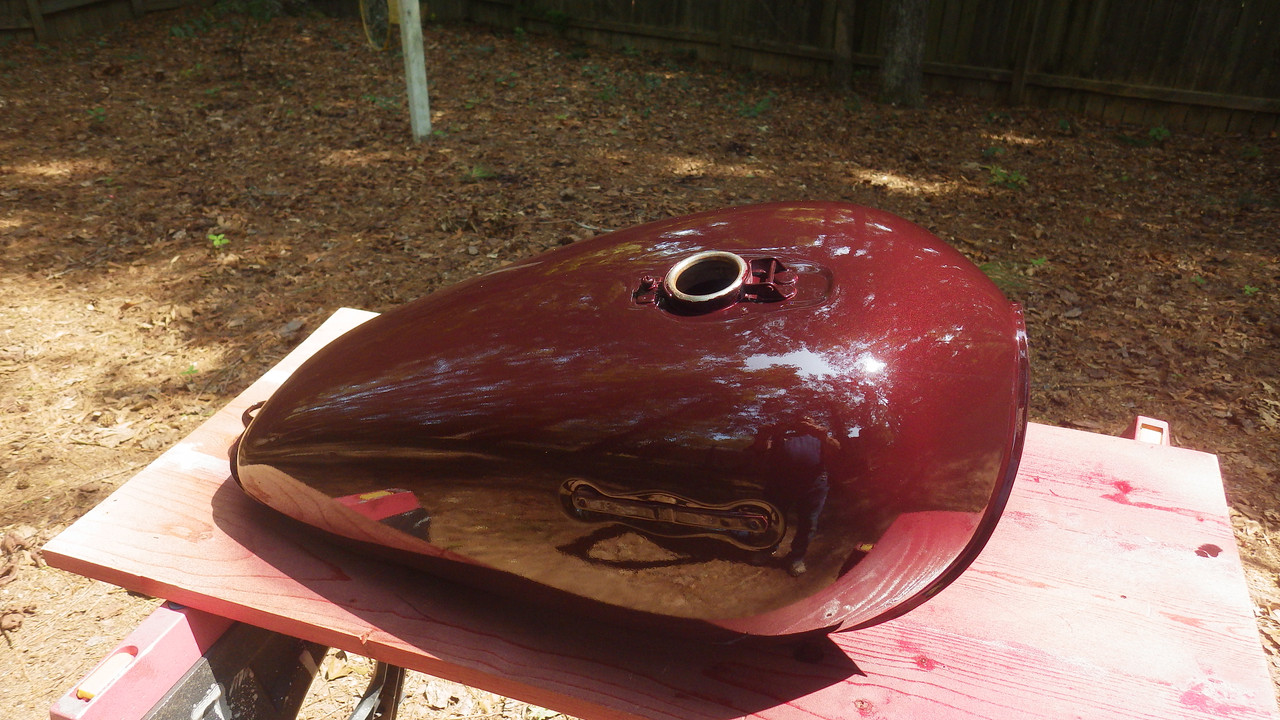

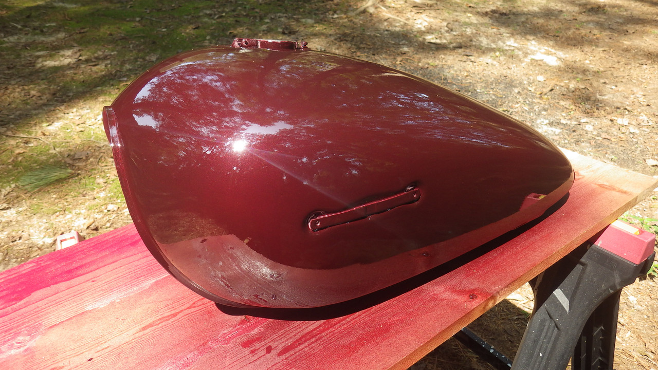

        Initially, I had planned to use this as a Guinea Pig for the custom mixed paint. Now, it turned out so well that it could become the primary tank for this machine. At the very least, it's a darn nice spare.
        I painted this early this A.M. before the sun was really up and overhead. It looked too dark. With the sun completely overhead it looks pretty darn close to correct, once dry enough to move later today I'll see how this PPG Custom Match compares to the OEM paint.
        Fortunately, I have no fisheyes and no orange peel! A couple little SPECS that will be eliminated once the tank is sanded and buffed. Unfortunately, using Mother Nature (sun & heat) as the drying booth the PPG rep recommends 2 weeks before wet sand and color buff.
        Thanks Again Marty

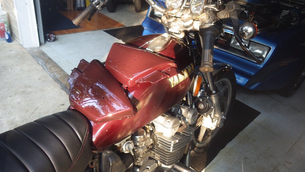

            XS Friends,

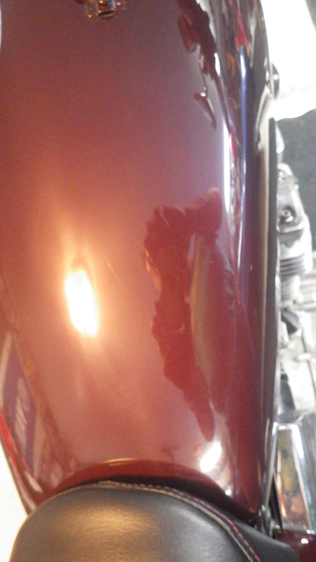

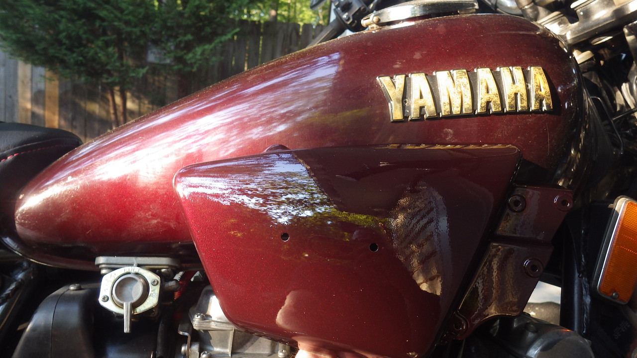

            Making some more progress this weekend with the 850. I got the side covers done and was trying to see how good the paint match was....
            Seems with this color the light really has a HUGE EFFECT on how the color looks. It's also difficult to gauge as the tank is faded on the top just like the side covers were. Unfortunately, it was late in the day before I could pick-up the side covers safely and I was moving the bike around to try and get some good sunlight.... Wasn't really possible.
            Here due to sunlight & shade it looks like the covers were painted in two different colors:
            It's not like this thing is ever going to be judged as a "Pristine" example of a stock XS850 but I want it to look pretty close (or close enough that it looks OEMish).

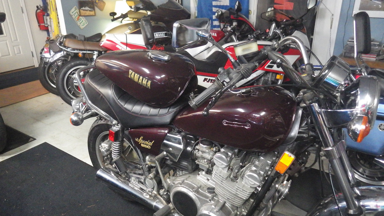

              XS Friends,

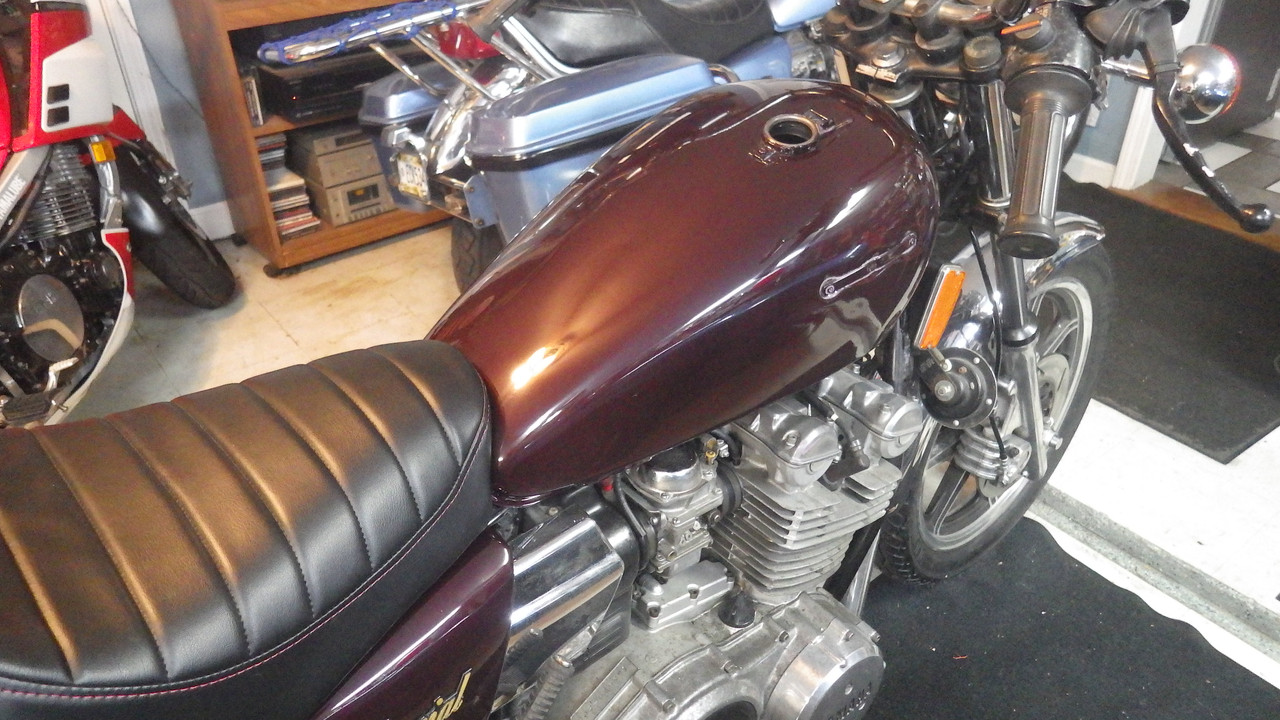

              Well BOTH the tanks and the side covers are done and buffed. Unfortunately, there are minor imperfections but that's the deal when painting out in the back yard..... Some dust will sand and buff out but Bird Doo Doo and leaves don't... Oh well they and the side covers are absolutely NOT perfect but they are much better than what I started with. NO time or $$ to keep playing around with these parts, gotta get the REST of the bike ready for the rally.
