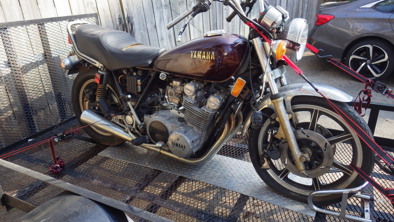

          XS850 is home today....
          Actually doesn't look too bad after a trip through the car wash to get 10+ years of storage dirt and filth off of her. We couldn't find the Right side cover or any others in the storage shed the Junk Yard has for side covers (actually a trailer designated as "plastics"). I don't think the side cover will be too hard to find. I may actually already have one from a Standard that might work.

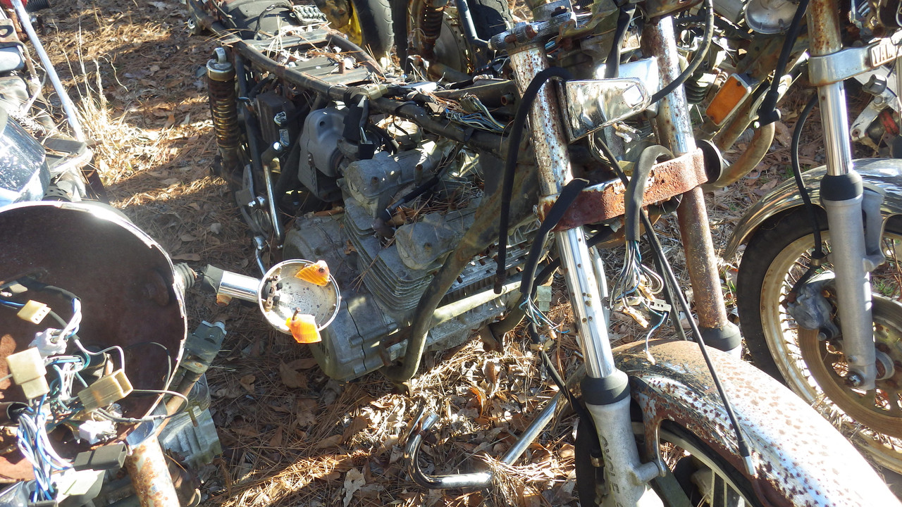

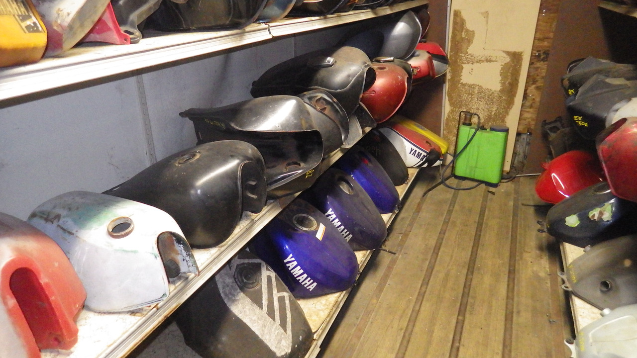

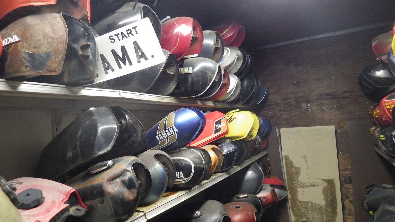

          The junkyard has several parts donors for motors and bits. I absolutely LOVE walking around the Bike Junk yard. But, when I see one I loved as a kid, and I know it is done forever it is a little sad.

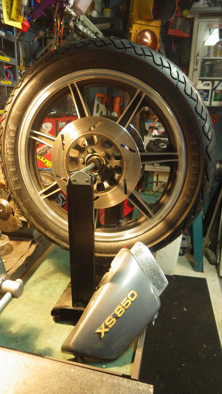

              The darn front tire wouldn't hold air and having sat flat for so long the bike could not even be easily pushed by Nancy & I with a lumpy flat mess on the front. Removing the fender made it a LITTLE easier for us to move onto the back porch but we struggled a LOT.
              I didn't want to spend anything on the bike until; 1.) tax season was over, 2.) I was sure it would run. Unfortunately, I had to bite the bullet and buy a new front tire just so the darn thing could be moved without getting a hernia. . Mounted and balanced it today, I'll get it on the bike this weekend and be able to push the XS850 into the garage....
              Once I have the engine STARTED, I'll pull the wheel back off and replace the wheel bearings and seals. For now, just being able to roll the bike will be sufficient.

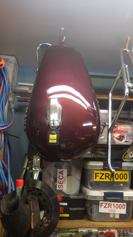

              On the weekend I decided to do "Something" to the XS850 and polished the tank with my buffing equipment. Although there are a couple paint chips and scratches the OEM paint came up pretty darn nice..... Another great thing is the inside looks like the day it was born!!! Absolutely spotless inside the tank! No liner needed for this one!!!!!
              I didn't have a chance to check but I have a full set of XS850 STANDARD parts (side covers and tank). I purchased these a couple years ago and they had been "Decorations" in my garage. They were only $20 at that time and I just couldn't walk away. I'm thinking MAYBE the standard side cover will fit the bike? The attachment points are all the same style/type in the same locations (I think). Haven't had a chance to check yet.......

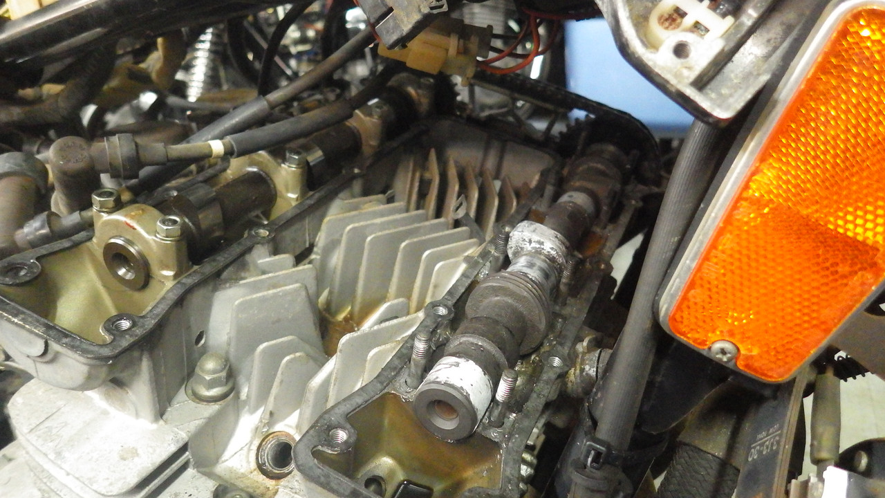

                Ahhhhh Now we now why the guy brought this bike to the junk yard!!!!
                Silly bastard apparently attempted to adjust his valves and was not up to the task.....
                Stupid SOB put the valve cover back on without any of the cam keepers...... wondered what all that noise was up in the cylinder head.....
                Damn..... this head & cams is headed for the trash can...
                Might just give up on this one while I'm only $300 into it

                  If you decide to proceed, the cam chain must be split to pull the head- not a big deal at all. You just have to find the master link.

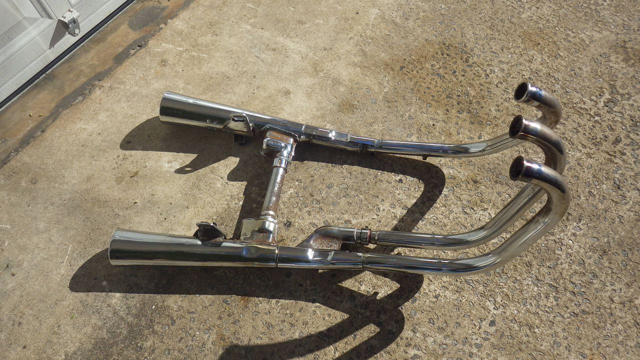

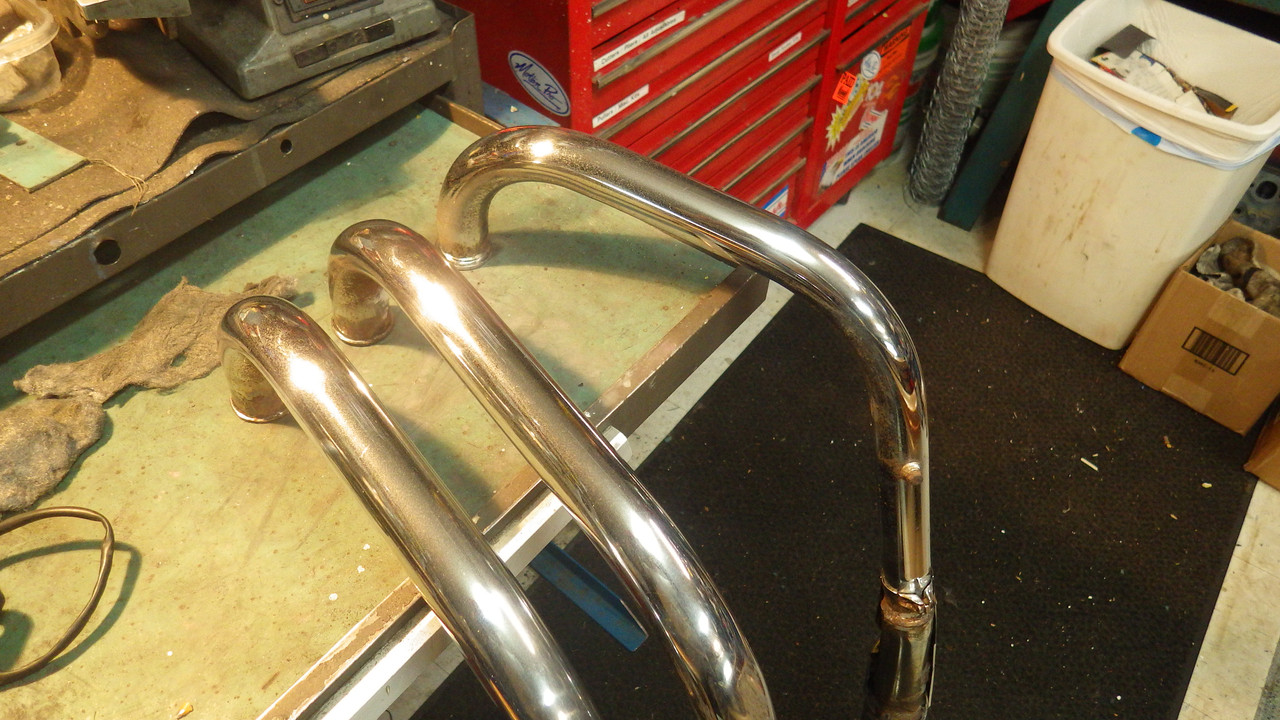

                      I had to pull the exhaust to get the head off the thing so I spent my day cleaning the exhaust (first step of many).
                      I believe with a lot of elbow grease, a lot of XXXX steel wool, and a ton of polish this exhaust will come up pretty nice.
                        With a lot less elbow grease, try this.
                        I bought this stock exhaust on eBay about a’hunnert years ago.
                        I painted the rusty bits with phosphoric acid.
                        I bought another gallon. Phosphoric is presented only in Spanish. It’s the same stuff.
                        Finish with wax or chrome polish. It looks great on my old XS650 now.
                          • 1249
                          Thanks for the tip Marty!

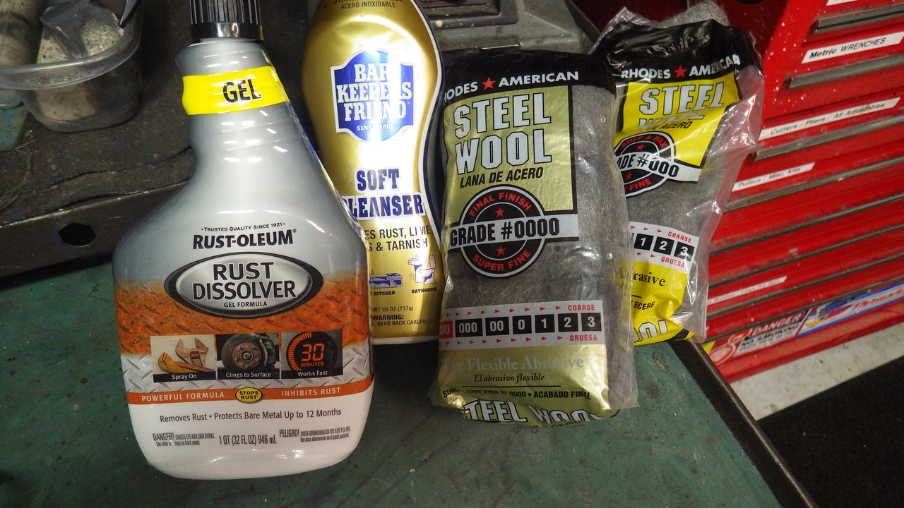

                          I've been using this....
                          The Rustoleum "Rust Dissolver" has phosphoric acid in it as a main ingredient although I suspect the level of purity/quantity of the acid is likely less than the product you used on the 650. The Rustoleum product did break up a very large quantity of the rust on the exhaust and the gel nature of the product and the spay application was helpful at keeping it on the pipes.
                          Someone turned me on to "Bar Keeper's Friend" a few years ago and I find it also very useful at cleaning up rust. The Bar Keepers has "Oxalic Acid" in it (whatever the hell that is).
                          I want to dunk/submerge a few other parts and will get a pail of what you used and probably try it on the crossover area of the mufflers where there is still a bit of rust to remove or convert.
                          So far.... the pipes have come a long way but there is a lot more to do on them.
                          KURT

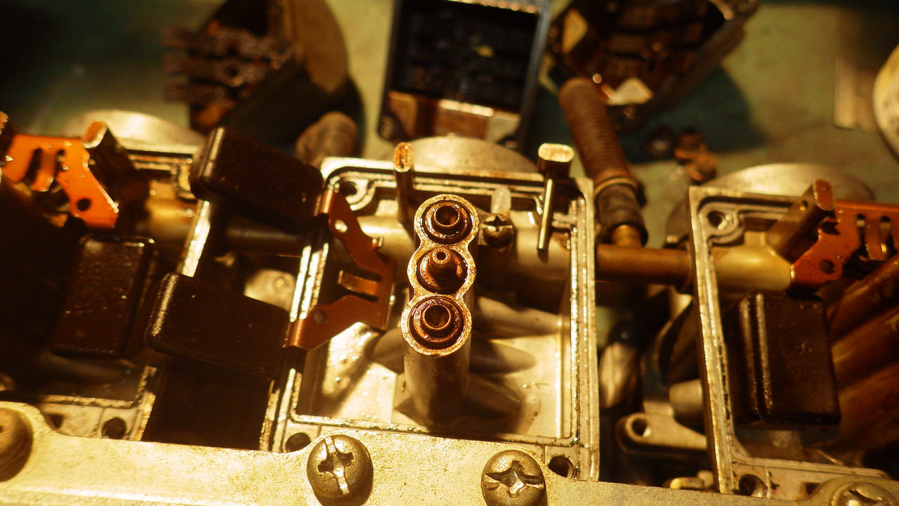

                              It looks like MO MONEY! Seems the PO wasn't satisfied with destroying the Cylinder Head.....He needed to destroy the carbs as well.
                              Question? Does one screw the carbs and then destroy the head or vice-versa? Once you know you screwed up.....Why continue? Did he think the carbs were the issue when the cam was floppin' around or that somehow a valve adjustment would repair the broken post and MISSING needles?
                              I expected to have a real science project here with a bike that had been sitting several years. However, I was hopeful I could clean up the carbs to a state where the damn thing would start (even if very poorly) and then later rebuild the carbs correctly with all new parts. Unfortunately, the PO was in here and not only did he break off the post, he never re-installed the needles. Maybe the Hitachi carbs on my SECA uses the same parts as I have 3-4 spare sets of those. I'll figure out how to properly mend this post (even if it turns out to be a temp move) and no JB weld will NOT be a component of that repair. I think I can drill the post and pin it back in place with a spring pin and then possibly reinforce the side with a SS plat and screws (drill & tapped M2 or M3).
                              The XS750/850 used the Mikuni carb in previous years and I may swap over to those.... The Mikuni had better quarter mile times and better off the line acceleration according to reports from the day. The Hitachi was more fuel efficient and smoother than the Mikuni according to the same reports.
                              Punting on this one was seemingly more and more the better choice.
